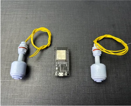

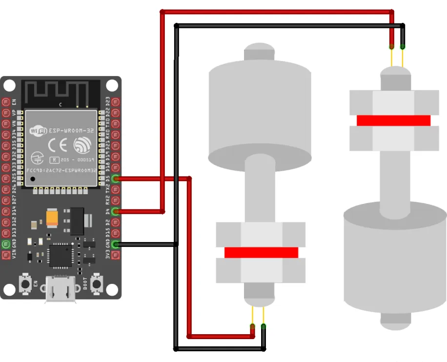

- Two P45 float switches.

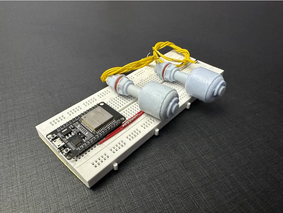

From ESP32 to the Float Switch Top (High level):
| ESP32 | Float Switch |
| GND | 1st terminal |
| D4 | 2nd terminal |
From ESP32 to the Float Switch Bottom (Low level):
| D5 | 2nd terminal |

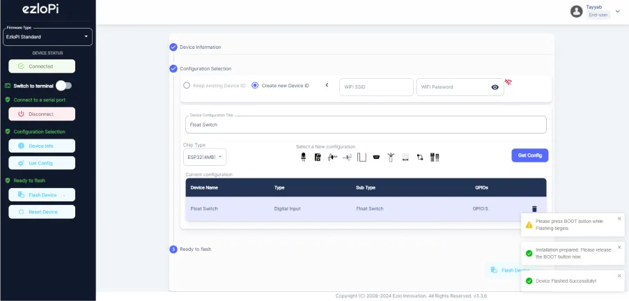

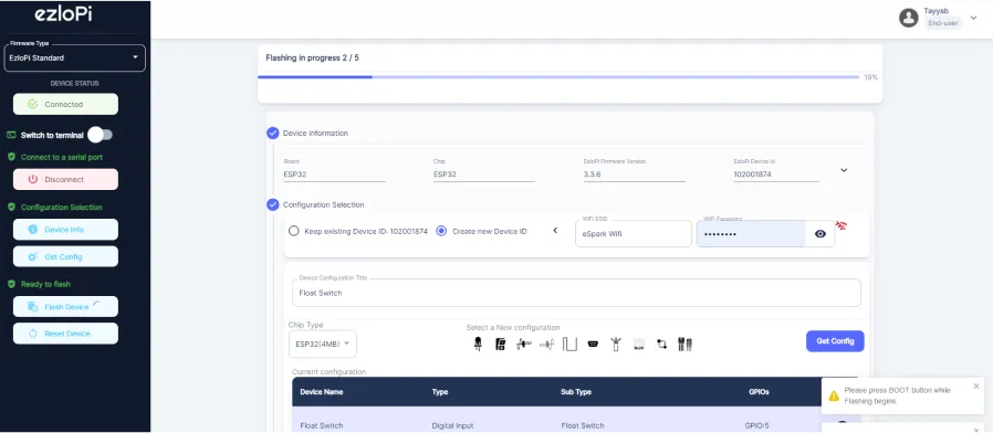

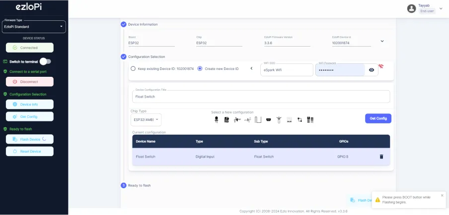

4. Interfacing the float switch with the EzloPi Web Flasher
Now, select COM Port to which your ESP32 device is connected. In our case, the COM3 port is used.
Click Connect.

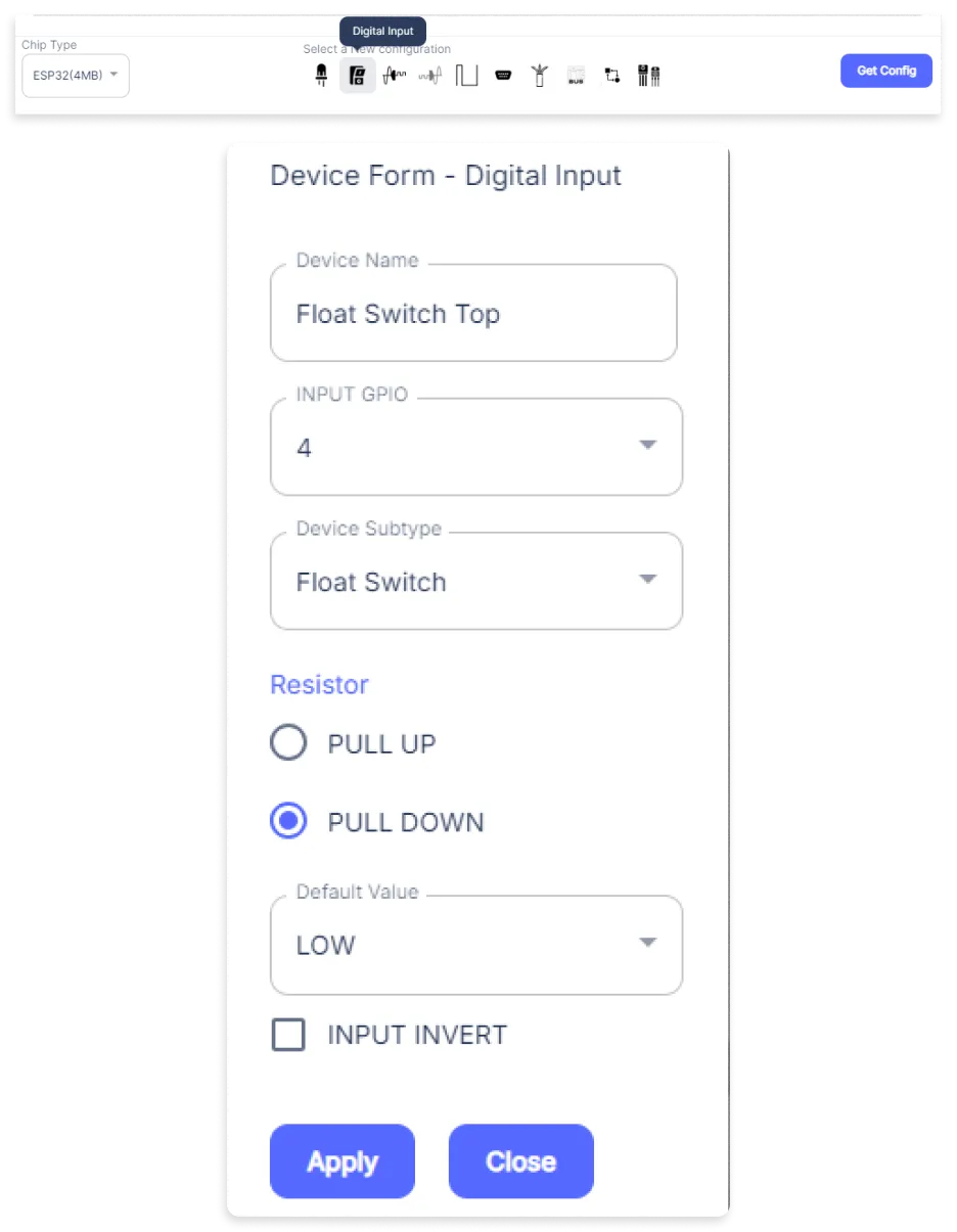

- A Digital Input window will open for inputting the following parameters:
- Set a device name of your choosing. In our case we set it to Float Switch Top.
- Set the Input GPIO to 4.
- Set Device Subtype to Float Switch.
- Set Default Value to LOW.
- Now, Click the Apply button.
- Again, In the Device Configuration, tab click on Digital Input.
- Set a device name of your choosing. In our case we set it to Float Switch Bottom.
- Set the Input GPIO to 5.
- Now Click the Apply button.
- After clicking the apply button you can see a table of your setting in the Current configuration tab.

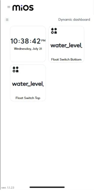

5. MiOS App

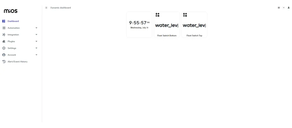

- After opening the MiOS mobile dashboard, you will be able to see the tiles of your connected device.
- As you can see in the MiOS mobile dashboard, we can see both float switch tiles. When the water level is above the threshold which is set for the bottom float switch, the tile will display “water level ok” message and when the water level increases and rises above the specific threshold for the top float switch, the tile will display “water level above high threshold” message. This will apply for both float switches.
- Similarly, when the SPDT gets operated/turned on, the switch will display the “On” message as depicted in the above image.
6. MiOS Web Application
- Now, on the MiOS web dashboard, you will be able to see the tiles for both float switches.
- When the water level is above the threshold which is set for the bottom float switch, the tile will display “water level ok” message and when the water level increases and rises above the specific threshold for the top float switch, the tile will display “water level above high threshold” message. This will apply for both float switches.
