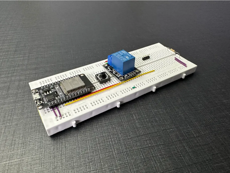

- Push button.
- 5V single-channel relay module.

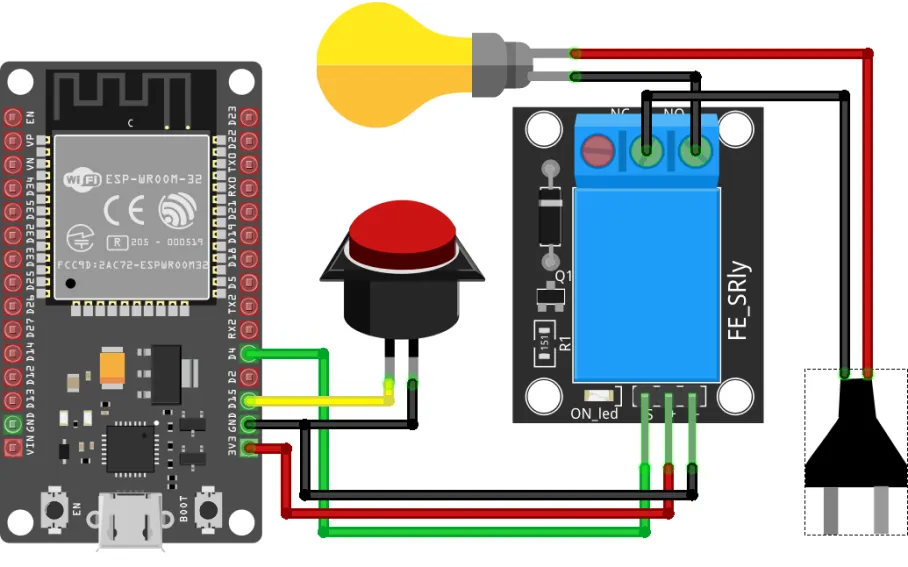

From ESP32 to Soil Moisture Sensor
| ESP32 | Push Button |
| GND | Terinal no.1 |
| D15 | Terinal no.2 |
From ESP32 to Relay:
| ESP32 | Relay |
| VCC | VCC |
| GND | GND |
| D4 | S |
From Relay to Bulb & 220VAC Mains:
| Relay | Bulb | 220AC |
| COM | NA | Neutral |
| NO | 1st terminal | NA |
| NA | 2nd terminal | Phase |

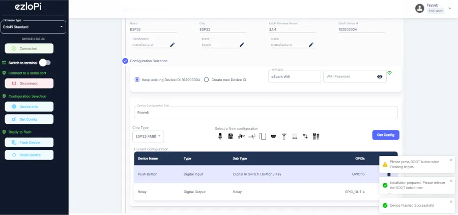

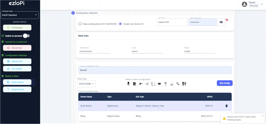

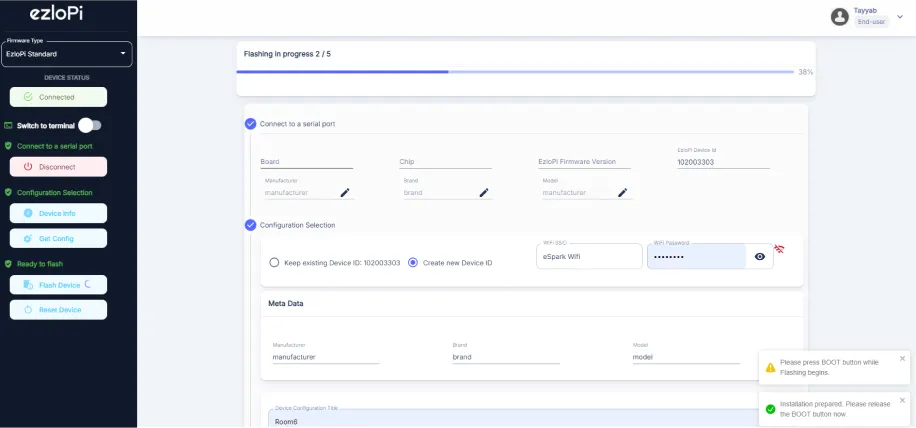

4. Interfacing the Push Button & relay using the EzloPi Web Flasher
Click Connect

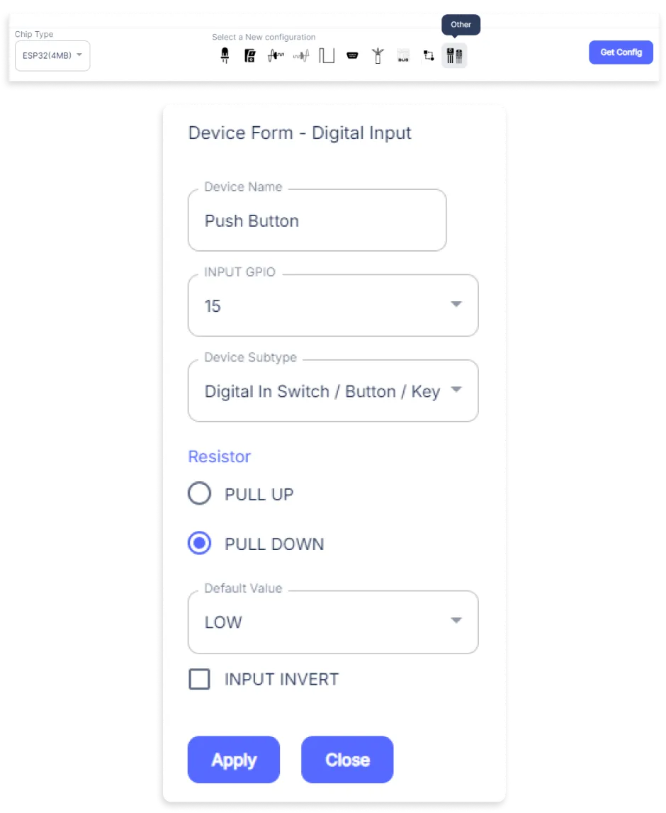

- A Digital Input window will open for inputting the following parameters:
- Set a device name of your choosing. In our case we set it to Push Button.
- Set the Input GPIO to 15.
- Set Device Subtype to Digital In Switch / Button / Key.
- Set the Resistor to PULL DOWN.
- Set the Default Value to LOW.
- Then Click Apply Button.

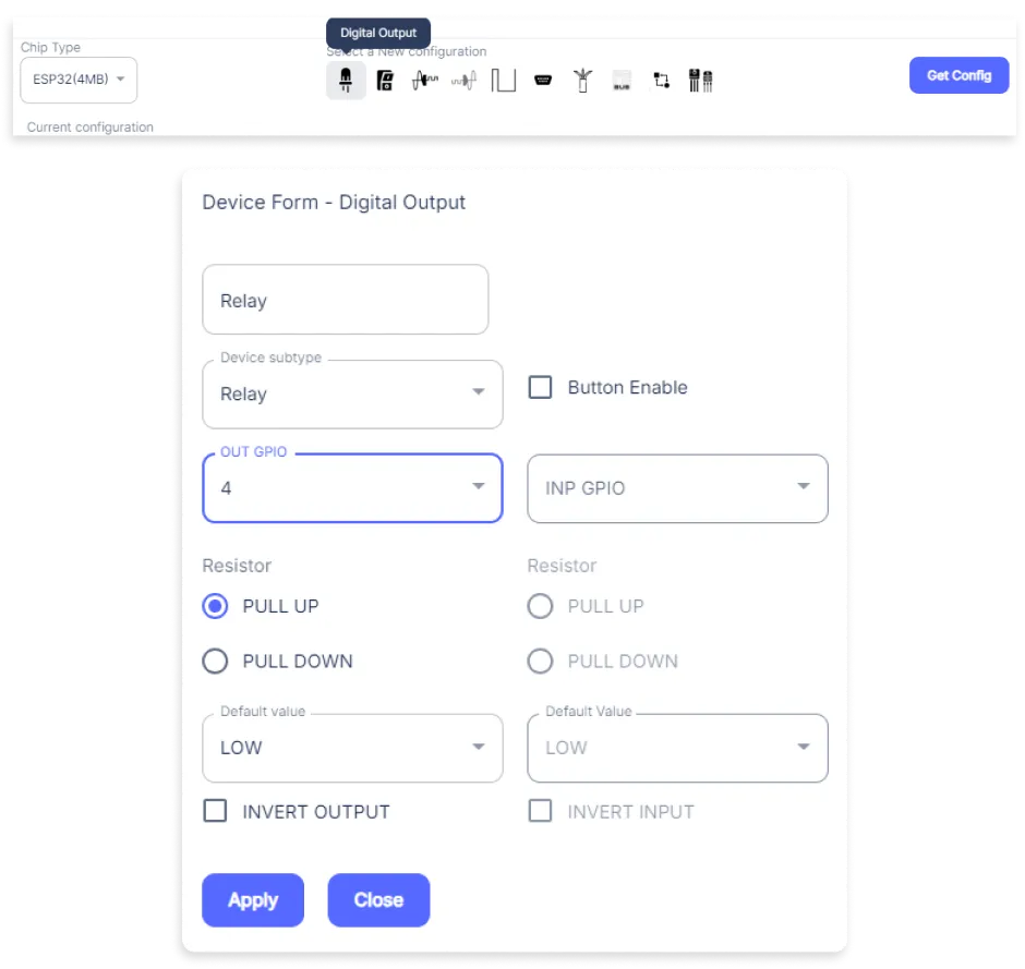

- Set a device name of your choosing. In our case, we set it to Relay.
- Set Device subtype to Relay.
- Set OUT GPIO to 4.
- Set Resistor to PULL UP.
- Set the default value to LOW.

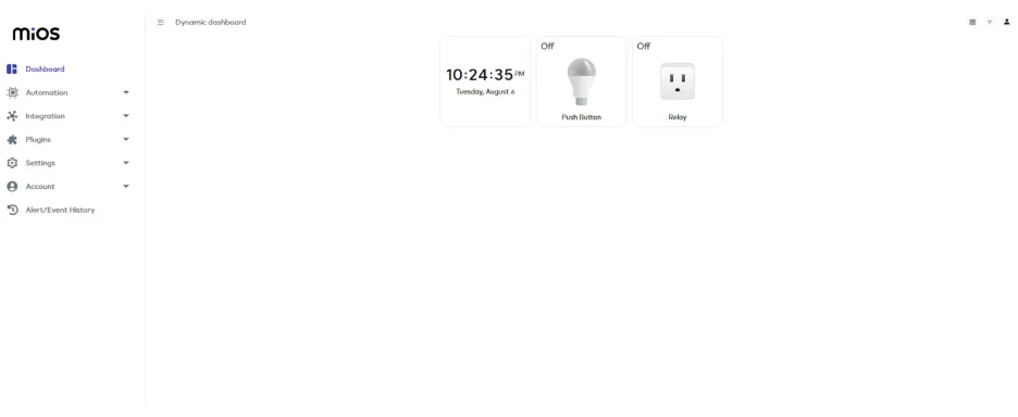

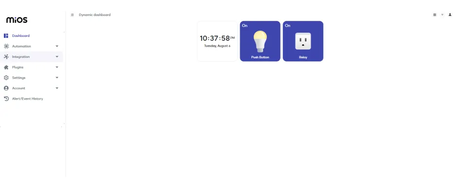

5. MiOS Web Dashboard
- On the MiOS web dashboard, you will be able to see the tile for the push button and the relay. The tile will indicate the status of the relay depending on the push button being operated.

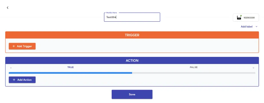

- After clicking on Create new MeshBot, you will see this now under Automation MeshBot click on Local.
- On the next screen you will see that we can create a name of our choosing, in this case we write it as Test004.

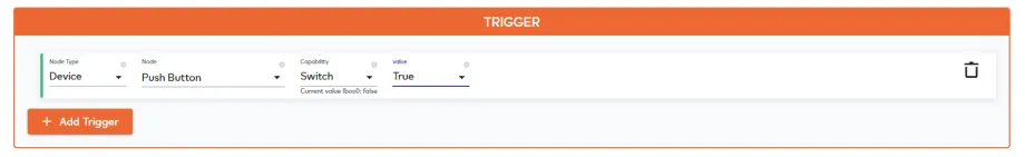

- Set Node Type to Device.
- Set the Node to Push Button.
- Set the Category to Switch.
- Set the value to True.

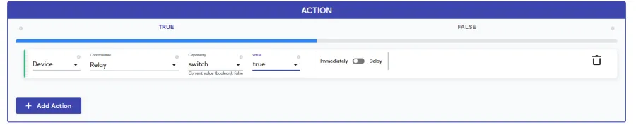

- Set Controllable Type to Device.
- Set the Controllable to Relay.
- Set the Capability to switch.
- Set the Value to true.
- Now Click the Save button.
- Set the Value to false.
- In the MiOS web dashboard, you can see that when the push button is operated, the relay is triggered or turned ON resulting in the AC lamp to turn ON because of the rules we have set in meshbot.

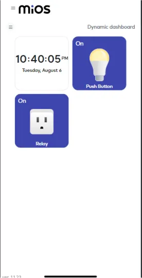

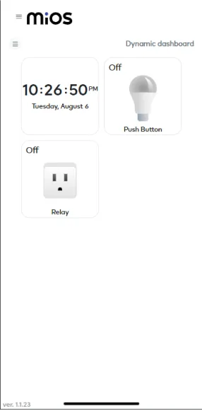

6. MiOS App
- Now, on the MiOS mobile dashboard, you will be able to see the tile for the push button and the relay. Both will function according to rules we have set in meshbot.
- Here, in the MiOS mobile dashboard, you can see that when the push button is operated, the relay is triggered which turns ON the lamp because of the rules we have set in meshbot.
