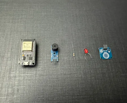

- TTP223B Touch sensor.
- LED with a current limiting resistor of 100 Ohms.

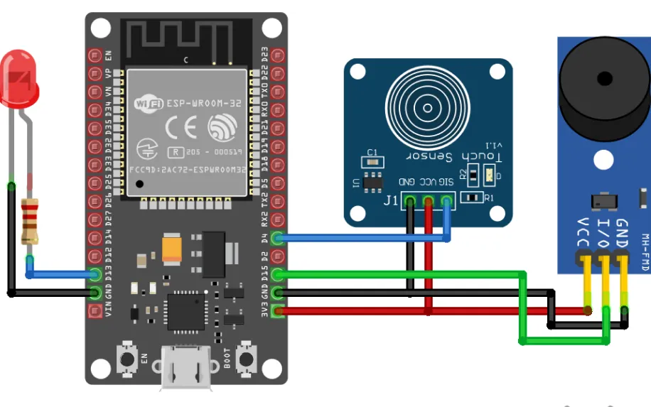

MH-FMD BuzzerThe wiring diagram of ESP32 30 pin is represented as follows:
From ESP32 to the TTP223B Touch Sensor:
| ESP32 | TTP223B |
| 3V3 | VCC |
| GND | GND |
| D4 | SIG |
From ESP32 to the Buzzer:
| ESP32 | Buzzer |
| 3V3 | VCC |
| GND | GND |
| D15 | I/O |
From ESP32 to the LED & Resistor:
| ESP32 | LED | Resistor |
| D13 | - | Terminal no.1 |
| GND | Cathode | - |
| - | Anode | Terminal no.2 |

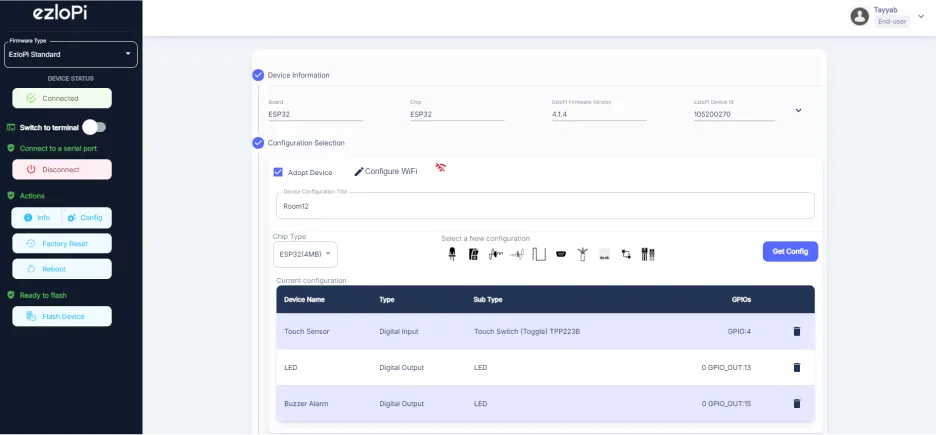

4. Interfacing the TTP223B Touch Sensor, Buzzer and LED using the EzloPi Web Flasher
Click Connect

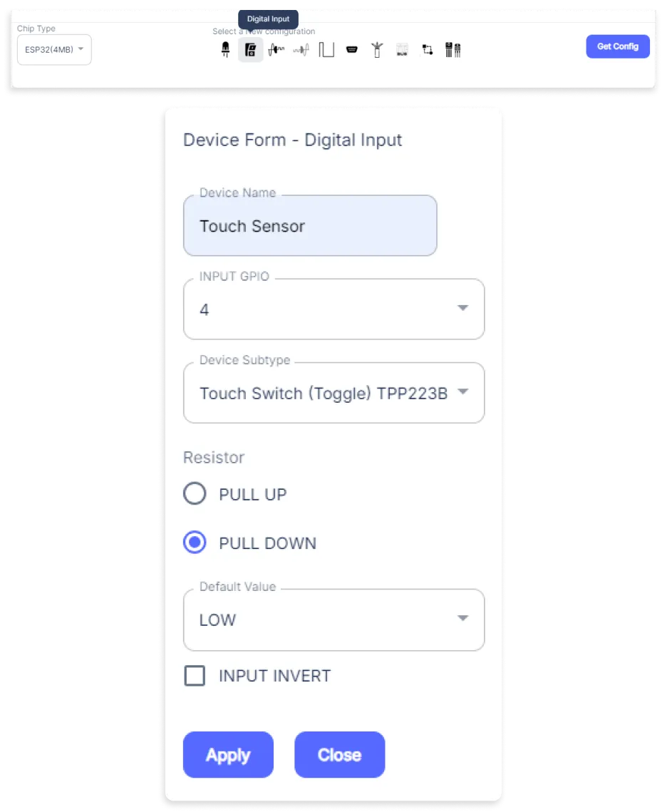

- A Digital Input window will open for inputting the following parameters:
- Set a Device name of your choosing. In our case we set it to Touch Sensor.
- Set the Input GPIO to 4.
- Set Device Subtype to Touch Switch (Toggle) TPP223B.
- Then Click Apply Button.

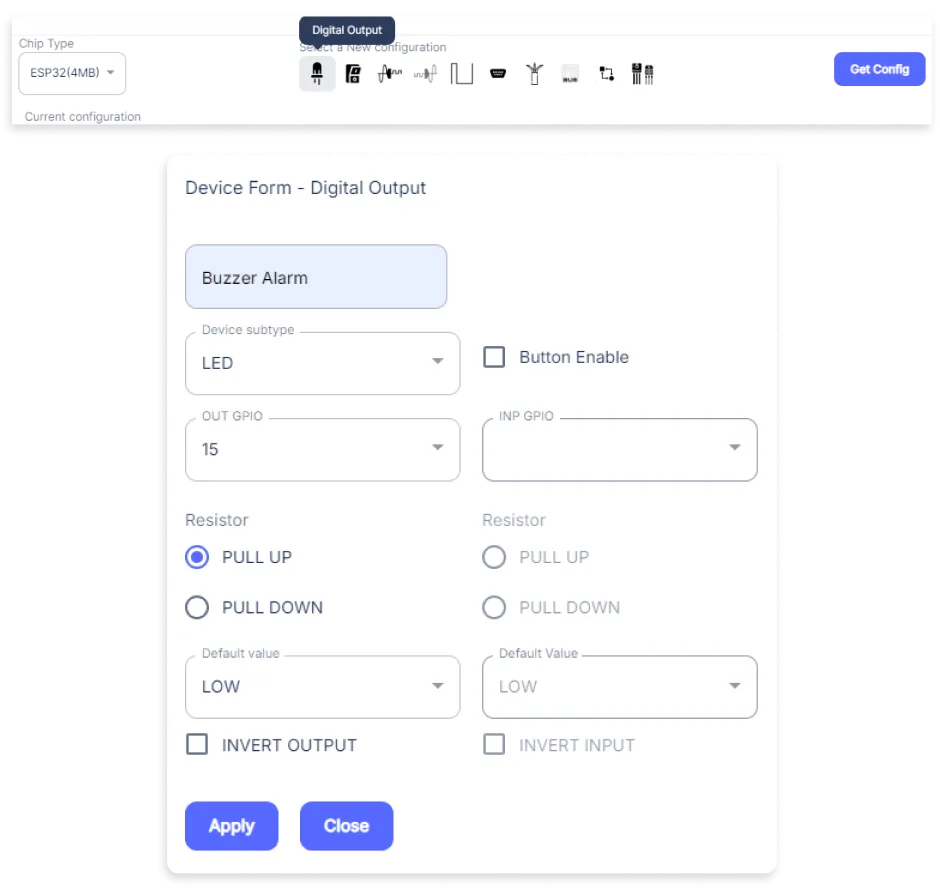

- Set a Device name of your choosing. In our case, we set it to Buzzer Alarm.
- Set Device subtype to LED.
- Set OUT GPIO to 15.
- Set Resistor to PULL UP.
- Set the Default value to LOW.

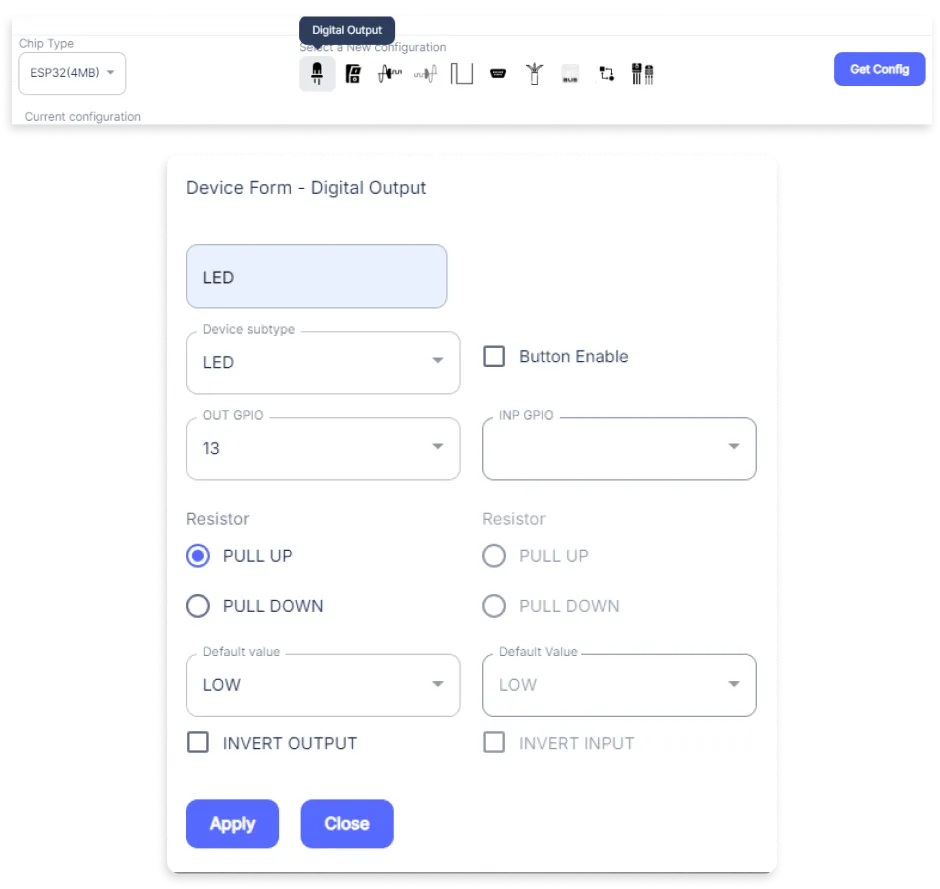

- A window will be opened for inputting the following parameters:
- Set a Device Name of your choosing. In our case, we will set it to LED.
- Set the Device Subtype to LED.
- Set OUT GPIO to 13.
- Set the Resistor to PULL UP.

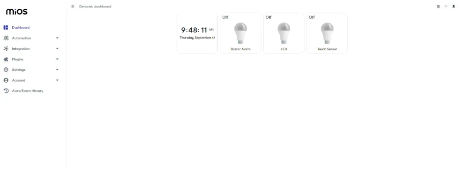

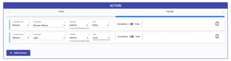

5. MiOS Web Dashboard

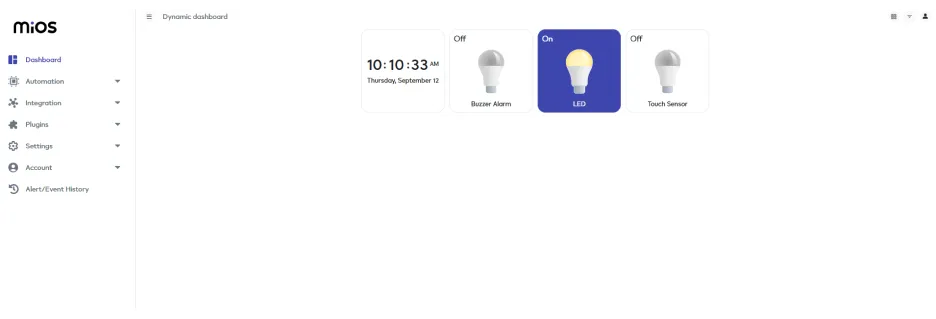

- Now, on the MiOS web dashboard, you will see the tiles of your connected devices as shown above labeled as touch sensor, buzzer alarm and LED. Currently, the touch sensor is not triggered/operating, therefore the Buzzer and LED tiles are shown as OFF.

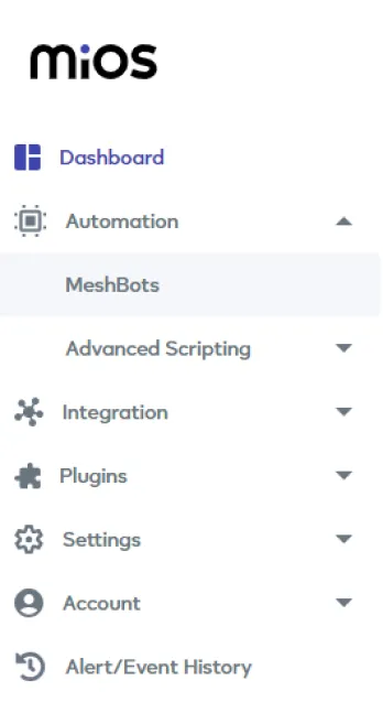

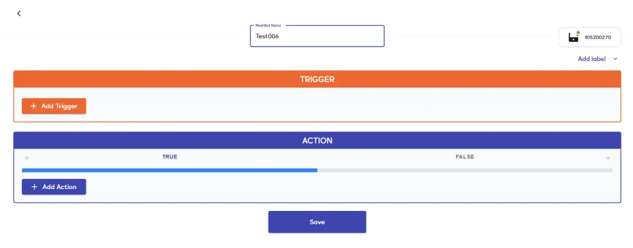

MeshBots:

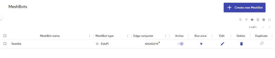

- After clicking on Create new MeshBot, you will see this now under Automation MeshBot click on EzloPi.
- On the next screen you will see that we can create a name of our choosing, in this case we write it as Test006.
- Set Node Type to Device.
- Set the Node to Touch Sensor.
- Set the Capability to Switch.
- Set the Armed State to any.
- Set the value to True.

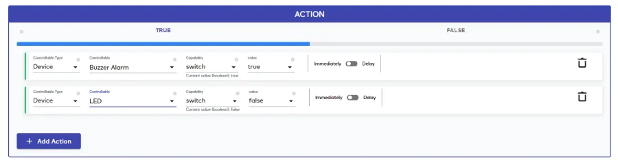

- Set Node type to Device.
- Set Controllable to Buzzer Alarm.
- Set Capability to switch.
- Set Value to true.
- Add another Node to the Action section.
- Set Controllable to LED.
- Set Value to false.
- After clicking the apply button you can see a table of your setting in the Current configuration tab.

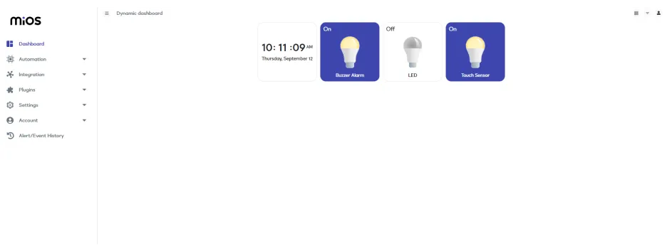

- Now in the above pic, It shows that when the touch sensor turns ON, the Buzzer alarm also turns ON and LED goes OFF, If the motor were also interfaced, it would have also turned OFF according to rules we have set in the meshbot.

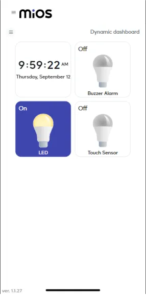

6. MiOS App

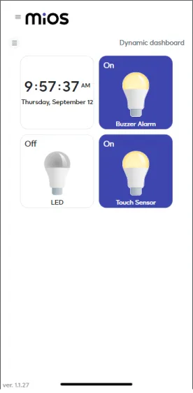

- After opening the MiOS mobile dashboard, you will see the tiles of your connected devices as shown above labeled as Touch sensor, Buzzer Alarm and LED. It shows that when the touch sensor is not operated then the LED turns ON and Buzzer Alarm remains OFF according to our meshbot setting. We can also use a motor in place of the LED.
