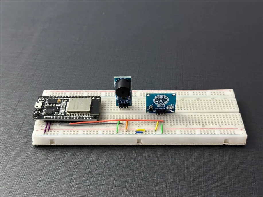

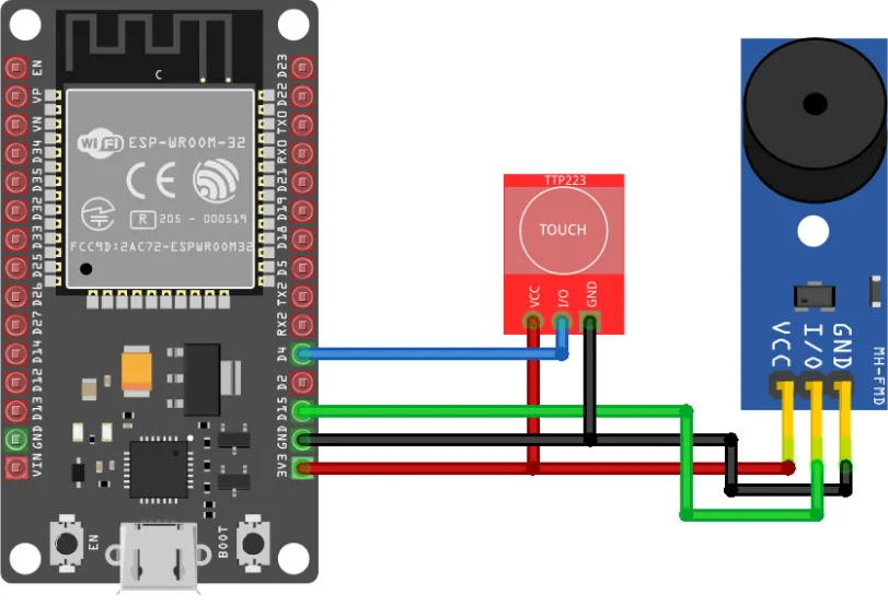

The wiring diagram for ESP32 30 pins is represented as follows:
From ESP32 to Touch Sensor TTP223B
ESP32 | TTP223B |
VCC | VCC |
GND | GND |
D4 | I/O |
From ESP32 to Buzzer
ESP32 | Buzzer |
VCC | VCC |
GND | GND |
D15 | I/O |

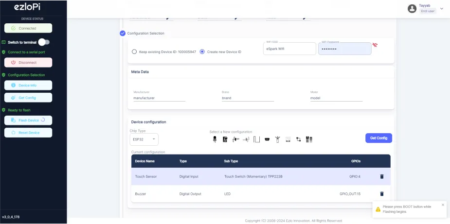

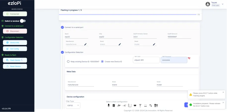

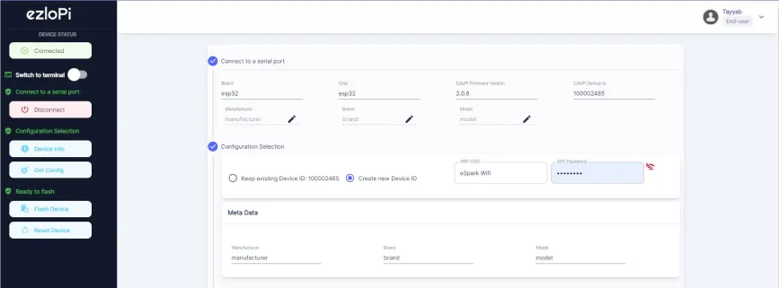

4. Interfacing the Touch sensor & buzzer using the EzloPi Web Flasher
Now, select COM Port to which your ESP32 device is connected. In our case, the COM3 port is used.
Click Connect.

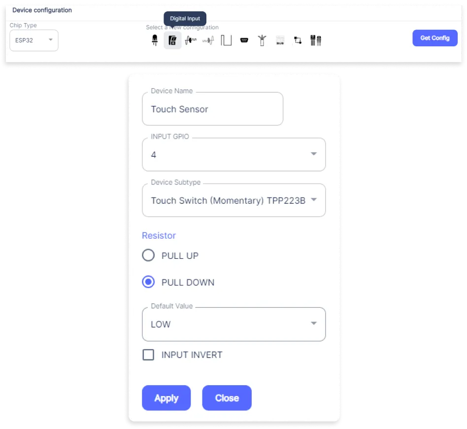

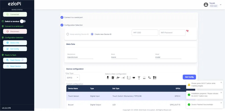

- A Digital Input window will open for inputting the following parameters:
- Set a device name of your choosing. In our case we set it to Touch Sensor.
- Set the Input GPIO to 4.
- Set Device Subtype to Touch Switch (Momentary) TPP223B.
- Now Click the Apply button.

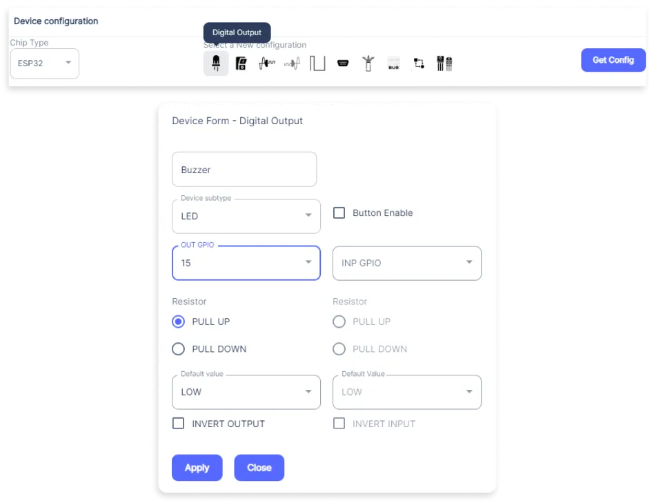

- Set a device name of your choosing. In our case, we set it to Buzzer.
- Set Device subtype to LED.
- Set OUT GPIO to 15.
- Set Resistor to PULL UP.
- Set the default value to LOW.

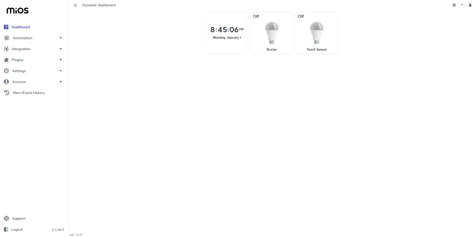

- Now, on the MiOS web dashboard, you will be able to see the tile for the touch sensor and the buzzer. The tile will indicate the status of the buzzer depending on the touch sensor being operated.

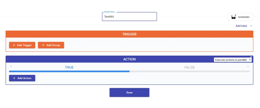

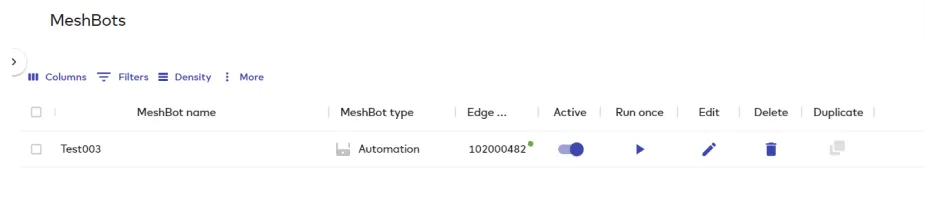

Meshbots

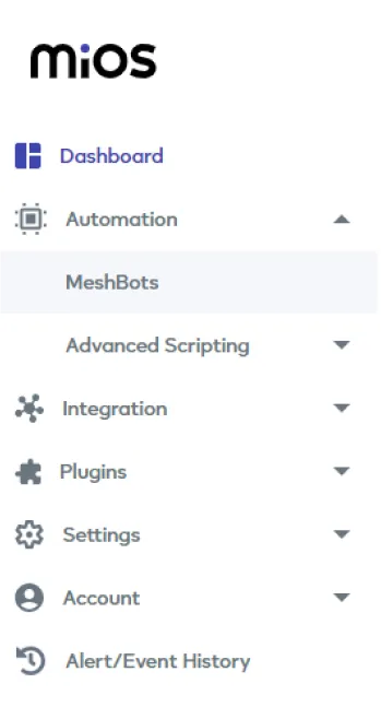

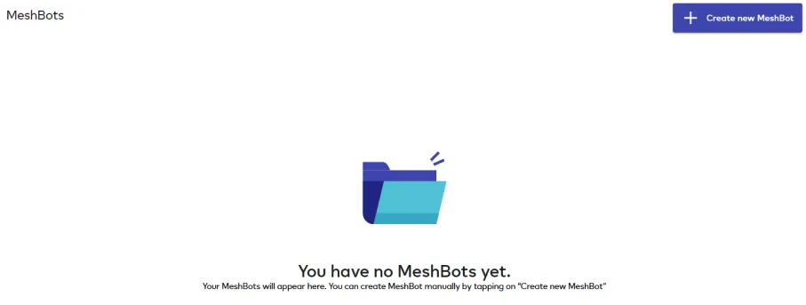

- On the right side of the screen under Automation, click on MeshBots.

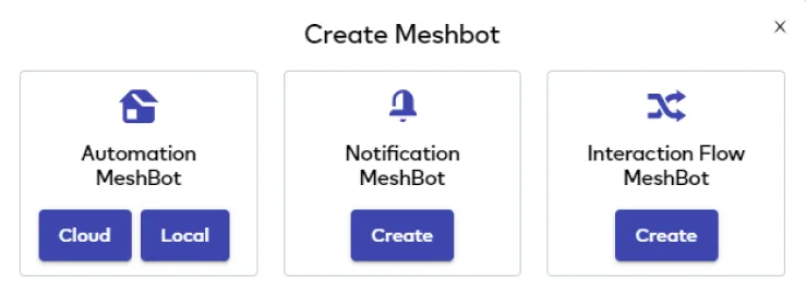

- After clicking on Create new MeshBot you will see this now under Automation MeshBot click on Local.
- On the next screen you will see that we can create a name of our choosing, in this case we write it as Test003.

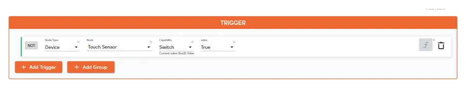

- Set Node Type to Device.
- Set the Node to Touch Sensor.
- Set the Category to Switch.

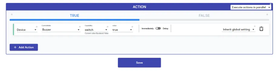

- Set the value to True.
- Set Controllable Type to Device.
- Set the Controllable to Buzzer.
- Set the Capability to switch.
- Set the Value to true.
- Now Click the Save button.
- Set the Value to false.

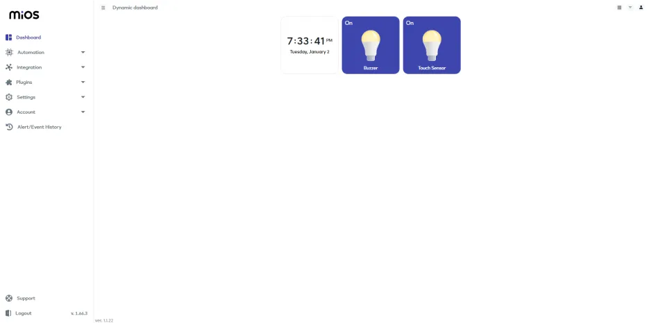

- In the MiOS web dashboard, you can see that when the touch sensor is being given an input in the form of a touch, the buzzer is triggered because of the rules we have set in meshbot.

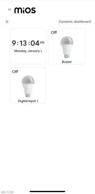

5. MiOS App

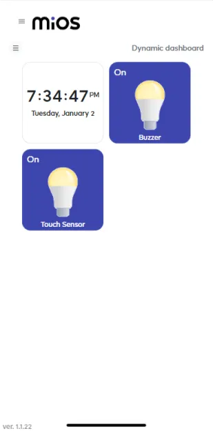

- Now, on the MiOS mobile dashboard, you will be able to see the tile for the touch sensor and the buzzer. Both will be functioning according to rules we have set in meshbot.
- Here, in the MiOS mobile dashboard, you can see that when the touch sensor is being given an input in the form of a touch, the buzzer is triggered because of the rules we have set in meshbot.
