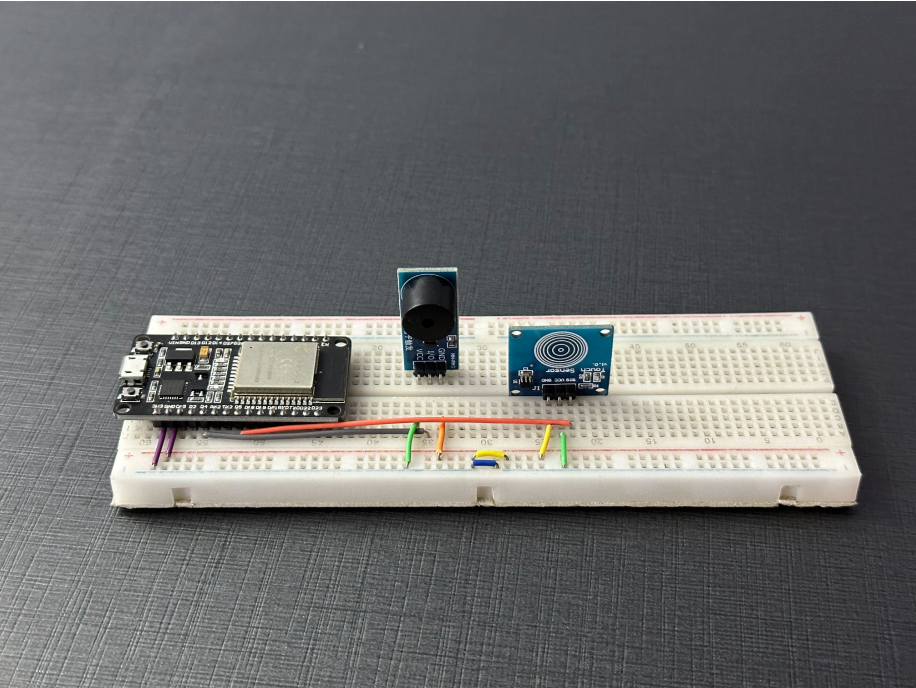

- TTP223B touch sensor.
- Buzzer

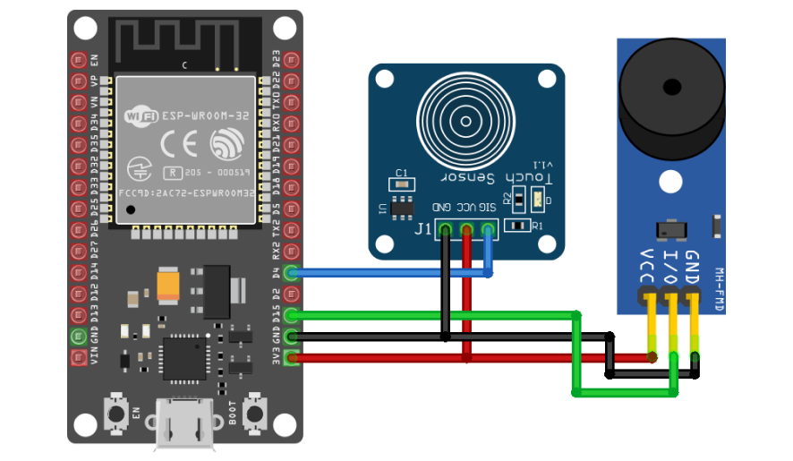

The wiring diagram for ESP32 30 pins is represented as follows:
From ESP32 to Touch sensor TTP223B
From ESP32 to Buzzer

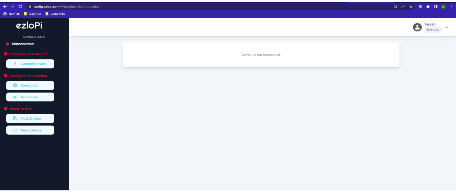

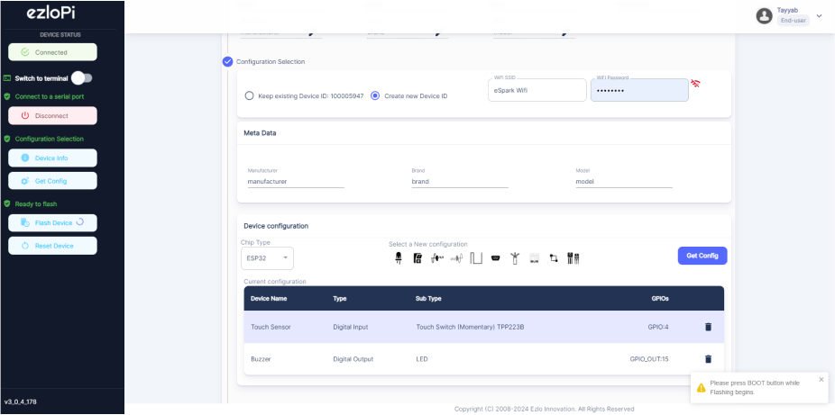

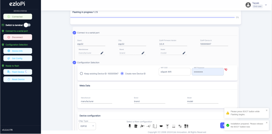

4. Interfacing the Touch sensor and buzzer using the EzloPi Web Flasher

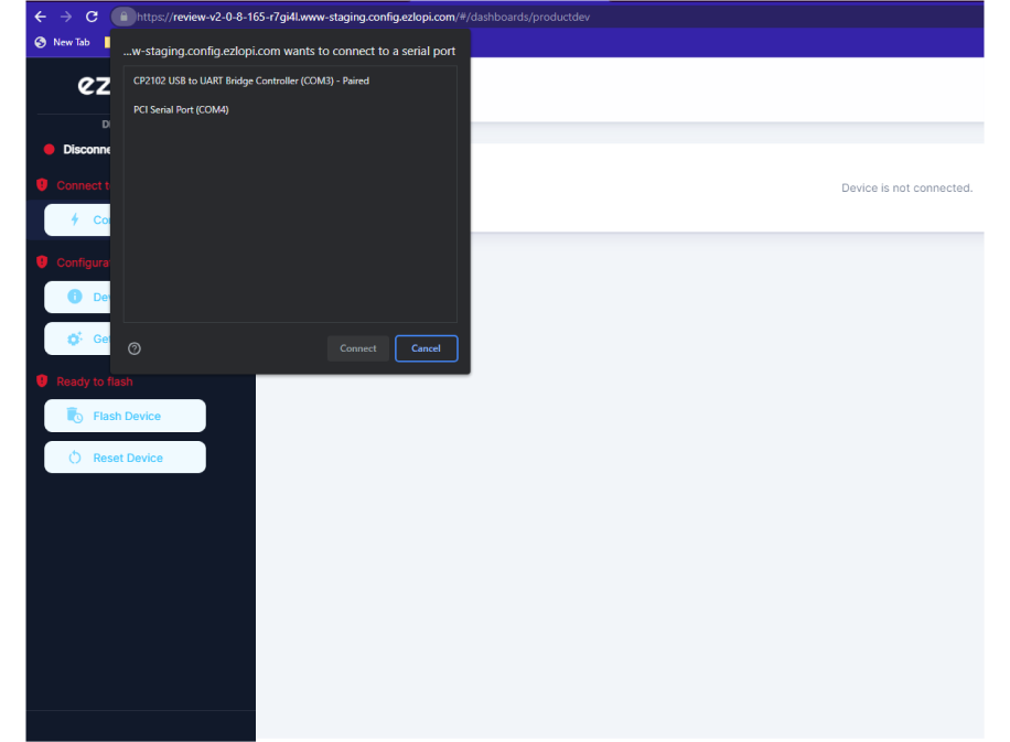

Set up your device/hardware by visiting config.ezlopi.com
Now, select COM Port to which your ESP32 device is connected. In our case, the COM3 port is used.
Click Connect.

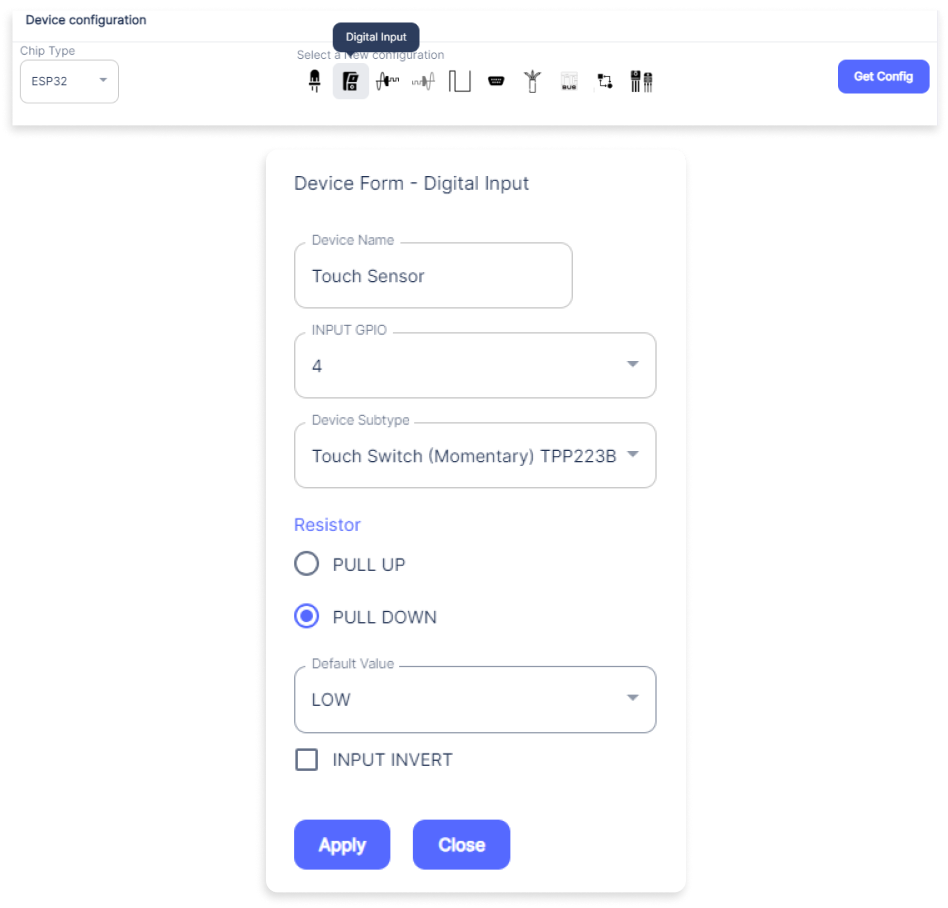

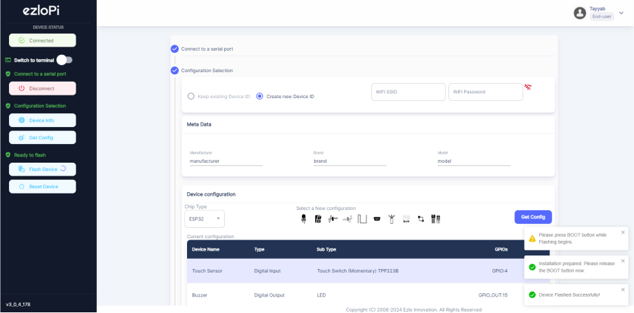

- A Digital Input window will open for inputting the following parameters:
- Set a device name of your choosing. In our case we set it to Touch Sensor.
- Set the Input GPIO to 4.
- Set Device Subtype to Touch Switch (Momentary) TPP223B.
- Now Click the Apply button.

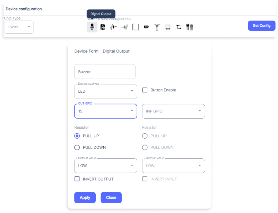

- Again in the Device Configuration, tab click on Digital Output.
- Set a device name of your choosing. In our case, we set it to Buzzer.
- Set Device subtype to LED.
- Set OUT GPIO to 15.
- Set Resistor to PULL UP.
- Set the default value to LOW.
- After clicking the apply button you can see a table of your setting below in the Current configuration tab.

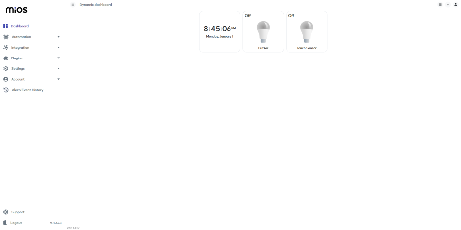

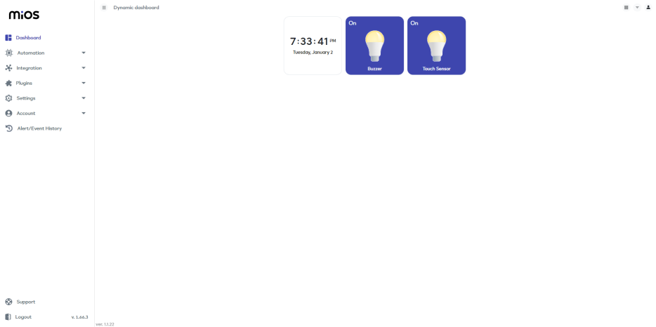

4. MiOS Web Application
- Now, on the MiOS web dashboard, you will be able to see the tile for the touch sensor and buzzer. The tile will indicate the status of the buzzer depending on the touch input being sensed.

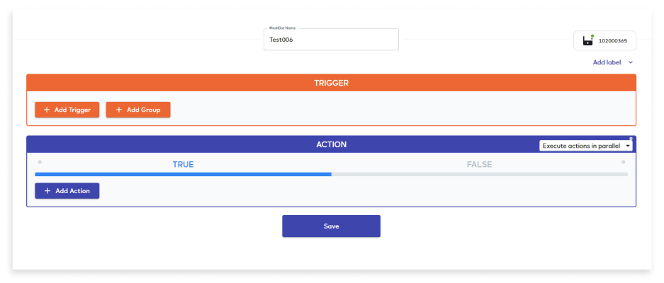

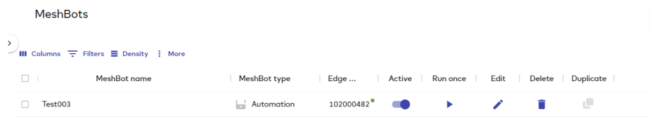

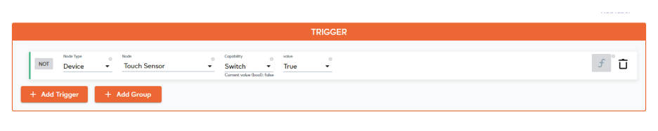

MeshBots:
- On the right side of the screen under Automation, click on MeshBots.
- After clicking on Create new MeshBot you will see this now under Automation MeshBot click on Cloud.
- On the next screen you will see that we can create a name of our choosing, in this case we write it as Test003.
- Set Node Type to Device.
- Set the Node to Touch Sensor.
- Set the Category to Switch.
- Set the value to True.

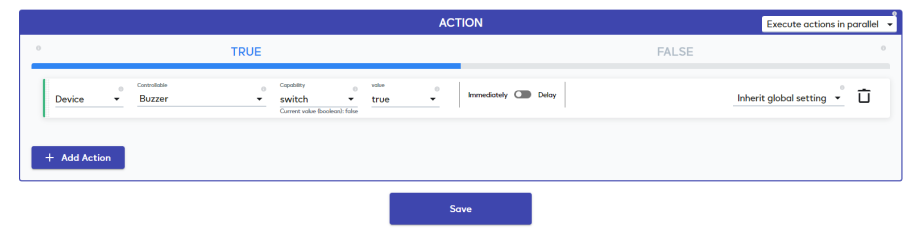

- Set Controllable Type to Device.
- Set the Controllable to Buzzer.
- Set the Capability to switch.
- Set the Value to true.
- Now Click the Save button.

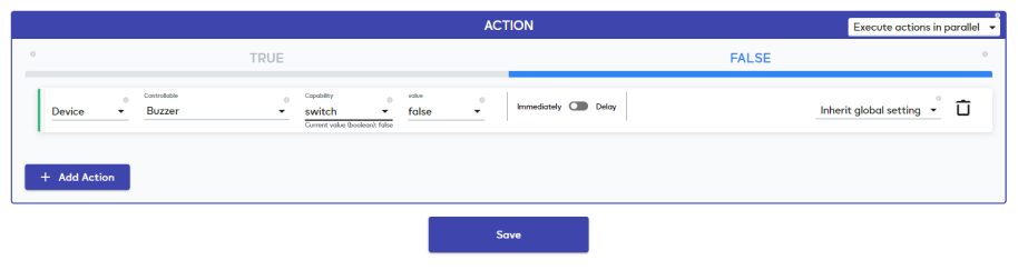

- Set the Value to false.

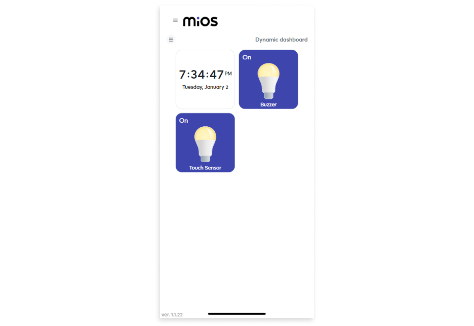

- Now, you can see in the MiOS web dashboard that when the touch sensor is being touched. The buzzer turns on because of the rules we have set in meshbot. When the touch sensor is touched again, the buzzer will turn off.

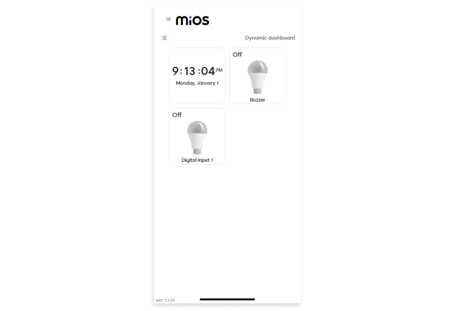

5. MiOS App
- Now, on the MiOS mobile dashboard, you will be able to see the tile for the touch sensor and buzzer. They will function according to rules we have set in meshbot.
- Now, you can see in the MiOS mobile app dashboard that when the touch sensor is being touched. The buzzer turns on because of the rules we have set in meshbot. When the touch sensor is touched again, the buzzer will turn off.
