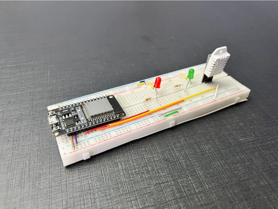

This project involves creating a temperature monitoring system using the DHT22 sensor and the EzloPi device. This project reads temperature data from the DHT22 sensor and controls two LEDs (green and red) based on the temperature levels. The green LED lights up when the temperature is within a safe range, indicating normal conditions, while the red LED activates if the temperature exceeds a predefined threshold, signaling a warning. This project setup provides a visual indication of environmental temperature changes, making it suitable for smart home monitoring, basic climate monitoring and safety applications.
Welcome to the project demonstration video section. The following video showcases the key aspects of Temperature monitoring with DHT22 and LEDs, providing a visual walkthrough of its implementation.
- DHT22 temperature & humidity sensor.
- Two LEDs
- Two 100 Ohm Resistors.
From ESP32 to DHT22:
| ESP32 | DHT22 |
| 3V3 | VCC |
| GND | GND |
| D15 | Data-Signal |

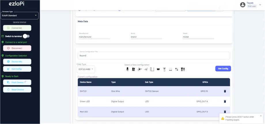

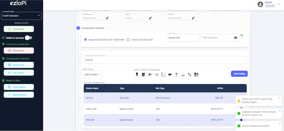

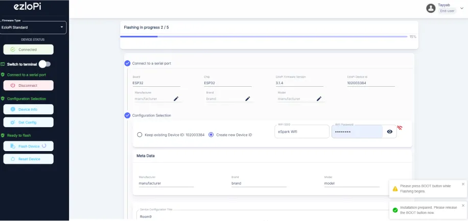

4. Interfacing the DHT22 and Two LEDs with EzloPi Web Flasher
Click Connect

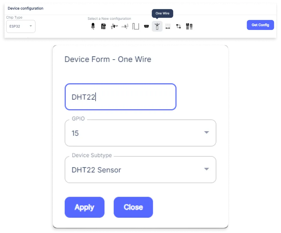

- In the Device Configuration, tab click on One Wire.
- A One Wire window will open for inputting the following parameters:
- Set a device name of your choosing. In our case, we set it to DHT22.
- Set the GPIO to 15.
- Set Device Subtype to DHT11 Temperature & Humidity Sensor.
- Then Click Apply Button.
- Set a device name of your choosing. In our case, we set it to Green LED.
- Set Device Subtype to LED.
- Set the OUT GPIO to 4.
- Set the Resistor to PULL UP.
- Press the Flash Device button.i>

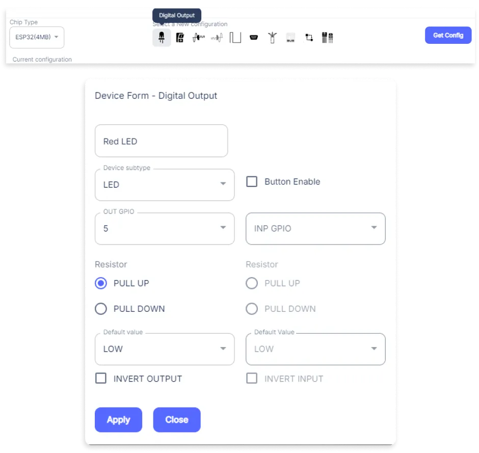

- Again, In the Device Configuration, tab click on Digital Output.
- Set a device name of your choosing. In our case, we set it to Red LED.
- Set the OUT GPIO to 5.

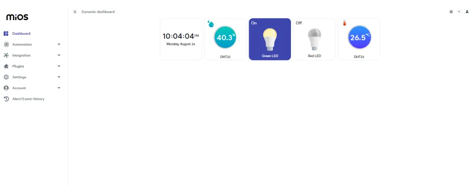

- Now, on the MiOS web dashboard, you will see the tiles of your connected devices as shown above labeled as DHT22 (one for temperature and one for humidity) and Two LEDs (Green & Red LED).
- Currently,DHT22 tiles show temperature and humidity while both LEDs are OFF.

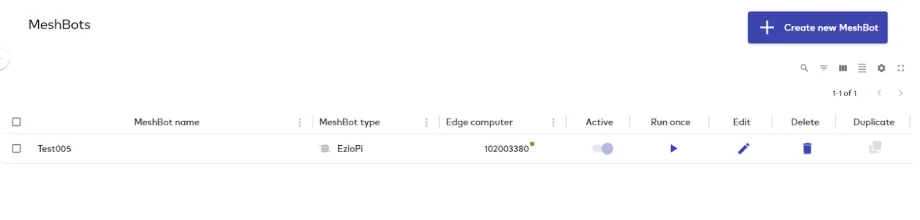

MeshBots:

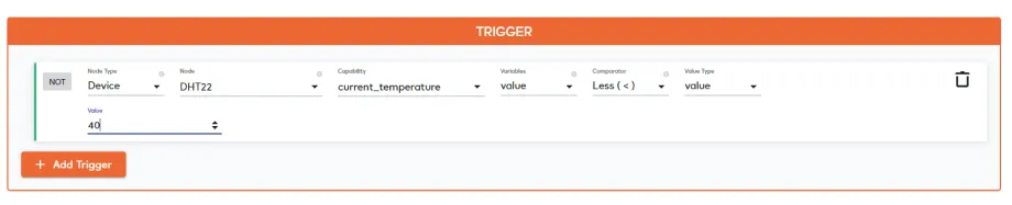

- After clicking on Create new MeshBot, you will see this now under Automation MeshBot click on EzloPi.

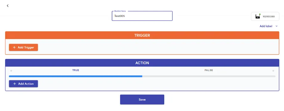

- On the next screen you will see that we can create a name of our choosing, in this case we write it as Test005.
- Set Node Type to Device.
- Set the Node to DHT22.
- Set the Capability to current_temperature.
- Set the variables to value.
- Set the Comparator to Less(<).
- Set the value type to value.
- Set the Value to 40.

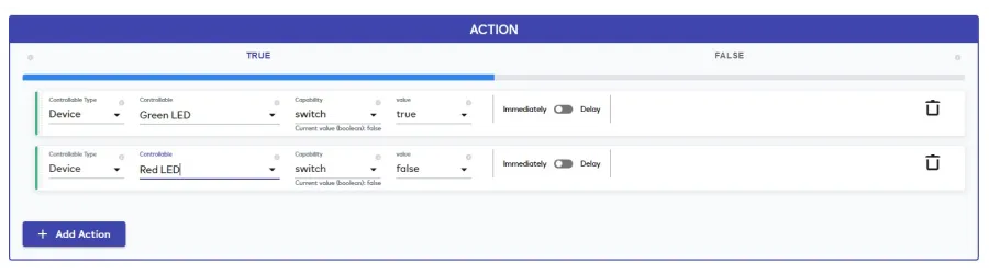

- Set Node type to Device.
- Set Controllable to Green LED.
- Set Capability to switch.
- Set value to true.
- Add another Action in the TRUE part of the ACTION section.
- Set Controllable to Red LED.
- Set value to false.

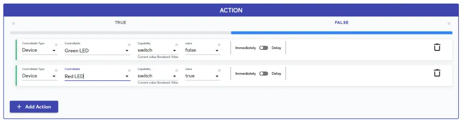

- Add another Action in the FALSE part of the ACTION section.
- After clicking the apply button you can see a table of your setting in the Current configuration tab.
- Now as seen above, it shows that when the temperature is below 40°C irrespective of the humidity, the green LED turns ON and the red LED remains OFF because of the rules we have set in the meshbot.

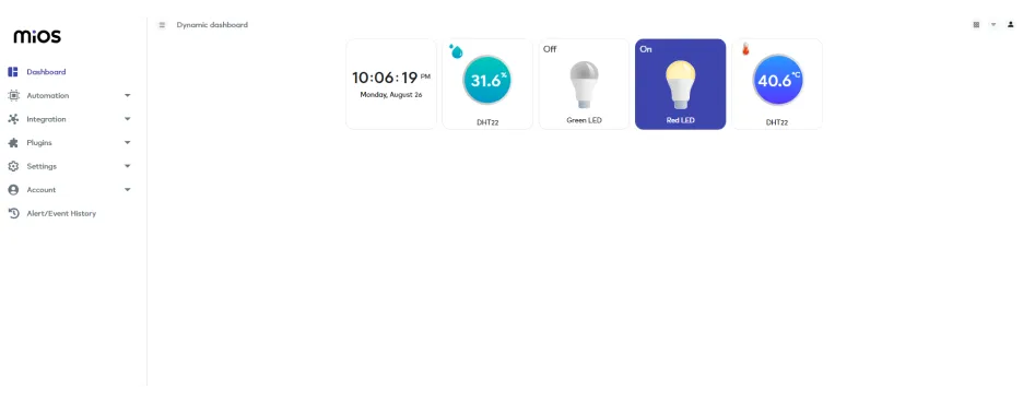

- Now as seen above, it shows that when the temperature reaches above the 40°C threshold, the green LED turns OFF and the red LED turns ON to trigger a warning alert because of the rules we have set in the meshbot.

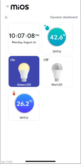

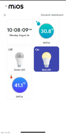

6. MiOS App
