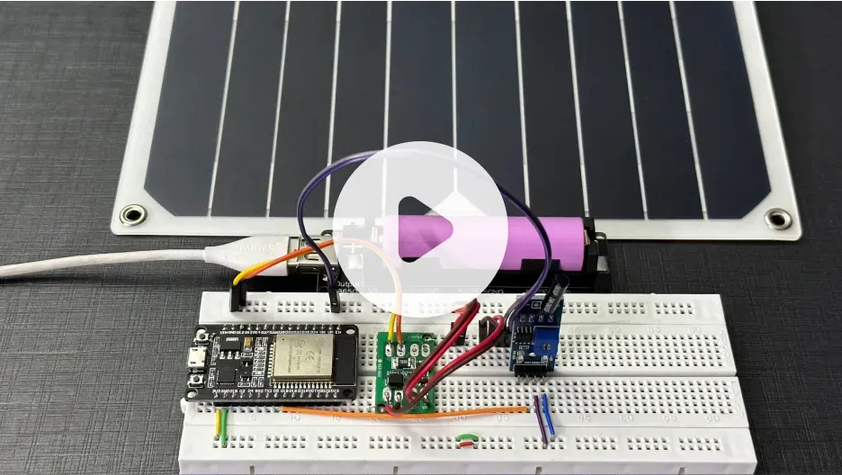

This project aims to develop a robust and efficient light monitoring system using an LDR sensor for light monitoring. This smart monitoring system utilizes solar energy for charging the battery, which also powers the system during periods of low light availability or when solar energy is not available. The system incorporates an LDR (Light Dependent Resistor) analog sensor to detect ambient light levels and adjust its operation accordingly. This integration enables applications such as automated lighting control, energy efficiency optimization, or security systems based on environmental light conditions. Solar panel is also integrated in this project for EzloPi device to work independently without the aid of any external power supply.
Welcome to the project demonstration video section. The following video showcases the key aspects of Solar charged battery powered light monitoring using LDR sensor, providing a visual walkthrough of its implementation.
- LM393 Photoresistor module.
- Solar Panel ZW110X69
- Solar panel Controller HW-150
- 18650 battery
The wiring diagram is represented as follows:
From ESP32 to LDR module:
| ESP32 | LDR |
| 3V3 | VCC |
| GND | GND |
| D33 | A0 |
From Solar panel to Solar controller:
| Solar Panel | Solar Controller |
| Signal + | S+ |
| Signal - | S- |
From 18650 Battery to Solar controller:
| 18650 Battery | Solar Controller |
| + | B+ |
| - | B- |
From ESP32 to Solar controller:
| ESP32 | Solar Controller |
| Vin | L+ |
| GND | L- |
