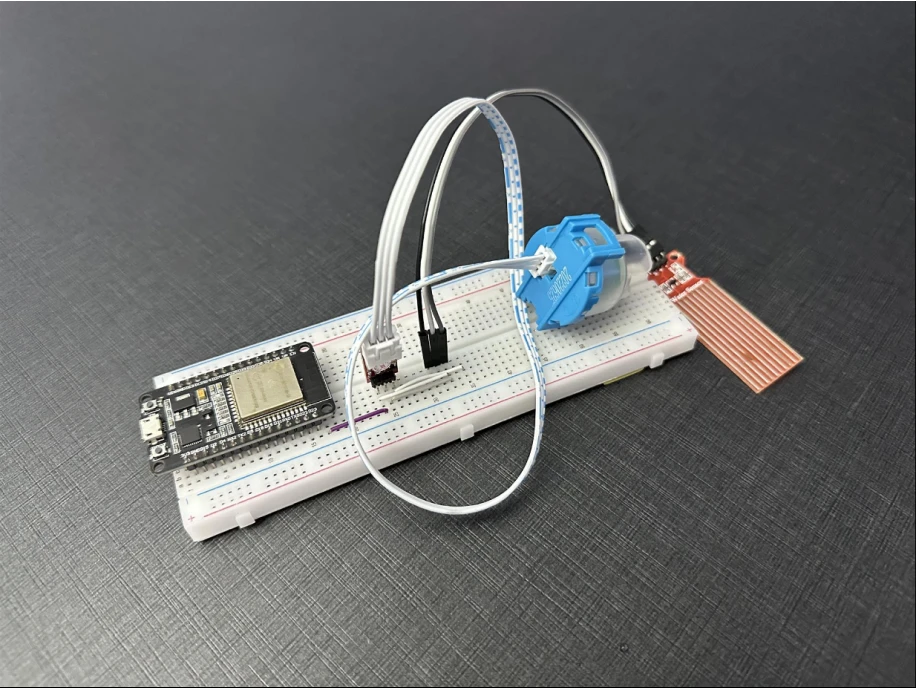

The smart water management system project integrates the TS-300B turbidity sensor and the FC-37 water leak sensor module with the EzloPi device. The TS-300B monitors water quality by detecting turbidity levels, which can indicate contamination or sediment buildup in water systems. The FC-37 sensor provides real-time detection of leaks, helping to prevent water damage when water is detected. Using the EzloPi smart platform, the system can automate water monitoring and leak detection, potentially integrating with other smart devices/sensors for further actions like shutting off water valves or sending notification alerts. This system is ideal for managing water resources efficiently and preventing water wastage.
Welcome to the project demonstration video section. The following video showcases the key aspects of Smart water management system, providing a visual walkthrough of its implementation.

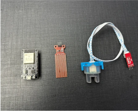

- TS-300B Turbidity sensor, with analog to digital output interface module.
- FC-37 Water leak sensor module.
- LM393 comparator module.

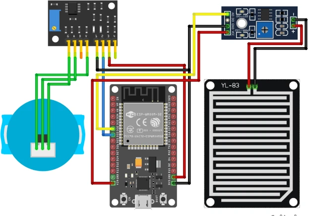

The wiring diagram for the ESP32 30 pin is represented as below:
From ESP32 to Turbidity Sensor Interface Module:
ESP32 | Interface Module |
GND | 1 |
D33 | 2 |
3V3 | 3 |
From Turbidity Sensor to Interface Module:
Turbidity Sensor | Interface Module |
IR | G |
TR | A |
VCC | V |
From ESP32 to the LM393 comparator module:
ESP32 | LM393 comparator module |
VCC | VCC |
GND | GND |
D33 | A0 |
From the LM393 module to the Water leak sensor::
LM393 Comparator Module | Leak Sensor Module |
+(Pin) | POS |
-(Pin) | NEG |

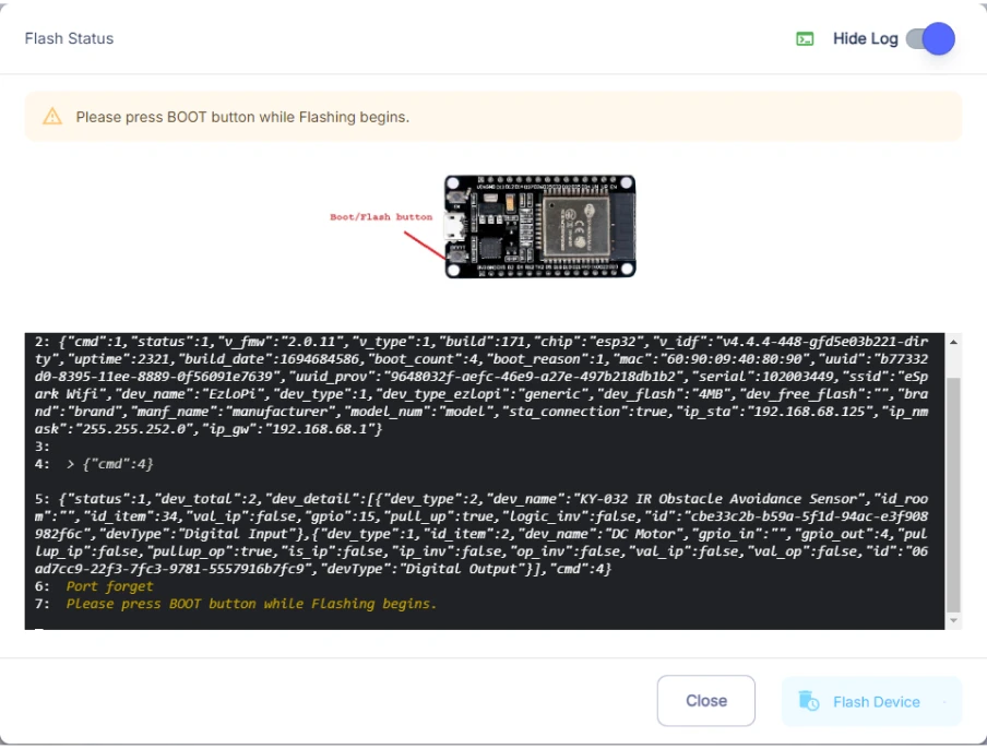

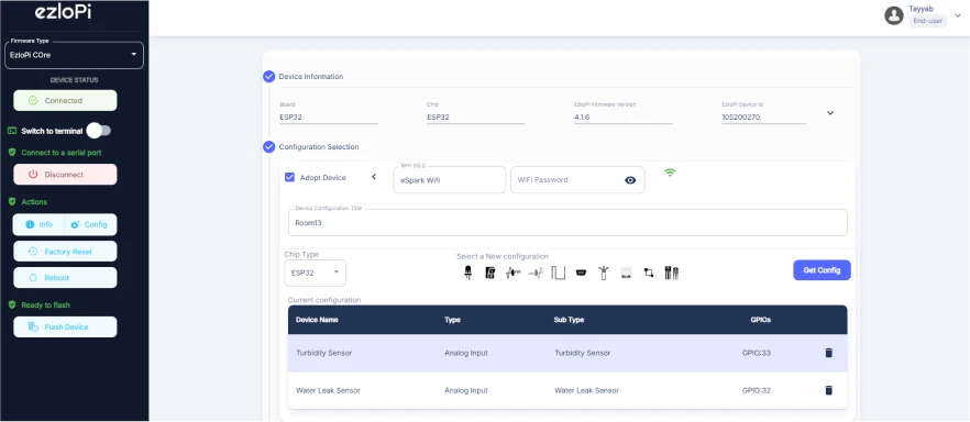

4. Interfacing the Turbidity Sensor & Water Leak Sensor Modules using the EzloPi Web Flasher
Click Connect
- If you are new to this and it's your first time configuring, select Create new Device ID. Click on the Configure Wifi button. Enter Wifi SSID and Wifi Password.

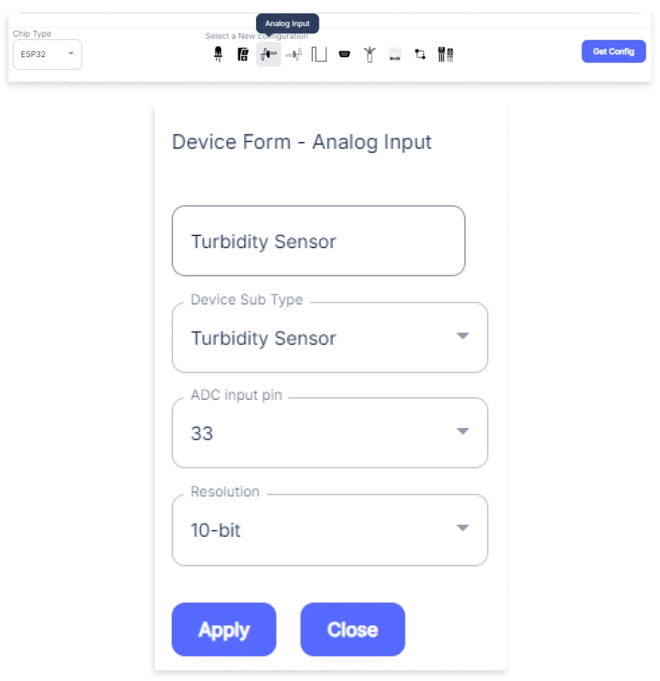

- In the Device Configuration, tab click on Analog Input.
- An Analog Input window will open for inputting the following parameters:
- Set a Device name of your choosing. In our case, we set it to Turbidity Sensor.
- Set Device Subtype to Turbidity Sensor.
- Set the ADC input pin to 33.
- Set the Resolution to 10-bit.
- Then Click Apply Button.

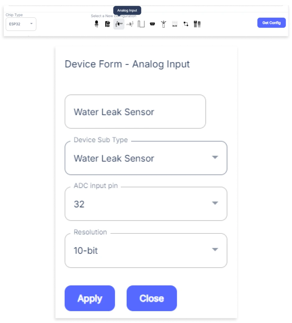

- Again, In the Device Configuration, tab click on Analog Input.
- Set a Device name of your choosing. In our case, we set it to the Water Leak Sensor.
- Set Device Subtype to Water Leak Sensor.
- Set the ADC input pin to 32.

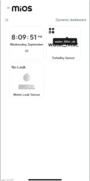

- After opening the MIOS mobile app, you will be able to see the tiles of your connected devices. The turbidity sensor is showing ‘water_filter_ok’ message which means water is clean or has very low impurities while water leak sensor is showing ‘No Leak’ message which means there is no leakage of water.

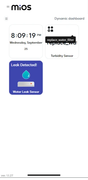

- Now as seen above, the turbidity sensor is displaying a ‘replace_water_filter’ message depicting that water has now become impure and the user needs to replace the filter. The water leak sensor also shows a ‘Leak Detected’ message indicating that there is water leakage in the system.

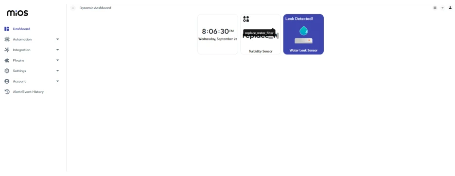

MeshBots:
