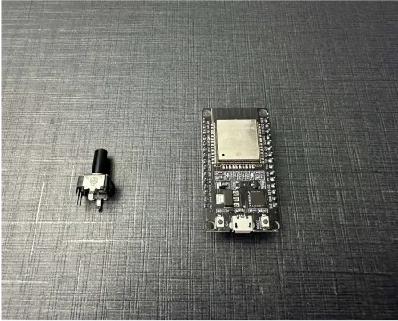

- Vertical 12.5mm shaft potentiometer.

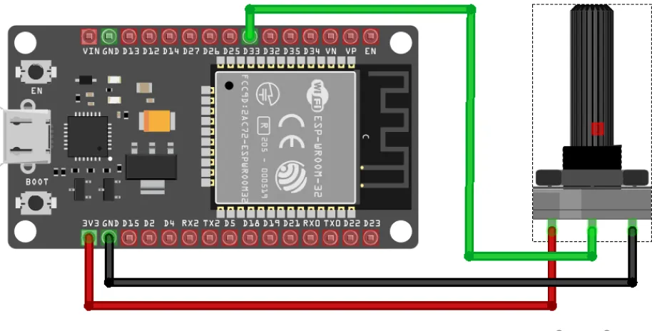

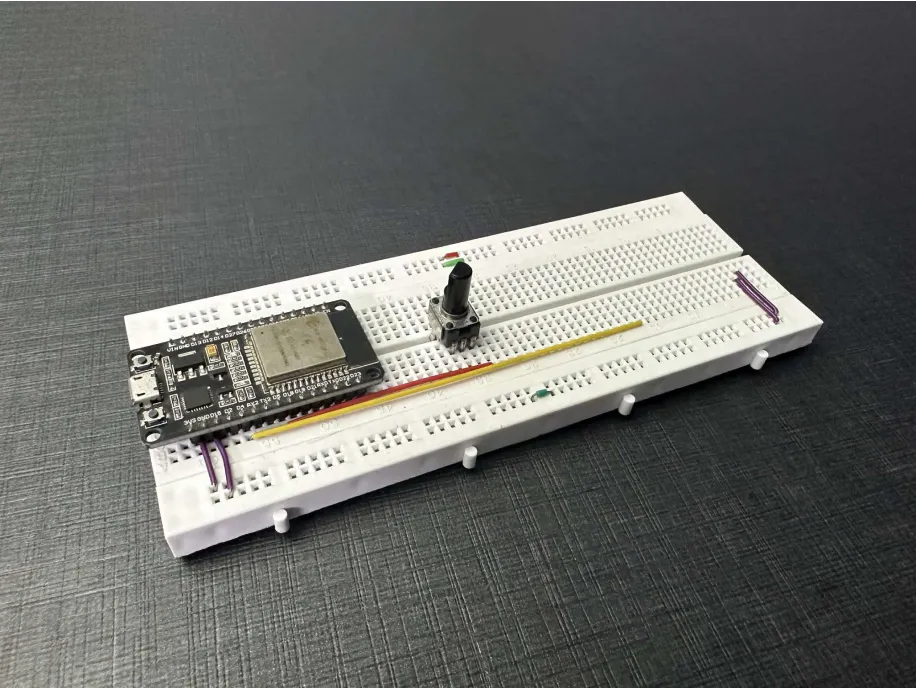

The wiring diagram is represented as follows:
From ESP32 to LDR module:
| ESP32 | Potentiometer |
| 3V3 | 1st Pin |
| GND | 2nd Pin |
| D33 | 3rd Pin |

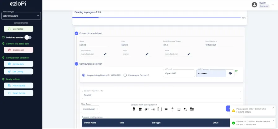

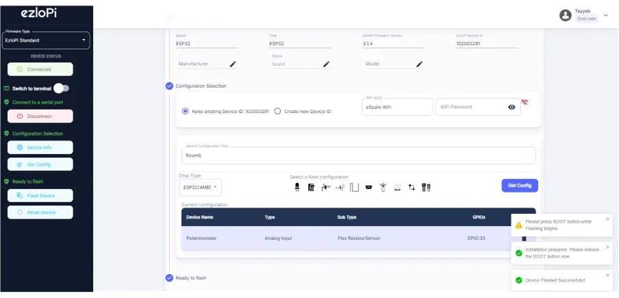

4. Interfacing the variable resistor/potentiometer module using EzloPi Web Flasher
Click Connect

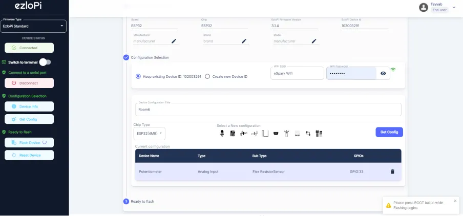

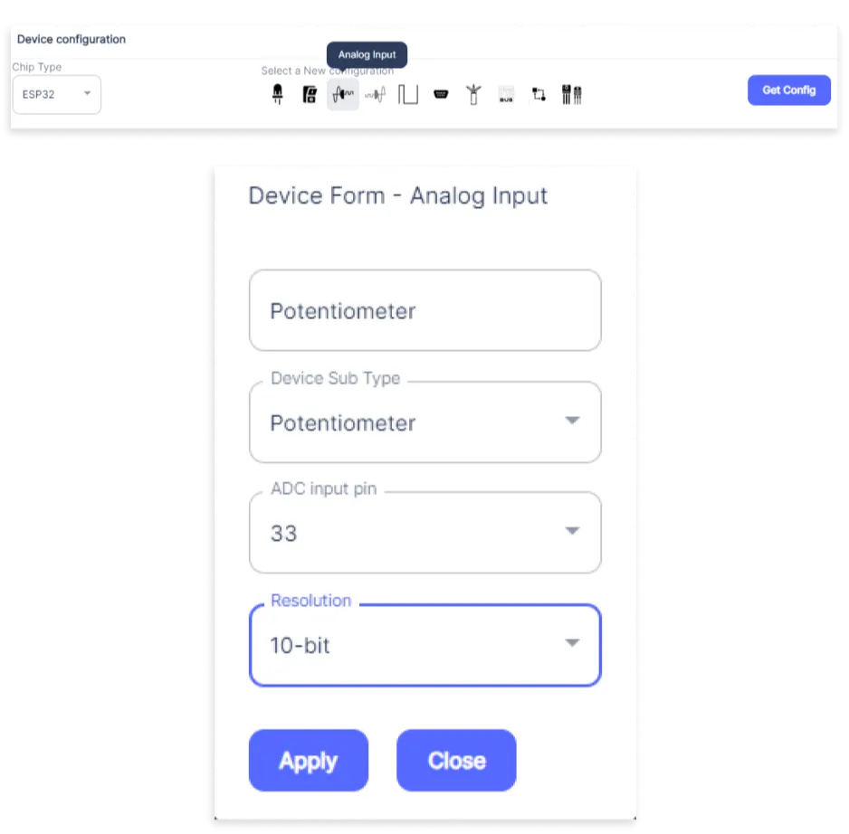

- In the Device Configuration, tab click on Analog Input.
- An Analog Input window will open for inputting the following parameters:
- Set a Device name of your choosing. In our case, we set it to the Potentiometer.
- Set Device subtype to Potentiometer.
- Set OUT GPIO to 33.
- Set Resolution to 10-bit.
- Then Click Apply Button.

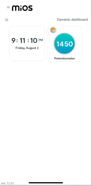

5. MiOS App
- After opening the mobile dashboard, you will be able to see the tile of your connected device. The potentiometer is currently showing the resistance which is set at the moment, the value can be easily changed by turning the knob and its updated resistance value will be displayed on the tile.
- When we turn the knob of the potentiometer clockwise or anti-clockwise, its value will increase or decrease.
