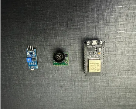

The smart street lights system project uses the EzloPi device to automate street lighting based on the environmental conditions. This project incorporates an MB1013 sonar sensor to detect the presence of vehicles or pedestrians, while the LM393 photoresistor (LDR) module measures ambient light levels. When low light conditions are detected by the LDR, the system prepares to activate the streetlights. However, the lights are only switched on when the sonar sensor identifies motion, ensuring energy-efficient lighting. This dynamic, sensor-driven control minimizes power consumption and reduces unnecessary light pollution, making it ideal for urban and rural settings.
- MB1013 sonar sensor module.
- LM393 Photoresistor Module(LDR).

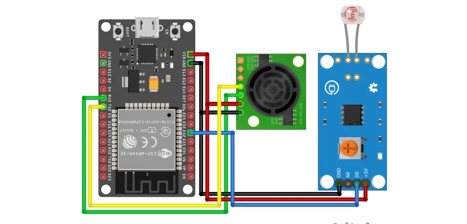

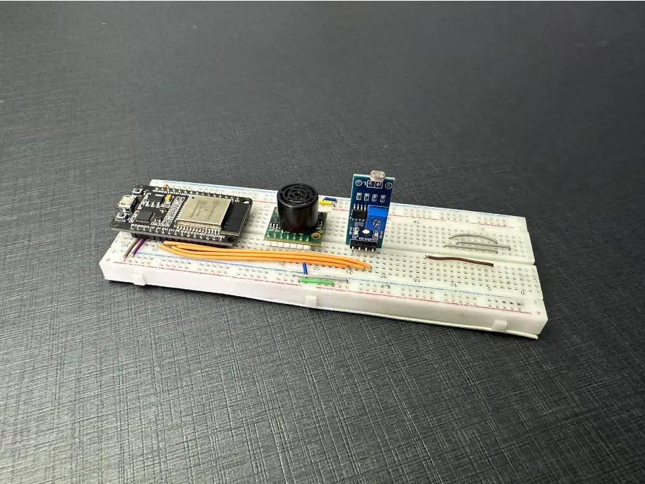

The wiring diagram for the ESP32 30 pin is represented as below:
From ESP32 to the MB1013 module:
ESP32 | MB1013 |
VIN | VCC |
GND | GND |
D16 (RX) | Tx |
D17 (TX) | Rx |
From ESP32 to the LDR module:
ESP32 | LDR |
VIN | +5V |
GND | GND |
D32 | D0 |

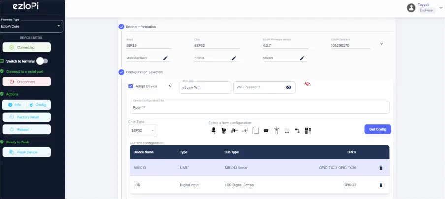

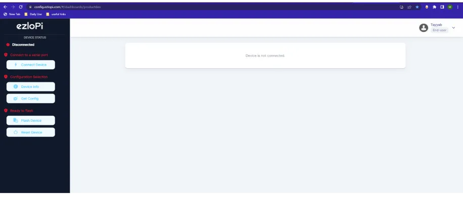

4. Interfacing the MB1013 Sonar sensor module with LDR using the EzloPi Web Flasher
Click Connect
- If you are new to this and it's your first time configuring, select Create new Device ID. Click on the Configure Wifi button. Enter Wifi SSID and Wifi Password.

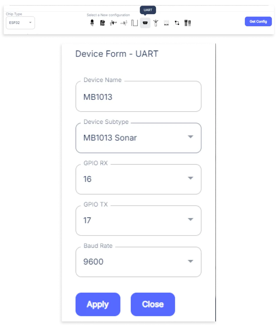

- In the Device Configuration, tab click on UART.
- A window will open for inputting the following parameters:
- Set a Device name of your choosing. In our case, we set it to Sonar Sensor.
- Set Device subtype to MB1013.
- Set GPIO RX to 16.
- Set GPIO TX to 17.
- Set Baud Rate to 9600.
- Then Click Apply Button.

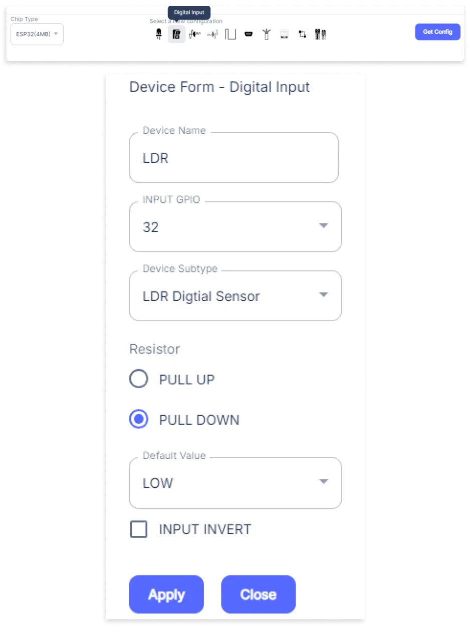

- Again, In the Device Configuration, tab click on Digital Input.
- A Digital Input window opens for inputting the following parameters:
- Set a Device name of your choosing. In our case, we set it to LDR.
- Set INPUT GPIO to 32.
- Set Device subtype to LDR Digital Sensor.
- Set the Resistor to PULL DOWN.

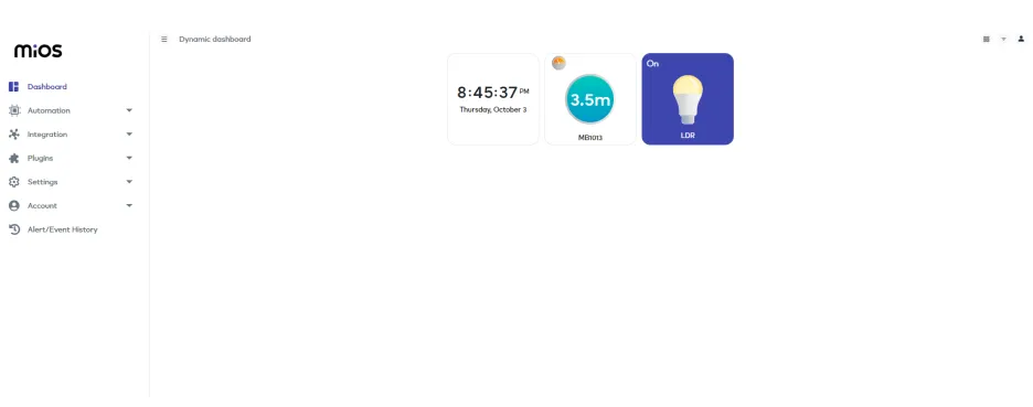

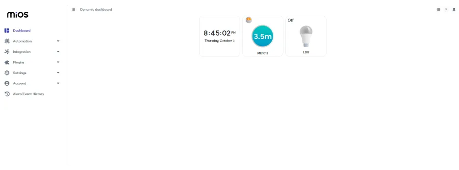

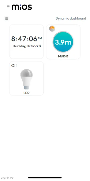

5. MiOS App
- Here, as seen in the MiOS mobile app above, we can see the MB1013 sonar sensor and LDR tiles. The above figure depicts the street light scenario where cars or people are moving on the road so the MB1013 measures distance of the objects from itself whereas LDR gives the indication of light. In above picture, the MB1013 sensor shows distance whereas LDR showing that there is light present.

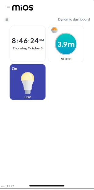

- Here, it can be seen that now LDR is turned because it depicts that there is less or no light whereas MB1013 shows distance from any object. By utilizing these sensors, we can control street lights easily and conserve energy.
6. MiOS Web Dashboard
- Here, as seen in the MiOS web app above, we can see the MB1013 sonar sensor and LDR tiles. The above figure depicts the street light scenario where cars or people are moving on the road so the MB1013 measures distance of the objects from itself whereas LDR gives the indication of light. In the above picture, MB1013 sensor shows distance whereas LDR showing that there is light present.
