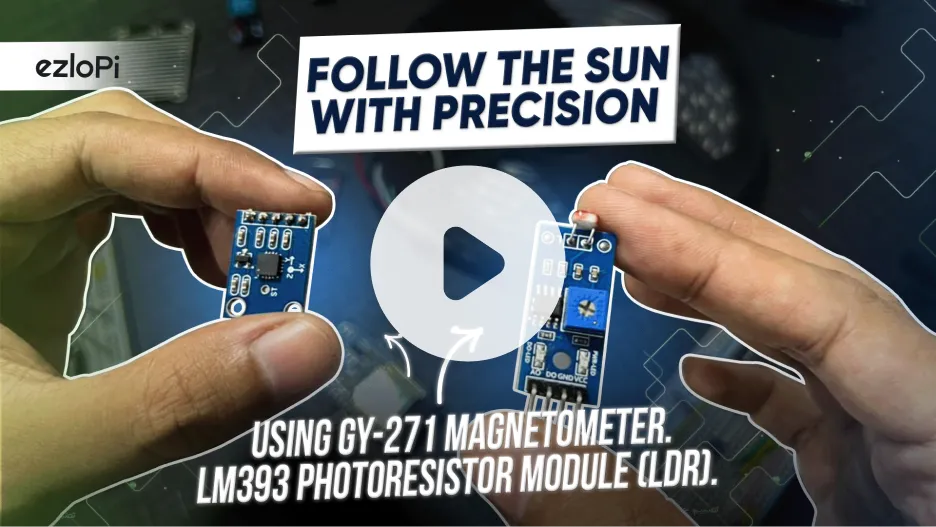

The smart solar tracker system uses the GY-271 magnetometer and the LM393 photoresistor (LDR) with the EzloPi device to enhance solar panel efficiency by aligning it towards the sun for maximum sunlight throughout the day. The LDR measures light intensity, guiding the solar panel to tilt and orient for optimal sun exposure. The GY-271 magnetometer helps in maintaining accurate positioning by providing orientation feedback. Together, these components enable efficient energy harvesting by ensuring the panel adjusts dynamically to sunlight direction changes, maximizing energy capture and sustainability.
Welcome to the project demonstration video section. The following video showcases the key aspects of Smart solar tracking, providing a visual walkthrough of its implementation.
- ESP32 as an EzloPi smart device.
- GY-271 Magnetometer.
- LM393 Photoresistor module (LDR).
