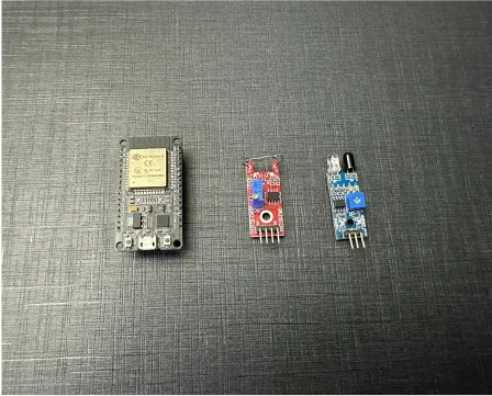

  • ESP32 as an EzloPi smart device
  • FC-51 Proximity sensor
  • KY-025 Reed switch module

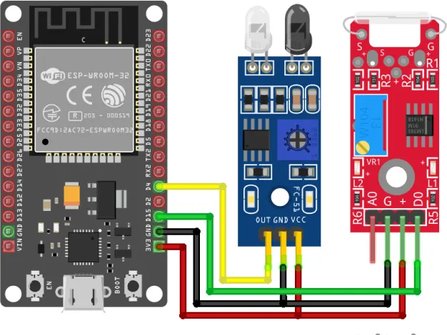

The wiring diagram for the ESP32 30 pin is represented as below:
From ESP32 to the FC-51 Proximity sensor:
ESP32 FC-51 Proximity sensor
3V3 VCC
GND GND
D4 OUTL
From ESP32 to KY-025 Reed switch module:
ESP32 KY-025
3V3 +(VCC)
GND G(GND)
D15 D0

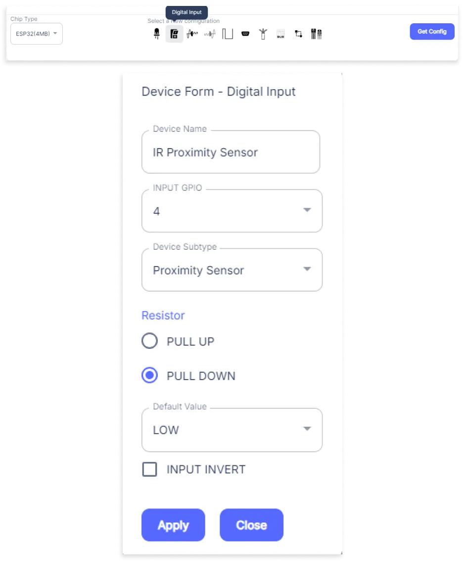

  2. In the Device Configuration, tab click on Digital Input.
  1. A Digital Input window will open for inputting the following parameters:
  • Set a Device name of your choosing. In our case, we set it to IR Proximity Sensor.
  • Set OUT GPIO to 4.
  • Set Device Subtype to IR Proximity Sensor.
  • Set the Resistor to PULL DOWN.
  • Set Default value to LOW.
  • Then Click Apply Button.

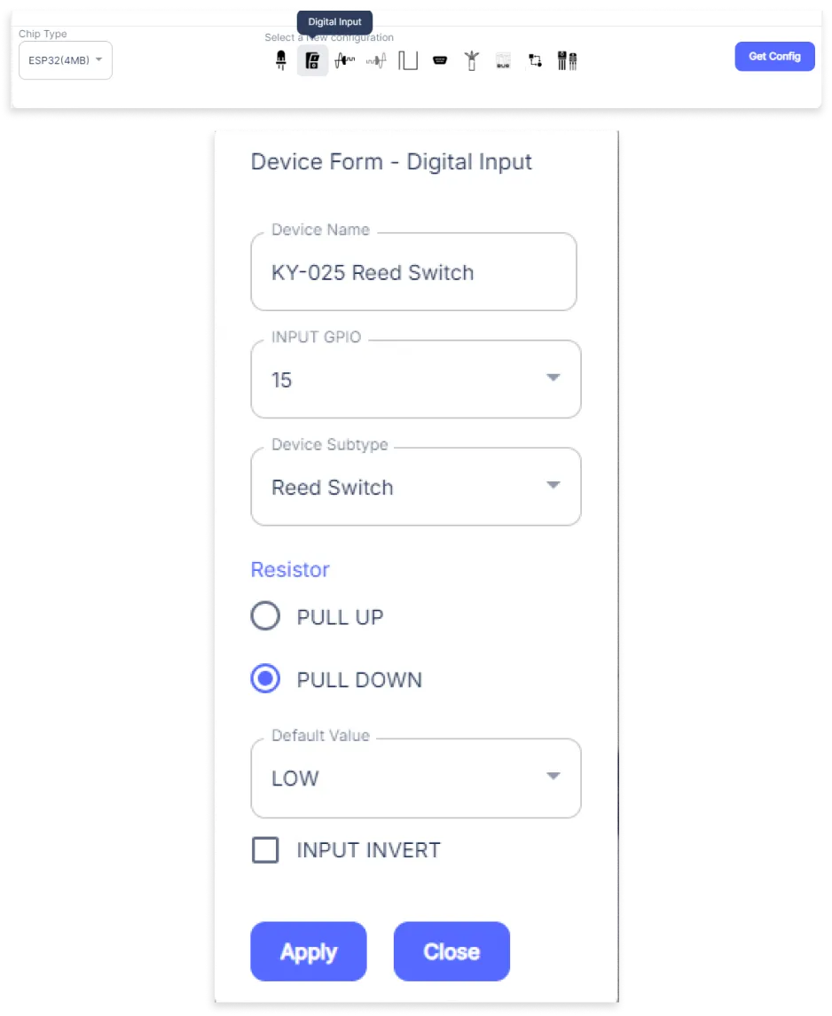

  1. Again, In the Device Configuration, tab click on Digital Input.
  • Set a Device name of your choosing. In our case, we set it to KY-025 Reed Switch.
  • Set OUT GPIO to 15.
  • Set Device Subtype to Reed Switch.

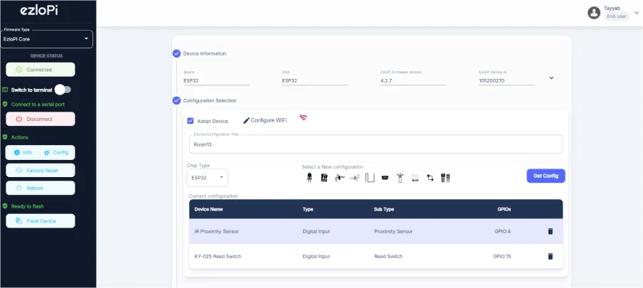

  • After clicking the apply button you can see a table of your setting in the device configuration tab.
  • Press the Flash Device button.

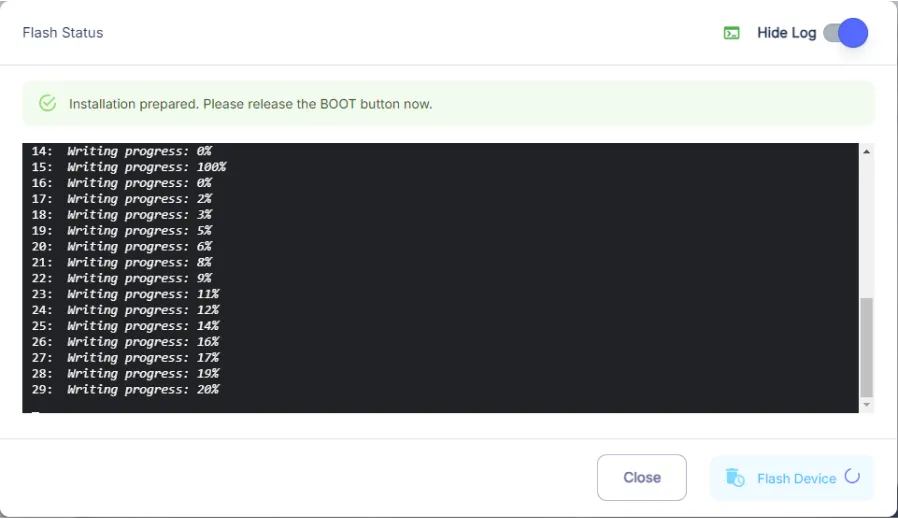

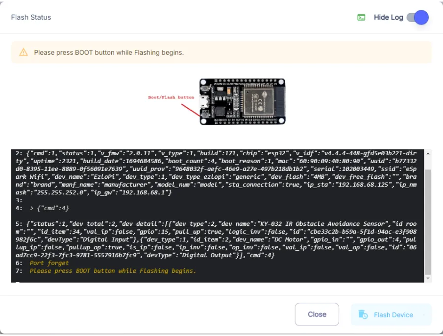

  1. A window will appear on the bottom right side of the screen displaying “Please press BOOT button while flashing begins.”
  1. Hold the BOOT button down until the next window appears on the bottom right side of the screen which says “Installation prepared. Please release the boot button now.”
  1. Release the BOOT button from your ESP32 when this pop-up on the bottom right window appears.
  1. After some time, a popup will appear saying Device Flashed Successfully! This means that your device has been set up successfully.

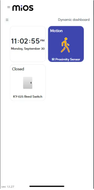

  1. Here, as seen in the MiOS mobile app above, we can see the IR proximity sensor and reed switch tiles. The above figure indicates when no motion is detected by proximity sensor it shows ‘No Motion’ message while the reed switch shows an ‘Open’ message which means no person or object is detected by it also.
  1. Now, it can be seen that when some motion is detected by IR proximity sensor, the tile message now changes to ‘Motion’ whereas the reed switch also detects something that's why it now shows a ‘Closed’ message.

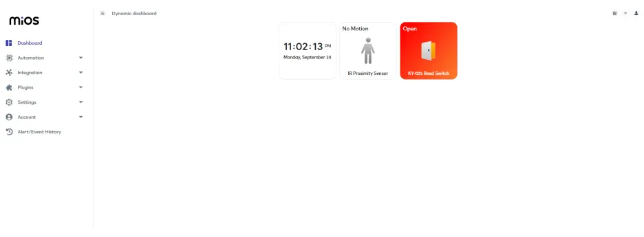

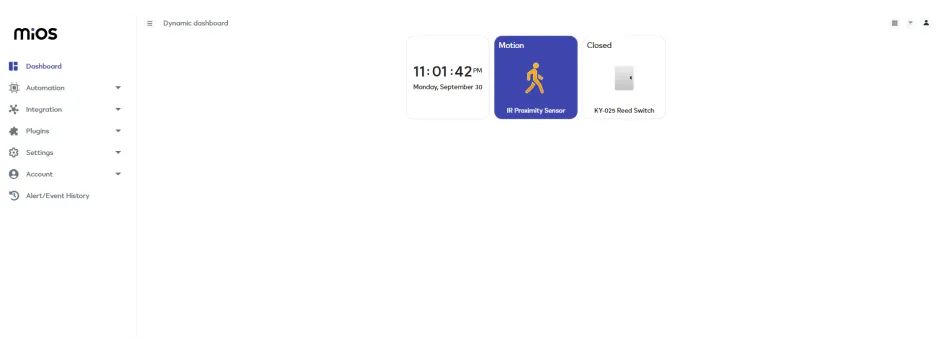

6. MiOS Web Dashboard
  1. After configuring the controller with the EzloPi web flasher, head to ezlogic.mios.com
  1. Use the same credentials to log in that you used for configuring the controller with the web flasher.
  1. Here, as seen in the MiOS web app above, we can see the IR proximity sensor and reed switch tiles. The above figure indicates when no motion is detected by proximity sensor it shows ‘No Motion’ message while the reed switch shows an ‘Open’ message which means no person or object is detected by it also.
