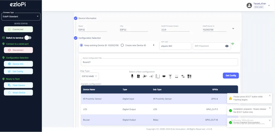

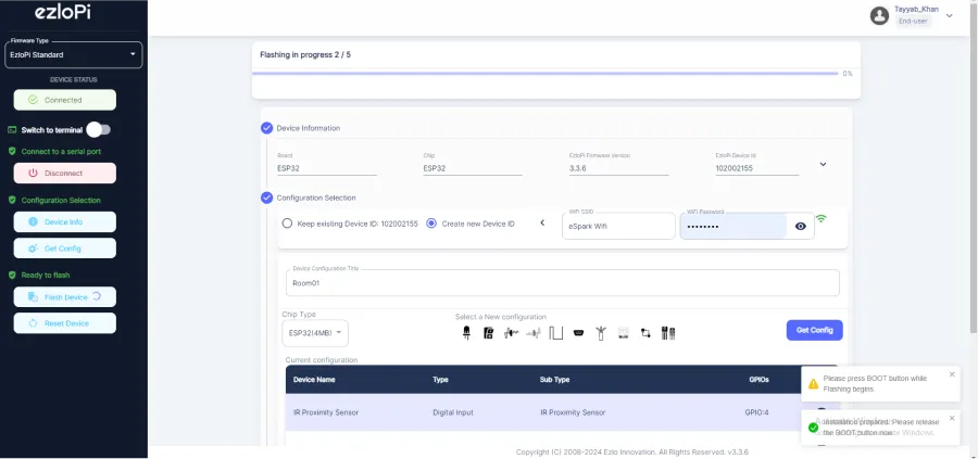

4. Interfacing the Book Light & Buzzer with Proximity sensor using the EzloPi Web Flasher
Set up your device/hardware by visiting config.ezlopi.com
Now, select COM Port to which your ESP32 device is connected. In our case, the COM3 port is used.
Click Connect.

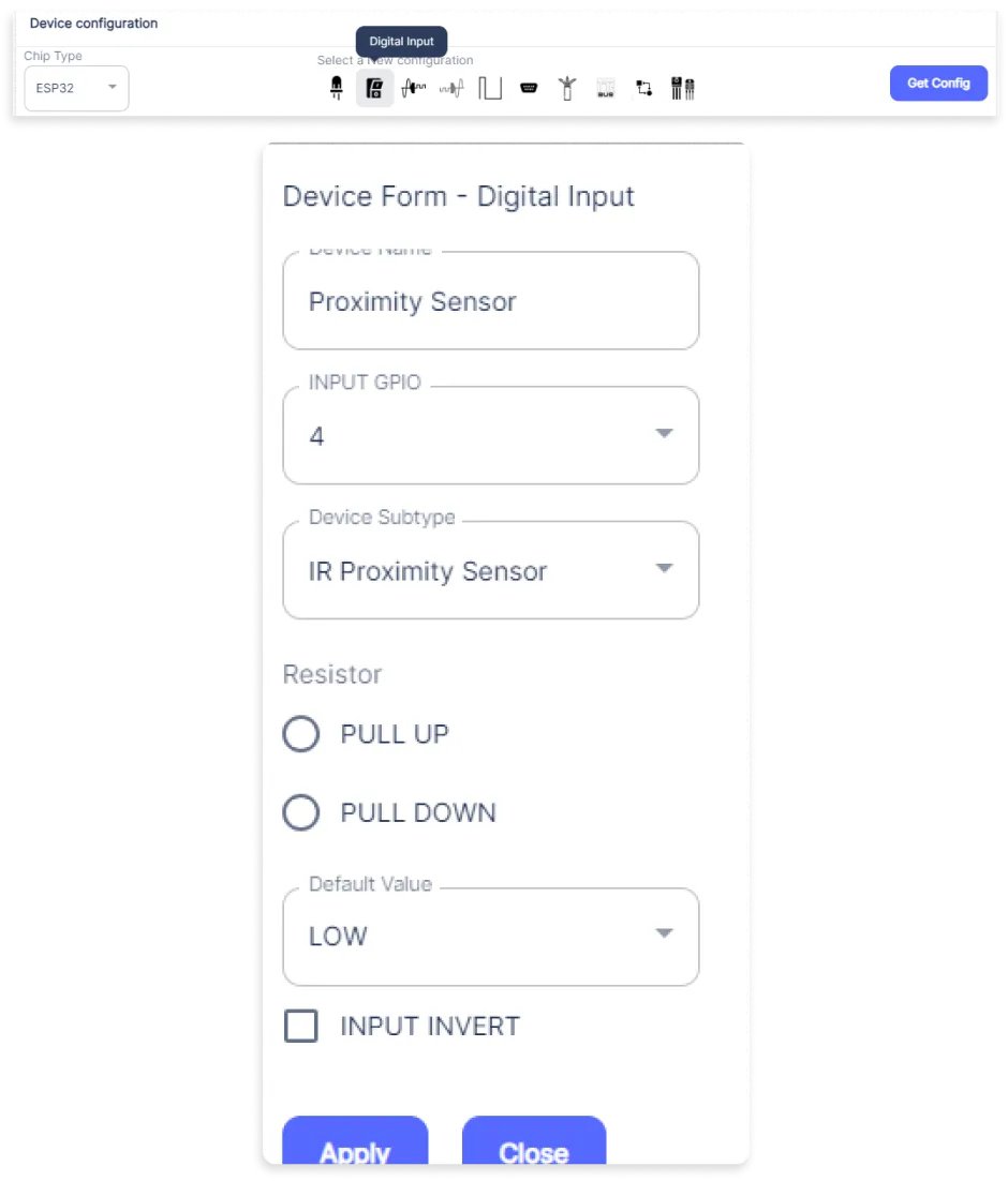

- A window will open for inputting the following parameters:
- Set a device name of your choosing. In our case, we set it to Proximity Sensor.
- Set OUT GPIO to 4.
- Set Device Subtype to IR Proximity Sensor.
- Set default value to LOW.
- Then click Apply Button.

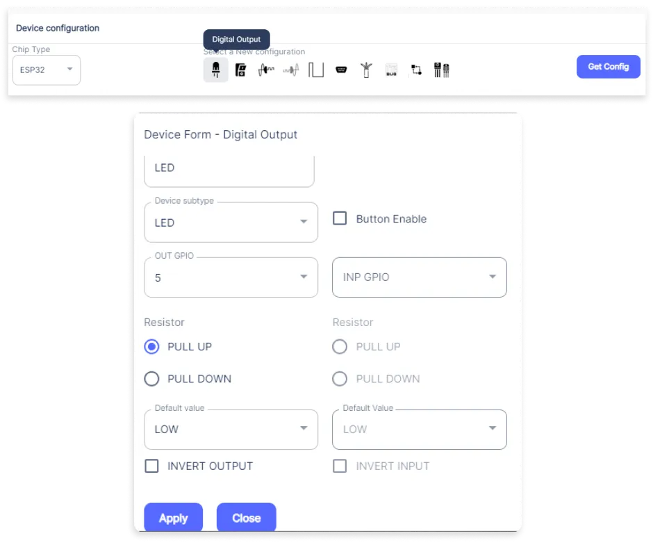

- Again, In the Device Configuration, tab click on Digital Output.
- Set a device name of your choosing. In our case, we set it to LED.
- Set Device Subtype to LED.
- Set OUT GPIO to 5.
- Set Resistor to PULL UP.

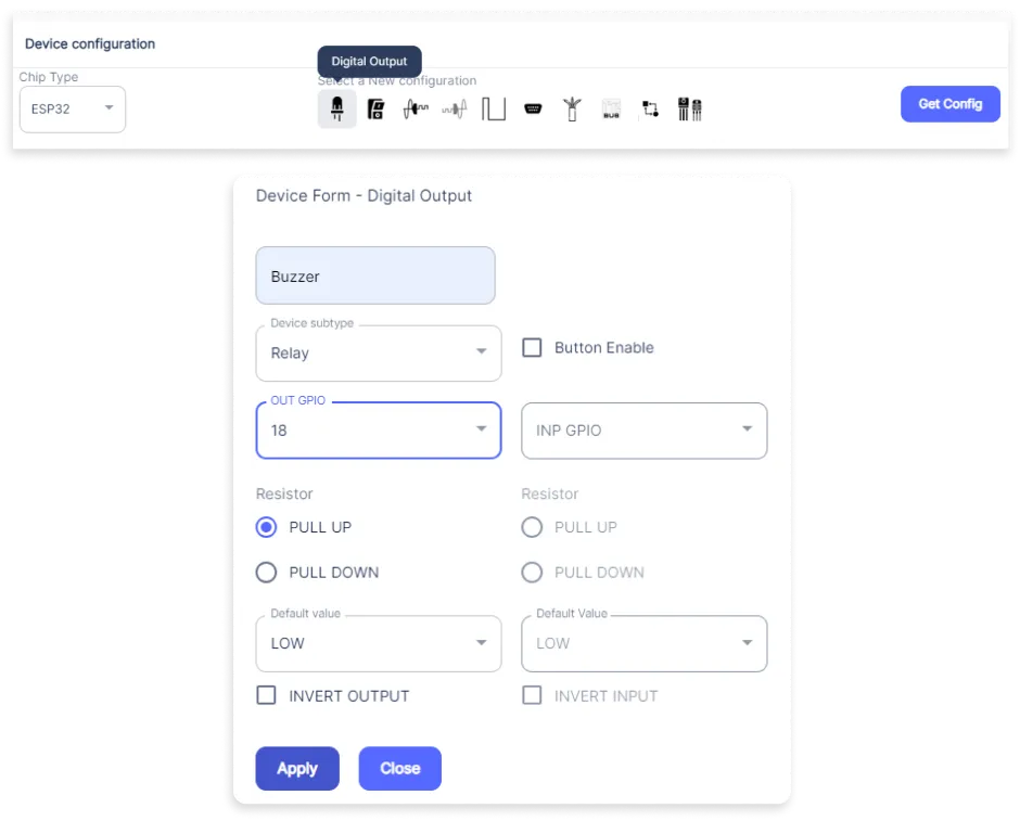

- Set a device name of your choosing. In our case, we set it to Buzzer.
- Set Device Subtype to Relay.
- Set OUT GPIO to 18.

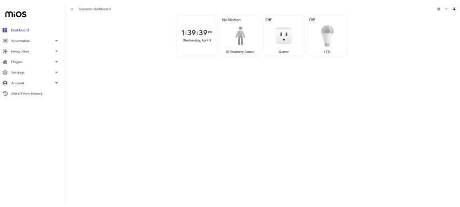

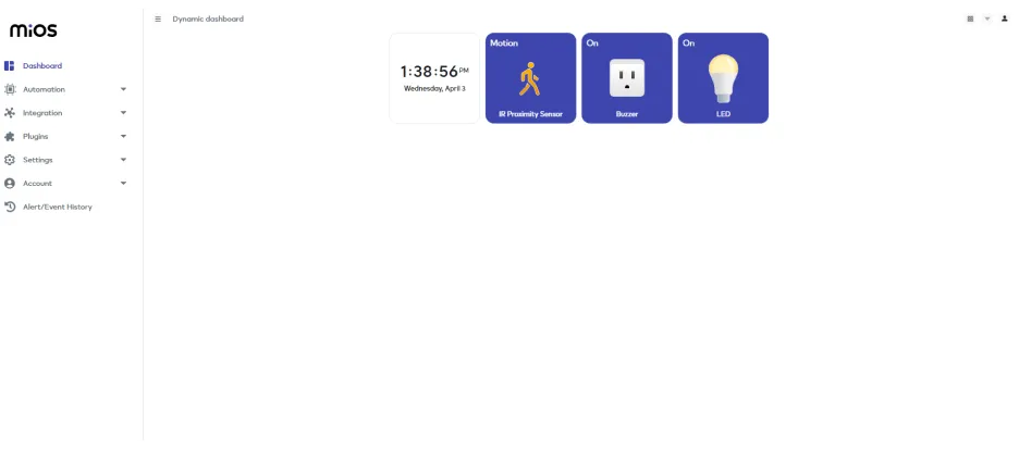

5. MiOS Web Dashboard
- On the MiOS web dashboard, you will be able to see the tile for proximity sensor, LED and the buzzer. These tiles show the status of proximity sensor, LED and buzzer.

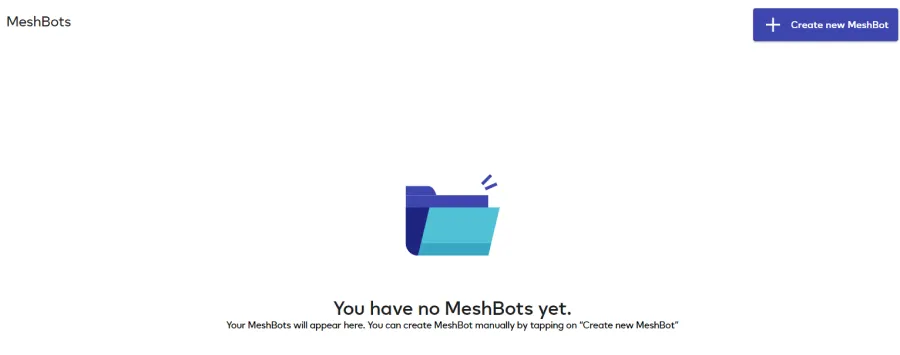

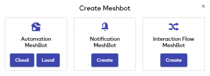

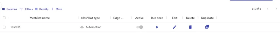

MeshBots:
- On the right side of the screen under Automation, click on MeshBots.

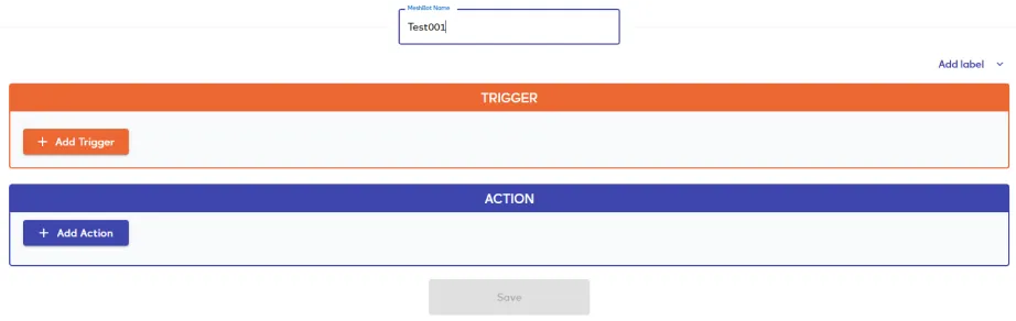

- After clicking on Create new MeshBot you will see new options, now under Automation MeshBot click on Local.
- On the next screen you will see that we can create a name of our choosing, in this case we write it as Test01.

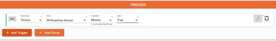

- Set Node Type to Device.
- Set the Node to IR Proximity Sensor.
- Set the Capability to Motion..
- Set the Value to True.

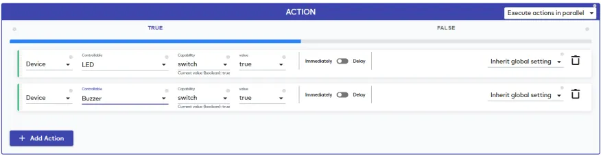

- Set these values in the True part of the ACTION section.
- Set Controllable Type to Device.
- Set the Controllable to LED.
- Set the Capability to switch.
- Set the Value to true.
- Set Action to immediately.
- Add another action by clicking Add Action.

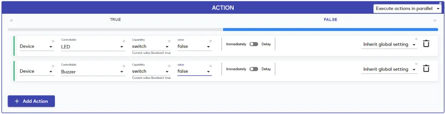

- Set these values in the False part of the ACTION section.
- Set the Value to false.
- Set action to immediately.
- After opening the MiOS web dashboard, you will be able to see the tile of your connected devices. While parking, whenever the car is away from the proximity sensor, it will not detect any motion or trigger the LED and Buzzer, For now, no motion is being detected.

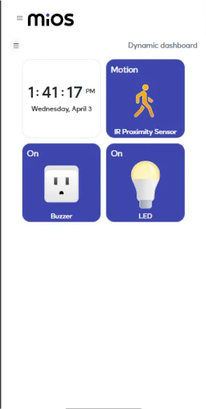

5. MiOS App
- After opening the MiOS mobile dashboard, you will be able to see the tile of your connected device, in our case the proximity sensor, LED and Buzzer. While parking, whenever the car is away from the proximity sensor, it will not detect any motion or trigger the LED and Buzzer, For now, no motion is being detected.
- Similarly, it can be seen that when the car comes close to the proximity sensor, it detects motion and the LED and Buzzer get triggered. This is because of the meshbot rules we have set earlier.
