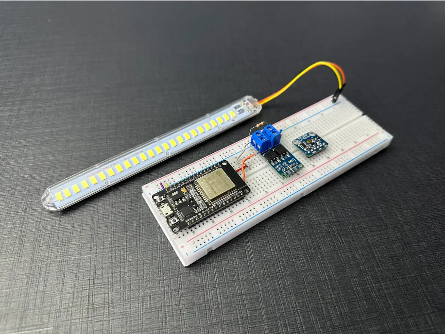

The smart mood lighting system uses the LTR303ALS luminosity sensor and a flexible neon LED strip integrated with the EzloPi device. The LTR303ALS sensor continuously monitors ambient light levels, adjusting the brightness and color of the neon LED strip to create optimal lighting based on the surrounding environment. The system offers customizable lighting options such as brightness control, providing an energy-efficient and personalized mood lighting experience. Ideal for home automation setups, this project allows users to enhance their living spaces with adaptive and intelligent lighting solutions using the EzloPi smart platform.
Welcome to the project demonstration video section. The following video showcases the key aspects of Smart mood lighting system, providing a visual walkthrough of its implementation.
  • ESP32 as an EzloPi smart device.
  • LTR303ALS Luminosity sensor.
  • XY-MOS, high-power dual MOSFET driver module.
  • Flexible neon LED strip.
  • 12V Power supply.

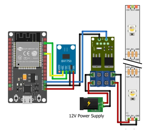

The wiring diagram for the ESP32 30 pin is represented as below:
From ESP32 to the LTR303ALS Luminosity sensor:
ESP32 LTR303ALS
3V3 VCC
GND GND
D21 SDA
D22 SCL
From ESP32 to the MOSFET driver module:
ESP32 MOSFET driver module
D15 Trig
GND GND
From Power Supply to the MOSFET driver module:
Power Supply MOSFET driver module
VCC SUPPLY+
GND SUPPLY-
From MOSFET driver module to LED Strip:
MOSFET Driver LED Strip
LOAD+ 5V
LOAD- GND

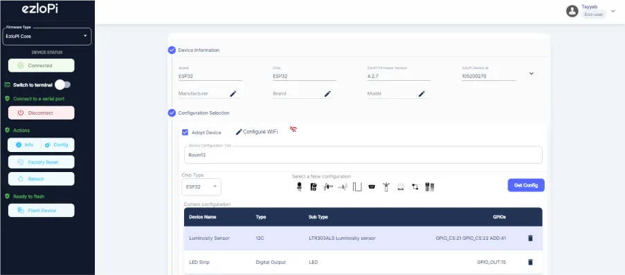

  1. If you are new to this and it's your first time configuring, select Create new Device ID. Enter Wifi SSID and Wifi Password.

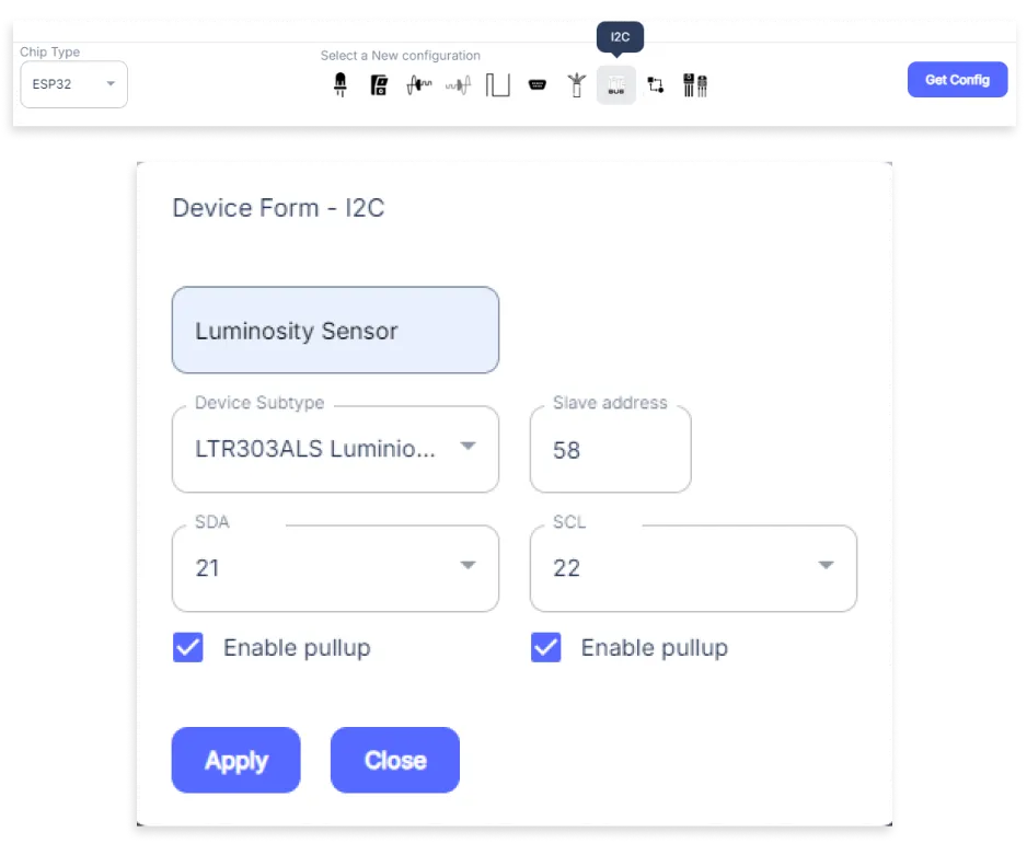

  2. In the Device Configuration, tab click on I2C.
  1. An I2C window will be opened for inputting the following parameters:
  • Set a Device name of your choosing. In our case, we set it to Luminosity Sensor.
  • Set Device subtype to LTR303ALS Luminosity Sensor.
  • Set Slave address to 41.
  • Set SDA pin to GPIO21.
  • Set SCL pin to GPIO22.
  • Check both Enable pullup boxes.
  • Then Click Apply Button.

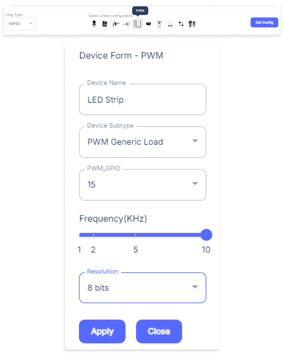

  1. Again, In the Device Configuration, tab click on PWM.
  1. A PWM window will be opened for inputting the following parameters:
  • Set a Device name of your choosing. In our case, we set it to LED Strip.
  • Set Device subtype to PWM Generic Load.
  • Set the PWM_GPIO pin to 15.
  • Set the Frequency from its Slider.
  • Set the Resolution to 8-bit.
  • After clicking the apply button you can see a table of your setting in the device configuration tab.

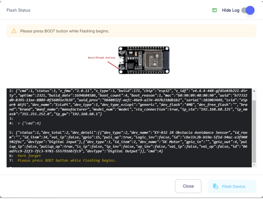

  • Press the Flash Device button.
  1. A window will appear on the bottom right side of the screen displaying “Please press BOOT button while flashing begins.”
  1. Hold the BOOT button down until the next window appears on the bottom right side of the screen which says “Installation prepared. Please release the boot button now.”
  1. Release the BOOT button from your ESP32 when this pop-up on the bottom right window appears.
  1. After some time, a popup will appear saying Device Flashed Successfully! This means that your device has been set up successfully.

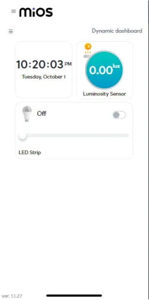

  1. After successfully logging in, you will be able to see the number of controllers connected such as a lamp, fan, or any other device in the MiOS app. Tap on any controller of your desired ID:
  1. You will be able to see the status of your controller whether it is online or offline. Access the device dashboard, and tap the device. The following view of the dashboard will appear:

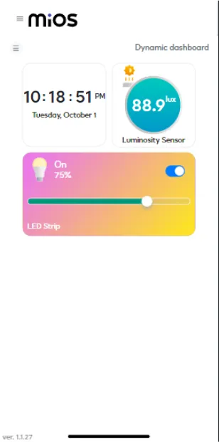

  1. Here, as seen in the MiOS mobile app above, we can see the LED strip and luminosity sensor tiles. The above picture shows that when the LED strip is OFF then the luminosity sensor also shows no or zero intensity.
  1. Here, it can be seen that when the LED strip is turned ON and with certain intensity then the luminosity sensor also detects the light of the LED Strip and also shows its intensity.

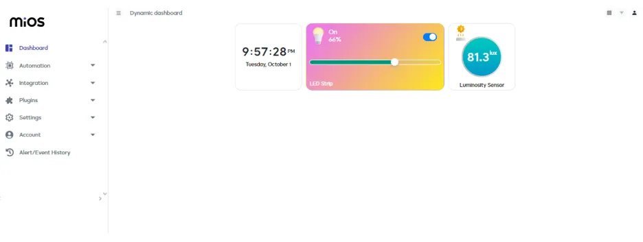

  1. After configuring the controller with the EzloPi web flasher, head to ezlogic.mios.com
  1. Use the same credentials to log in that you used for configuring the controller with the web flasher.

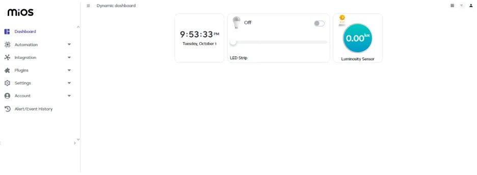

  1. As seen in the MiOS web app, we can see the LED strip and luminosity sensor tiles. The above picture shows that when the LED strip is OFF then the luminosity sensor also shows no or zero intensity.
MeshBots:
