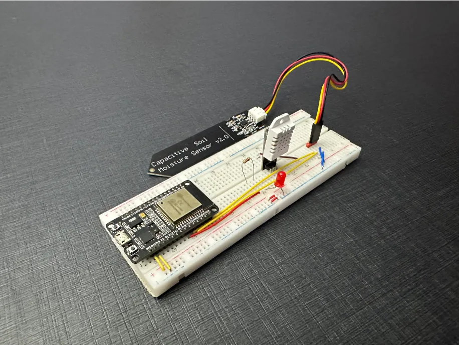

The smart irrigation system project leverages a soil moisture sensor and DHT22 sensor integrated with the EzloPi device to automate and optimize watering conditions for plants or crops. The soil moisture sensor monitors the water content in the soil, while the DHT22 provides real-time temperature and humidity data. Based on these readings, the EzloPi device can be programmed to trigger water pumps or sprinklers when necessary, ensuring efficient water usage. The system aims to conserve resources and promote healthier plant growth by preventing over or under-watering, making it ideal for gardens or agricultural applications.

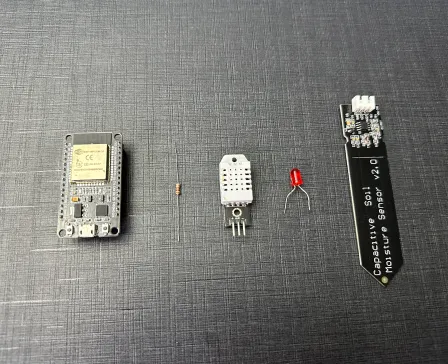

- Capacitive soil moisture sensor.
- DHT22 digital temperature and humidity sensor.
- LED with 100 Ohm Resistor

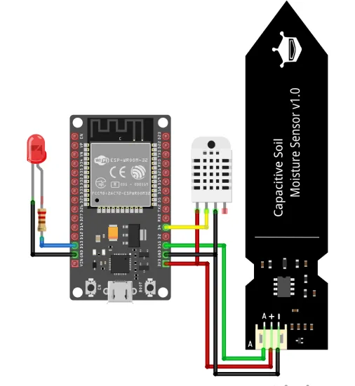

MH-FMD BuzzerThe wiring diagram of ESP32 30 pin is represented as follows:
From ESP32 to Soil Moisture Sensor:
| ESP32 | Soil Moisture Sensor |
| VIN | VCC |
| GND | GND |
| D4 | A (Data Signal) |
From ESP32 to DHT22:
| ESP32 | DHT22 |
| 3V3 | VCC |
| GND | GND |
| D13 | Data Signal |
From ESP32 to LED & Resistor:
| ESP32 | LED | Resistor |
| GND | Cathode | - |
| - | Anode | Terminal no.1 |
| D13 | - | Terminal no.2 |

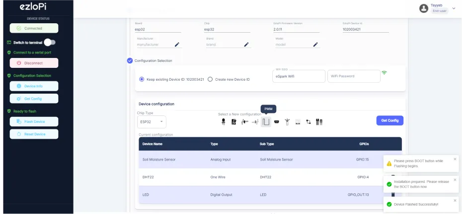

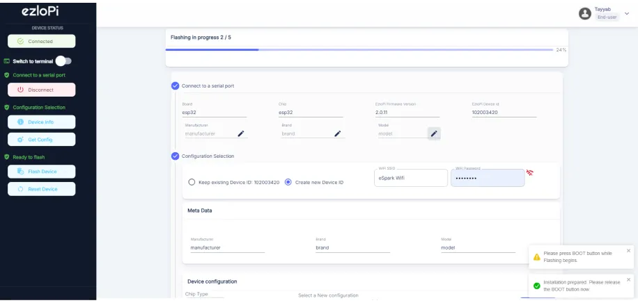

4. Interfacing the Soil moisture sensor and DHT22 with the EzloPi Web Flasher
Click Connect

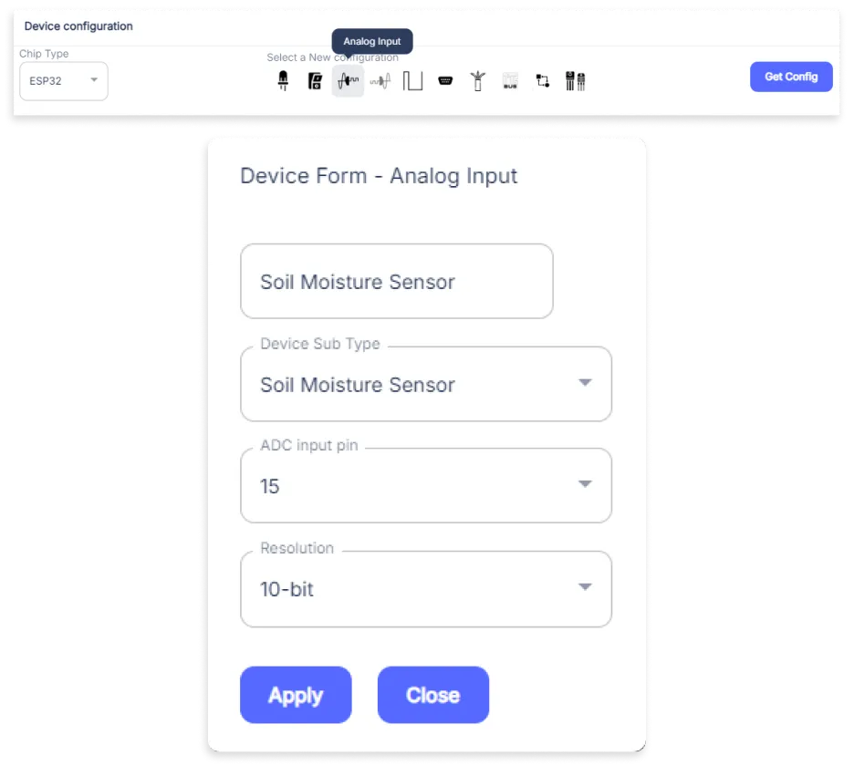

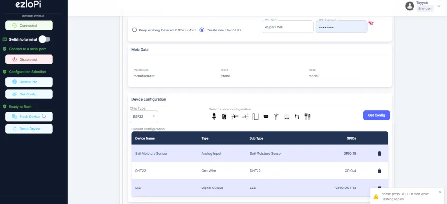

- In the Device Configuration, tab click on Analog Input.
- An Analog Input window will open for inputting the following parameters:
- Set a Device name of your choosing. In our case, we set it to Soil Moisture Sensor.
- Set Device Subtype to Soil Moisture Sensor.
- Set the ADC input pin to 15.
- Set the Resolution to 10-bit.
- Then Click Apply Button.

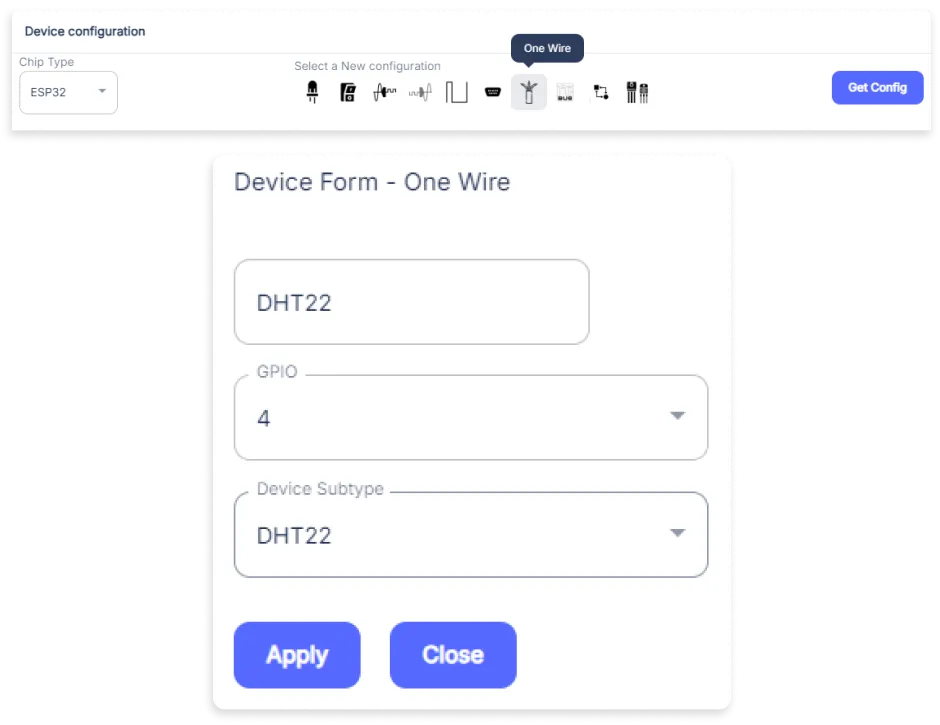

- In the Device Configuration, tab click on One Wire.
- A pop up window will open for inputting the following parameters:
- Set a Device name of your choosing. In our case, we set it to DHT22.
- Set the GPIO to 4.
- Set Device subtype to DHT22.

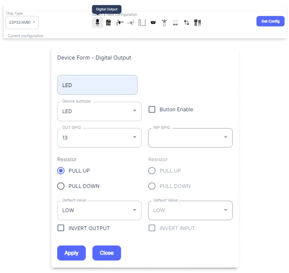

- A window will be opened for inputting the following parameters:
- Set a Device Name of your choosing. In our case, we will set it to LED.
- Set the Device Subtype to LED.
- Set OUT GPIO to 13.
- Set the Resistor to PULL UP.

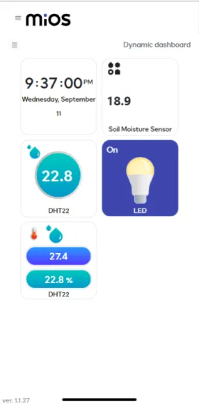

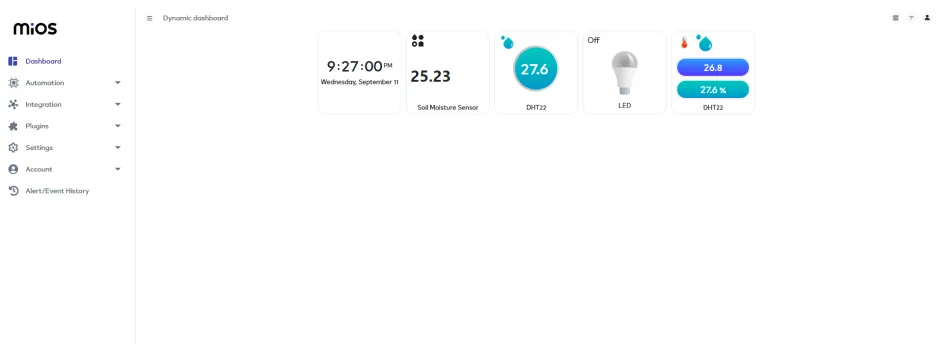

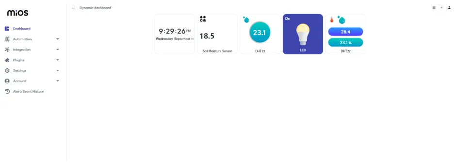

5. MiOS Web Dashboard
- Here, on the MiOS web dashboard, you will be able to see the tiles of connected devices. In our case, we have a soil moisture sensor, DHT22 and LED tiles. The soil moisture sensor shows the moisture in the soil. The LED will be operated according to our setting of meshbot. We can also use motors instead of LED to pump/provide water to soil. The DHT22 tile shows the temperature and humidity of the environment using the sensor.

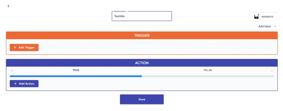

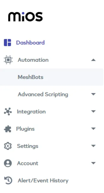

MeshBots:
- After clicking on Create new MeshBot, you will see this now under Automation MeshBot click on Local.
- On the next screen you will see that we can create a name of our choosing, in this case we write it as Test002.

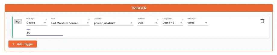

- Set Node Type to Device.
- Set the Node to Soil Mositure Sensor.
- Set the Category to parent_abstract.
- Set the variables to uuid.
- Set the Comparator to Less (<).
- Set the Value Type to value.
- Set the value to 20.

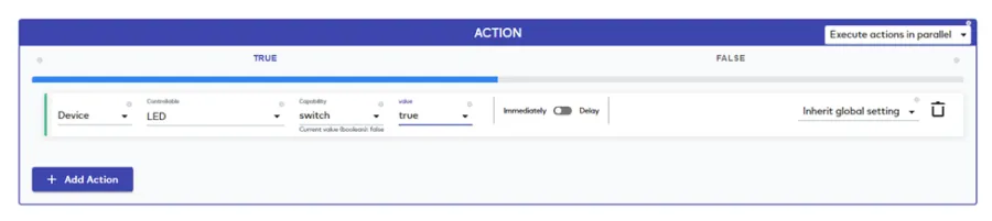

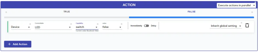

- Set Controllable Type to Device.
- Set the Controllable to LED.
- Set the Capability to switch.
- Set the Value to true.
- Set Action to immediately.
- Set the Value to false.
- Now Click the Save button.
- Now in the MiOS web dashboard, we can see that when the soil moisture reaches a certain value as declared above, the LED will turn ON because of the rules we have set in meshbot.

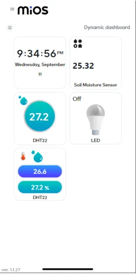

6. MiOS App
- Here, on the MiOS mobile dashboard, you will be able to see the tiles of connected devices. In our case, we have a soil moisture sensor, DHT22 and LED tiles. The soil moisture sensor shows the moisture in the soil. The LED will be operated according to our setting of meshbot. We can also use motors instead of LED to pump/provide water to soil. The DHT22 tile shows the temperature and humidity of the environment using the sensor.
- Now in the MiOS mobile dashboard, we can see that when the soil moisture reaches a certain value as declared above while configuring the meshbot, the LED will turn ON because of the rules we have set in the meshbot.
