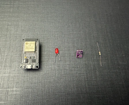

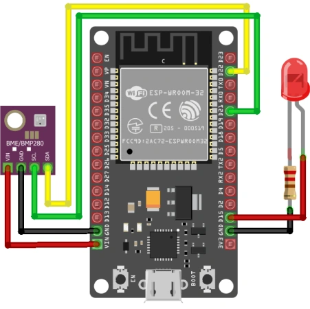

- 5V BME280 Barometric Pressure & Humidity sensor.
- LED with 100 Ohm Resistor.

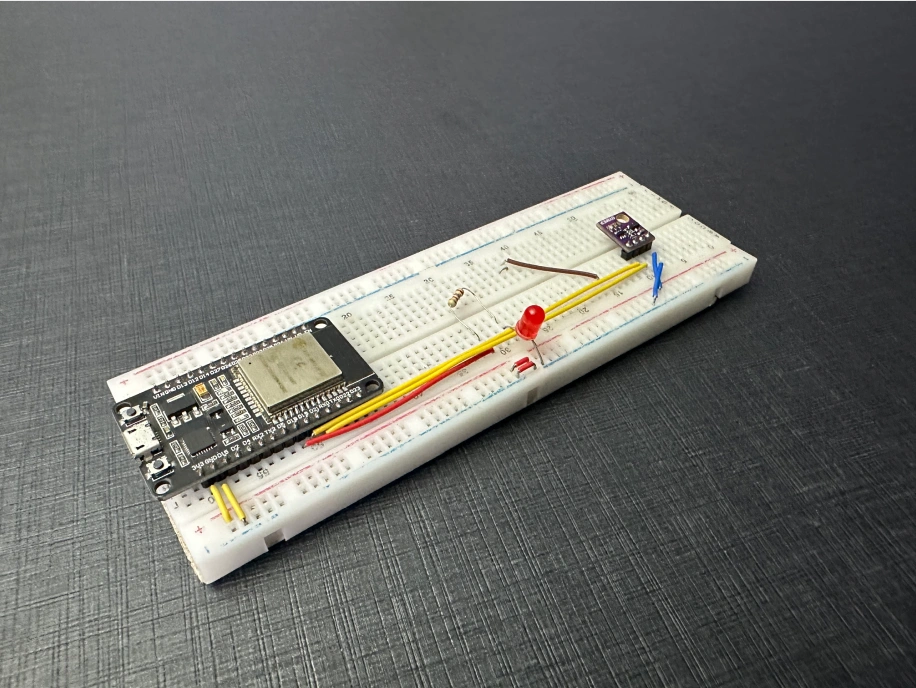

From ESP32 to the BME280:
| ESP32 | BME280 |
| VIN | VIN |
| GND | GND |
| D21 | SCL |
| D22 | SDA |

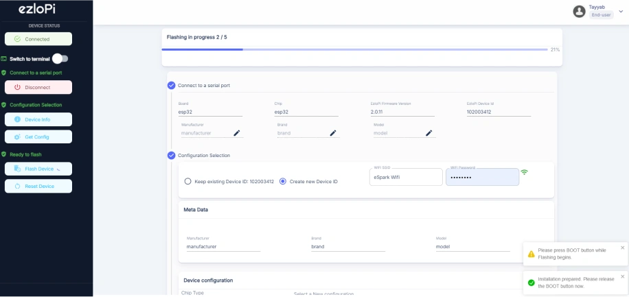

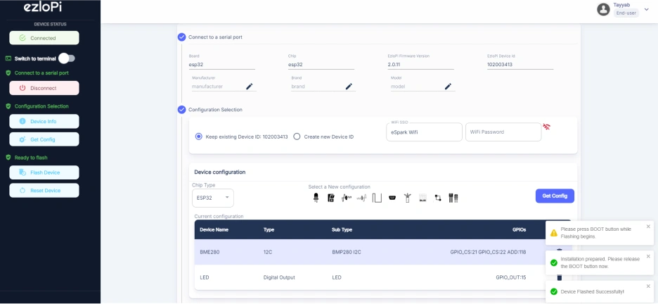

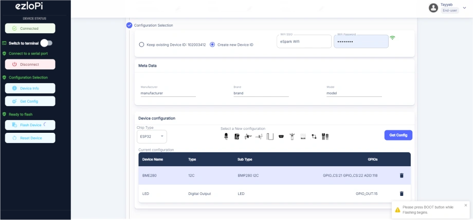

4. Interfacing the Presure and humidity sensor with the EzloPi Web Flasher:
Click Connect

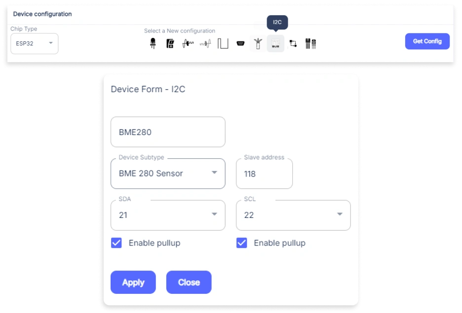

- In the Device Configuration, tab click on I2C.
- A I2C Input window will open for inputting the following parameters:
- Set a Device name of your choosing. In our case, we set it to BME280.
- Set Device Subtype to BME 280 Sensor.
- Set the Slave Address to 118.
- Set the SDA pin to 21.
- Set the SCL pin to 22.
- Tick the “Enable Pullup” for both the SDA and SCL.
- Then Click Apply Button.

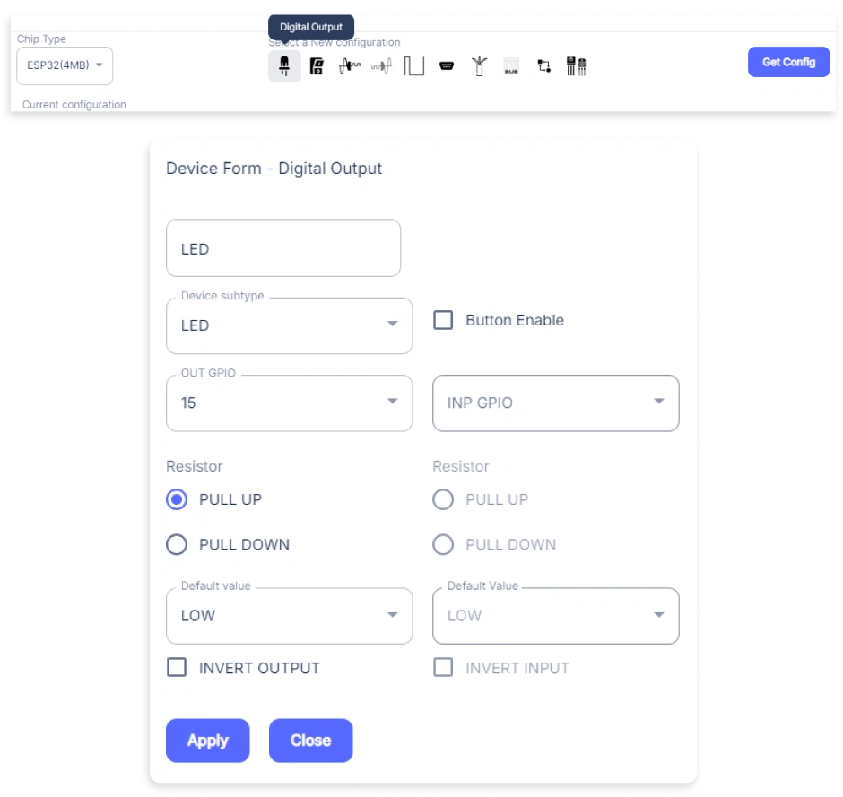

- Set a Device name of your choosing. In our case, we set it to the LED
- Set Device Subtype to LED.
- Set the OUT GPIO to 15.
- Set the Resistor to PULL UP.

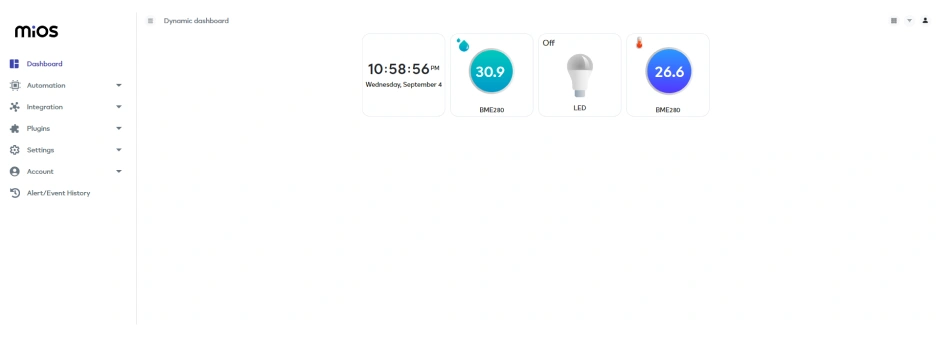

5. MiOS Web Dashboard

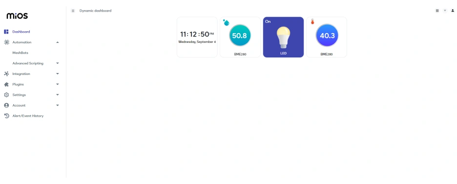

- Here, on the MiOS web dashboard, you will be able to see the tiles of connected devices. In our case we have a BME280 sensor and LED. The LED tile will indicate the status of the LED depending on the temperature and humidity being detected by the BME280 sensor.

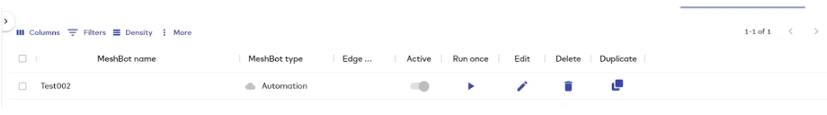

MeshBots:

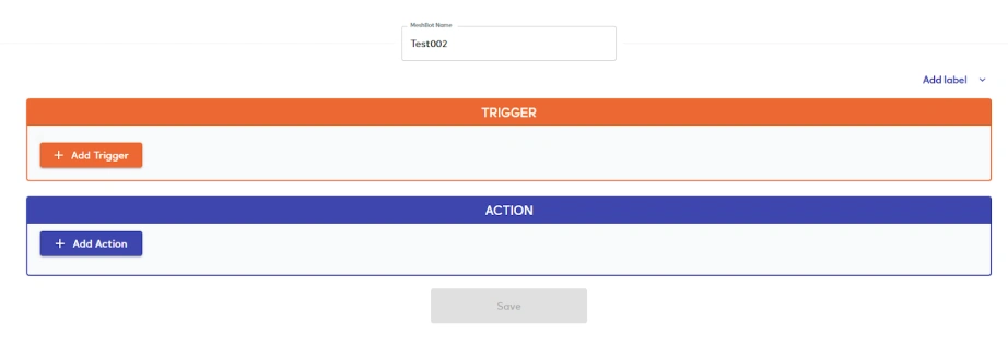

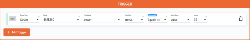

- After clicking on Create new MeshBot, you will see this now under Automation MeshBot click on Local.
- On the next screen you will see that we can create a name of our choosing, in this case we write it as Test005.
- Set Node Type to Device.
- Set the Node to BME280.
- Set the Category to power.
- Set the variables to status.
- Set the Comparator to Equal (==).
- Set the Value Type to value.
- Set the value to true.

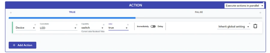

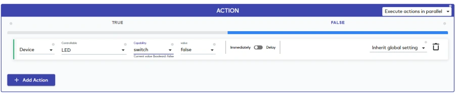

- Set Controllable Type to Device.
- Set the Controllable to LED.
- Set the Capability to switch.
- Set the Value to true.
- Set Action to immediately.
- Set the Value to false.
- Now Click the Save button.

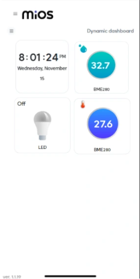

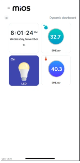

- Now in the MiOS web dashboard, we can see that when the temperature and humidity goes beyond a certain value then the LED turns on because of the rules we have set in meshbot.
6. MiOS App
- Here, as seen above on the MiOS mobile dashboard, we can see that when the temperature remains in the set limit, the LED remains OFF because of the rules we have set in meshbot.
- Now, as seen above on the MiOS mobile dashboard, we can see that when the temperature increases beyond the specified limit, the LEDs turn ON because of the rules we have set in meshbot.
