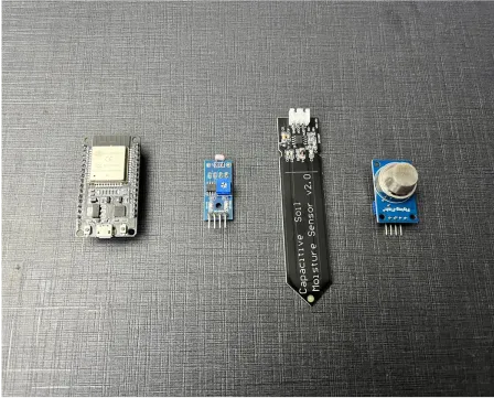

- Capacitive Soil moisture sensor.
- MQ135 NH3 sensor.
- LM393 Photoresistor module (LDR).

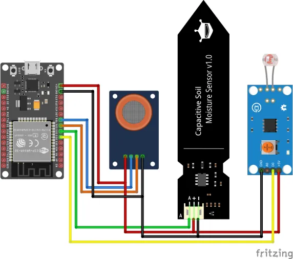

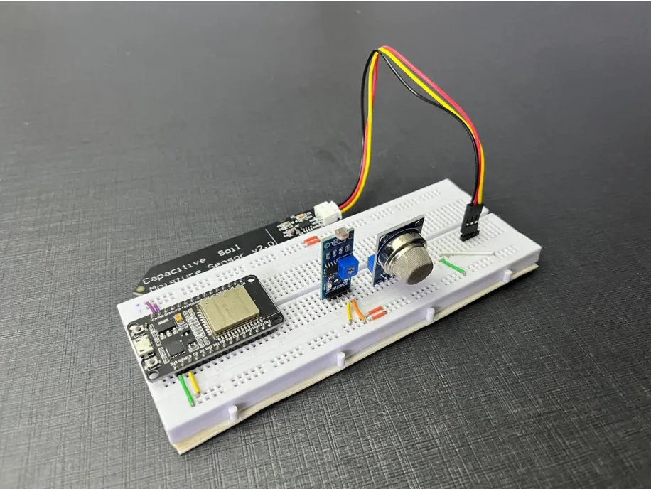

The wiring diagram for the ESP32 30 pin is represented as below:
From ESP32 to Soil Moisture Sensor:
| ESP32 | Soil Moisture Sensor |
| VIN | VCC |
| GND | GND |
| D33 | A (Data Signal) |
From ESP32 to MQ135 NH3 Sensor:
| ESP32 | MQ135 |
| VIN | 5V |
| GND | GND |
| D25 | AOUT |
| D26 | DOUT |
From ESP32 to LDR:
| ESP32 | LDR |
| VIN | +5V |
| GND | GND |
| D32 | D0 |

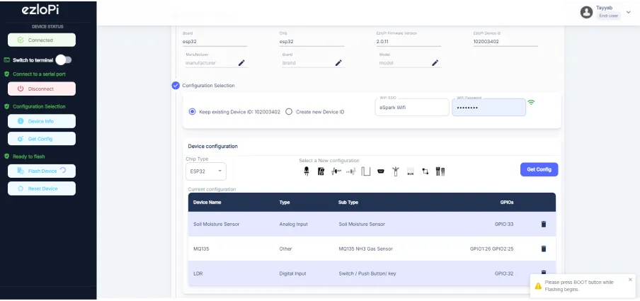

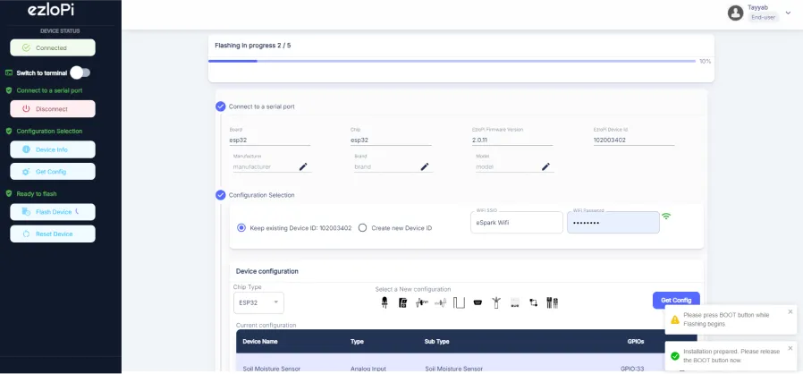

4. Interfacing the Soil moisture sensor, LDR module and gas sensor with the EzloPi Web Flasher
Click Connect

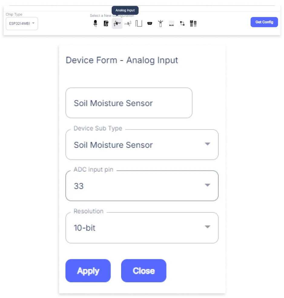

- In the Device Configuration, tab click on Analog Input.
- An Analog Input window will open for inputting the following parameters:
- Set a Device name of your choosing. In our case, we set it to Soil Moisture Sensor.
- Set Device Subtype to Soil Moisture Sensor.
- Set the ADC input pin to 33.
- Set the Resolution to 10-bit.
- Then Click Apply Button.

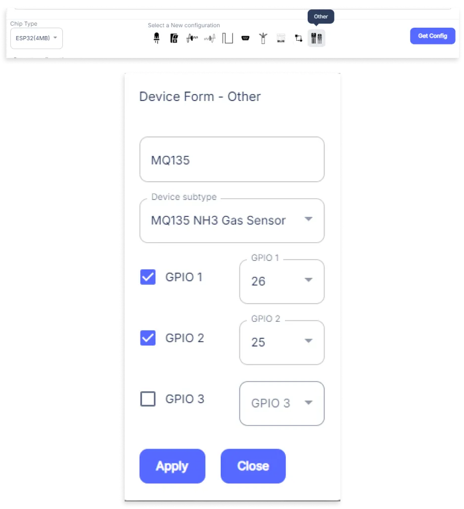

- Again, In the Device Configuration, tab click on Others.
- A pop up window will open for inputting the following parameters:
- Set a Device name of your choosing. In our case, we set it to MQ135.
- Set Device subtype to MQ135 NH3 Sensor.
- Select the check box of GPIO 1.
- Set GPIO 1 to 26.
- Select the Check box of GPIO 2.
- Set GPIO 2 to 25.

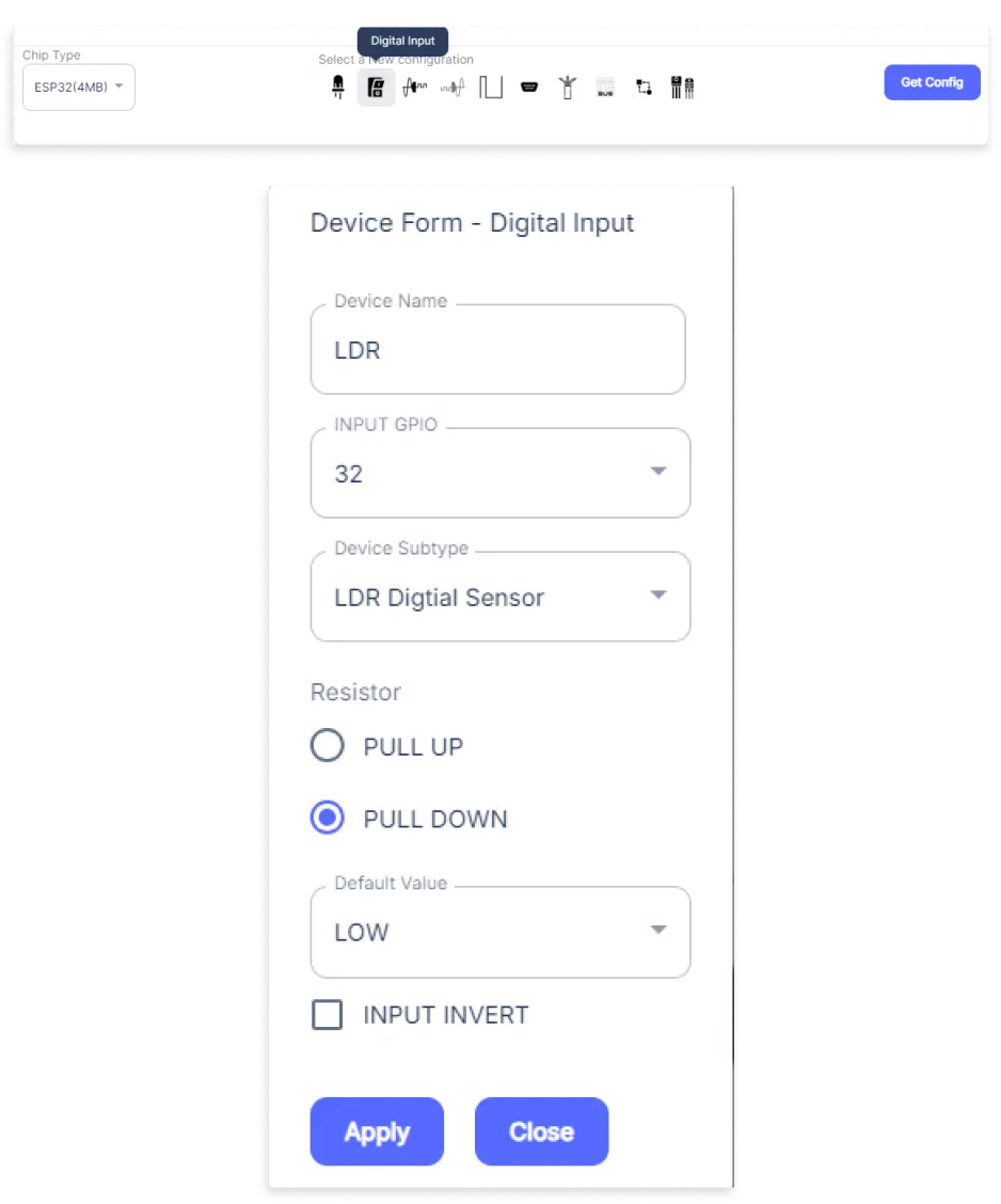

- Again, In the Device Configuration, tab click on Digital Input.
- A Digital Input window will open for inputting the following parameters:
- Set a Device name of your choosing. In our case, we set it to LDR.
- Set the INPUT GPIO to 32.
- Set Device Subtype to Switch / Push Button / Key.
- Set the Resistor to PULL DOWN.

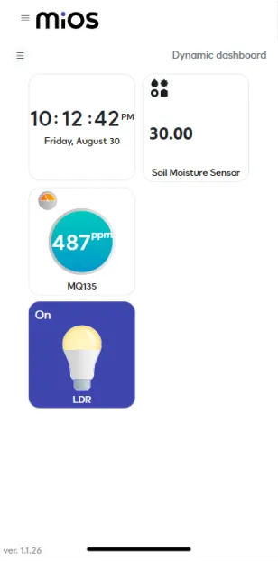

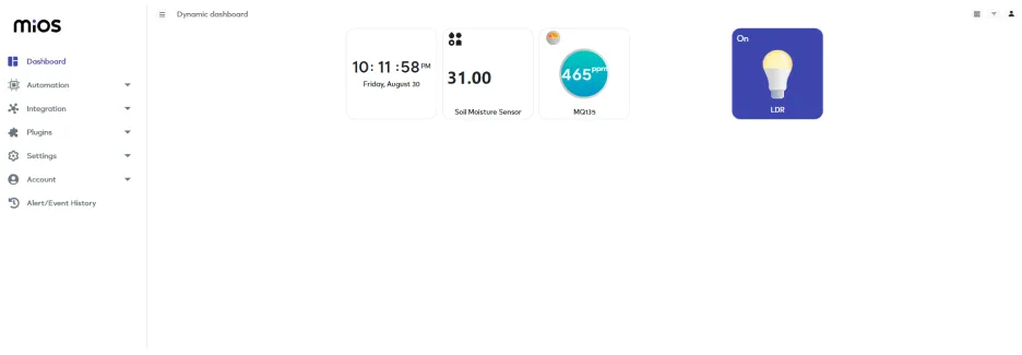

5. MiOS App
- On the MiOS mobile dashboard,we can see the tiles of the connected devices which can be seen as Soil moisture sensor, MQ135 Air quality sensor and LDR respectively. The respective tiles allow users to remotely monitor their greenhouse environment using these multiple sensors.
6. MiOS Web Dashboard
- As seen in the MiOS web dashboard, we can see the tiles of the connected devices which can be seen as Soil moisture sensor, MQ135 Air quality sensor and LDR respectively. The respective tiles allow users to remotely monitor their greenhouse environment using these multiple sensors.
