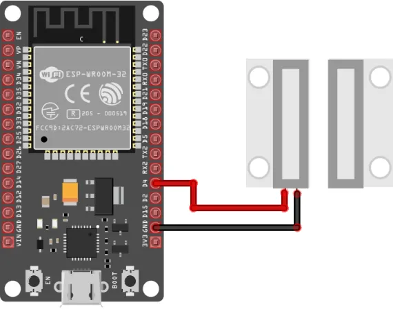

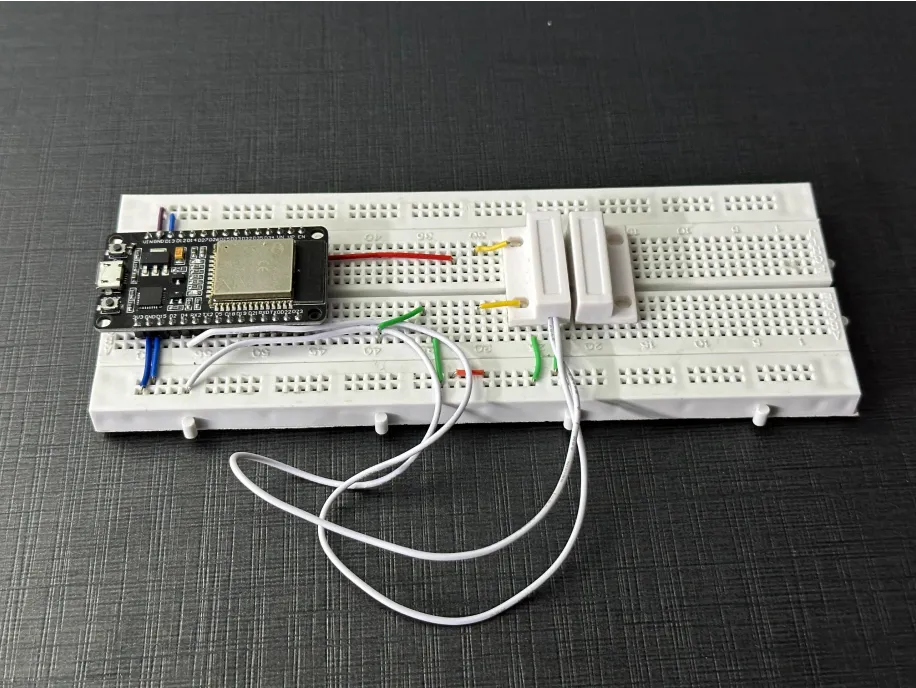

The wiring diagram of ESP32 is represented as follows:
From ESP32 to the MC-38 Magnetic door switch:
ESP32 | MC-38 |
D4 | 1st terminal |
GND | 2nd terminal |

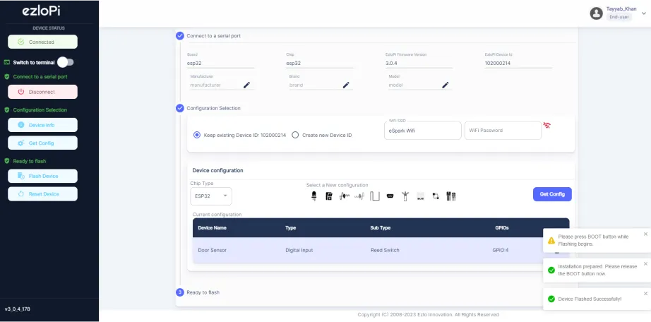

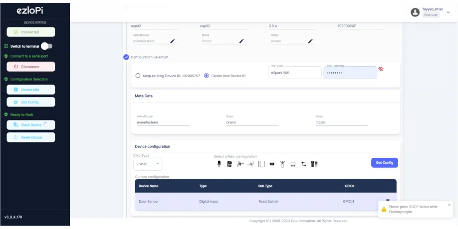

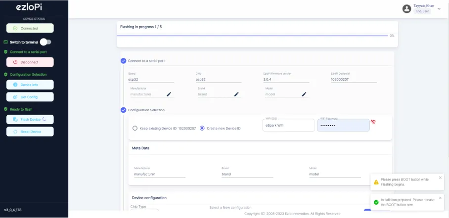

4. Interfacing the MC-38 Magnetic Door Switch module using the EzloPi Web Flasher:
Now, select COM Port to which your ESP32 device is connected. In our case, the COM3 port is used.
Click Connect.

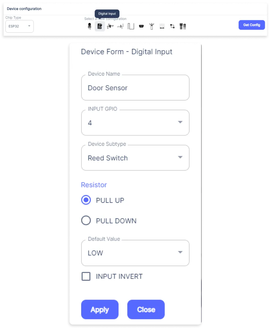

- A Digital Input window will open for inputting the following parameters:
- Set a device name of your choosing. In our case, we set it to Door Sensor.
- Set the INPUT GPIO input pin to 4.
- Set device Subtype to Reed Switch.
- Set the Resistor Setting to PULL UP.
- Now Click the Apply button. After clicking the apply button you can see a table of your setting in the device configuration tab.
- A window will appear on the bottom right side of the screen displaying “Please press BOOT button while flashing begins.”.

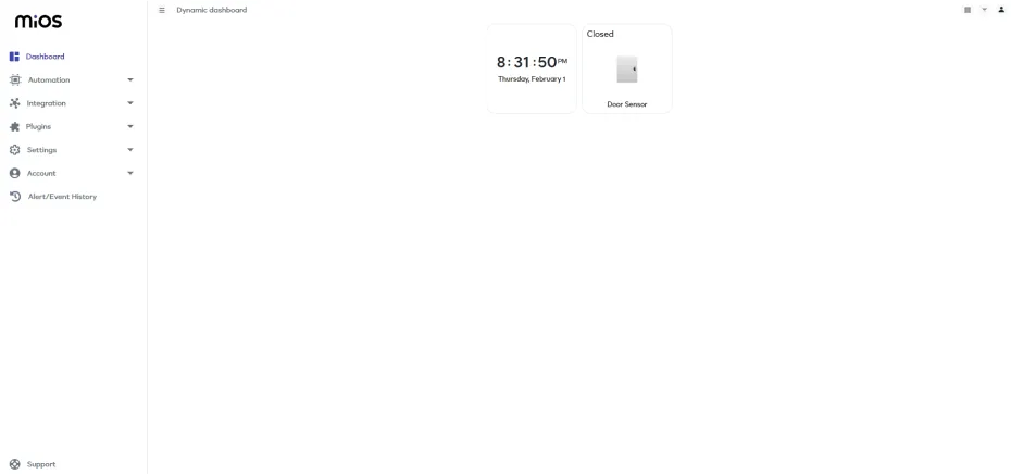

- As seen in the MiOS web dashboard above, the door sensor tile is visible with the message “Closed” which means that the door sensor is detecting magnetic field.

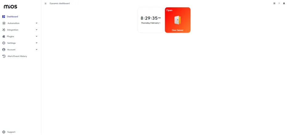

- As seen in the MiOS web dashboard above, the door sensor tile is visible with the message “Open” which means that the Door sensor is not detecting magnetic fields.

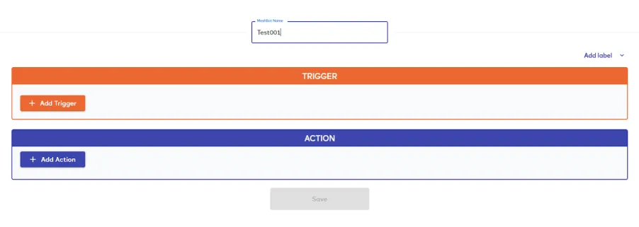

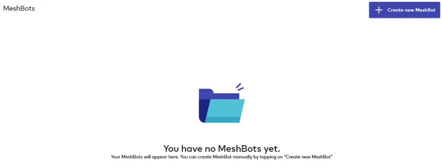

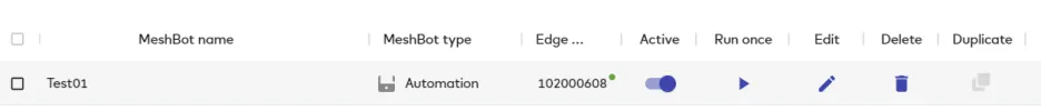

Meshbots

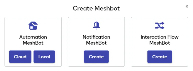

- On the right side of the screen under Automation, click on MeshBots.
- After clicking on Create new MeshBot you will see this now under Automation MeshBot click on Cloud.
- On the next screen you will see that we can create a name of our choosing, in this case we write it as MQ3.

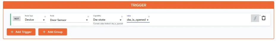

- Set these values in TRIGGER section:
- Set Node Type to Device.
- Set the Node to Door Sensor.
- Set the Capability to Dw state.
- Set the value to dw_is_opened.

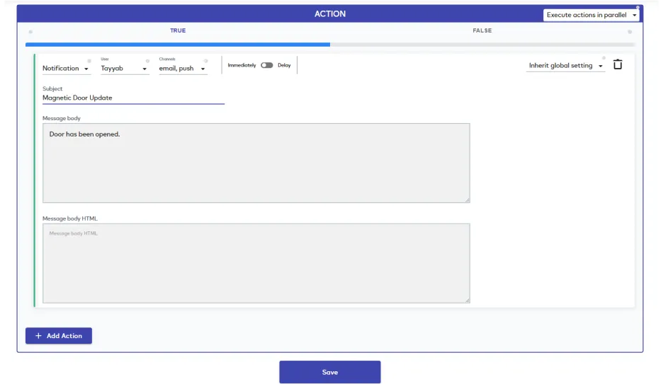

- Set these values in the ACTION section.
- Set Controllable Type to Notification.
- Set the User to Your user account .
- Set the Channels to email,push.
- Set the Subject to Magnetic Door Update.

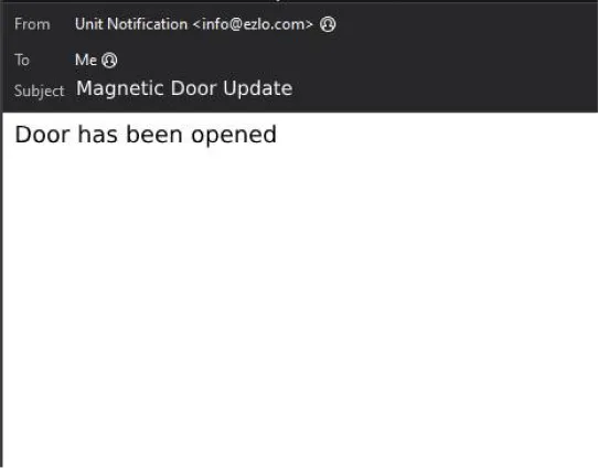

- Write the suitable Message body that you want to receive in your email. As you can see, we write, Door has been opened.
- After clicking the apply button you can see a table of your setting in the Current configuration tab.

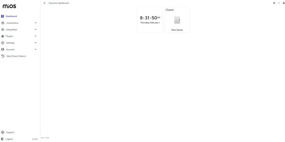

- As seen in the MiOS web dashboard above, the door sensor tile is visible with the message “Closed” which means that the door sensor is detecting magnetic fields.
- As we can see, we have received email through Meshbot when a magnet is placed near ESP32 based EzloPi device meaning that the door is closed.

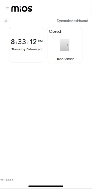

6. MiOS App
- After opening the dashboard, you will be able to see the tile of your connected device.

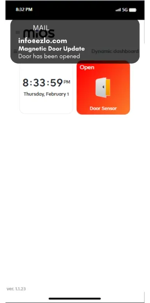

- As seen in the MiOS mobile dashboard, the door sensor tile is visible with the message “Closed” which means that the door sensor is detecting magnetic fields.
- When the ESP32 does not detect any magnetic field or object, the tile will display the “Open” message and we will receive an email via meshbot, as shown in the MiOS mobile dashboard.
