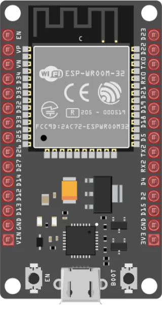

  • ESP32 as an EzloPi smart device.
The wiring diagram is represented as follows:
There is no need for connections to be made as we have only utilized ESP32 for this project demonstration.

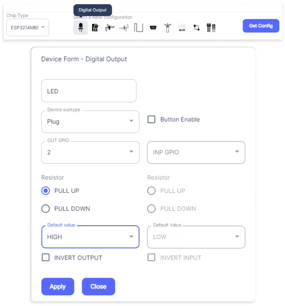

  2. In the Device Configuration, tab click on Digital Output.
  1. A Digital Output window will open for inputting the following parameters:
  • Set a device name of your choosing. In our case, we set it to LED.
  • Set Device subtype to Plug.
  • Set OUT GPIO to 2.
  • Set the Resistor to PULL UP.
  • Set the Default value to HIGH.
  • Then Click Apply Button.
  • After clicking the apply button you can see a table of your setting in the device configuration tab.

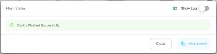

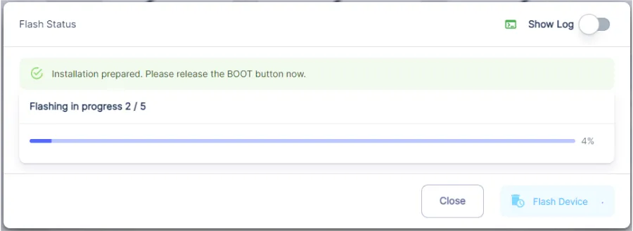

  • Press the Flash Device button.
  1. A window will appear on the bottom right side of the screen displaying “Please press BOOT button while flashing begins.”
  1. Hold the BOOT button down until the next window appears on the bottom right side of the screen which says “Installation prepared. Please release the boot button now.”
  1. Release the BOOT button from your ESP32 when this pop-up on the bottom right window appears.
  1. After some time, a popup will appear saying Device Flashed Successfully! This means that your device has been set up successfully.

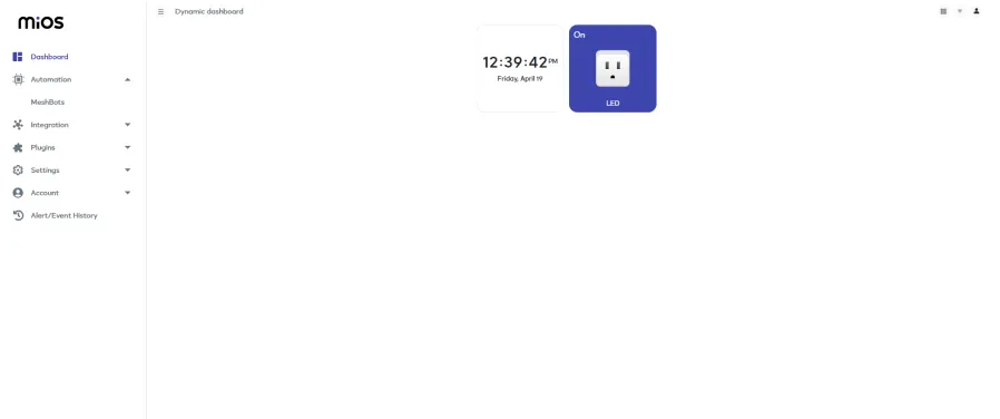

  1. On the MiOS web dashboard, you will be able to see the tile for the touch sensor and Neon light. These tiles show the status of touch sensor and the neon light.

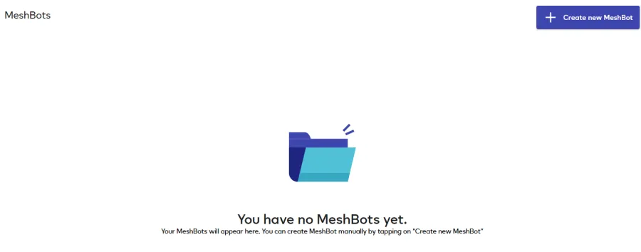

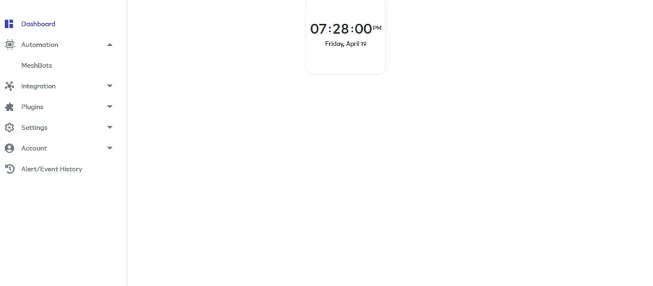

  1. On the right side of the screen under Automation, click on MeshBots.

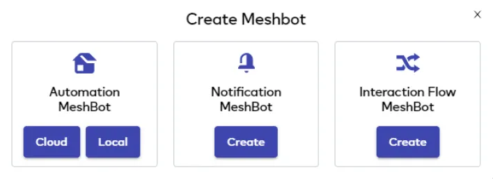

  1. On meshbot screen, click on Create new MeshBot button present on the top right corner of the screen.
  2. After clicking on Create new MeshBot you will see new options, now under Automation MeshBot click on Local.

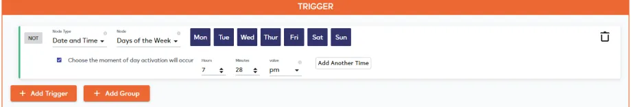

  1. In the trigger tab you can set the TRIGGER for your device and in the ACTION tab you can set the action to be performed based on the trigger which you have created.
  1. Set these things in TRIGGER section:
  • Set Node Type to Device.
  • Set the Node to Touch.
  • Set the Capability to Switch.
  • Set Armed State to Armed.
  • Set the Value to True.

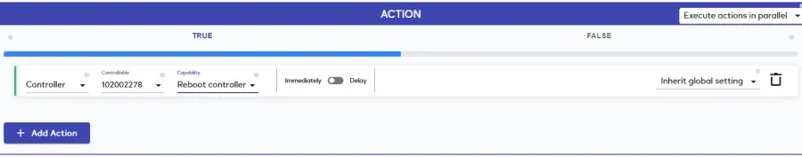

  1. Set these values in the True part of the ACTION section.
  • Set Controllable Type to Device.
  • Set the Controllable to Neon Light.
  • Set the Capability to switch.
  • Set the Value to true.
  1. Set these values in the False part of the ACTION section.
  • Set the Value to false.

  1. After opening the MiOS web dashboard, you will be able to see the tile of your connected device, in our case, the touch sensor and neon light. When the touch sensor is not touched, it will not trigger the neon light.

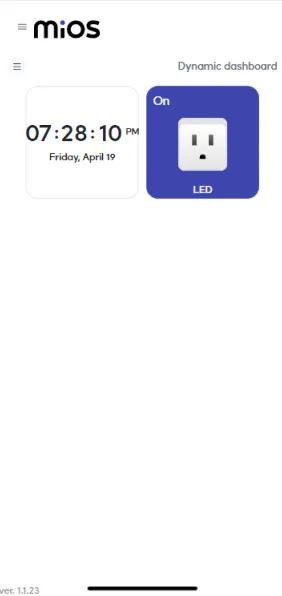

  1. After successfully logging in, you will be able to see the number of controllers connected such as a lamp, fan, or any other device in the MiOS app. Tap on any controller of your desired ID:
  1. You will be able to see the status of your controller whether it is online or offline. Access the device dashboard, and tap the device. The following view of the dashboard will appear:
  1. After opening the MiOS mobile dashboard, you will be able to see the tile of your connected device, in our case the touch sensor and neon light. When the touch sensor is not touched, it will not trigger the neon light.
  1. Similarly, it can be seen that when the touch sensor is touched, the neon light gets triggered. This is because of the meshbot rules we have set earlier.
