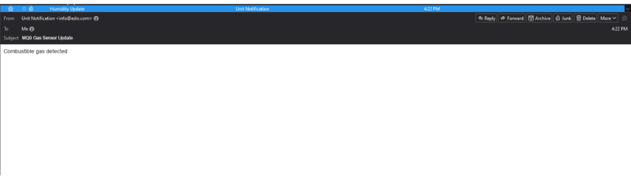

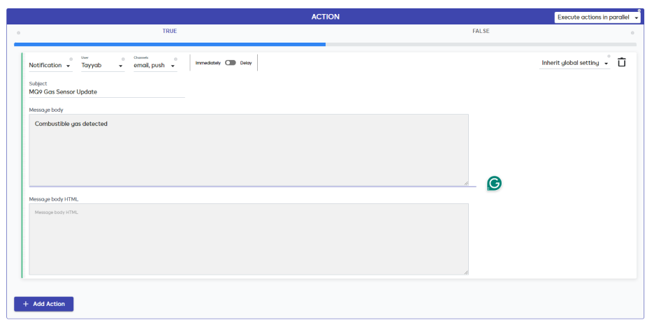

The project aims to enhance air quality monitoring capabilities by interfacing the MQ-9 gas sensor with the EzloPi smart device. This integration enables real-time detection of various gases present in the environment, allowing users to monitor air quality levels efficiently. Moreover, this smart gas detection system is designed to send instant notification alerts via email when the sensor detects any hazardous gases, ensuring timely response to potential safety hazards. This project can be deployed anywhere whether it be your home for smart safety, office or industrial environment.

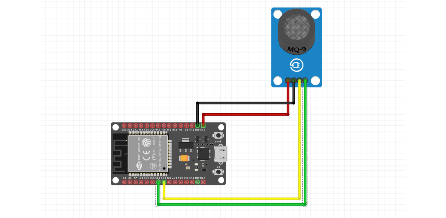

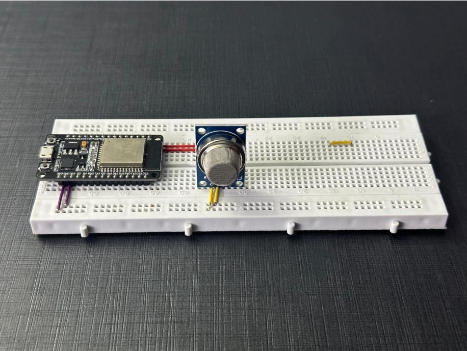

The wiring diagram for the ESP32 30 pin is represented as below:
From ESP32 to the MQ-9 gas sensor:

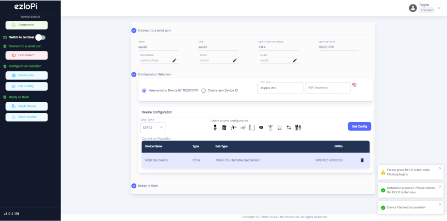

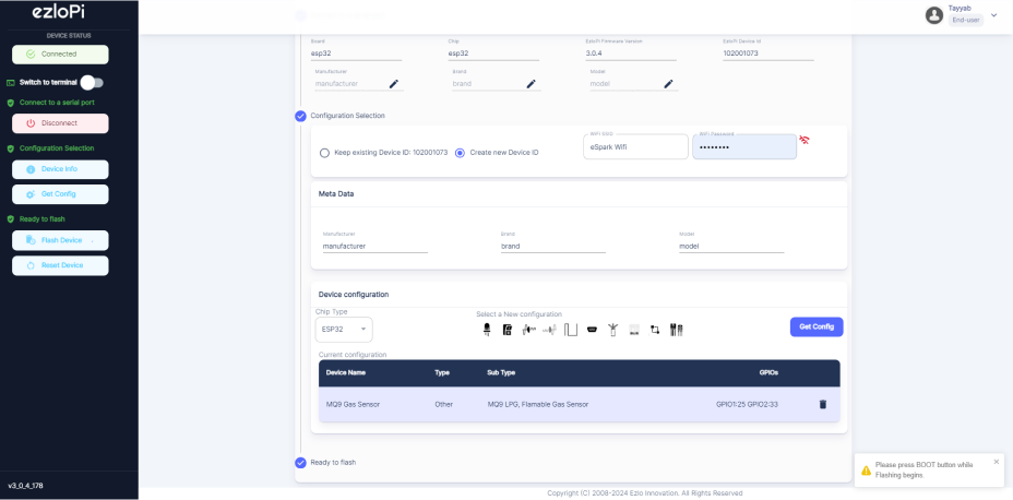

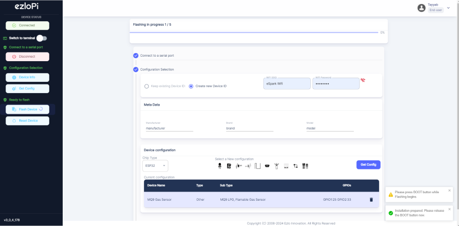

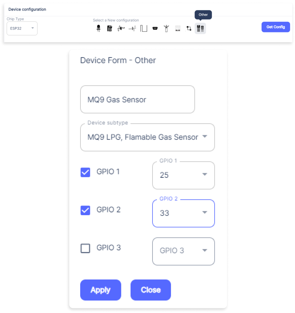

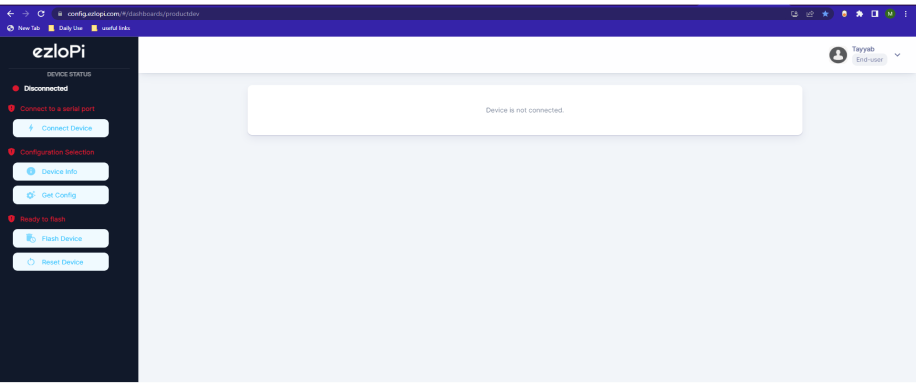

Set up your device/hardware by visiting config.ezlopi.com

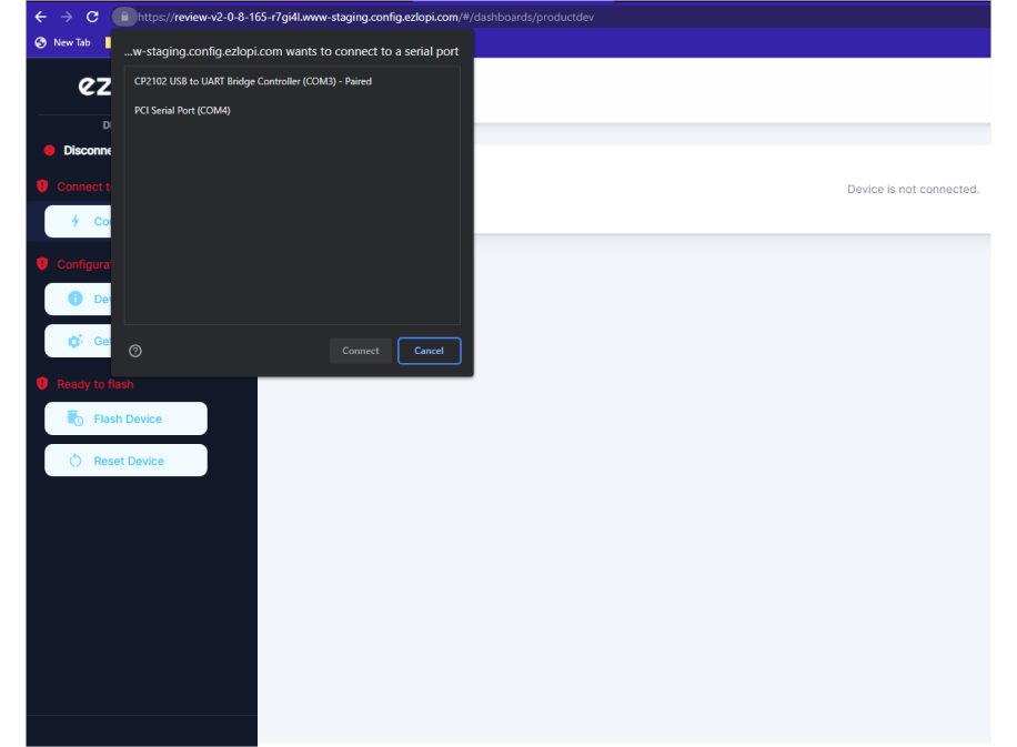

Now, select COM Port to which your ESP32 device is connected. In our case, the COM3 port is used.
Click Connect.
