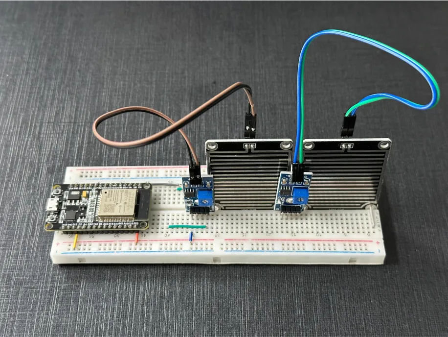

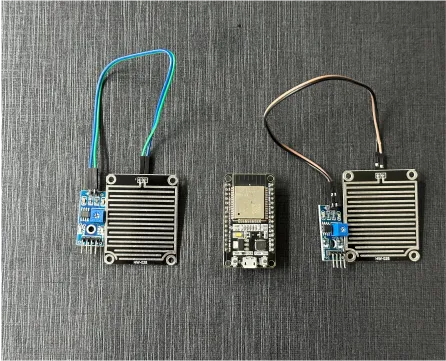

- Arduino Nano ESP32 as an EzloPi smart device.
- 2 x LM393 comparator IC module.
- 2 x FC-37 rain sensor module.

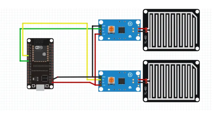

The wiring diagram of Arduino Nano ESP32 is represented as follows:
The following connections are made in order to complete the entire circuit setup:
From Arduino Nano ESP32 to the LM393 comparator module:
- Connect the VCC of the Arduino Nano ESP32 with the VCC of both the LM393 modules.
- Connect the GND pin of the Arduino Nano ESP32 to the GND pin of both the LM393 modules.
- Connect the ESP32 GPIO 33 and 34 to the A0 of both of the modules.
From the LM393 module to the Rain Sensor:
- Connect any of the output pins of both rain sensors to the positive and negative terminal of the comparator module respectively.

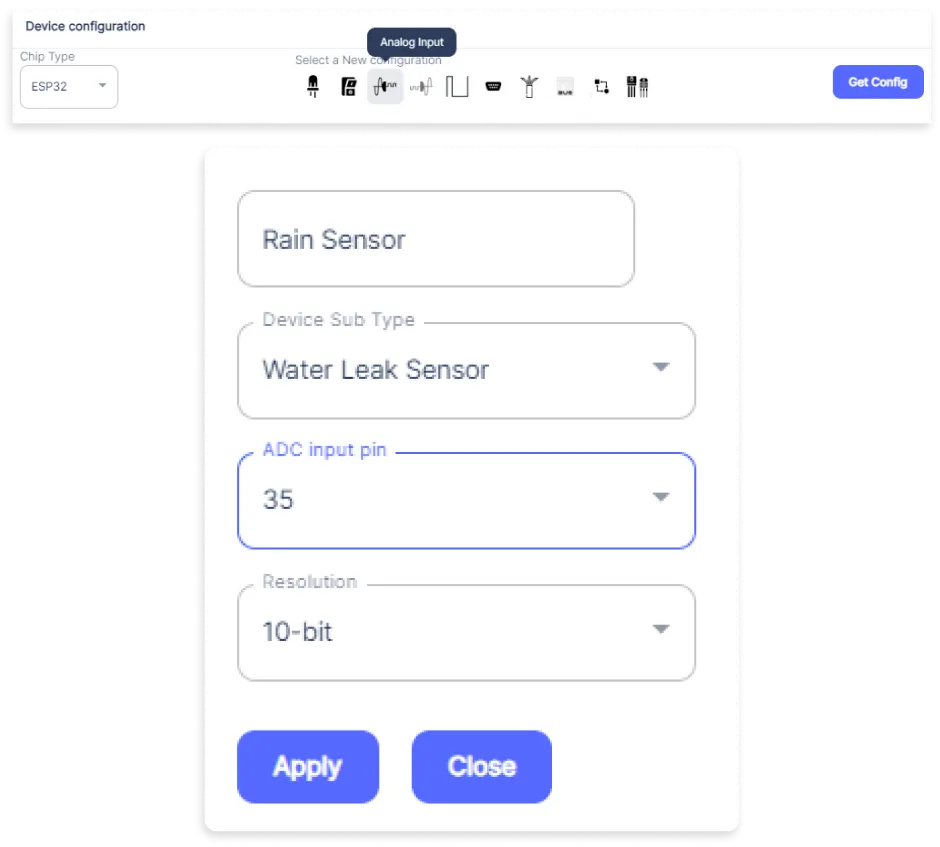

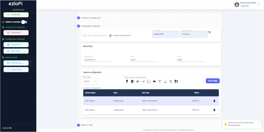

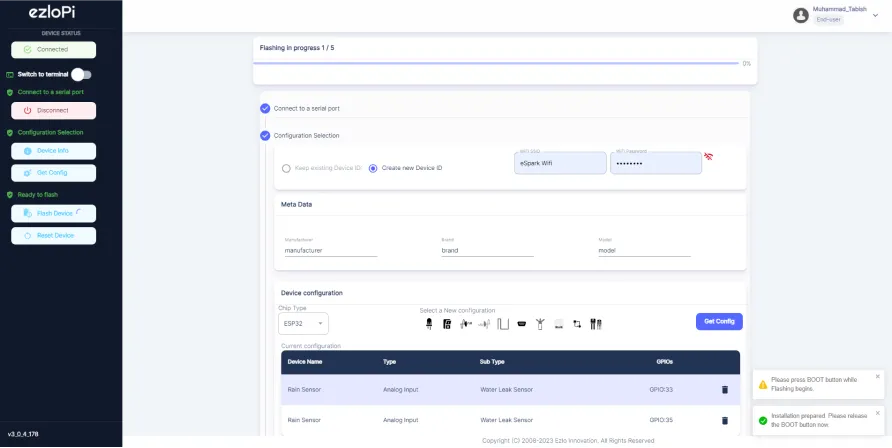

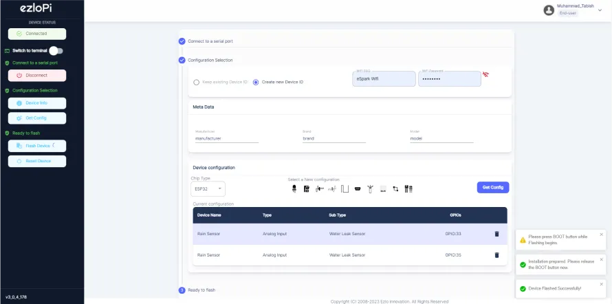

4. Interfacing the Rain Sensors using the EzloPi Web Flasher:
Now, select COM Port to which your ESP32 device is connected. In our case, the COM3 port is used.
Click Connect.
- In the Device Configuration, tab click on Analog Input.
- An Analog Input window will open for inputting the following parameters:
- Set a device name of your choosing. In our case, we set it to the Rain Sensor.
- Set device Subtype to Water leak Sensor.
- Set the ADC input pin to 33.
- Set the Resolution to 10-bit.
- Now Click the Apply button.

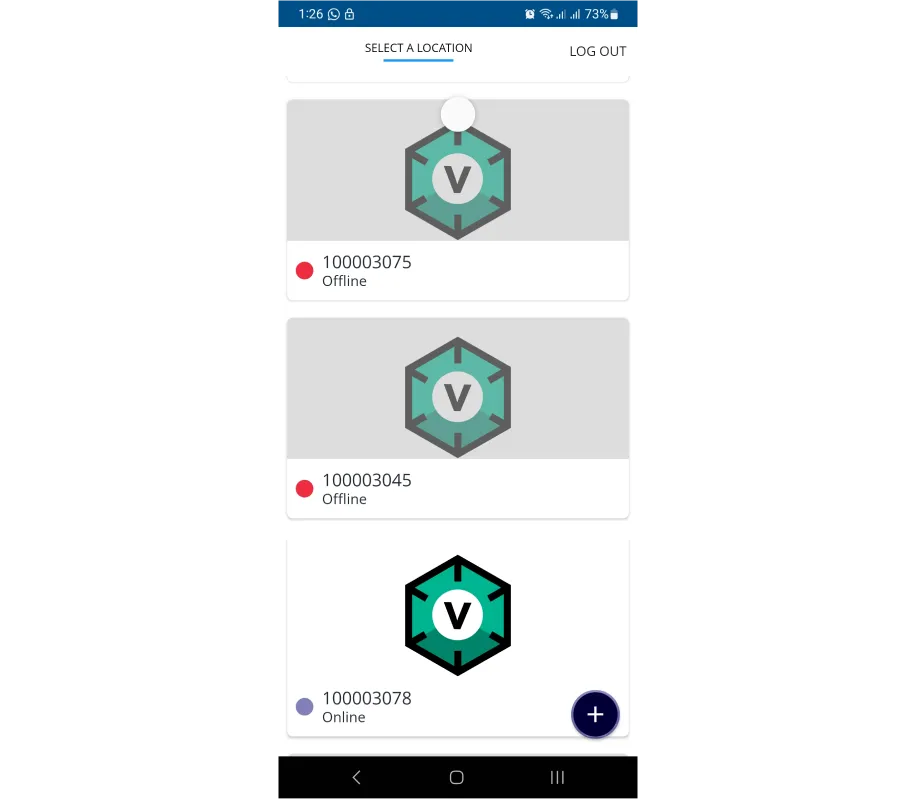

5. MiOS App
- After opening the MiOS mobile app dashboard, you will be able to see the tile of your connected device. The state of the 2-channel relay module is controlled by just touching the tile button as shown on the app.

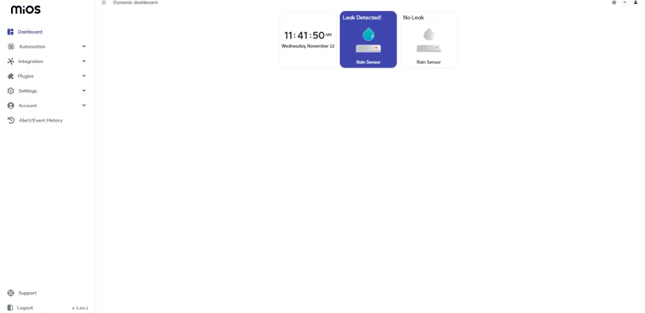

6. MiOS Web Application
- As you can see in the MiOS web dashboard, we can see two rain sensor tiles. One tile shows a “Leak detected” message on the tile for when the sensor is detecting any raindrops or rain water, meanwhile the other tile is showing a “No Leak” message on the tile as the sensor is not detecting any raindrops or rain water.
