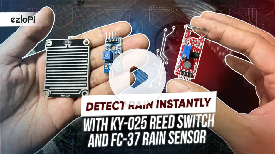

Rain flooding detection system
The project, using the KY-025 reed switch module and FC-37 rain sensor with the EzloPi device, is designed to provide early alerts for potential flooding. The FC-37 rain sensor detects the presence and intensity of rain, while the KY-025 Reed switch module helps monitor water levels, triggering alerts when water reaches a certain height. This setup can be integrated with an alarm or notification system, enabling proactive measures to mitigate damage. Compact and efficient, this system is ideal for monitoring areas prone to heavy rainfall or flooding, enhancing response times and safety.
Welcome to the project demonstration video section. The following video showcases the key aspects of Rain flooding detection system, providing a visual walkthrough of its implementation.
- ESP32 as an EzloPi smart device.
- KY-025 Reed switch module.
- FC-37 rain sensor module with LM393 comparator IC module.
