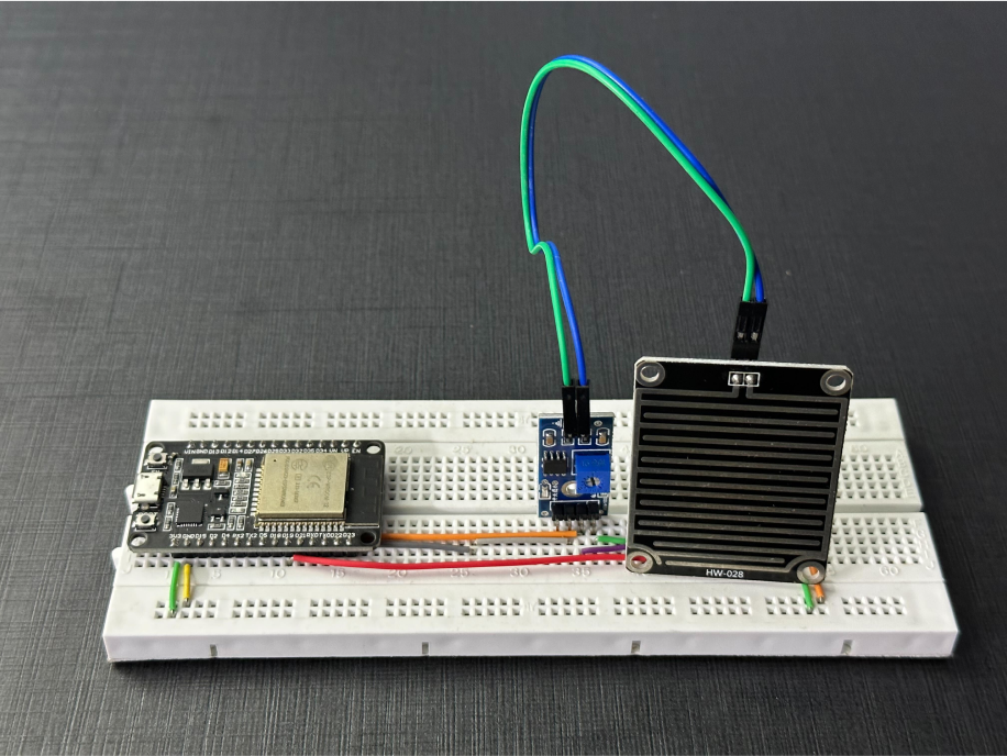

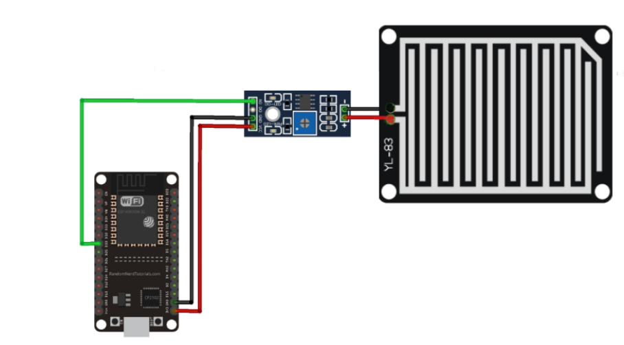

- LM393 comparator IC module.
- FC-37 rain sensor module.
The wiring diagram of ESP32 is represented as follows:
From ESP32 to the LM393 comparator module:
From the LM393 module to the Rain sensor:

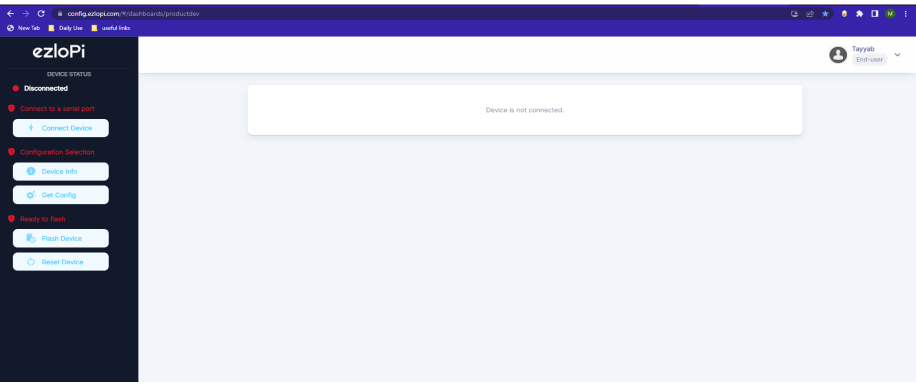

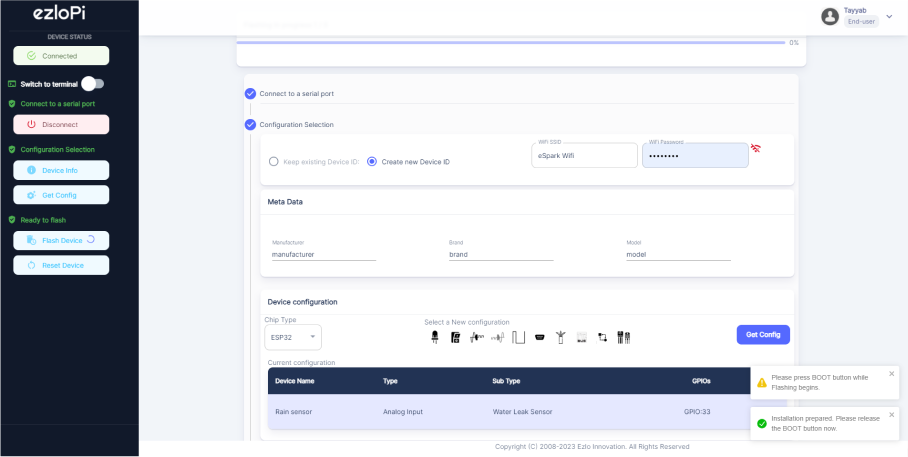

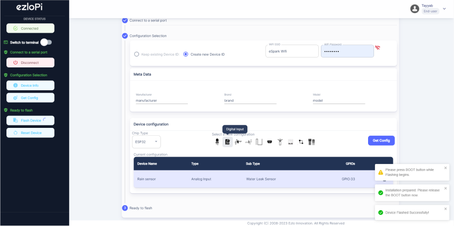

4. Interfacing the Rain Sensor with the EzloPi Web Flasher:

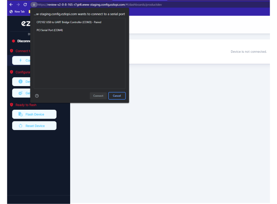

Set up your device/hardware by visiting config.ezlopi.com
Now, select COM Port to which your ESP32 device is connected. In our case, the COM3 port is used.
Click Connect.

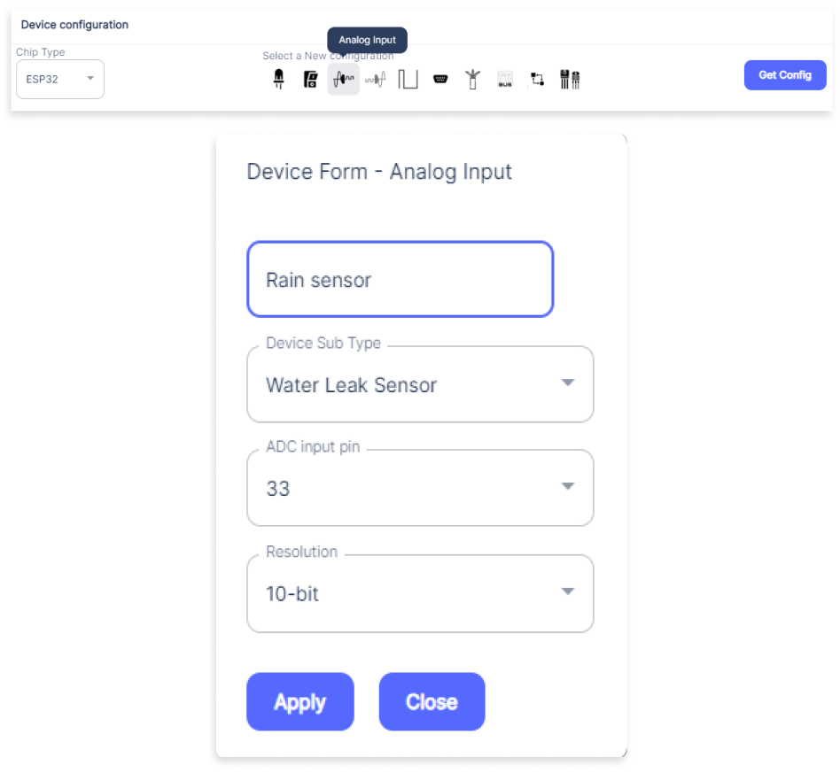

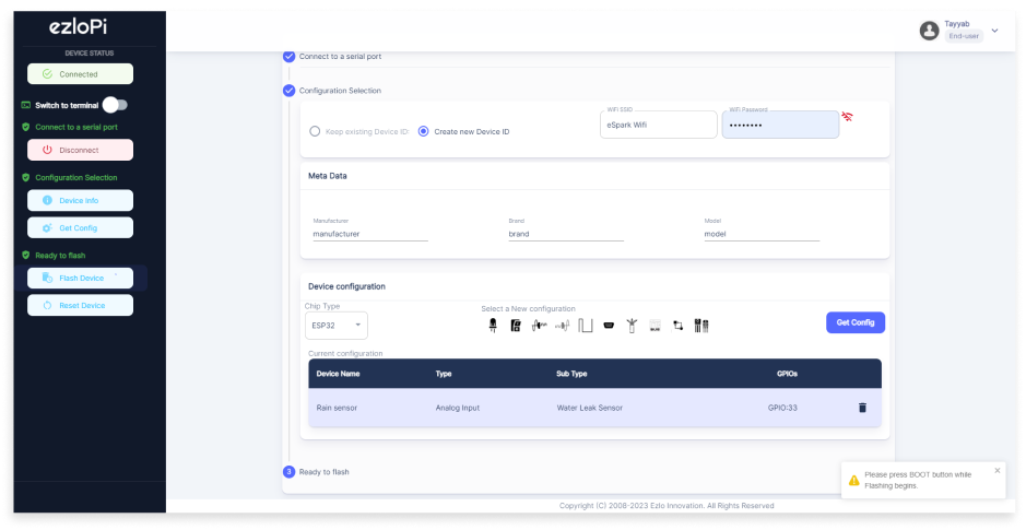

- In the Device Configuration, tab click on Analog Input.
- An Analog Input window will open for inputting the following parameters:
- Set a device name of your choosing. In our case, we set it to the Rain Sensor.
- Set device Subtype to Water Leak Sensor.
- Set the ADC input pin to 33.
- Set the Resolution to 10-bit.
- Now Click the Apply button. After clicking the apply button you can see a table of your setting in the device configuration tab.

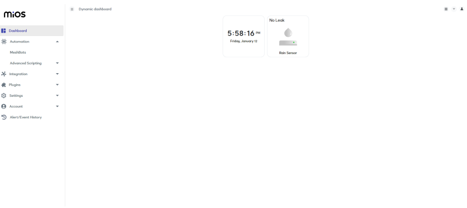

5. MiOS Web Application
- Here, as you can see in the MiOS web dashboard, we can see the motion sensor tile. The above figure is indicating that motion is not being detected by the sensor.

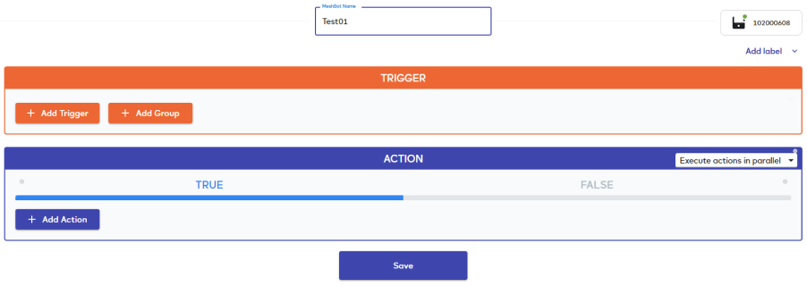

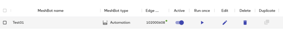

MeshBots:
- On the right side of the screen under Automation, click on MeshBots.
- After clicking on Create new MeshBot you will see this now under Automation MeshBot click on Cloud.
- On the next screen you will see that we can create a name of our choosing, in this case we write it as Test01 Sensor.

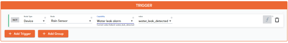

- Set Node Type to Device.
- Set the Node to Rain sensor.
- Set the Capability to Water leak alarm.
- Set the Value to water_leak_detected.

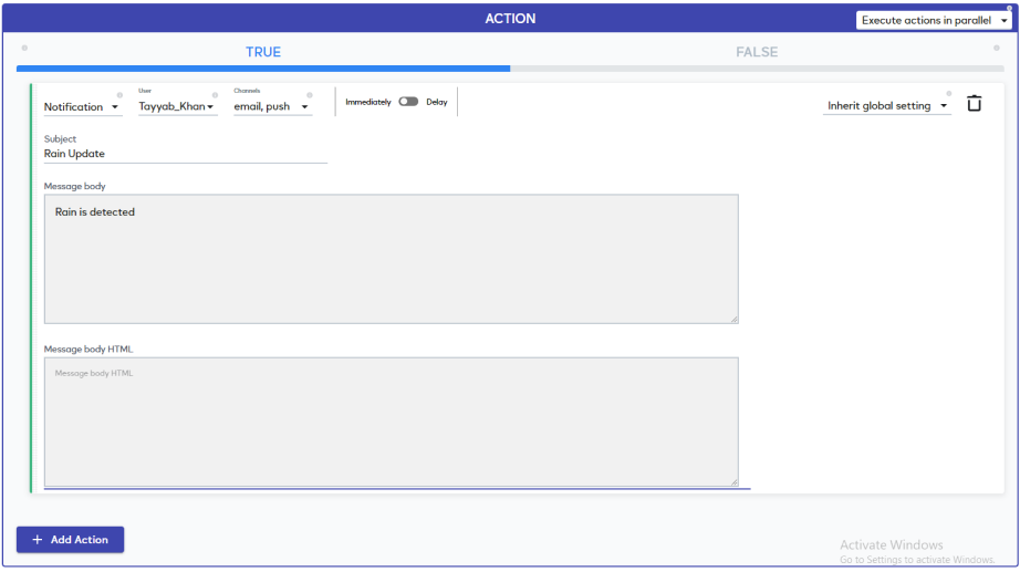

- Set these values in the ACTION section.
- Set Controllable Type to Notification.
- Set the User to Your user account but in our case the user account is Tayyab.
- Set the Channels to email,push.
- Set the Subject to Rain Update.
- Set the Message body info to Rain is detected.
- After clicking the apply button you can see a table of your setting in the Current configuration tab.

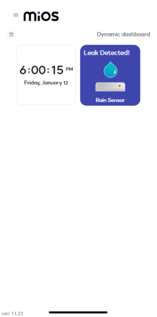

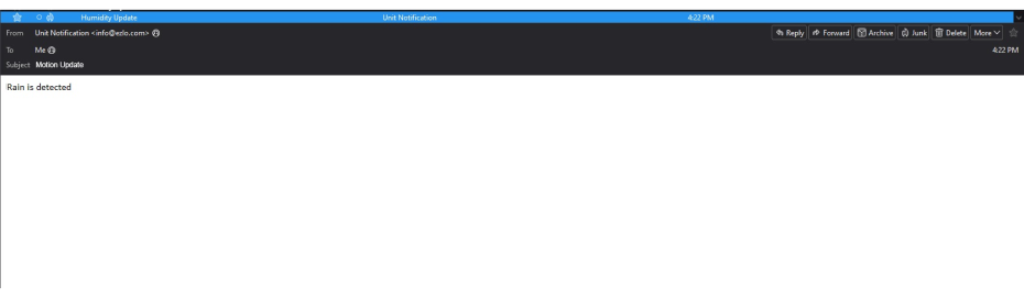

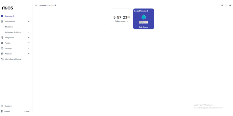

- It shows a “Rain Detected” or “Leak detected” message on the tile when the sensor detects any raindrops or rain water. Therefore, an email is sent to the user to notify them about the rain.
6. MiOS App

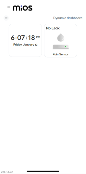

- After opening the MiOS mobile dashboard, you will be able to see the tile of your connected device. Currently, no rain drops are detected by the sensor therefore the rain sensor tiles show the “No Rain" or “No Leak” message.
