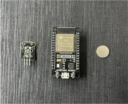

- KY-025 Reed Switch module.

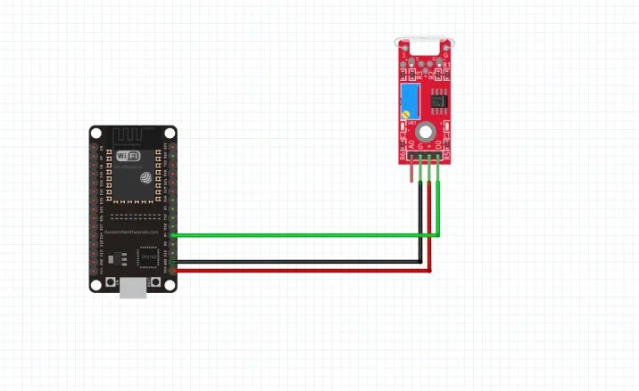

The wiring diagram of ESP32 is represented as follows:

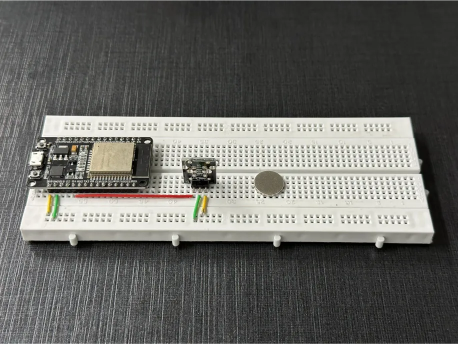

The following connections are made in order to complete the entire circuit setup:
From ESP32 to the KY-025 Reed Switch module:
- Connect the VCC of the ESP32 with the VCC of the KY-025 module.
- Connect the GND pin of the ESP32 to the GND pin of the KY-025 module.
- Connect the ESP32 GPIO D4 to the D0 of the KY-025 module.

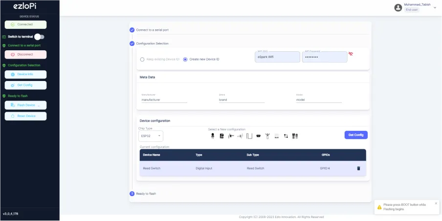

Now, select COM Port to which your ESP32 device is connected. In our case, the COM3 port is used.
Click Connect.

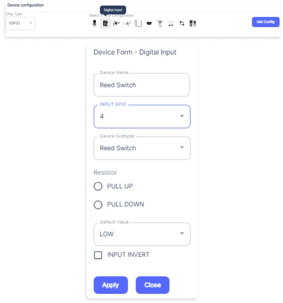

- An Digital Input window will open for inputting the following parameters:
- Set a device name of your choosing. In our case, we set it to Reed Switch
- Set device Subtype to Reed Switch.
- Set the ADC input pin to 4.
- Now Click the Apply button.

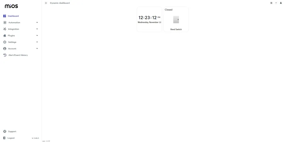

- After opening the MiOS mobile dashboard, you will be able to see the tile of your connected device.

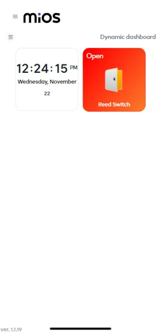

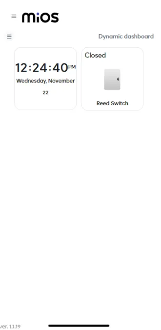

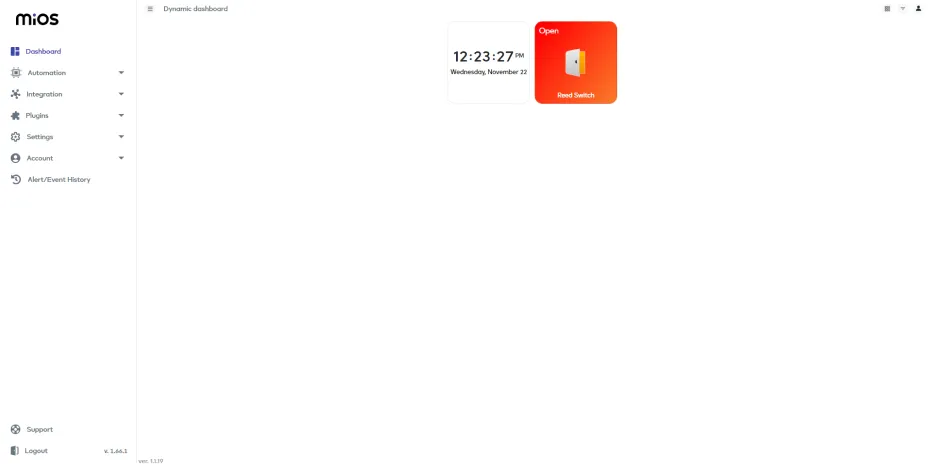

- As you can see in the example given above, we can see the Reed Switch module tile. It shows a “Closed” message on the tile as the sensor is not detecting any magnetic field.
- Similarly, It shows an “Open” message on the tile when the sensor detects magnetic fields.
