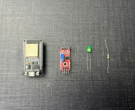

- KY-025 Reed Switch.
- LED with 100 Ohms resistor.

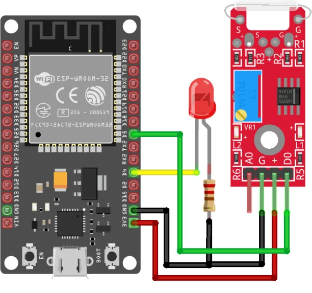

From ESP32 to the KY-025 Reed Switch:
| ESP32 | Reed Switch |
| 3V3 | +(VCC) |
| GND | G (GND) |
| D5 | D0 |
From ESP32 to the LED & Resistor:
| ESP32 | LED | Resistor |
| D5 | Anode | - |
| GND | - | 1st Terminal |
| - | Cathods | 2nd Terminal |

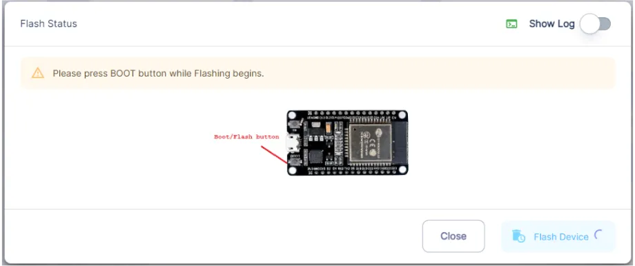

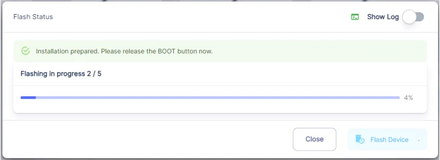

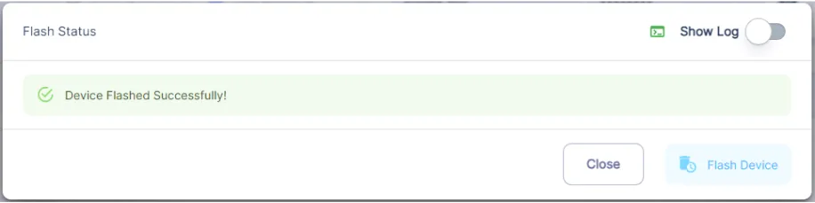

4. Interfacing the KY-025 Reed Switch module with LED using the EzloPi Web Flasher:
Click Connect

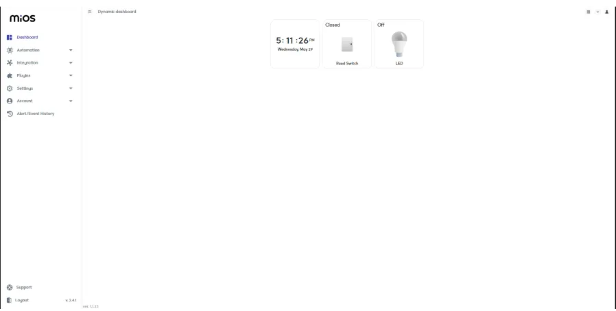

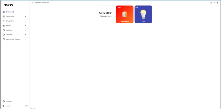

5. MiOS Web Dashboard
- As seen in the MiOS web dashboard above, the reed switch and LED tiles are visible.

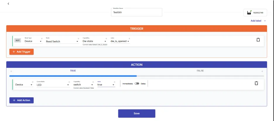

MeshBots:

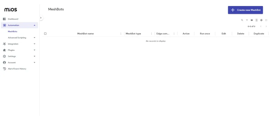

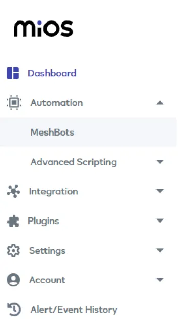

- On the right side of the screen under Automation, click on MeshBots.
- After clicking on Create new MeshBot you will see new options, click on EzloPi.
- On the next screen you will see that we can create a name of our choosing, in this case we write it as Test001.
- Set these values in TRIGGER section:
- Set Node Type to Device.
- Set the to Reed Switch.
- Set the Capability to Dw state.
- Set the value to dw_is_opened.
- Set these values in the True part of the ACTION section.
- Set Controllable Type to LED.
- Set the Capability to Switch.
- Set the value to true.

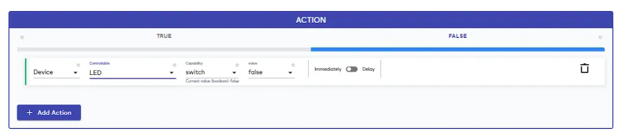

- Set these values in the False part of the ACTION section.
- Set the value to false.

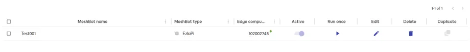

- After clicking the apply button you can see a table of your setting in the Current configuration tab.
- Here, it can be seen that the reed switch tile turns on which indicates that it is detecting some magnetic field, then the LED also turns on because of the rules we have set in the meshbot.
6. MiOS App
- After opening the MiOS mobile dashboard, you will be able to see the tile of your connected device. We can see the KY-025 Reed switch tile and LED tile.
