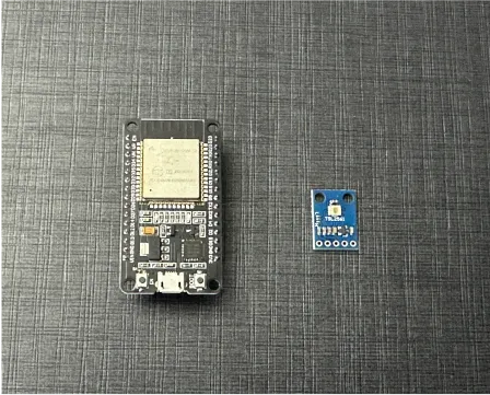

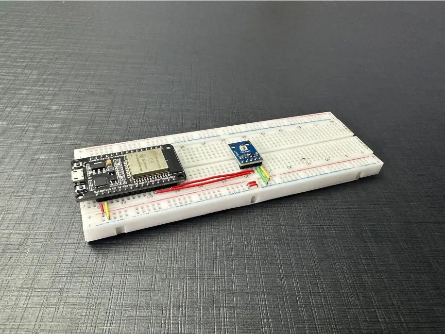

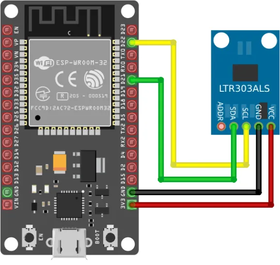

From ESP32 to the LTR303ALS Luminosity sensor:
| ESP32 | LTR303ALS |
| 3V3 | VCC |
| GND | GND |
| D21 | SDA |
| D22 | SCL |

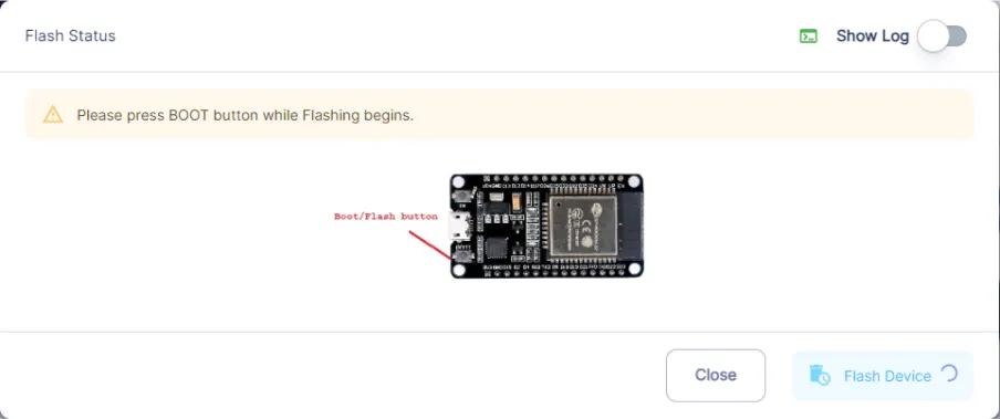

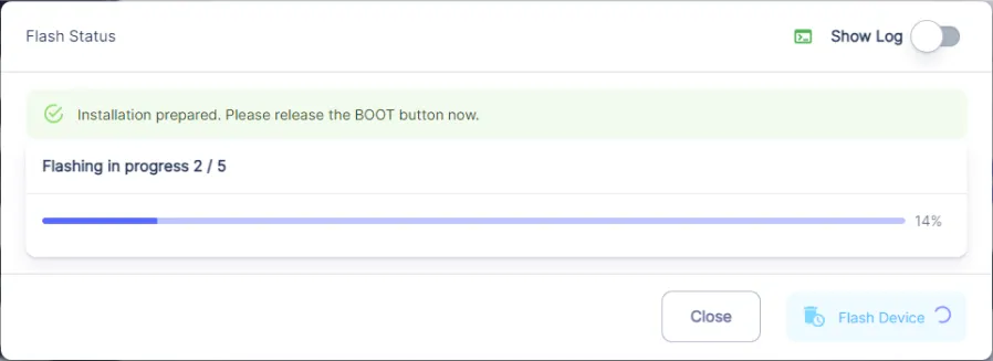

4. Interfacing the Light/Luminosity Sensor (LTR303ALS) using the EzloPi Web Flasher
Click Connect

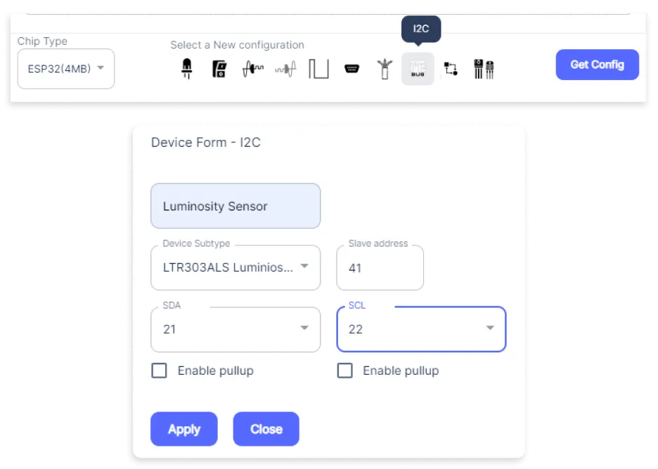

- In the Device Configuration, tab click on I2C.
- A I2C window will open for inputting the following parameters:
- Set a device name of your choosing. In our case, we set it to Luminosity Sensor.
- Set Device subtype to LTR303ALS Luminosity Sensor.
- Set Slave address to 57.
- Set SDA pin to GPIO21.
- Set SCL pin to GPIO22.
- Now, Click the Apply button.

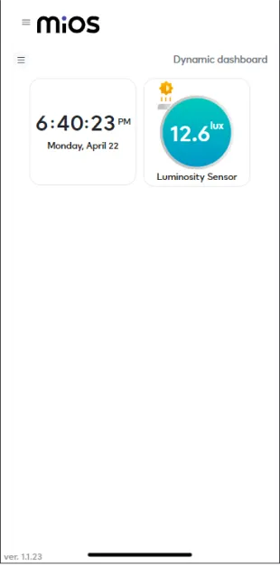

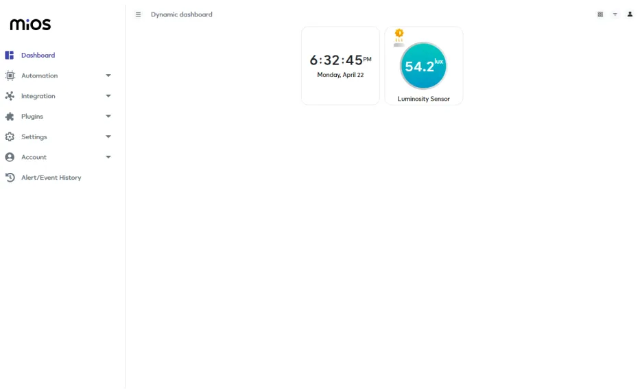

- Here, as seen in the MiOS mobile app above, we can see the Luminosity sensor tile. The above figure indicates that very little amount of light is being detected by the sensor as it shows the value of intensity of light being measured.

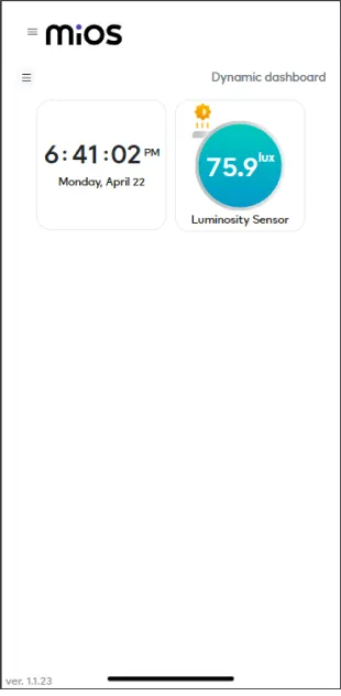

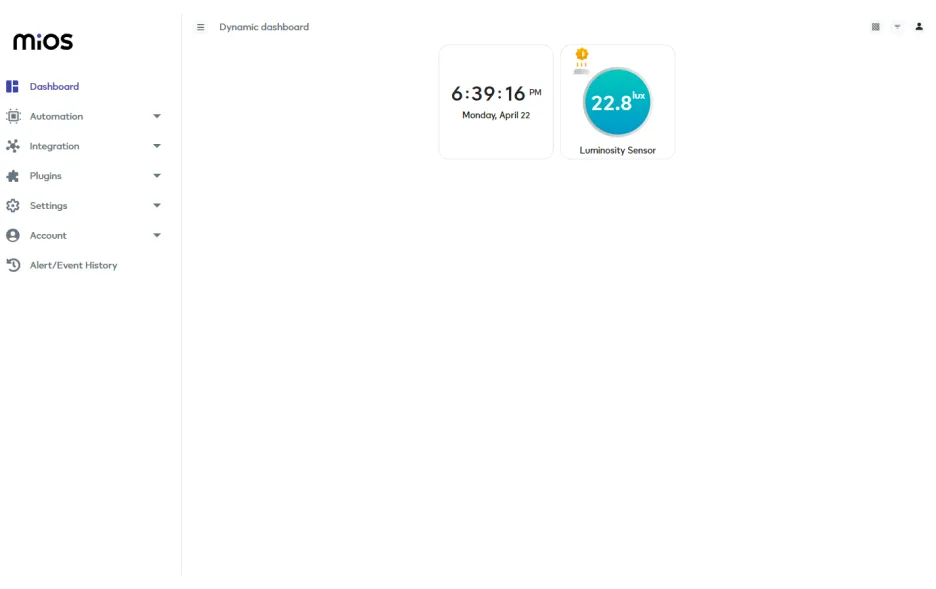

- Here, it can be seen that now more light is being detected by the Luminosity sensor, as the amount of light detected by the sensor has increased.

- Here, as seen in the MiOS web app above, we can see the Luminosity sensor tile. The above figure indicates that very little amount of light is being detected by the sensor as its tile shows the value of intensity of light being measured.
