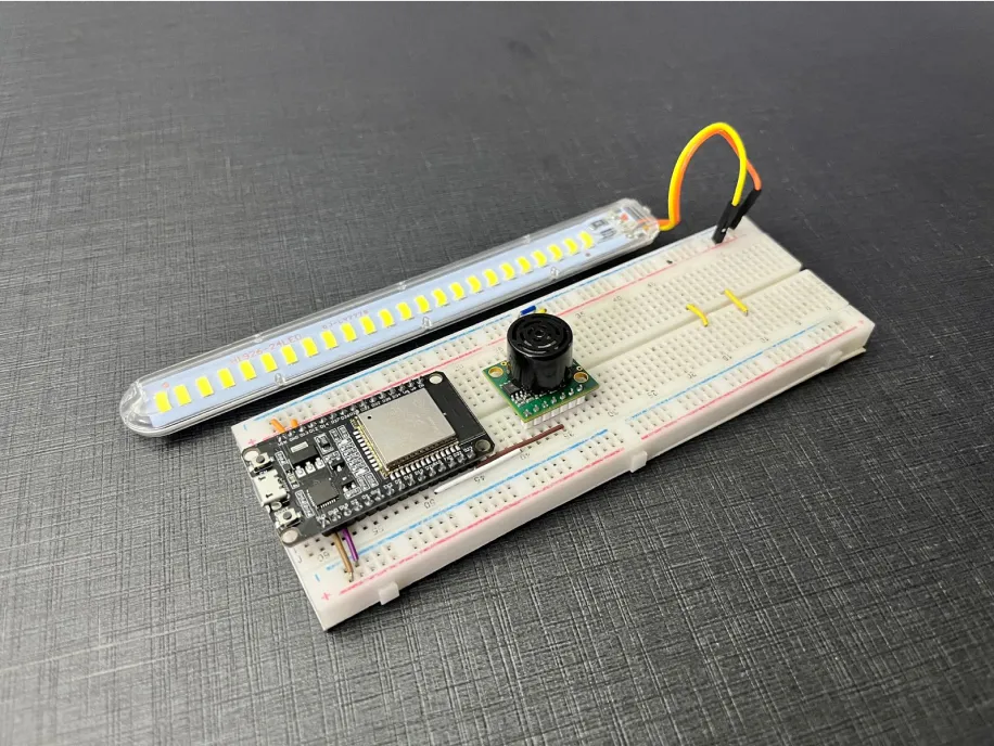

This project demonstrates the development of a parking assistance system using the MB1013 sonar sensor integrated with the EzloPi device. The sonar sensor will measure the distance between the vehicle and obstacles or the wall of the garage, providing real-time feedback to the driver by triggering the neon LED strip. The EzloPi device will process this data and trigger alerts, ensuring safe and precise parking. The system aims to enhance parking accuracy and reduce the risk of collisions in tight spaces.
Welcome to the project demonstration video section. The following video showcases the key aspects of Parking assistance using MB1013 sonar sensor, providing a visual walkthrough of its implementation.

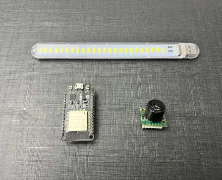

- MB1013 sonar sensor module.
- XY-MOS, high-power dual MOSFET driver module.
- 24-LED Mini portable lamp.

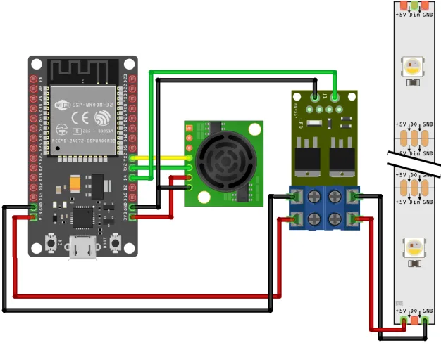

From ESP32 to the MB1013 module:
ESP32 | MB1013 |
3V3 | VCC |
GND | GND |
D16 (RX) | Tx |
D17 (TX) | Rx |
From ESP32 to the MOSFET driver module:
ESP32 | MOSFET driver module |
D5 | Trig |
GND | GND |
From MOSFET driver module to LED Strip:
MOSFET Driver | LED Strip |
OUT+ | 5V |
OUT- | GND |

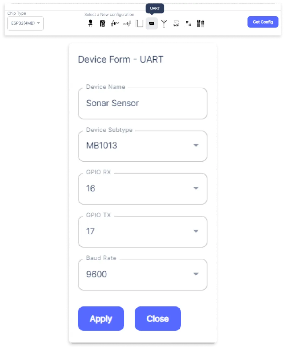

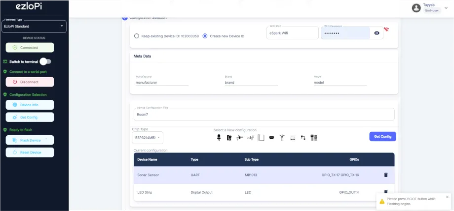

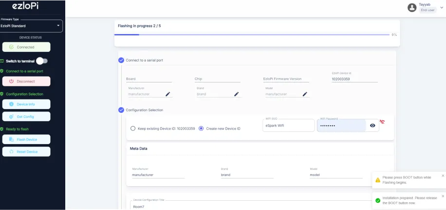

4. Interfacing the MB1013 Sonar sensor module using the EzloPi Web Flasher
Click Connect

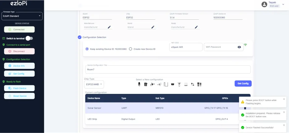

- In the Device Configuration, tab click on UART.
- A window will open for inputting the following parameters:
- Set a device name of your choosing. In our case, we set it to Sonar Sensor.
- Set Device subtype to MB1013.
- Set GPIO RX to 16.
- Set GPIO TX to 17.
- Set Baud Rate to 9600.
- Then Click Apply Button.

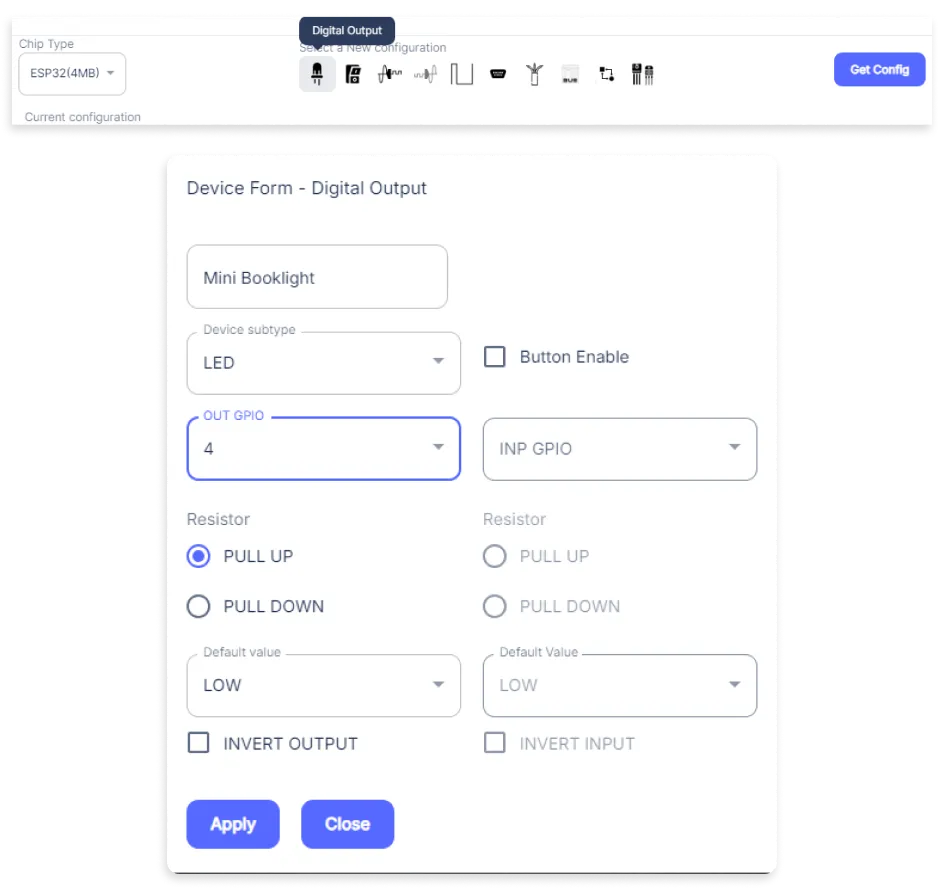

- Again click on Digital Output in the configuration tab. A Digital Output window opens for inputting the following parameters:
- Set a device name of your choosing. In our case, we set it to LED Strip.
- Set Device subtype to LED.
- Set OUT GPIO to 4.
- Set the Resistor to PULL UP.

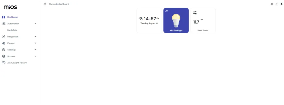

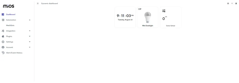

5. MiOS Web Dashboard
- In the MiOS web dashboard, you will be able to see the tiles for the MB1013 sonar sensor and the Mini Booklight. These tiles will indicate the status of the mini book light depending on the output of the sonar sensor when it detects an obstacle or an object.

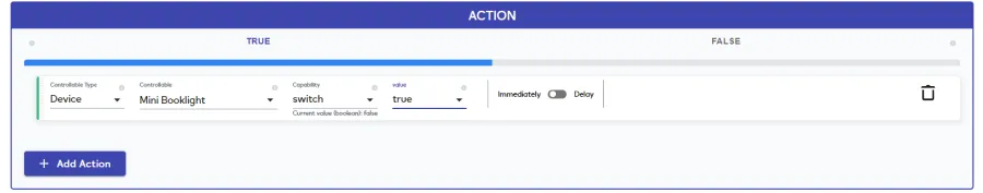

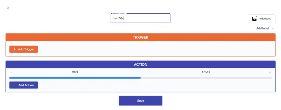

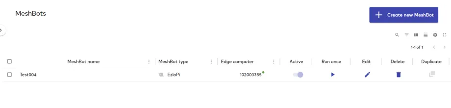

MeshBots:
- After clicking on Create new MeshBot, you will see this now under Automation MeshBot click on EzloPi.
- On the next screen you will see that we can create a name of our choosing, in this case we write it as Test004.

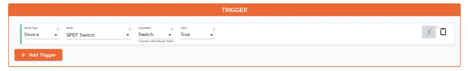

- Set Node Type to Device.
- Set the Node to SPDT Switch.
- Set the Capability to True.
- Set Controllable Type to Device.
- Set the Controllable to Mini Booklight.
- Set the Capability to switch.
- Set the Value to true.
- Now Click the Save button.

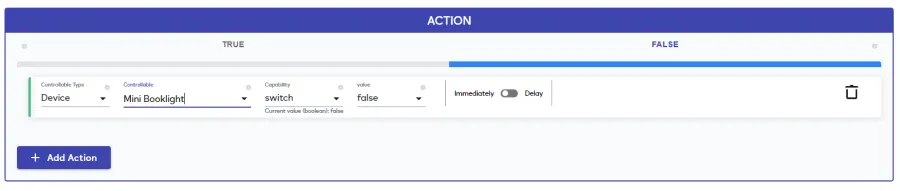

- Set the Value to false.

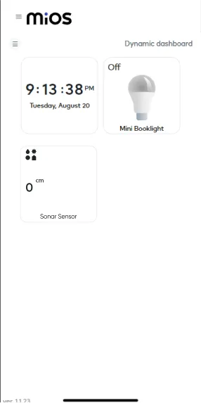

- Now, on the MiOS web dashboard, you can see that when the sonar sensor detects an obstacle or an object, the mini book light is turned ON because of the rules we have set in meshbot.

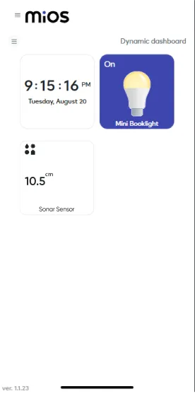

6. MiOS App
- Now, on the MiOS mobile dashboard, you can see that when the sonar sensor detects an obstacle or an object, the mini book light is turned ON because of the rules we have set in meshbot.
