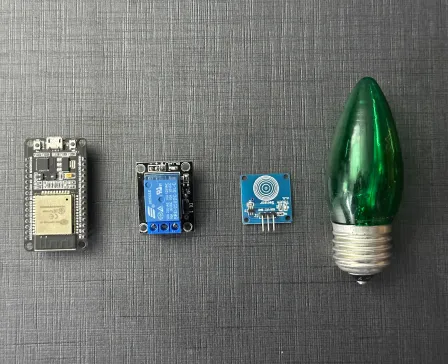

- TTP223B touch sensor.
- 5V Single-channel relay module.

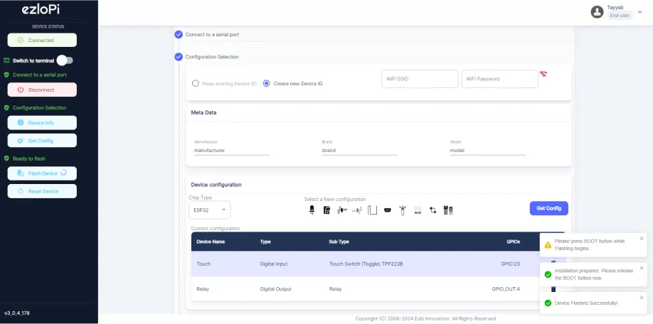

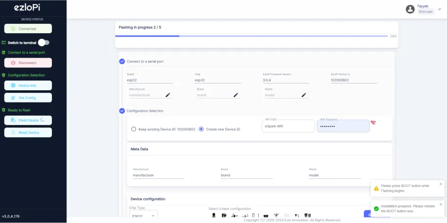

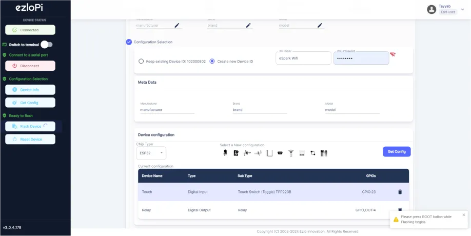

4. Interfacing the Touch sensor & relay using the EzloPi Web Flasher
Now, select COM Port to which your ESP32 device is connected. In our case, the COM3 port is used.
Click Connect.

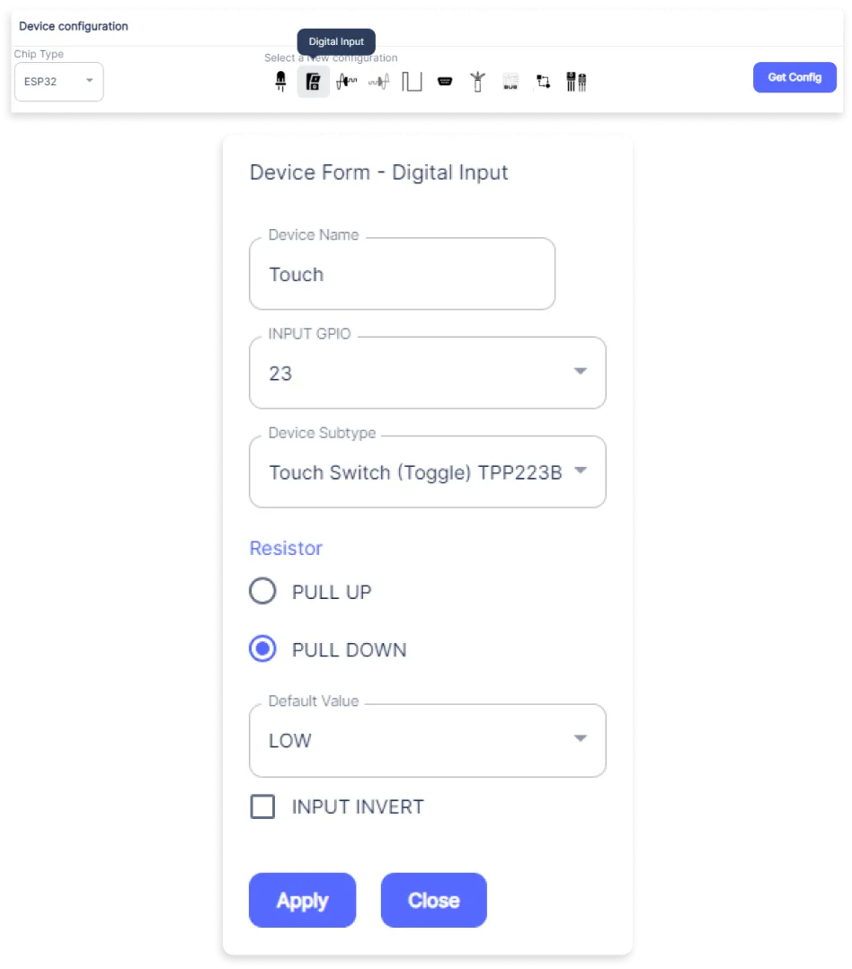

- A Digital Input window will open for inputting the following parameters:
- Set a device name of your choosing. In our case we set it to Touch.
- Set the Input GPIO to 23.
- Set Device Subtype to Touch Switch (Toggle) TPP223B.
- Now Click the Apply button.

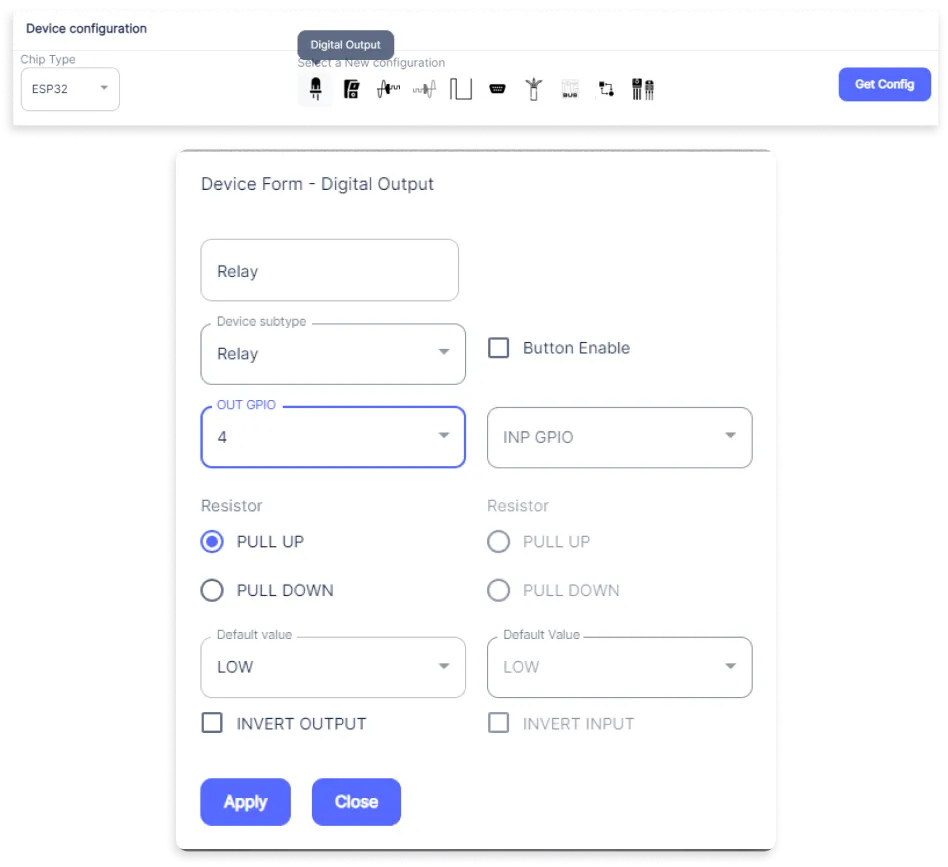

- Set a device name of your choosing. In our case, we set it to Relay.
- Set Device subtype to Relay.
- Set OUT GPIO to 4.
- Set Resistor to PULL UP.
- Set the default value to LOW.

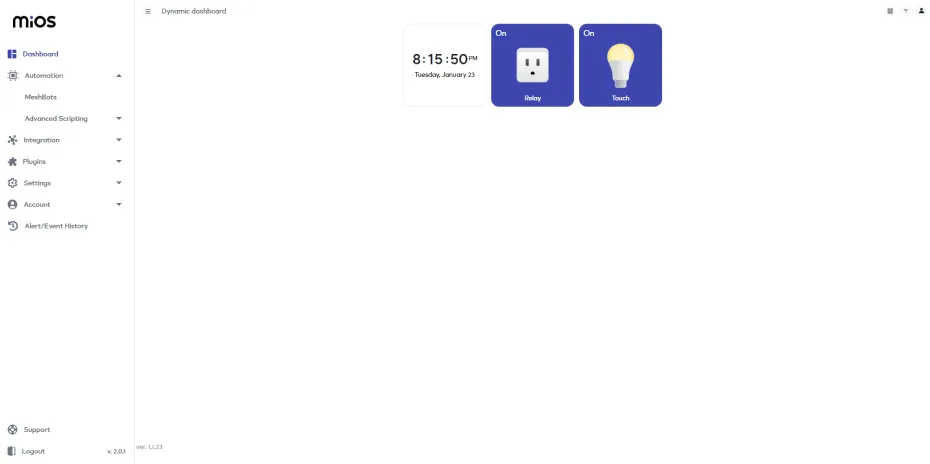

5. MiOS Web Application

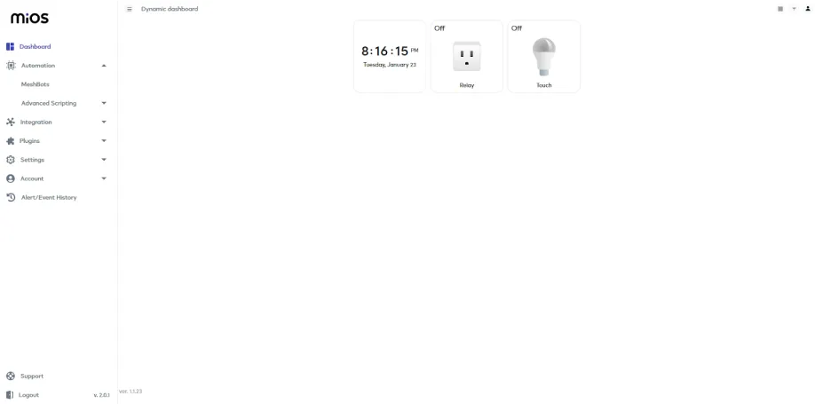

- Now, on the MiOS web dashboard, you will be able to see the tile for the touch sensor and the relay. The tile will indicate the status of the relay depending on whether the touch sensor is being operated.

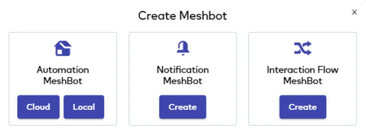

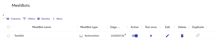

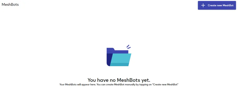

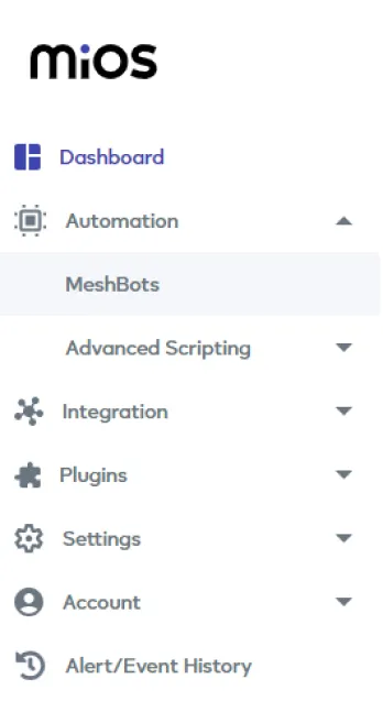

Meshbots
- On the right side of the screen under Automation, click on MeshBots.
- After clicking on Create new MeshBot you will see this now under Automation MeshBot click on Local.

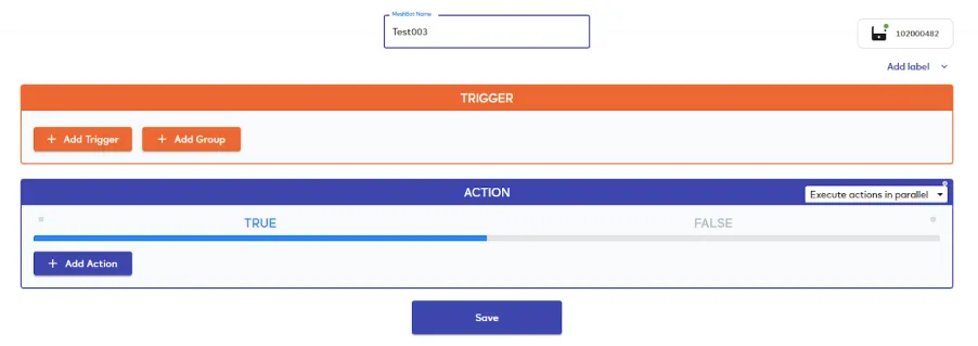

- On the next screen you will see that we can create a name of our choosing, in this case we write it as Test003.

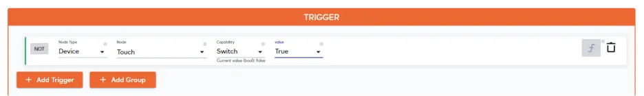

- Set Node Type to Device.
- Set the Node to Touch Sensor.
- Set the Category to Switch.
- Set the value to True.

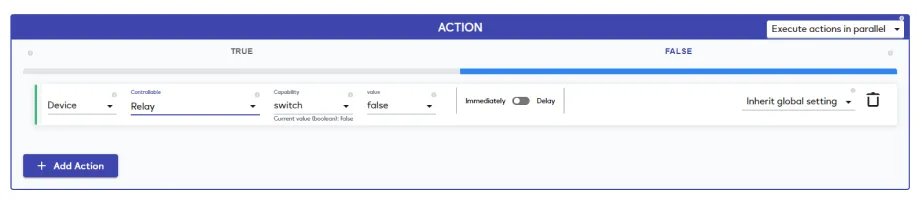

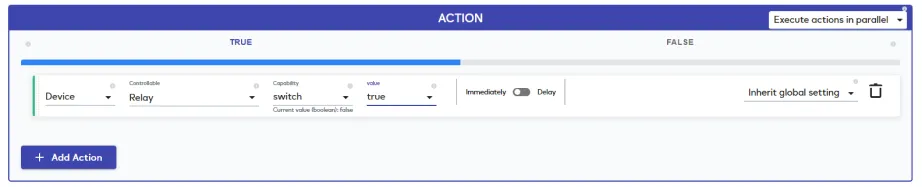

- Set Controllable Type to Device.
- Set the Controllable to Relay.
- Set the Capability to switch.
- Set the Value to true.
- Now Click the Save button.
- Set the Controllable to Buzzer.
- Set the Value to false.

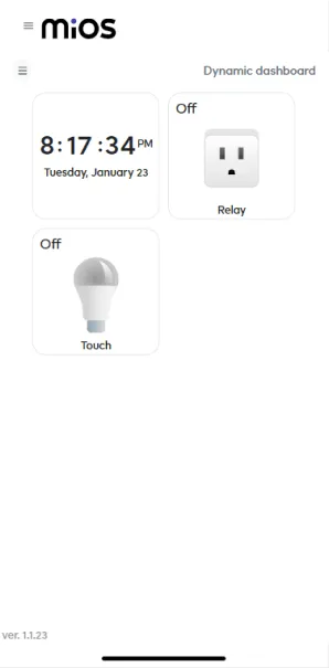

6. MiOS App

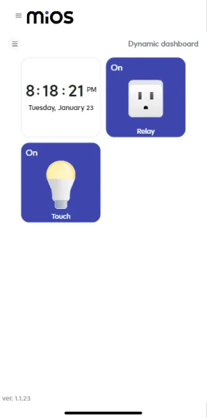

- Now, on the MiOS mobile dashboard, you will be able to see the tile for the touch sensor and the relay. Both will be functioning according to rules we have set in meshbot.
- Here, in the MiOS mobile dashboard, you can see that when the touch sensor is being given an input in the form of a touch, the relay is triggered because of the rules we have set in meshbot.
