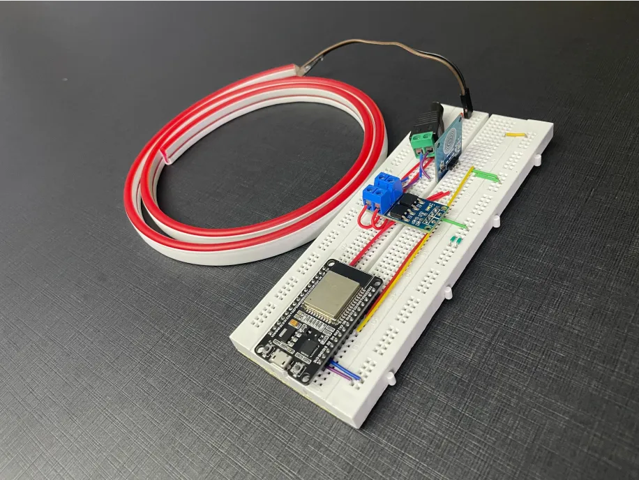

The project aims to create an interactive lighting system by interfacing a neon LED light strip and a TTP223B touch sensor with the EzloPi device. The EzloPi device enables seamless integration and control of the light strip. Through the touch sensor, users can intuitively interact with the light strip, triggering the operational state of the LED strip. The neon LED light strip offers vibrant and energy-efficient illumination, adding ambiance to any space. With the EzloPi's capabilities, users can remotely control the lighting system via the MiOS smart application or integrate it into a smart home ecosystem for enhanced automation. This project merges cutting-edge technology with user-friendly simple design, offering a dynamic and customizable lighting experience.
Welcome to the project demonstration video section. The following video showcases the key aspects of Operate a Neon Light with TTP223B touch sensor, providing a visual walkthrough of its implementation.

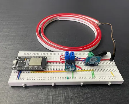

- ESP32 as an EzloPi smart device
- XY-MOS, high-power dual MOSFET driver module
- Flexible neon LED strip
- TTP223B Touch sensor
The wiring diagram is represented as follows:
From ESP32 to the MOSFET driver module:
ESP32 | MOSFET driver module |
D5 | Trig |
GND | GND |
From ESP32 to MOSFET driver module:
ESP32 | MOSFET driver |
VIN | VIN+ |
GND | VIN- |
From ESP32 to TTP223B Touch sensor:
ESP32 | TTP223B |
VIN | VIN+ |
GND | VIN- |

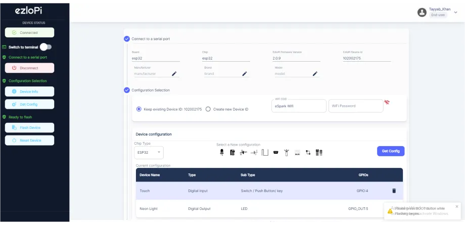

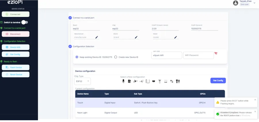

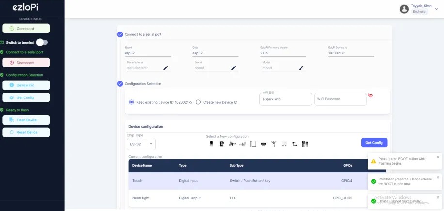

4. Interfacing the MC-38 Magnetic Door Switch module using the EzloPi Web Flasher:
Now, select COM Port to which your ESP32 device is connected. In our case, the COM3 port is used.
Click Connect.

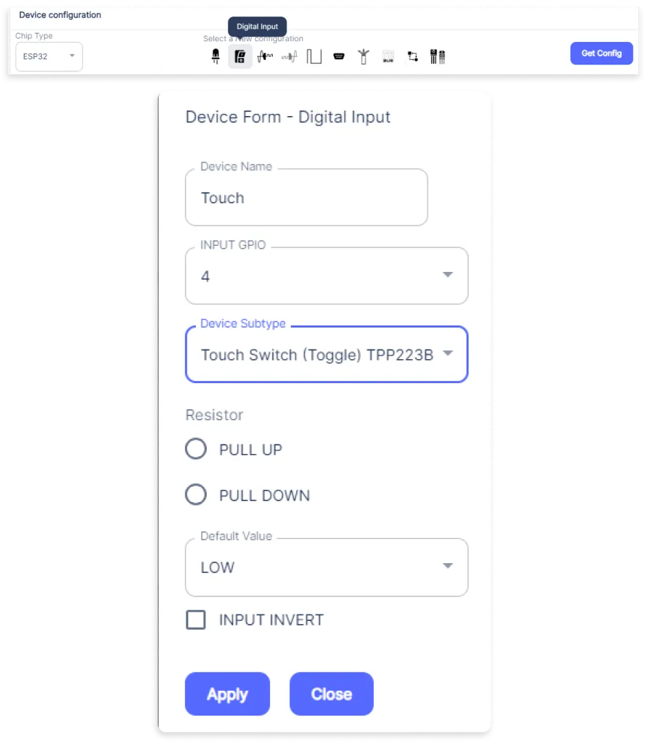

- A window will open for inputting the following parameters:
- Set a device name of your choosing. In our case, we set it to Touch.
- Set OUT GPIO to 4.
- Set Device Subtype to Touch Switch (Toggle) TPP223B.
- Set default value to LOW.
- Now Click the Apply button.

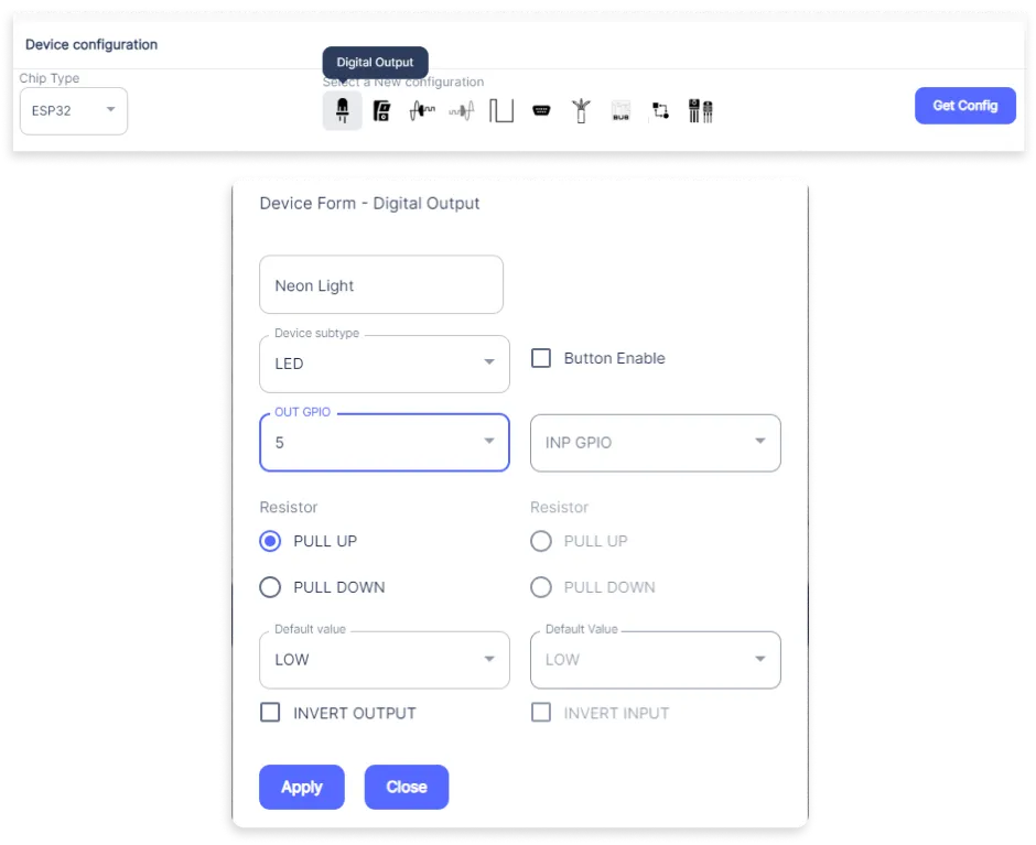

- Set a device name of your choosing. In our case, we set it to Neon Light.
- Set Device Subtype to LED.
- Set OUT GPIO to 5.
- Set Resistor to PULL UP.
- A window will appear on the bottom right side of the screen displaying “Please press BOOT button while flashing begins.”.

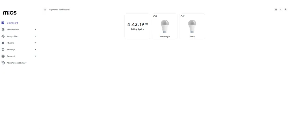

- On the MiOS web dashboard, you will be able to see the tile for the touch sensor and Neon light. These tiles show the status of touch sensor and the neon light.

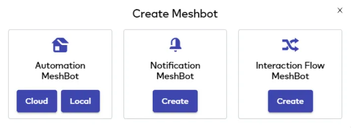

MeshBots

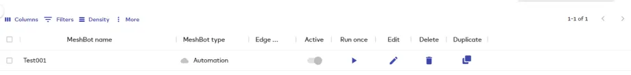

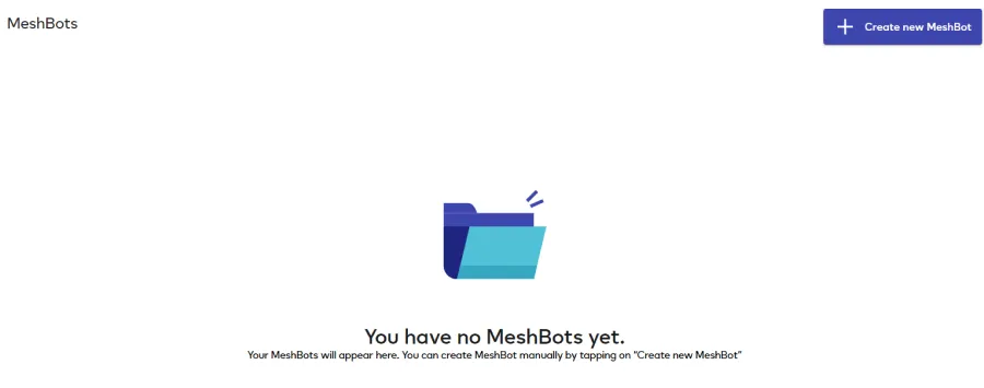

- On the right side of the screen under Automation, click on MeshBots.
- After clicking on Create new MeshBot you will see new options, now under Automation MeshBot click on Local.

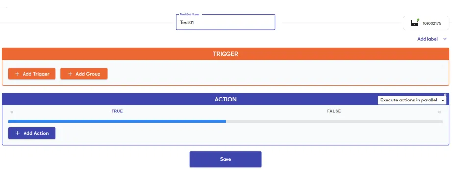

- On the next screen you will see that we can create a name of our choosing, in this case we write it as Test01.

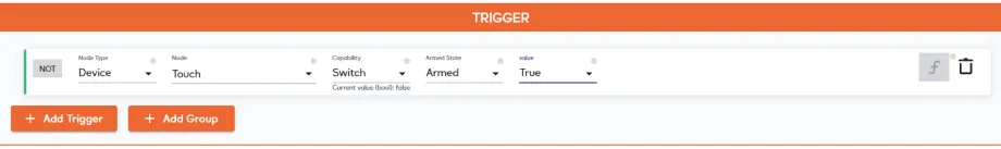

- Set Node Type to Device.
- Set the Node to Touch.
- Set the Capability to Switch.
- Set Armed State to Armed.
- Set the Value to True.

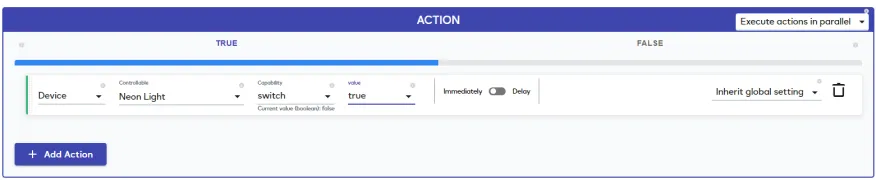

- Set these values in the True part of the ACTION section.
- Set Controllable Type to Device.
- Set the Controllable to Neon Light.
- Set the Capability to switch.
- Set the Value to true.

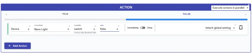

- Set these values in the False part of the ACTION section.
- Set the Value to false.

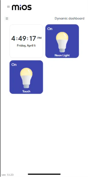

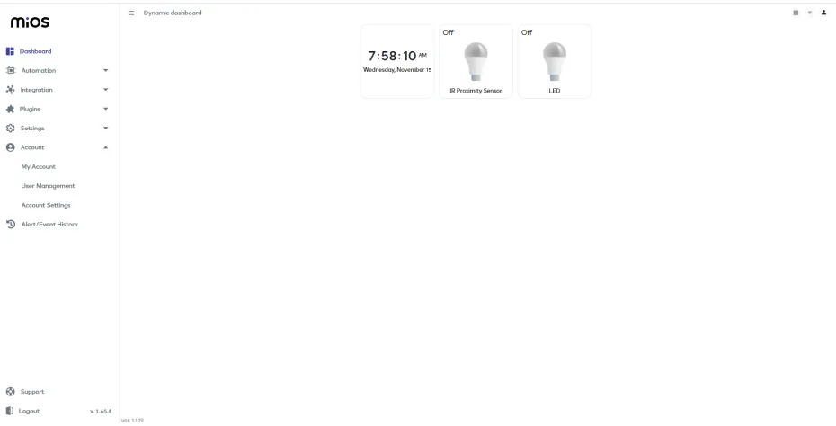

- After opening the MiOS web dashboard, you will be able to see the tile of your connected device, in our case, the touch sensor and neon light. When the touch sensor is not touched, it will not trigger the neon light.

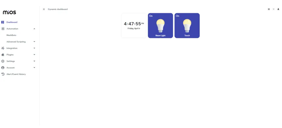

- Similarly, it can be seen that when the touch sensor is touched, the neon light gets triggered. This is because of the meshbot rules we have set earlier.
6. MiOS App

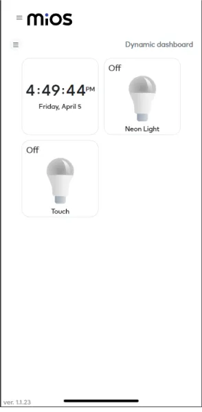

- After opening the MiOS mobile dashboard, you will be able to see the tile of your connected device, in our case the touch sensor and neon light. When the touch sensor is not touched, it will not trigger the neon light.
