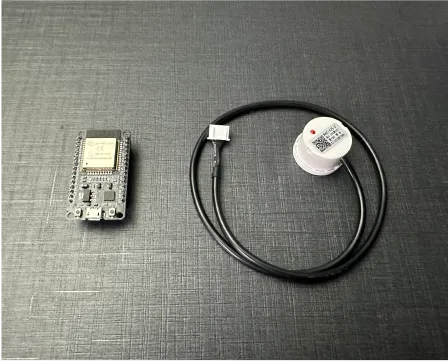

- XKC-Y25-PNP Non-contact capacitive liquid level sensor.

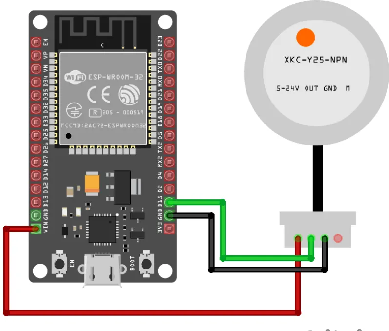

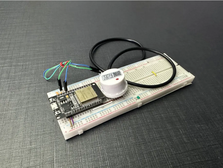

From ESP32 to the XKC-Y25-PNP:
| ESP32 | XKC-Y25-PNP |
| VIN | VCC |
| GND | GND |
| D15 | OCT |

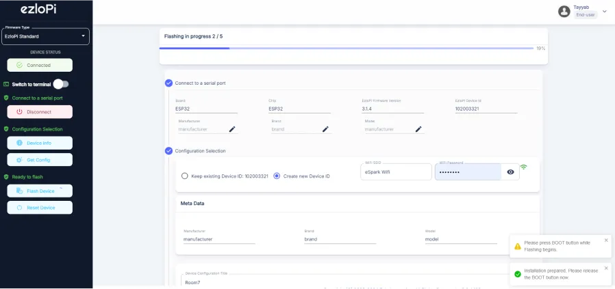

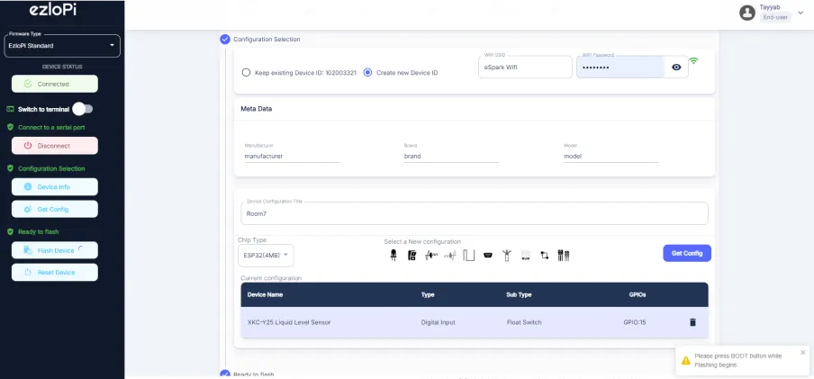

4. Interfacing the liquid level sensor with the EzloPi Web Flasher
Click Connect

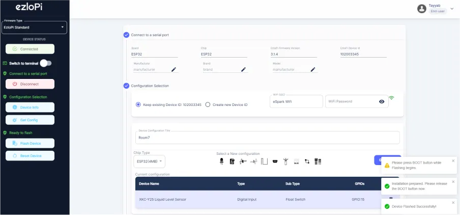

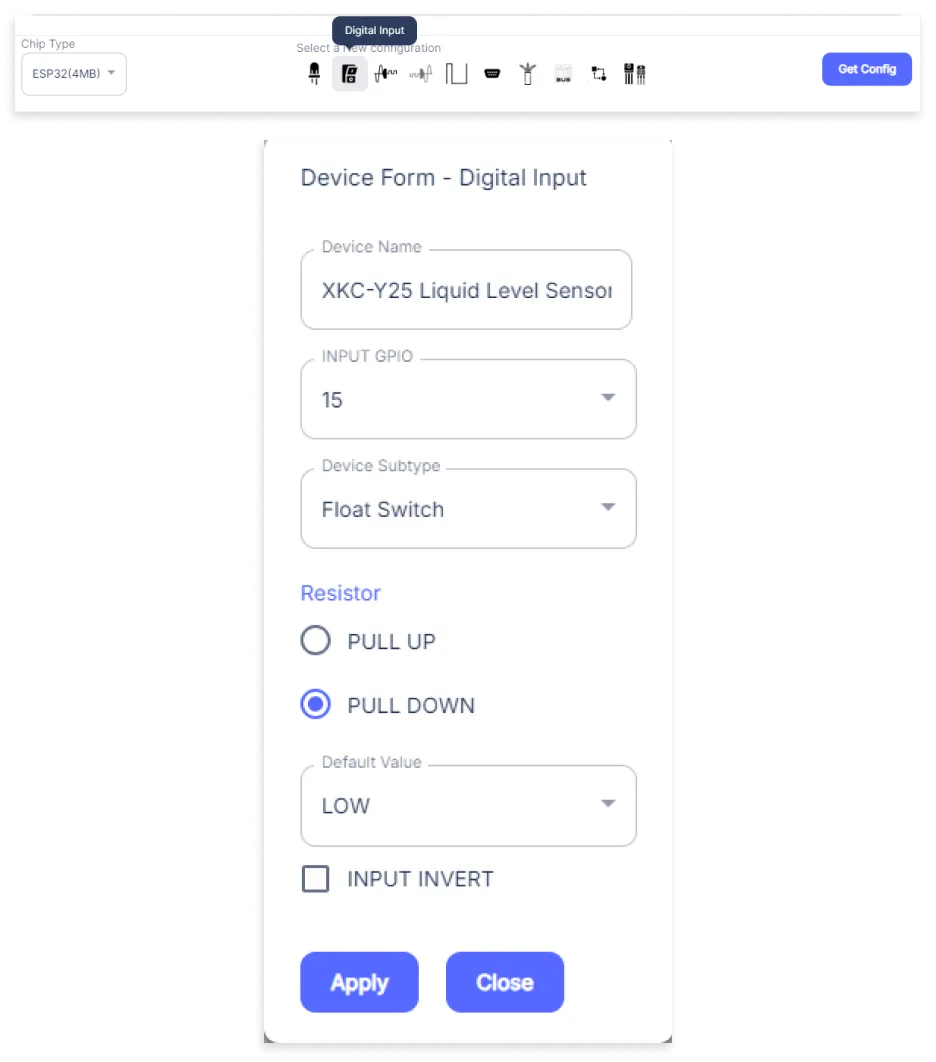

- A Digital Input window will open for inputting the following parameters:
- Set a device name of your choosing. In our case we set it to XKC-Y25 Liquid Level Sensor.
- Set the Input GPIO to 15.
- Set Device Subtype to Float Switch.
- Set the Resistor to PULL DOWN.
- Set Default Value to LOW.
- Then Click Apply Button.

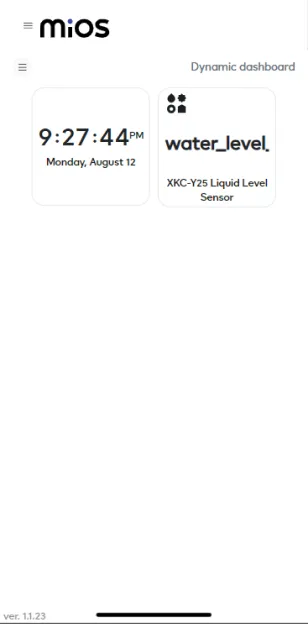

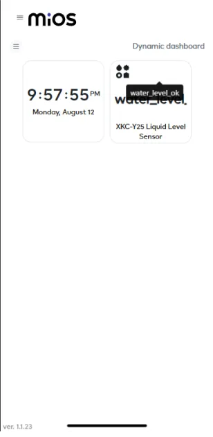

5. MiOS App
- After opening the MiOS mobile dashboard, you will be able to see the tile of your connected device. As seen above, the XKC-Y25 sensor tile is displayed here. For now, water levels have reached the threshold as detected by the sensor.
- Now as seen in the above picture, the XKC-Y25 sensor tile is displaying the message “water_level_ok” which means that the water level is below the set threshold as detected by the sensor.

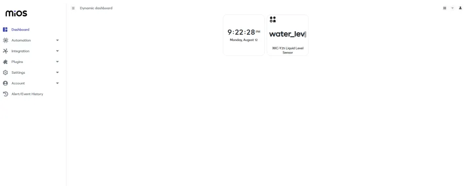

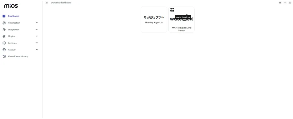

6. MiOS Web Dashboard
- After opening the MiOS web dashboard, you will be able to see the tile of your connected device. As seen above, the XKC-Y25 sensor tile is displayed here. For now, water levels have reached the threshold as detected by the sensor.
