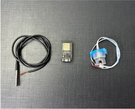

- TS-300B turbidity sensor, with analog to digital output interface module.
- DS18B20 Digital temperature sensor probe.

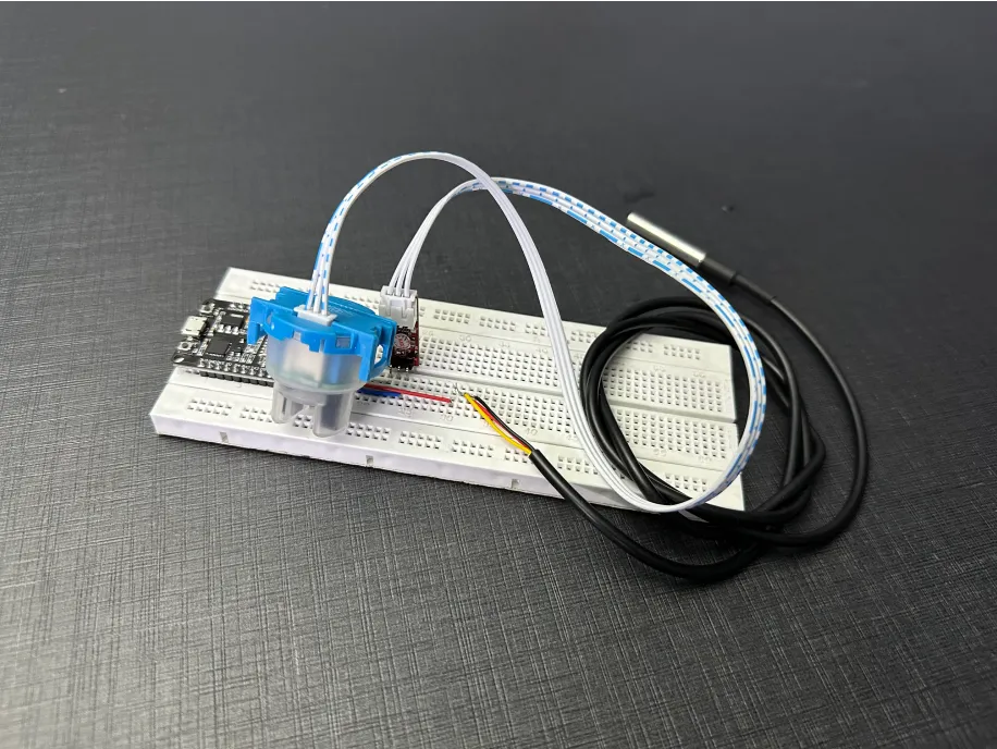

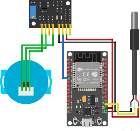

The wiring diagram for the ESP32 30 pin is represented as below:
From ESP32 to Turbidity sensor interface module:
| ESP32 | Interface Module |
| GND | 1 |
| D32 | 2 |
| 3V3 | 3 |
From Turbidity Sensor to Interface Module:
| Turbidity Sensor | Interface Module |
| IR | G |
| TR | A |
| VCC | V |
From ESP32 to the DS18B20 Temperature sensor probe:
| ESP32 | DS18B20 |
| 3V3 | VDD |
| GND | GND |
| D15 | DQ(Data) |

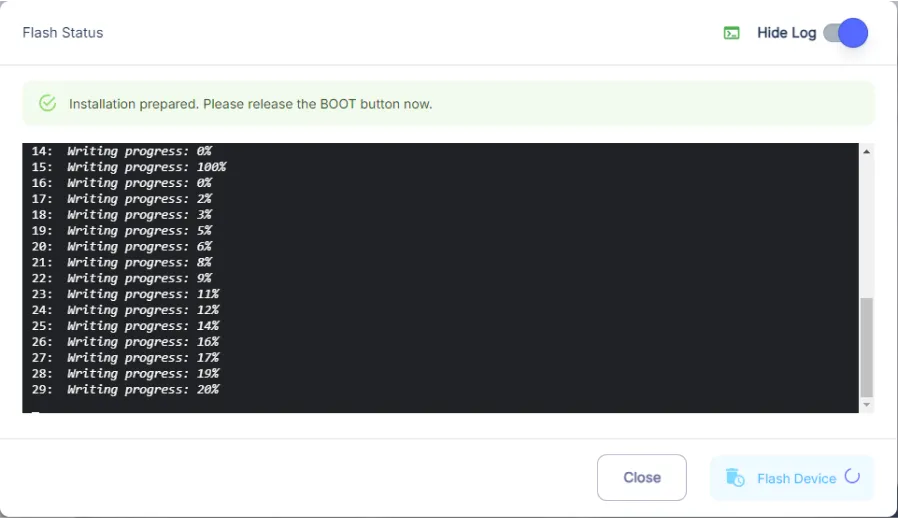

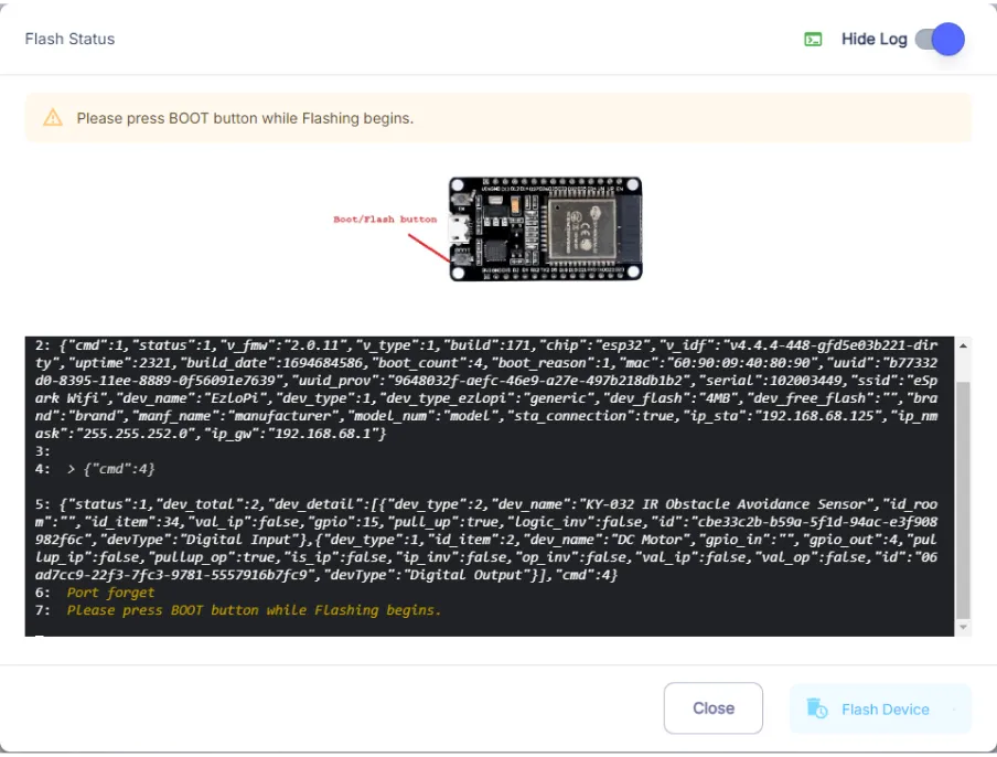

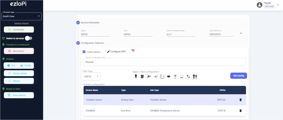

4. Interfacing the Turbidity Sensor & Temperature Sensor using the EzloPi Web Flasher
Click Connect
- If you are new to this and it's your first time configuring, select Create new Device ID. Click on the Configure Wifi button. Enter Wifi SSID and Wifi Password.

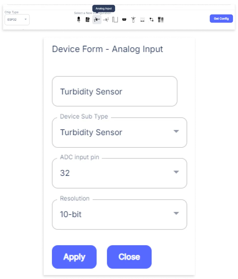

- In the Device Configuration, tab click on Analog Input.
- An Analog Input window will open for inputting the following parameters:
- Set a Device name of your choosing. In our case, we set it to Turbidity Sensor.
- Set Device Subtype to Turbidity Sensor.
- Set the ADC input pin to 32.
- Set the Resolution to 10-bit.
- Then Click Apply Button.

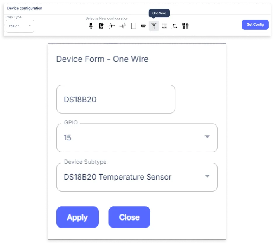

- Again, In the Device Configuration, tab click on One Wire.
- A One Wire window will open for inputting the following parameters:
- Set a Device name of your choosing. In our case, we set it to the DS18B20.
- Set the GPIO pin to 15.
- Set Device Subtype to DS18B20 Temperature Sensor.

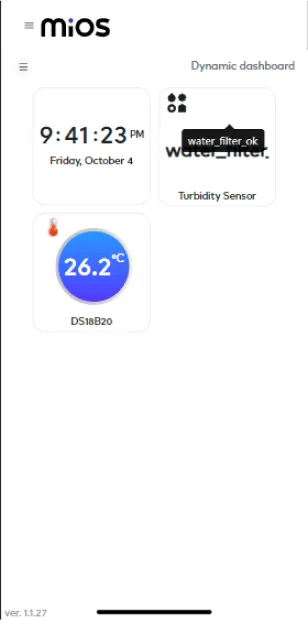

- After opening the MIOS mobile app, you will be able to see the tiles of your connected devices. The turbidity sensor is showing a ‘water_filter_ok’ message which means water is clean or has very low impurities while DS18B20 shows the temperature of the water in the aquarium.

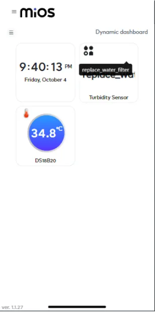

- Now as seen above, the turbidity sensor is displaying a ‘replace_water_filter’ message depicting that water has now become impure and the user needs to replace the filter. The DS18B20 also shows a temperature of 34.8 degree celsius which is very warm and not suitable for fishes in the aquarium.

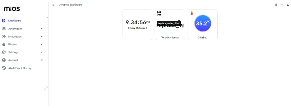

6. MiOS Web Dashboard

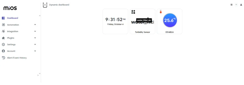

- After opening the MIOS web dashboard, you will be able to see the tiles of your connected devices. The turbidity sensor is showing a ‘water_filter_ok’ message which means water is clean or has very low impurities while DS18B20 shows the temperature of the water in the aquarium.
- Now as seen above, the turbidity sensor is displaying a ‘replace_water_filter’ message depicting that water has now become impure and the user needs to replace the filter. The DS18B20 also shows a temperature of 35.2 degree celsius which is very warm and not suitable for fishes in the aquarium.
