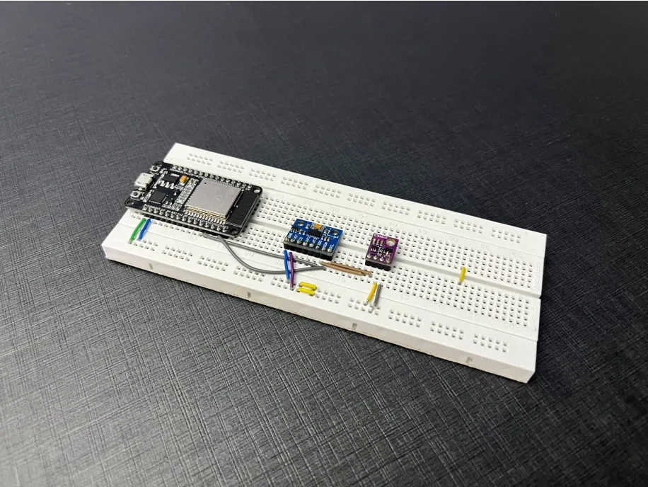

The wiring diagram for the ESP32 30 pin is represented as below:
From ESP32 to ADXL345:
| ESP32 | ADXL345 |
| 3V3 | VCC |
| GND | GND |
| 21 | SCL |
| 22 | SDA |
From ESP32 to BME280:
| ESP32 | BME280 |
| VIN | VCC |
| GND | GND |
| 21 | SCL |
| 22 | SDA |

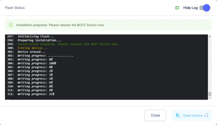

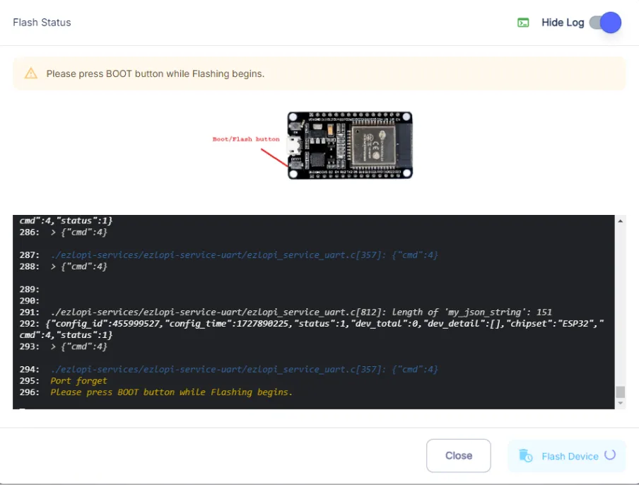

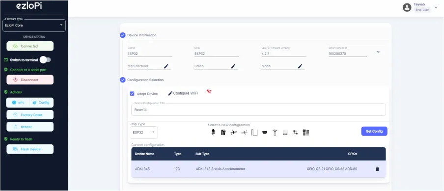

4. Interfacing the MPU6050 & BME280 using the EzloPi Web Flasher
Click Connect
- If you are new to this and it's your first time configuring, select Create new Device ID. Click on the Configure Wifi button. Enter Wifi SSID and Wifi Password.

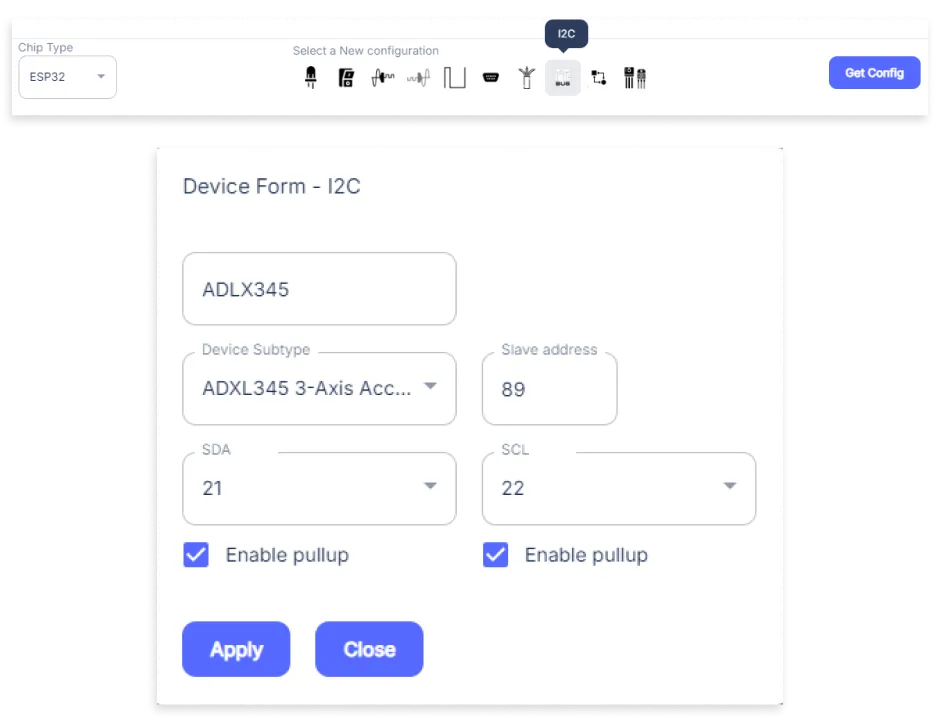

- In the Device Configuration, tab click on I2C.
- An I2C window will open for inputting the following parameters:
- Set a Device name of your choosing. In our case, we set it to ADXL345.
- Set Device Subtype to ADXL345 3-Axis Accelerometer.
- Set the Slave address to 89.
- Set the SDA pin to 21.
- Set the SCL pin to 22.
- Tick mark both boxes of Enable pullup.
- Then Click Apply Button.

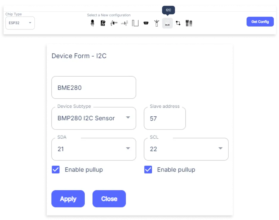

- Again, In the Device Configuration, tab click on I2C.
- Set a Device name of your choosing. In our case, we set it to BME280.
- Set Device Subtype to BMP280 I2C Sensor.
- Set the Slave address to 57.

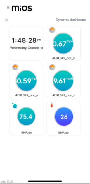

5. MiOS App
- After opening the MIOS mobile app, you will be able to see the tiles of your connected devices. The ADXL345 3-axis accelerometer shows the accelerometer data of the three axes i.e X,Y and Z whereas BME280 collects the data of temperature and humidity parameters of the environment.
6. MiOS Web Dashboard
- After opening the MIOS web dashboard, you will be able to see the tiles of your connected devices. The ADXL345 3-axis accelerometer shows the accelerometer data of the three axes i.e X,Y and Z whereas BME280 collects the data of temperature and humidity parameters of the environment.
