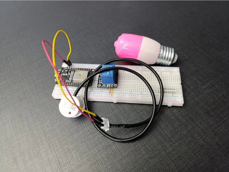

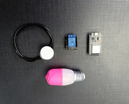

  • ESP32 as an EzloPi smart device.
  • XKC-Y25-NPN Non-contact capacitive liquid level sensor.
  • Single Channel Relay Module
  • AC Lamp
  • AC power source

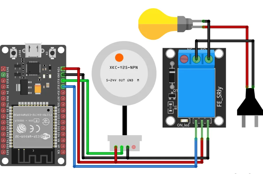

From ESP32 to the XKC-Y25-NPN:
ESP32 XKC-Y25-NPN
VIN VCC
GND GND
D15 OUT
From ESP32 with Relay:
ESP32 Relay
VIN +(VCC)
GND -(GND)
D12 S (Signal)
From Relay to AC LAMP & 220V:
Relay AC Lamp 220V
COM - Neutral
NO Terminal no. 1 -
- Terminal no. 2 Phase

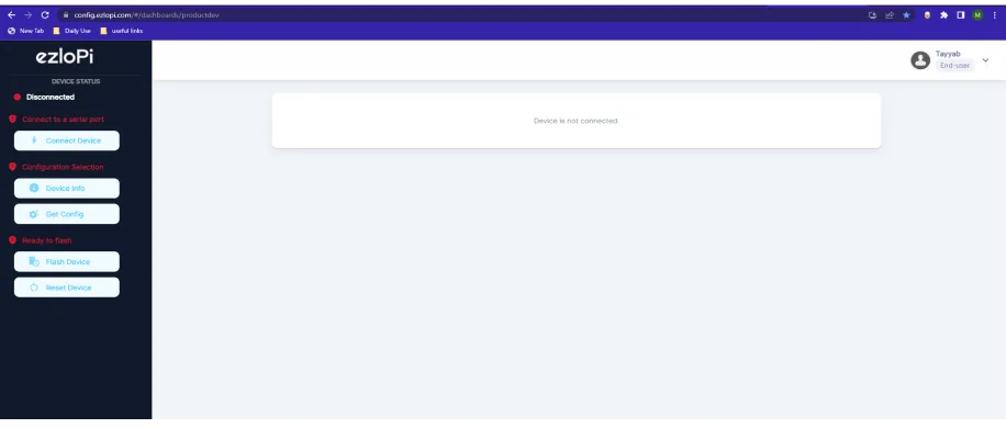

4. Interfacing the XKC-Y25-NPN using the EzloPi Web Flasher
  1. Log in using the credentials which you just set earlier while signing up.
  1. Now, click on the Connect Device button and a pop-up window will appear.
  1. Now, select COM Port to which your ESP32 device is connected. In our case, the COM3 port is used.
Click Connect
  1. If you are new to this and it's your first time configuring, select Create new Device ID. Enter Wifi SSID and Wifi Password.

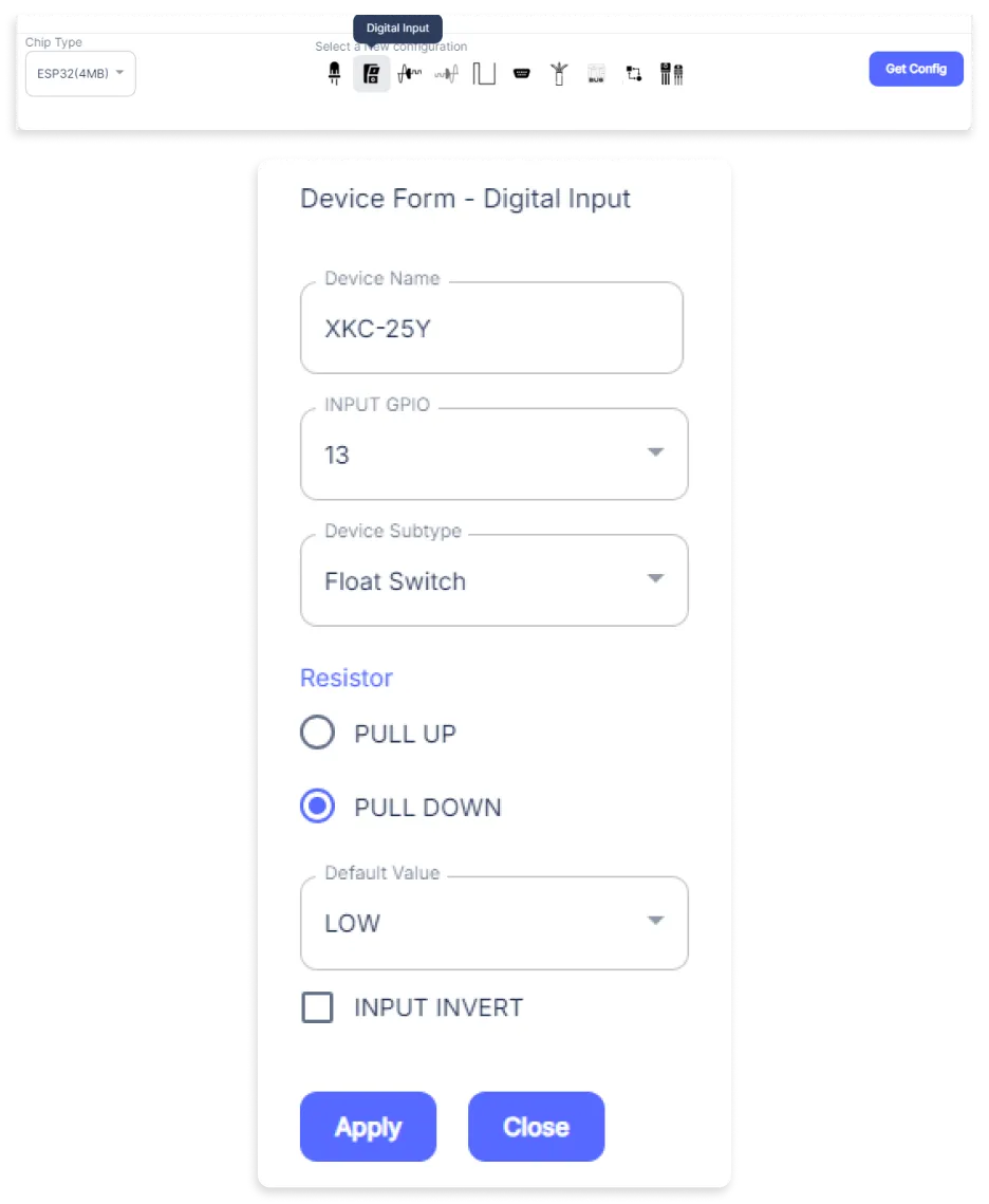

  2. In the Device Configuration, tab click on Digital Input.
  1. A Digital Input window will open for inputting the following parameters:
  • Set a Device name of your choosing. In our case, we have set it to the XKC-25Y.
  • Set INPUT GPIO to 13.
  • Set Device Subtype to Float Switch.
  • Set Resistor to PULL DOWN.
  • Then Click Apply Button.

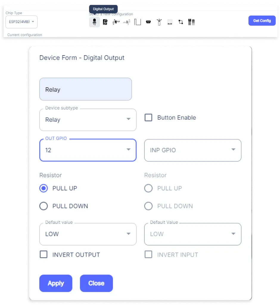

  1. In the Device Configuration, tab click on Digital Output.
  1. A Digital Output window will open for inputting the following parameters:
  • Set a Device name of your choosing. In our case, we set it to the Relay.
  • Set Device Subtype to Relay.
  • Set OUT GPIO to 12.
  • Set Resistor to PULL UP.

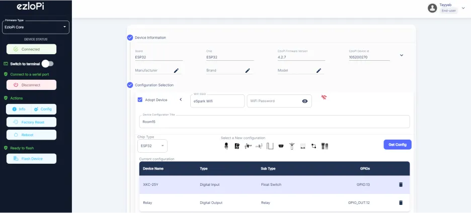

  • After clicking the apply button you can see a table of your setting in the device configuration tab.

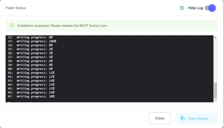

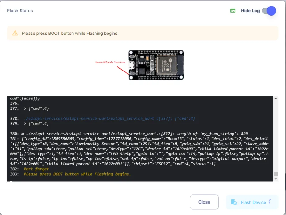

  • Press the Flash Device button.
  1. A window will appear on the bottom right side of the screen displaying “Please press BOOT button while flashing begins.”
  1. Hold the BOOT button down until the next window appears on the bottom right side of the screen which says “Installation prepared. Please release the boot button now.”
  1. Release the BOOT button from your ESP32 when this pop-up on the bottom right window appears.
  1. After some time, a popup will appear saying Device Flashed Successfully! This means that your device has been set up successfully.

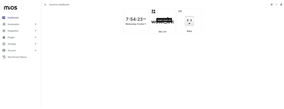

5. MiOS Web Dashboard
  1. After configuring the controller with the EzloPi web flasher, head to ezlogic.mios.com
  1. Use the same credential to log in that you used for configuring the controller with the web flasher.

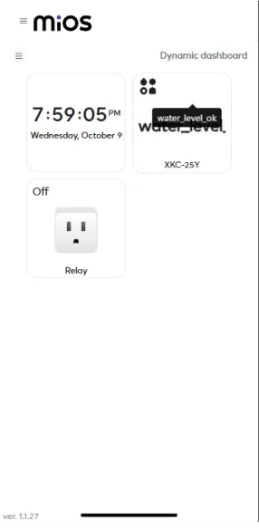

  1. Now, on the MiOS web dashboard, you will see the tiles of your connected devices as shown above as XKC-25Y and Relay.

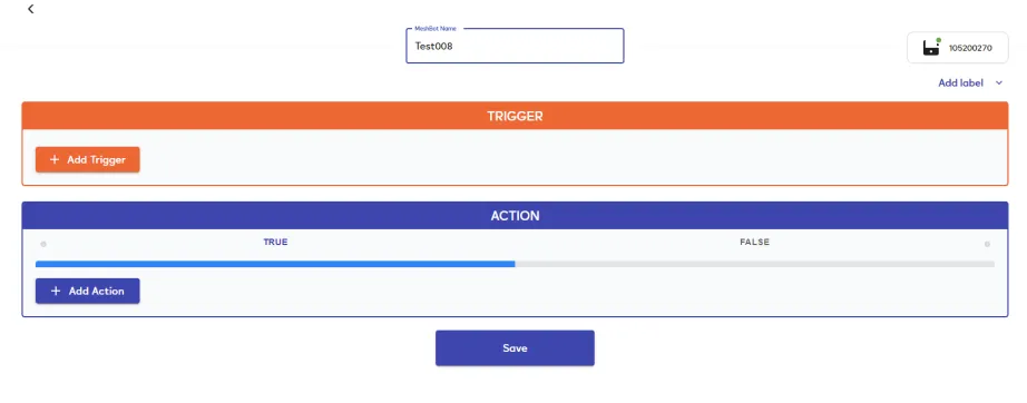

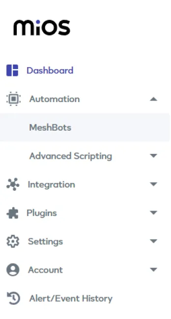

MeshBots:
  1. On the left side of the screen under Automation, click on MeshBots.
  2. On meshbot screen, click on Create new MeshBot button present on the top right corner of the screen.
  3. After clicking on Create new MeshBot, you will see this now under Automation MeshBot click on EzloPi.
  1. On the next screen you will see that we can create a name of our choosing, in this case we write it as Test008.
  1. In the trigger tab you can set the TRIGGER for your device and in the ACTION tab you can set the action to be performed based on the trigger which you have created.

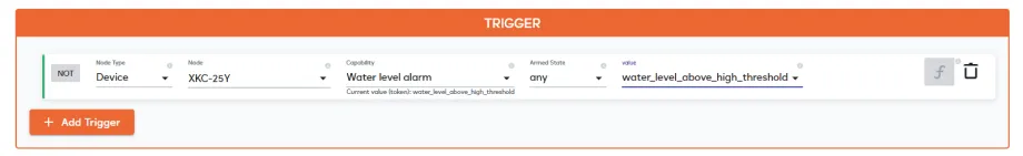

  1. Set these things in TRIGGER section:
  • Set Node Type to Device.
  • Set the Node to XKC-25Y.
  • Set the Capability to Water level alarm.
  • Set the Armed State to any.
  • Set the Value to water_level_above_high_threshold.

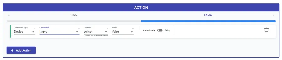

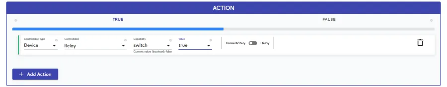

  1. Set these values in the TRUE part of the ACTION section.
  • Set Node type to Device.
  • Set Controllable to Relay.
  • Set Capability to switch.
  • Set value to true.
  1. Set these values in the FALSE part of the ACTION section.
  • Set value to false.

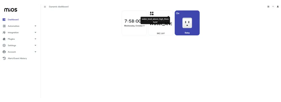

  1. Currently on the MIOS web dashboard, liquid level is normal and not required to dispense the liquid as the sensor tile shows water_level_ok message so therefore our relay remains OFF because of our meshbot settings.
  1. Now as seen above, the liquid level is now below our required level. That's why the sensor shows water_level_above_threshold message so therefore the relay is turned ON because now it is required to dispense the liquid by using any valve or pump which is fulfilled by our setting of the meshbot.

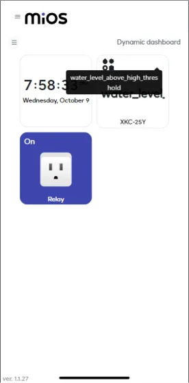

  1. On the MiOS mobile dashboard, you will see the tiles of your connected devices as shown above as XKC-25Y and Relay. Currently, the liquid level is normal and not required to dispense the liquid as the sensor tile shows water_level_ok message so therefore our relay remains OFF because of our meshbot settings.
  1. Now as seen above, liquid level is now below our required level that's why the sensor tile shows water_level_above_threshold message so therefore relay is turned ON because now it is required to dispense the liquid by using any valve or pump which is fulfilled by our setting of meshbot.
