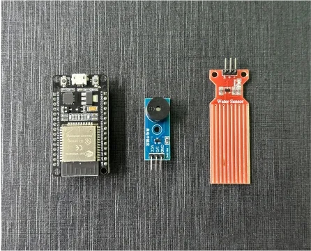

- SEN 18 Water Leak Sensor.
- Buzzer module.

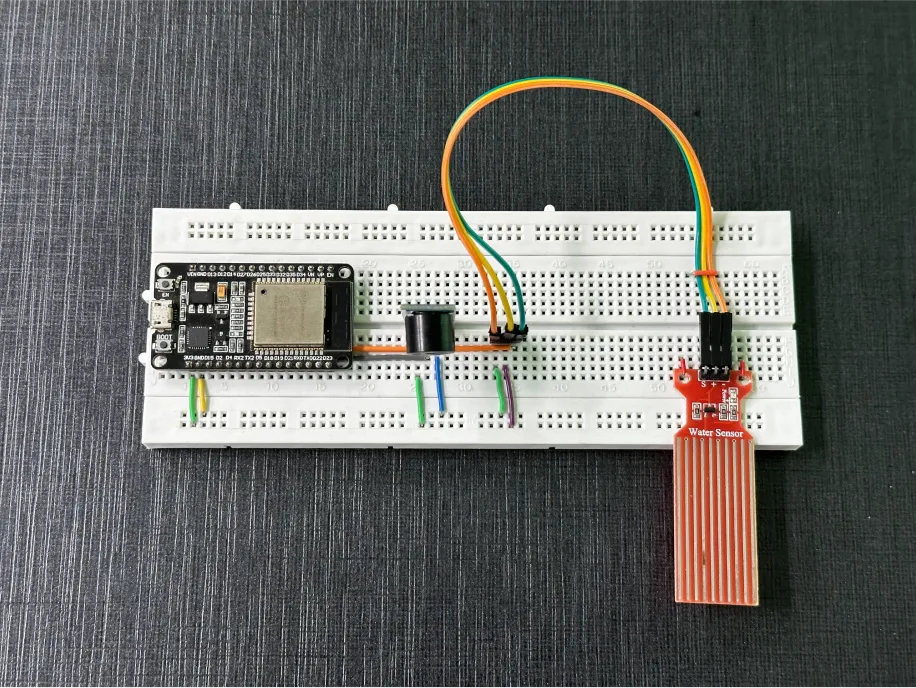

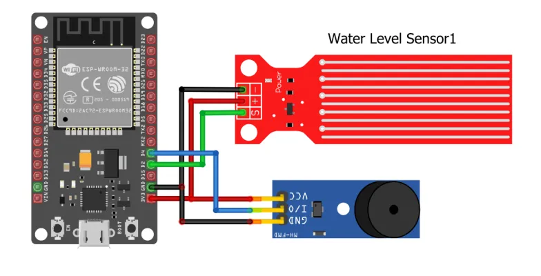

The following connections are made in order to complete the entire circuit setup:
From ESP32 to SEN18 Water leak sensor:
- Connect 3V3 from the ESP32 to the VCC of the sensor.
- Connect GND from the ESP32 to the GND pin of the sensor.
- Connect D2 from the ESP32 to the pin “S” of the sensor as an input.
From ESP32 to the Buzzer:
- Connect the D4 pin from the ESP32 to the Signal pin of the buzzer.
- Connect the GND to the negative pin of the buzzer.

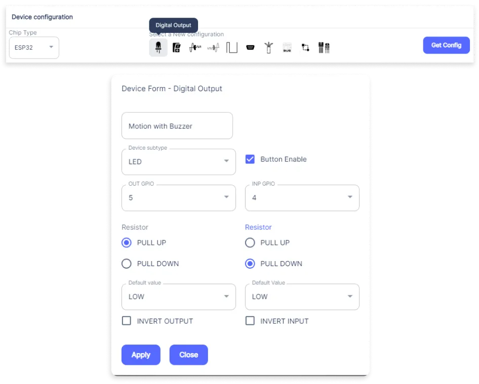

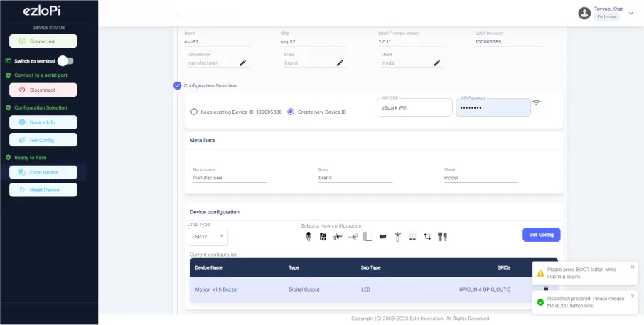

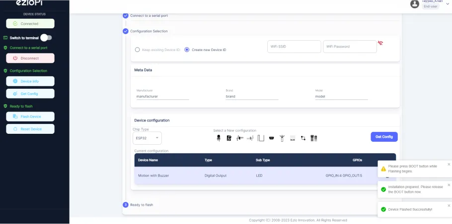

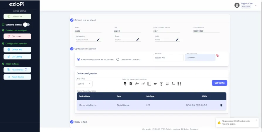

4. Interfacing the SEN18 Water Leak Sensor with Buzzer using EzloPi Web Flasher:
Now, select COM Port to which your ESP32 device is connected. In our case, the COM3 port is used.
Click Connect.
- Set a device name of your choosing. In our case, we set it to Water Leak with Buzzer.
- Set Device subtype to LED.
- Set OUT GPIO to 4.
- Set Resistor to PULL UP.
- Set the default value to LOW.
- Check the Button Enable box.
- Set INP GPIO to 2.
- Set Resistor to PULL DOWN.
- Then Click Apply Button.

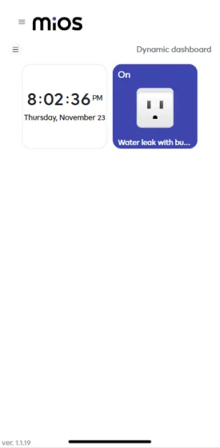

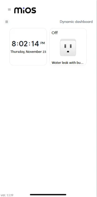

6. MiOS App
- After opening the MiOS mobile dashboard, you will be able to see the tile of your connected device. The SEN18 water leak sensor when combined with a buzzer works as an alarm system for potential water leaks. As seen above, currently no leak is being detected by the sensor.
- When a water leak is detected, the buzzer will be triggered and alert its user as shown.

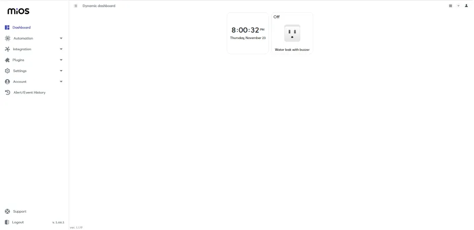

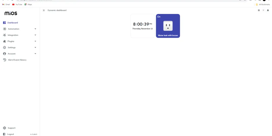

5. MiOS Web Application
- After opening the MiOS web app, you will be able to see the tile of your connected device. The SEN18 water leak sensor when combined with a buzzer works as an alarm system for potential water leaks. As seen above, currently no leak is being detected by the sensor.
