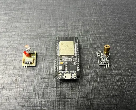

- KY-008 Laser transmitter module (5V).
- Laser receiver module.

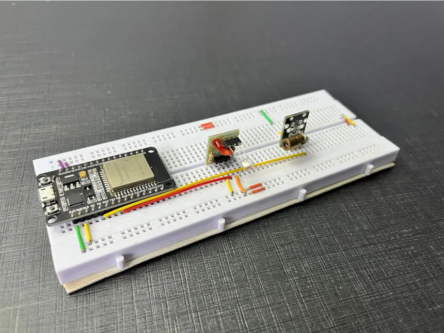

From ESP32 to KY-008:
| ESP32 | KY-008 |
| VIN | VCC (5V) |
| GND | GND |
| D15 | S (Signal) |
From ESP32 to Laser Receiver Module:
| ESP32 | Laser Receiver Module |
| VIN | VCC (5V) |
| GND | GND |
| D4 | OUT |

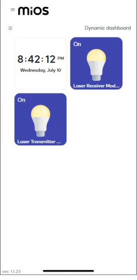

6. MiOS App
- Now, on the MiOS web app, you will see the tiles of your connected devices as shown above labeled as Laser transmitter module and Laser receiver module. Currently, no device is triggered therefore both tiles are shown as “Off”.
- Now, as seen above, when the Laser transmitter module turns on and starts transmitting the laser and its tile gets triggered. Also, the Laser receiver module gets triggered because of the rules we have set in the meshbot.

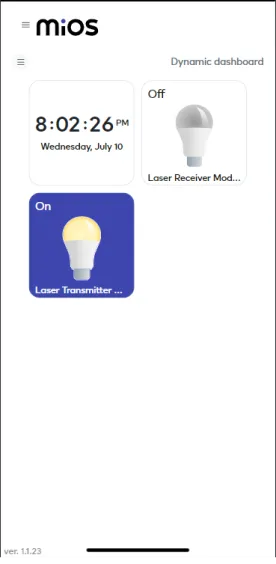

- Now in the above picture, we have a different condition from the previous one. It shows that when the Laser transmitter module turns on and starts transmitting the laser and the Laser receiver module gets turned off because of the rules we have set in the meshbot.
