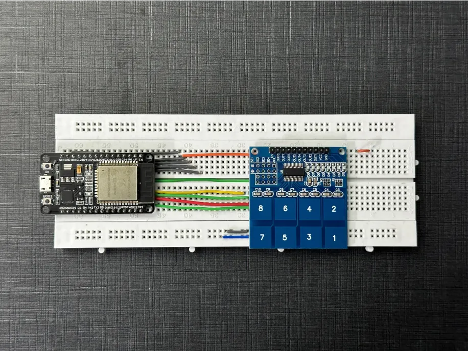

The project aims to interface an 8-channel touch sensor module TTP226 with the EzloPi device. This integration will enable the EzloPi device to detect touch inputs across its eight channels, expanding its functionality for tactile interaction. The TTP226 module offers sensitivity and reliability in detecting touch inputs, making it suitable for various control applications such as controlling the state of eight LED lamps or relays using the touch sensor module as a touch switch.
Through this project, users can harness the capabilities of the EzloPi device and the TTP226 touch module for interactive control in their smart home systems, IoT applications, or other projects requiring touch-sensitive inputs. Overall, this project enhances the usability and versatility of the EzloPi device by incorporating touch sensing capabilities.

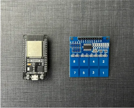

- TTP226 8-channel digital touch sensor.

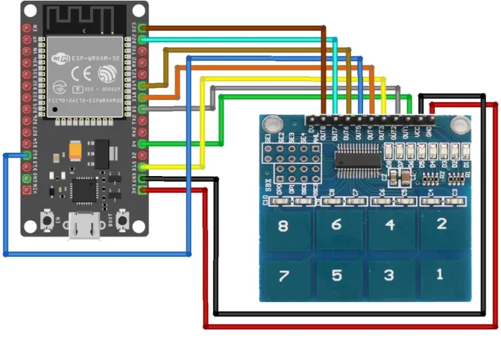

From ESP32 to the TTP226 module:
| ESP32 | TTP226 |
| 3V3 | VCC |
| GND | GND |
| D4 | OUT1 |
| D5 | OUT2 |
| D15 | OUT3 |
| D18 | OUT4 |
| D12 | OUT5 |
| D19 | OUT6 |
| D22 | OUT7 |
| D23 | OUT8 |

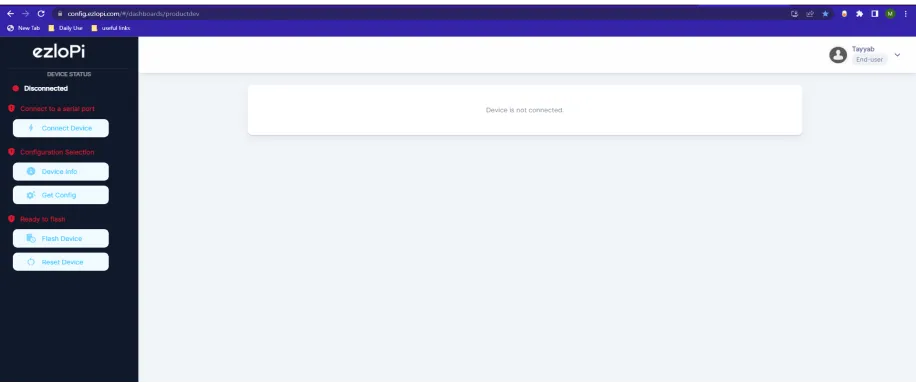

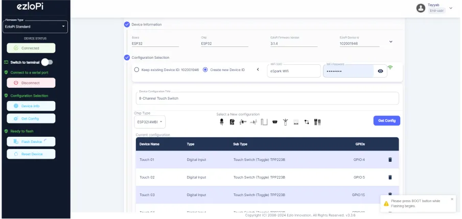

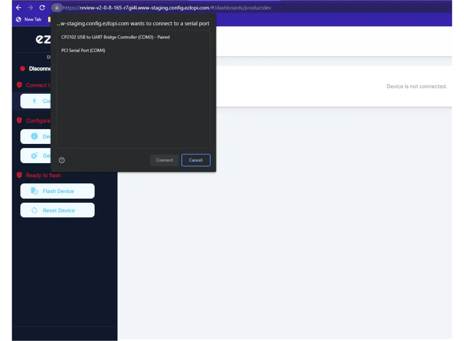

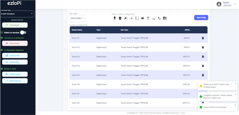

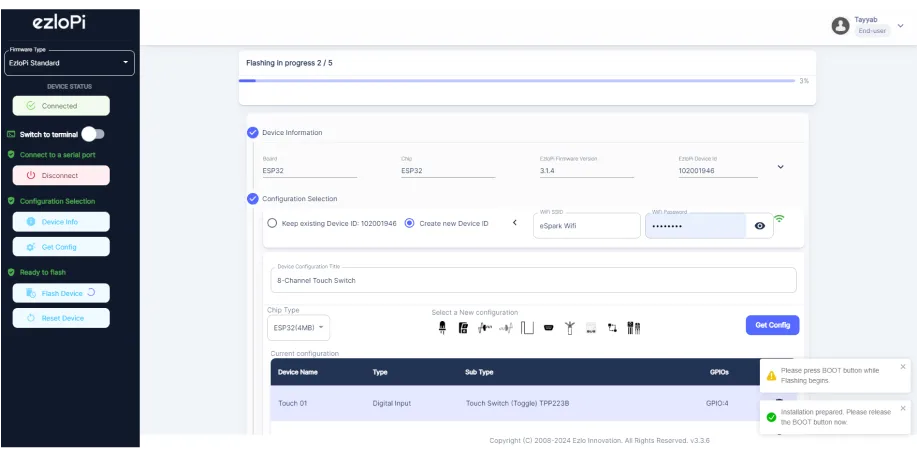

4. Interfacing the TTP226 8-channel Touch sensor module using the EzloPi Web Flasher
Click Connect
- If you are new to this and it's your first time configuring, select Create new Device ID. Click on the Configure Wifi button. Enter Wifi SSID and Wifi Password.

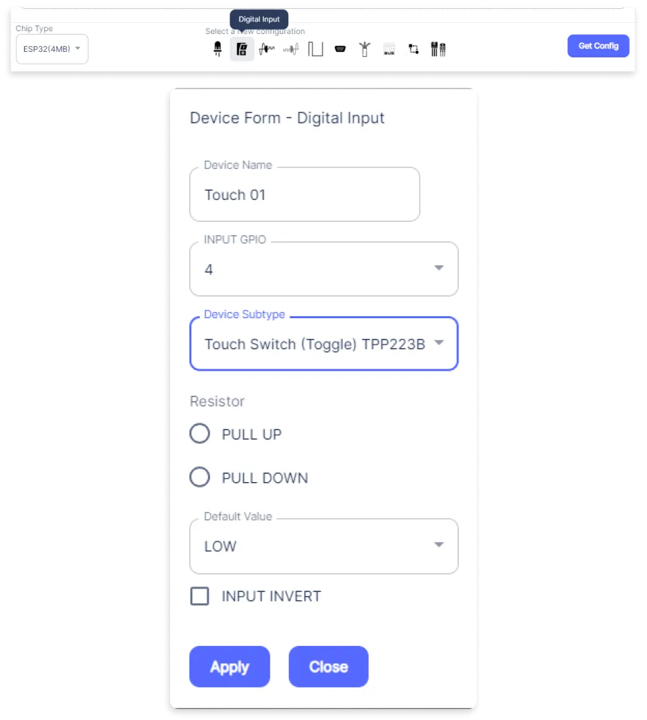

- A Digital Input window will open for inputting the following parameters:
- Set Device name to Touch 01.
- Set OUT GPIO to 4.
- Set Device subtype to Touch Switch (Toggle) TTP223B.
- Set the default value to LOW.
- Now Click the Apply button.
- Again, In the Device Configuration, tab click on Digital Input.

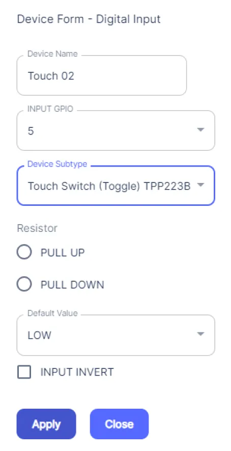

- Set Device name to Touch 02.
- Set OUT GPIO to 5.
- Set Device name to Touch 03.
- Set OUT GPIO to 15.
- Set Device name to Touch 04.
- Set OUT GPIO to 18.

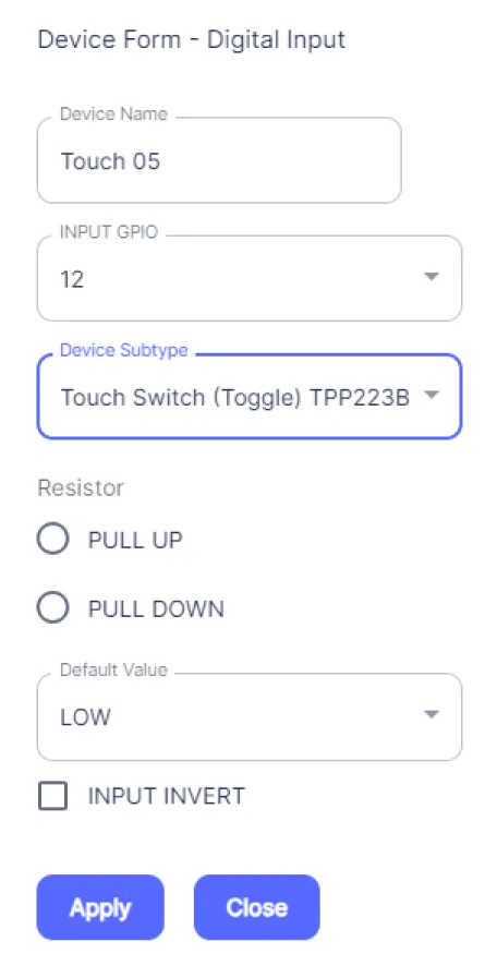

- Set Device name to Touch 05.
- Set OUT GPIO to 12.

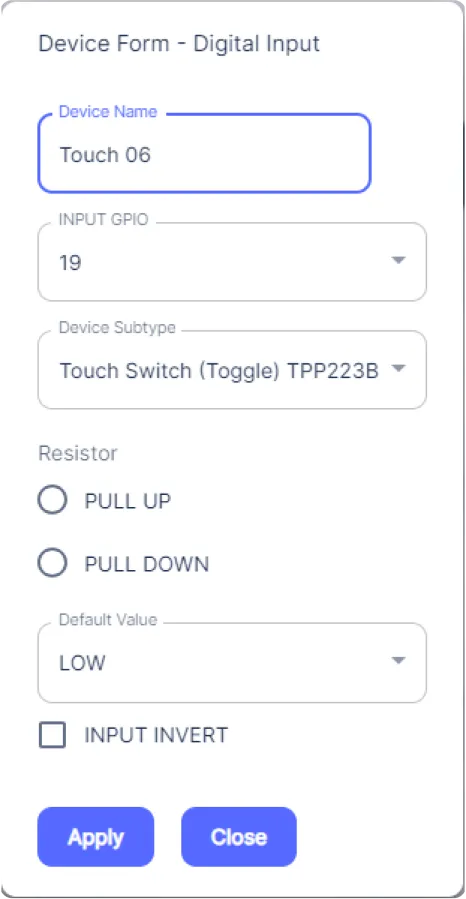

- Set Device name to Touch 06.
- Set OUT GPIO to 19.

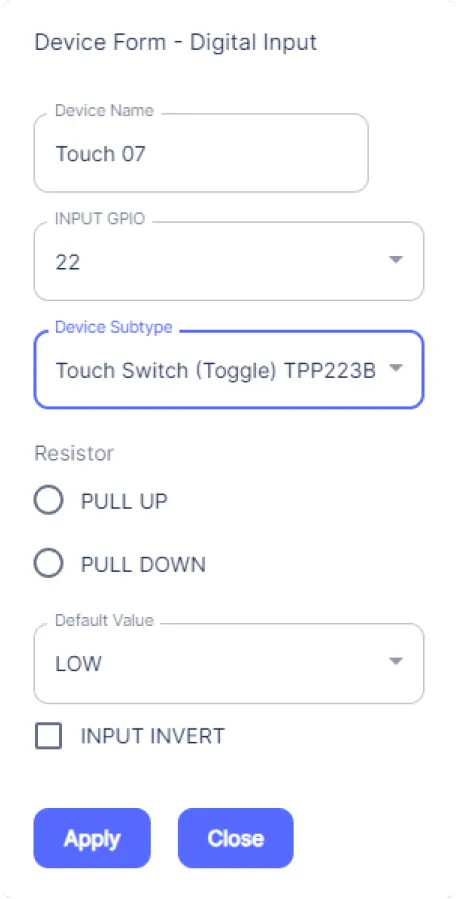

- Set Device name to Touch 07.
- Set OUT GPIO to 22.

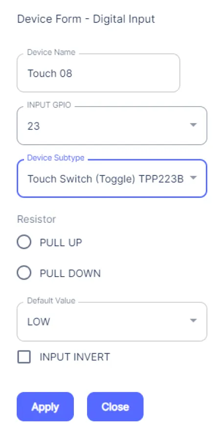

- Set Device name to Touch 08.
- Set OUT GPIO to 23.

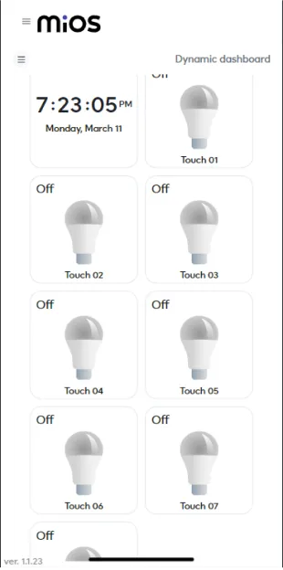

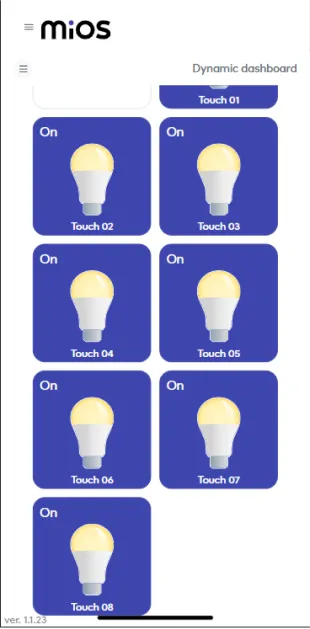

5. MiOS App
- After opening the MiOS mobile dashboard, you will be able to see the tile of your connected device. The state of all the eight touch switches can be controlled by just touching on the tiles for each touch switch.
- Currently, all the tiles for the touch switches are OFF, which indicates that all the touch switches are OFF.
- Similarly, it can now be seen that after touching one by one on each touch sensor on the touch module, the touch switches turn ON as indicated by the tiles. Additionally, we can also create meshbot conditions/rules for controlling various devices such as LEDs and relays for our smart home use or automation purpose.

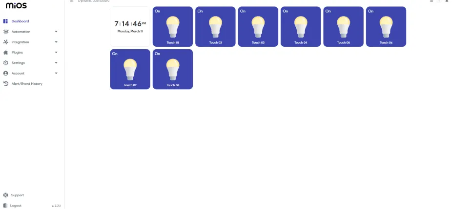

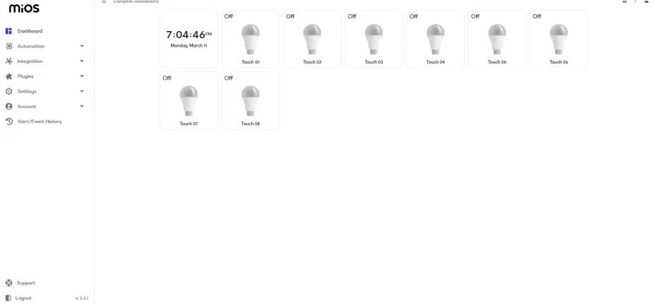

5. MiOS Web Dashboard
- After opening the MiOS web dashboard, you will be able to see the tile of your connected device. The state of all the eight touch switches can be controlled by just touching on the tiles for each touch switch.
- On the dashboard, it can now be seen that after touching one by one on each touch sensor on the touch module, the touch switches turn ON as indicated by the tiles. Additionally, we can also create meshbot conditions/rules for controlling various devices such as LEDs and relays for our smart home use or automation purpose.
