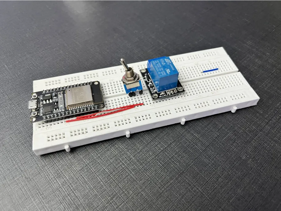

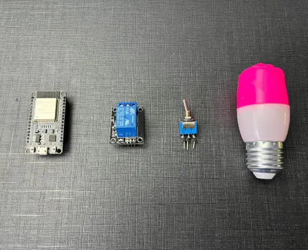

- SPDT toggle switch.
- Single channel relay module
- AC lamp

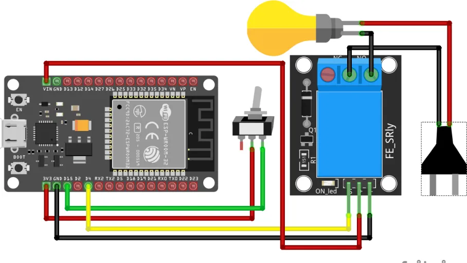

From ESP32 to SPDT Switch:
| ESP32 | SPDT Switch |
| 3V3 | COM |
| D15 | L2 |
From ESP32 with Relay:
| ESP32 | Relay |
| VIN | +(VCC) |
| GND | GND |
| D4 | S (Signal) |
From Relay to AC LAMP & 220V:
| Relay | AC Lamp | 220AC |
| COM | - | Neutral |
| NO | Terminal no. 1 | - |
| - | Terminal no. 2 | Phase |

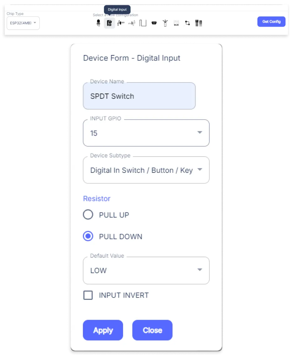

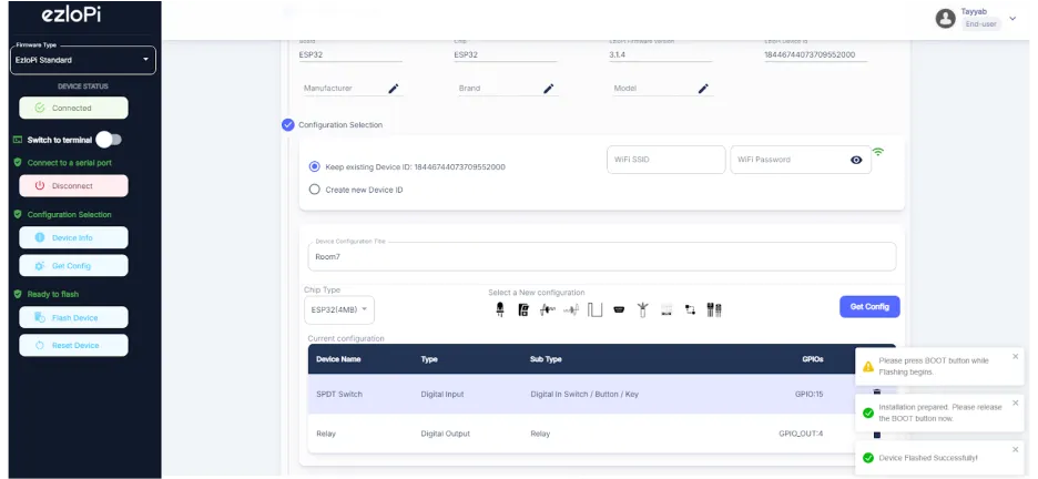

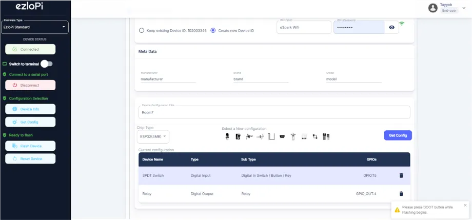

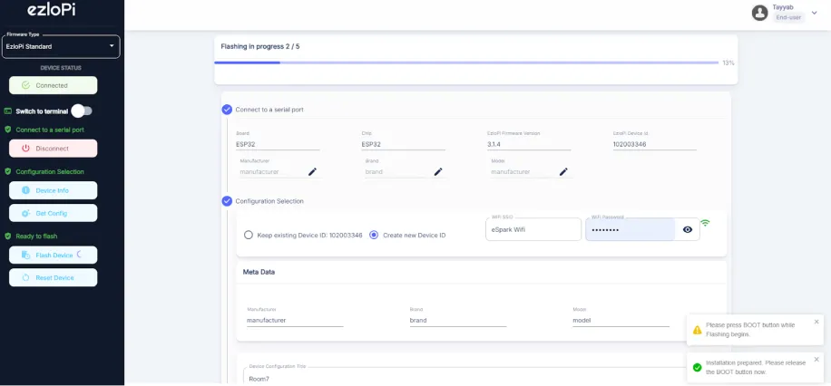

4. Interfacing the SPDT Toggle Switch with Relay using the EzloPi Web Flasher
Click Connect
- A Digital Input window will open for inputting the following parameters:
- Set a Device name of your choosing. In our case, we set it to the SPDT Switch.
- Set INPUT GPIO to 15.
- Set Device Subtype to Digital In Switch / Button / Key.
- Set Resistor to PULL DOWN.
- Then Click Apply Button.

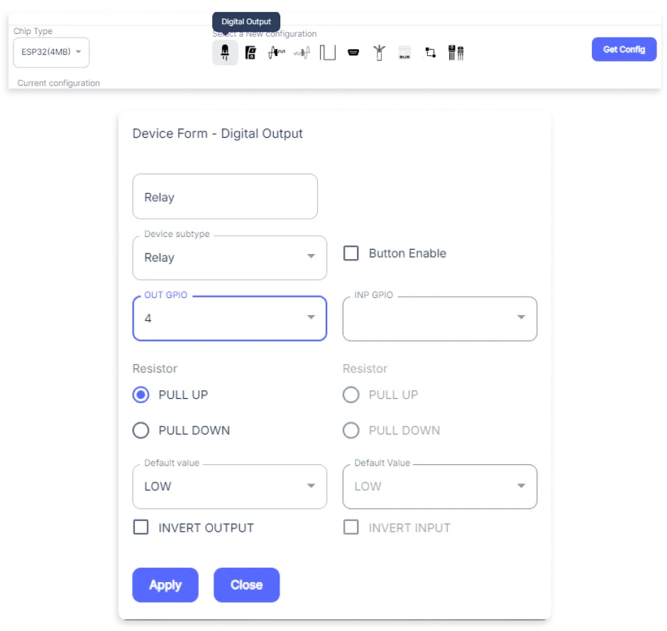

- Set a Device name of your choosing. In our case, we set it to the Relay.
- Set Device Subtype to Relay.
- Set OUT GPIO to 4.
- Set Resistor to PULL UP.

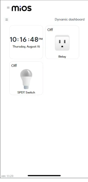

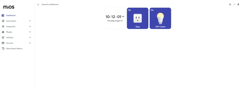

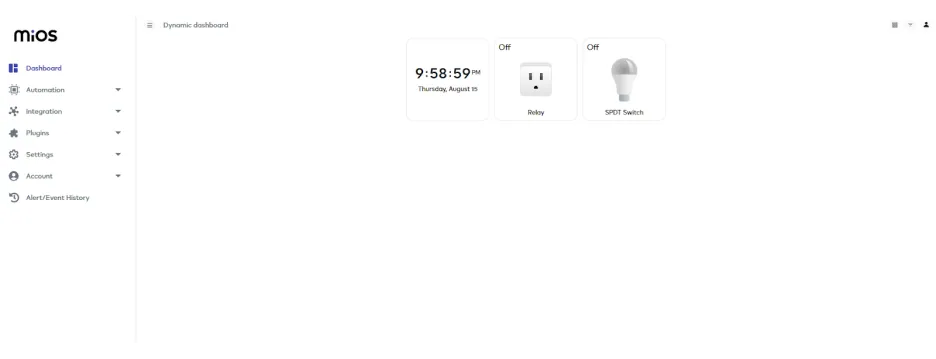

5. MiOS Web Dashboard
- In the MiOS web dashboard, you will be able to see the tiles for the SPDT Switch and the relay. These tiles will indicate the status of the relay depending on whether the SPDT switch is being operated.

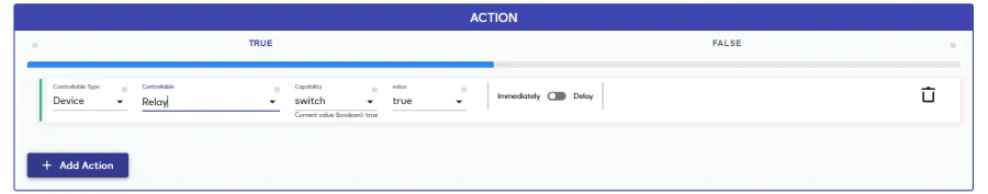

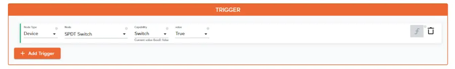

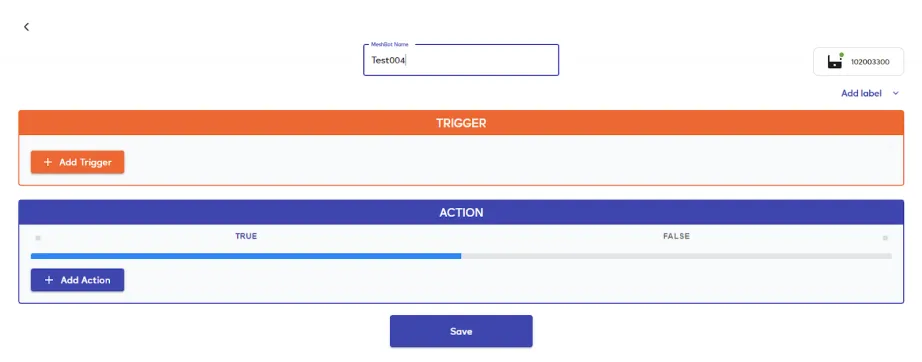

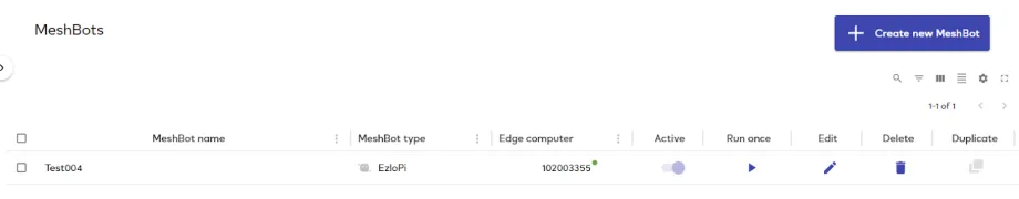

MeshBots:
- After clicking on Create new MeshBot, you will see this now under Automation MeshBot click on EzloPi.
- On the next screen you will see that we can create a name of our choosing, in this case we write it as Test004.

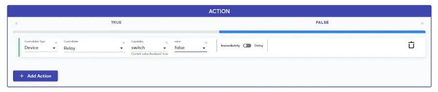

- Set Node Type to Device.
- Set the Node to SPDT Switch.
- Set the Capability to True.
- Set Controllable Type to Device.
- Set the Controllable to Relay.
- Set the Capability to switch.
- Set the Value to true.
- Now Click the Save button.
- Set the Value to false.
- On the MiOS web dashboard, you can see that when the SPDT switch is operated, the Relay is latched and the AC lamp is turned ON because of the rules we have set in meshbot.

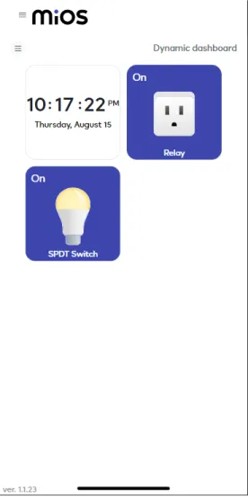

6. MiOS App
- In the MiOS mobile dashboard, you will be able to see the tiles for the SPDT Switch and the relay. These tiles will indicate the status of the relay depending on whether the SPDT switch is being operated.
- On the MiOS mobile dashboard, you can see that when the SPDT switch is operated, the Relay is latched and the AC lamp is turned ON because of the rules we have set in meshbot.
