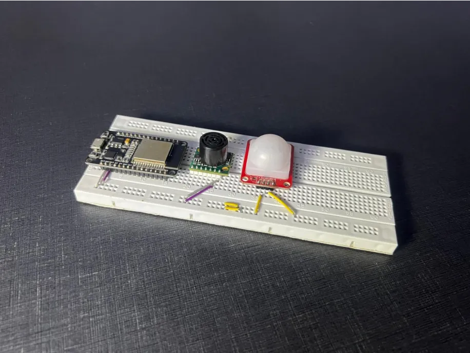

  • ESP32 as an EzloPi smart device.
  • MB1013 sonar sensor module.
  • PIR motion sensor.

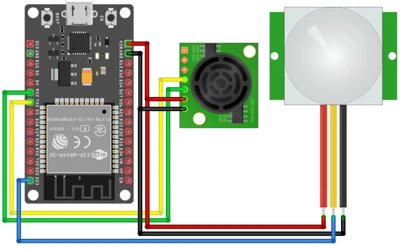

The wiring diagram for the ESP32 30 pin is represented as below:
From ESP32 to the MB1013 module:
ESP32 MB1013
VIN VCC
GND GND
D16 (RX) Tx
D17 (TX) Rx
From ESP32 to the PIR Motion Sensor:
ESP32 PIR
VIN +5V
GND GND
D23 SIG

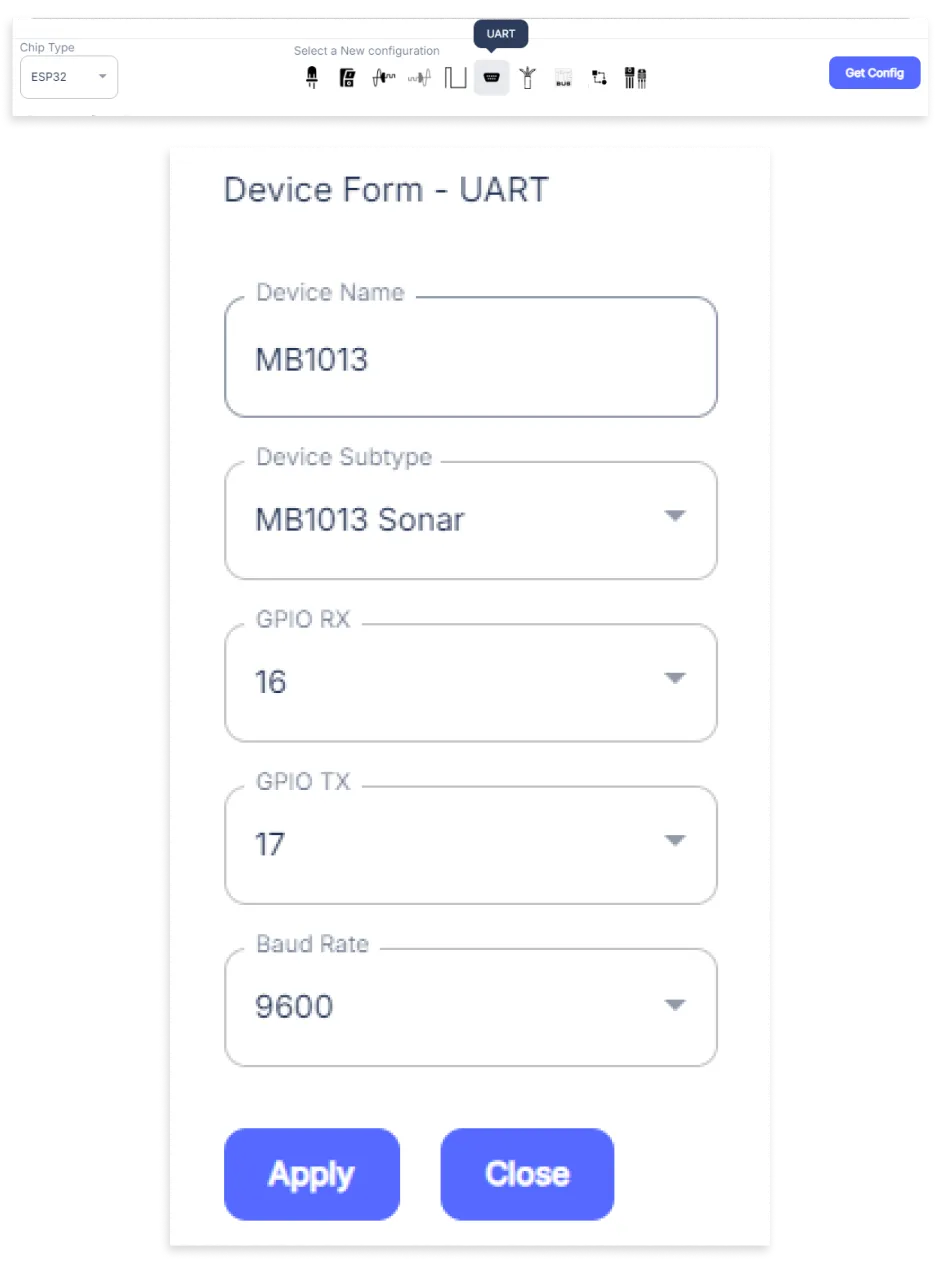

  2. In the Device Configuration, tab click on UART.
  1. A window will open for inputting the following parameters:
  • Set a Device name of your choosing. In our case, we set it to MB1013.
  • Set Device subtype to MB1013 Sonar.
  • Set GPIO RX to 16.
  • Set GPIO TX to 17.
  • Set Baud Rate to 9600.
  • Then Click Apply Button.

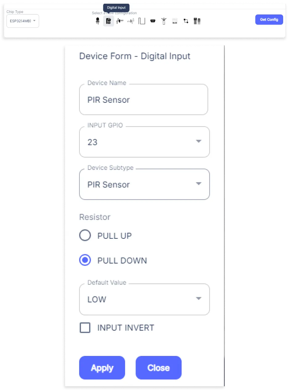

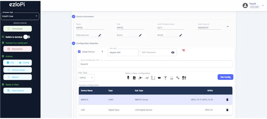

  1. Again, In the Device Configuration, tab click on Digital Input.
  1. A Digital Input window opens for inputting the following parameters:
  • Set a Device name of your choosing. In our case, we set it to PIR Sensor.
  • Set INPUT GPIO to 32.
  • Set Device subtype to PIR Sensor.
  • Set the Resistor to PULL DOWN.
  • After clicking the apply button you can see a table of your setting in the device configuration tab.

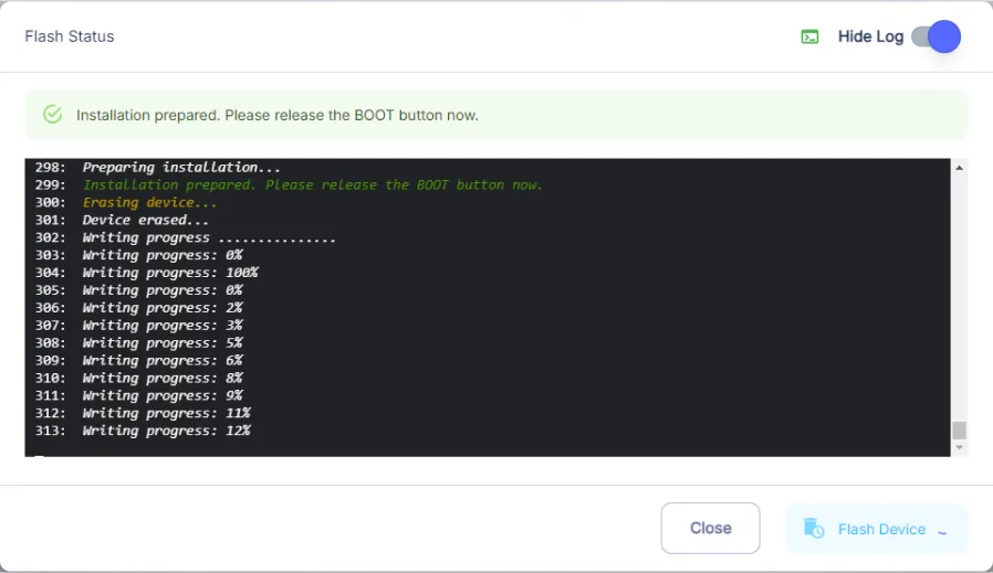

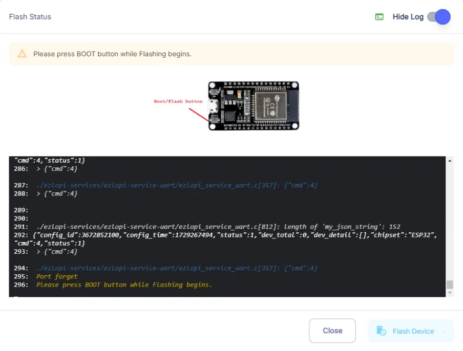

  • Press the Flash Device button.
  1. A window will appear on the bottom right side of the screen displaying “Please press BOOT button while flashing begins.”
  1. Hold the BOOT button down until the next window appears on the bottom right side of the screen which says “Installation prepared. Please release the boot button now.”
  1. Release the BOOT button from your ESP32 when this pop-up on the bottom right window appears.
  1. After some time, a popup will appear saying Device Flashed Successfully! This means that your device has been set up successfully.

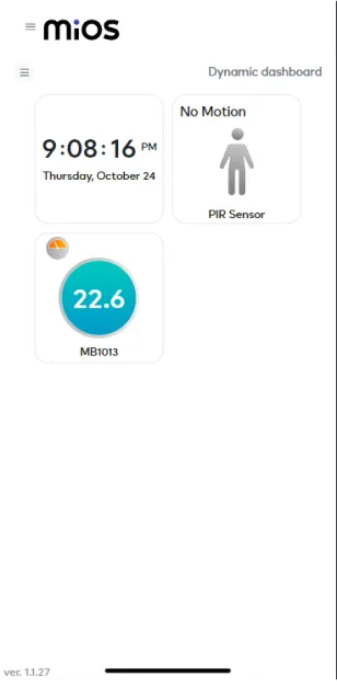

  1. After downloading the app, proceed to install the application and open it.
  1. Using the MIOS mobile application, create a new Ezlo Cloud account using the sign-up option. If you already have an account, you may proceed to log in.

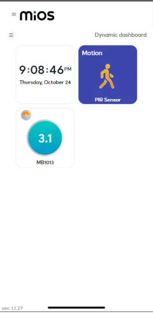

  1. After successfully logging in, you will be able to see the number of controllers connected such as a lamp, fan, or any other device in the MiOS app. Tap on any controller of your desired ID:
  1. You will be able to see the status of your controller whether it is online or offline. Access the device dashboard, and tap the device. The following view of the dashboard will appear:
  1. Here, as seen in the MiOS mobile app above, we can see the MB1013 sonar sensor and PIR sensor tiles. The above figure depicts the scenario where a person is infront of the door so the MB1013 measures the distance of the objects from itself whereas PIR sensor gives the indication of a object.
  1. Similarly as can be seen above the PIR sensor detects a person in front of the door and the person’s distance is measured by the sonar sensor.

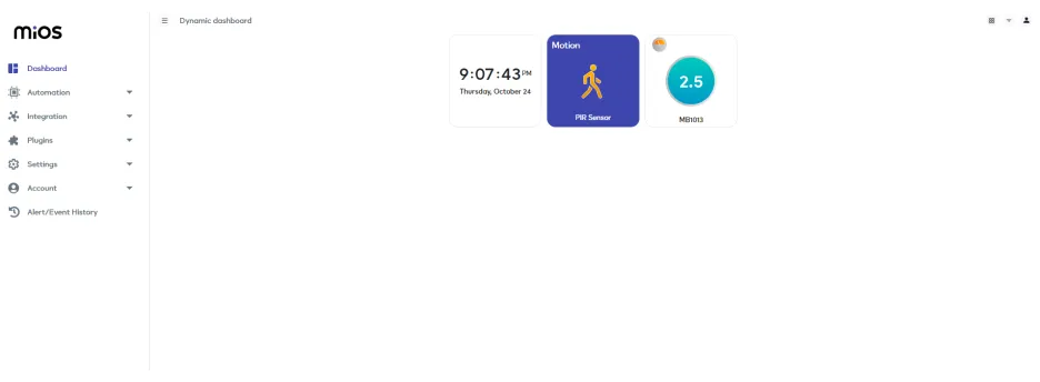

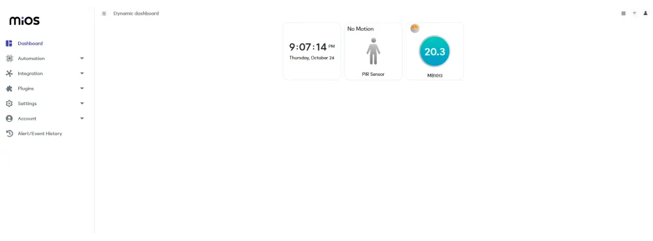

6. MiOS Web Dashboard
  1. After configuring the controller with the EzloPi web flasher, head to ezlogic.mios.com
  1. Use the same credentials to log in that you used for configuring the controller with the web flasher.
  1. Here, as seen in the MiOS web app above, we can see the MB1013 sonar sensor and PIR sensor tiles. The above figure depicts the scenario where a person is in front of the door so the MB1013 measures the distance of the objects from itself whereas the PIR sensor gives the indication of an object.
