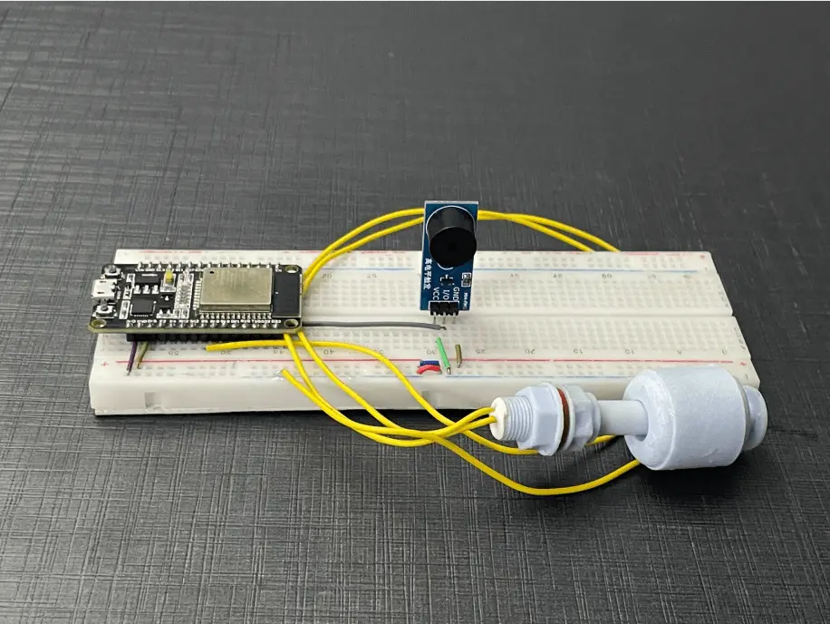

This project aims to interface a P45 float switch and a buzzer with the EzloPi device for efficient water tank level monitoring. The float switch is a simple yet effective liquid level sensor, which is integrated with the EzloPi device to enable real-time monitoring of water levels in various applications for users. This smart monitoring is done by utilizing the MiOS smart platform for allowing the users to monitor and notify them about various water level conditions. We have implemented the float switch in such a way that when the water tank is close to getting full or gets full, the buzzer will be triggered to alert the user to turn off the water pump.
Welcome to the project demonstration video section. The following video showcases the key aspects of Implementing tank full alert with P45 float switch and buzzer, providing a visual walkthrough of its implementation.

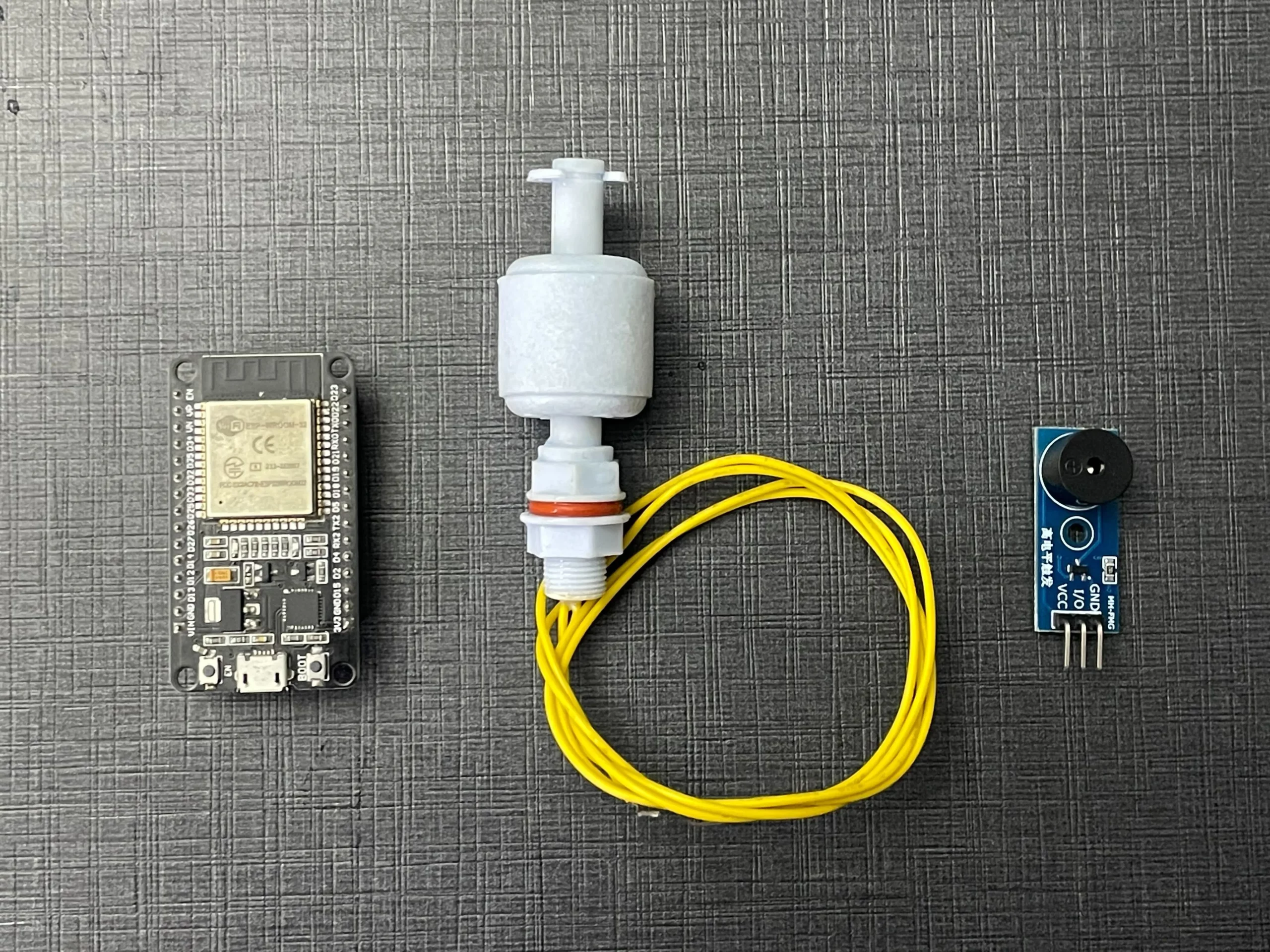

- P45 float switch.
- MH-FMD Buzzer.

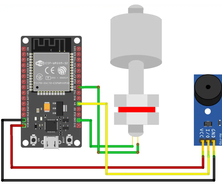

The wiring diagram is represented as follows:
From ESP32 to the Float Switch:
| ESP32 | Float switch |
| GND | 1st terminal |
| D5 | 2nd terminal |
From ESP32 to the MH-FMD Buzzer:
| ESP32 | Buzzer |
| VIN | VCC |
| GND | GND |
| D4 | I/O |

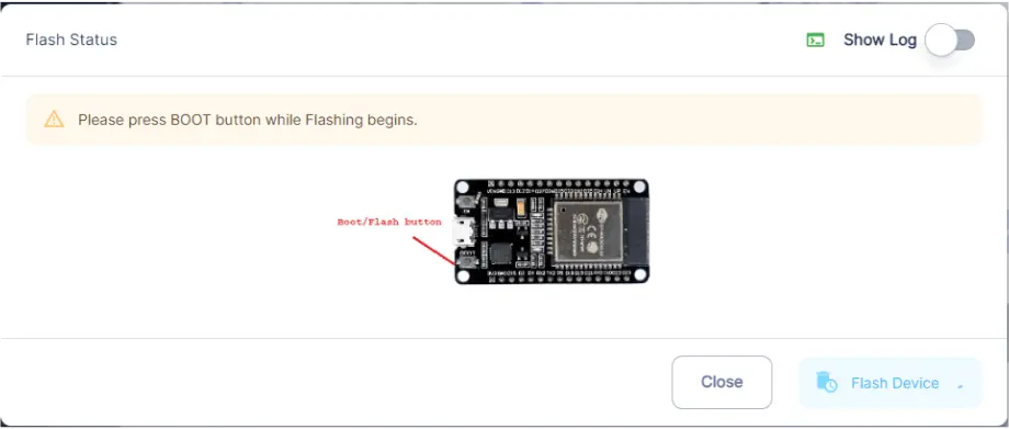

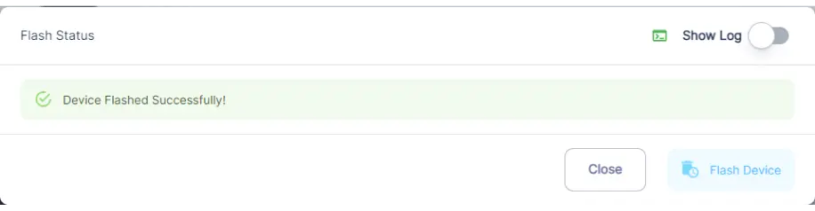

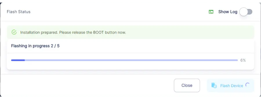

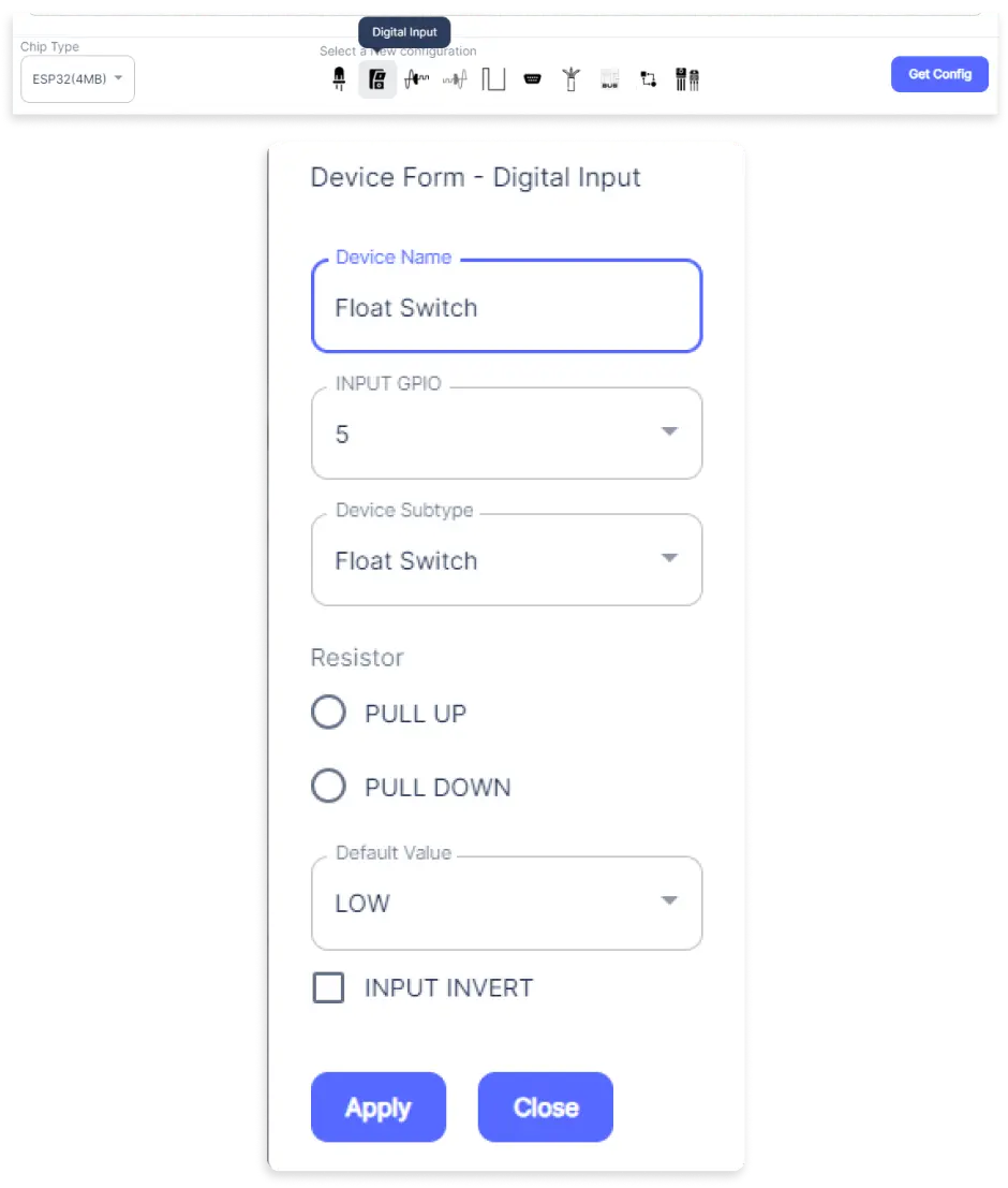

4. Interfacing the float switch with the EzloPi Web Flasher
Click Connect
- A Digital Input window will open for inputting the following parameters:
- Set a device name of your choosing. In our case we set it to Float Switch.
- Set the Input GPIO to 5.
- Set Device Subtype to Float Switch.
- Set Default Value to LOW.
- Now Click the Apply button.

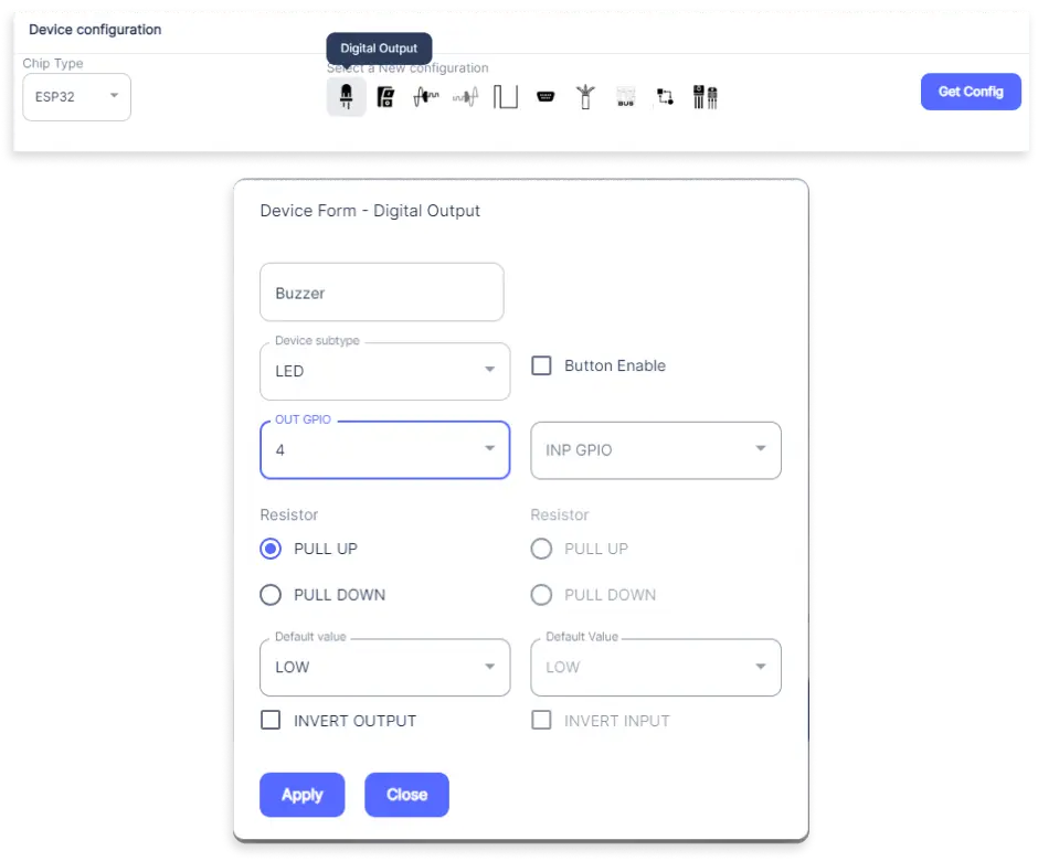

- Set a device name of your choosing. In our case, we set it to Buzzer.
- Set Device subtype to LED.
- Set OUT GPIO to 4.
- Set Resistor to PULL UP.
- Set the default value to LOW.

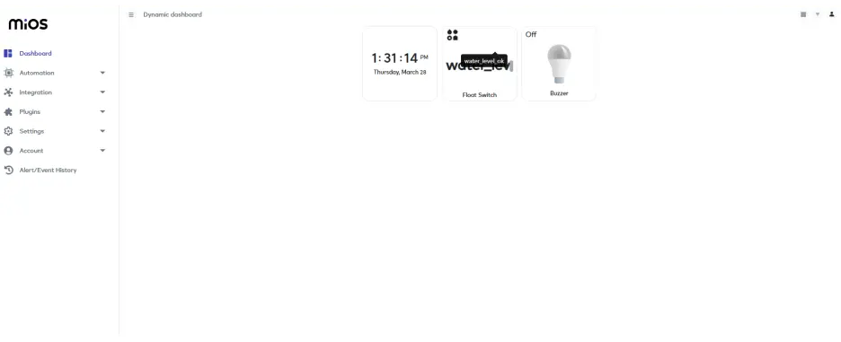

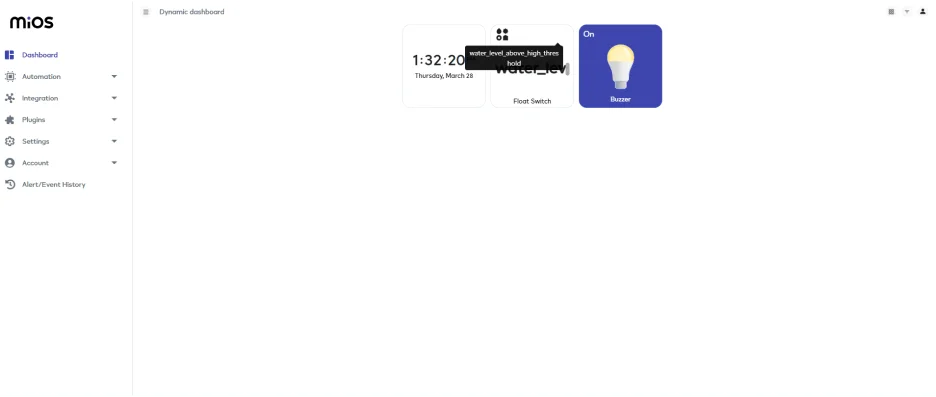

5. MiOS Web Dashboard
- Now, on the MiOS web dashboard, you will be able to see the tile for the float switch.

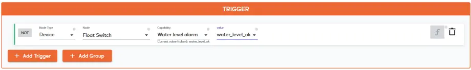

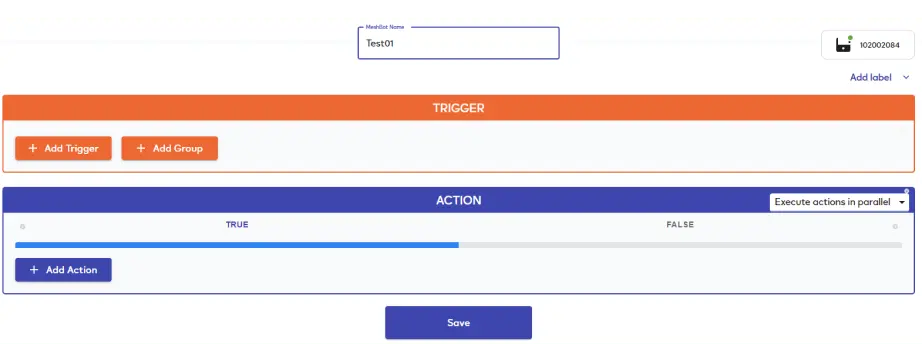

MeshBots:
- On the right side of the screen under Automation, click on MeshBots.
- After clicking on Create new MeshBot you will see new options, now under Automation MeshBot click on Local.
- On the next screen you will see that we can create a name of our choosing, in this case we write it as Test01.
- Set Node Type to Device.
- Set the Node to Proximity Float Switch.
- Set the Capability to Water level alarm.
- Set the Value to water_level_ok.
- Set these values in the True part of the ACTION section.
- Set Controllable Type to Device.
- Set the Controllable to Buzzer.
- Set the Capability to switch.
- Set the Value to true.
- Set these values in the False part of the ACTION section.
- Set the Value to false.
- Now, on the MiOS web dashboard, you will be able to see the tile for the float switch and buzzer.
- When the water level is below the threshold which is set for the float switch, the tile will display “water level ok” message and when the water level increases and rises above the specific threshold that we have set for the tank, the tile will display “water level above high threshold” message and the buzzer alarm will be triggered as we have set the meshbot conditions.

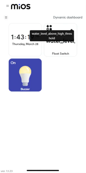

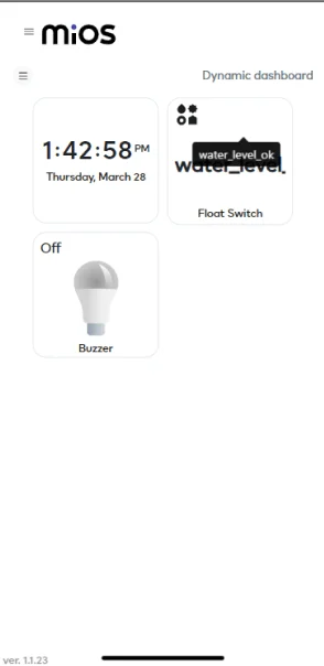

6. MiOS App
- Now, on the MiOS mobile dashboard, you will be able to see the tile for the float switch and buzzer. They will function according to rules we have set in meshbot.
- As you can see in the MiOS mobile dashboard, we can see the float switch tile. When the water level is below the threshold which is set for the float switch, the tile will display “water level ok” message and when the water level increases and rises above the specific threshold that we have set for the tank, the tile will display “water level above high threshold” message and buzzer alarm will be triggered as we have set the meshbot conditions.
