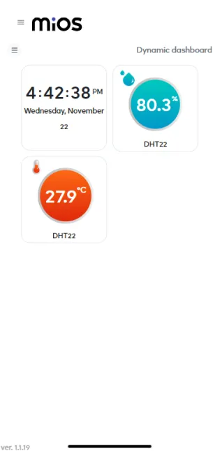

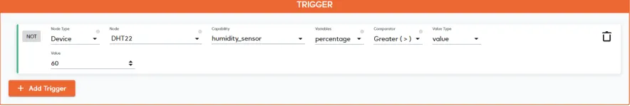

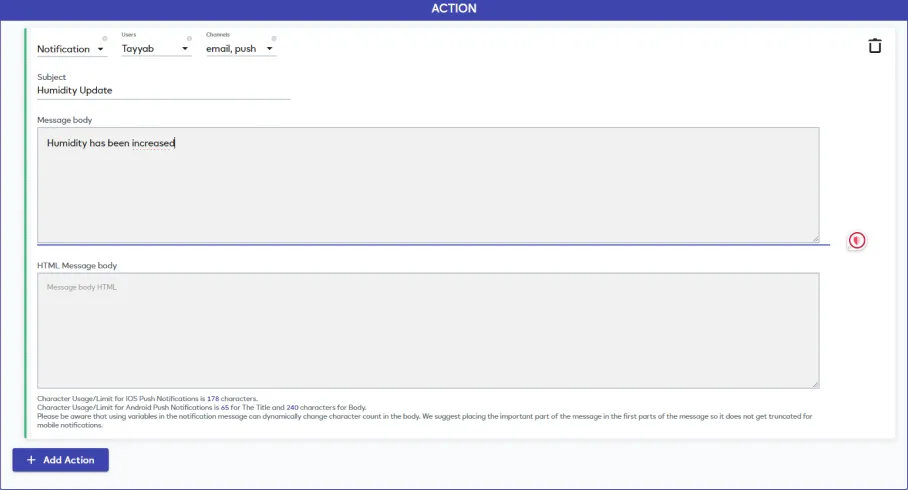

This designed system will operate to continuously monitor the humidity levels. If the humidity readings surpasses a predefined threshold set by the user, an email notification is automatically dispatched to the user's Gmail account. This mechanism serves as an alert to notify the user about the elevated humidity levels beyond the set specified limit and take measures accordingly.

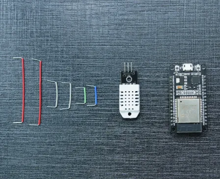

The following components are required for interfacing the DHT22 sensor using the EzloPi device:

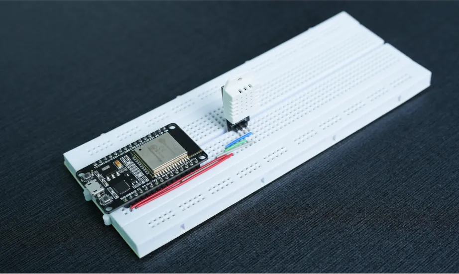

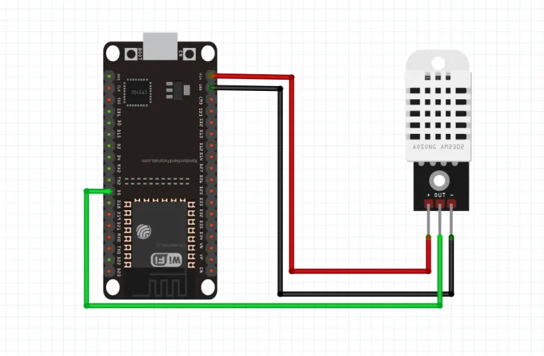

The wiring diagram is represented as follows:
The following connections are made in order to complete the entire circuit setup:
From ESP32 to the DHT22:

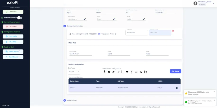

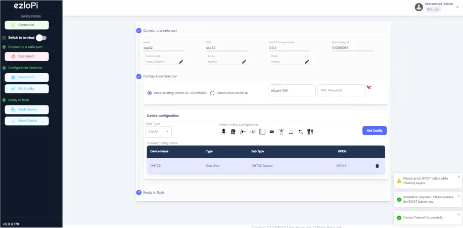

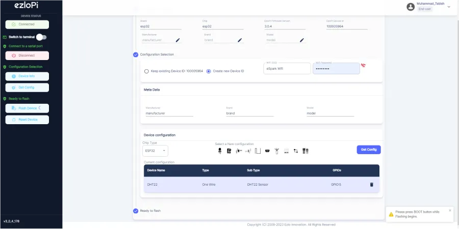

Set up your device/hardware by visiting config.ezlopi.com
Now, select COM Port to which your ESP32 device is connected. In our case, the COM3 port is used.
Click Connect.
eZlopie Products ESP32
