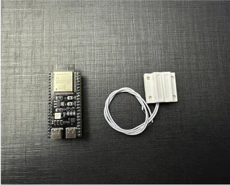

This project aims to interface a door sensor magnetic switch with the EzloPi device, which is based on the ESP32-S3 microcontroller board for this project. The primary goal is to develop a reliable door status monitoring system. The project will involve configuring the ESP32-S3 to read the magnetic switch status, which indicates whether a door is open or closed. The EzloPi device is equipped with enhanced processing capabilities and wireless connectivity, and will transmit this status data over Wi-Fi for integration with home automation systems or for alerts. Furthermore, the implementation includes configuring the web flashed to the ESP32-S3 to handle the sensor data efficiently and securely.

- ESP32-S3 as an EzloPi smart device.
- MC-38 Magnetic Door Switch.

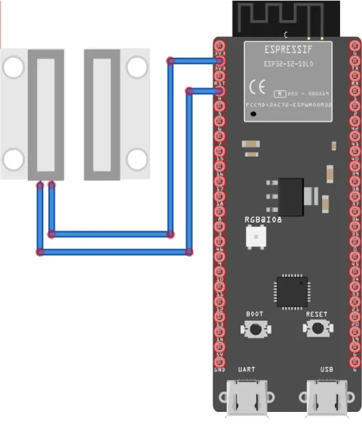

From ESP32-S3 to the MC-38 Magnetic Door Switch:
- Connect the 3V3 of the ESP32-S3 with any one wire of the MC-38 Magnetic Door Switch.
- Connect the D4 pin of the ESP32-S3 to another wire of MC-38 Magnetic Door Switch.

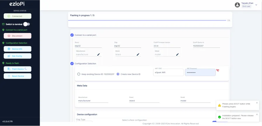

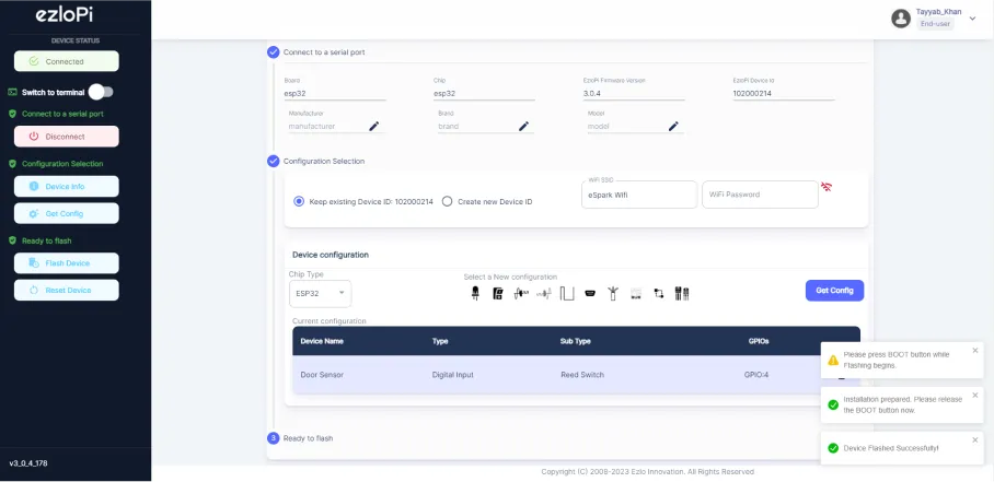

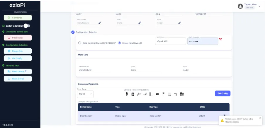

4. Interfacing the MC-38 Magnetic Door Switch module using the EzloPi Web Flasher:
Click Connect
- A Digital Input window will open for inputting the following parameters:
- Set a device name of your choosing. In our case, we set it to Door Sensor
- Set the INPUT GPIO input pin to 4.
- Set device Subtype to Reed Switch.
- Set the Resistor Setting to PULL DOWN.Now Click the Apply button.

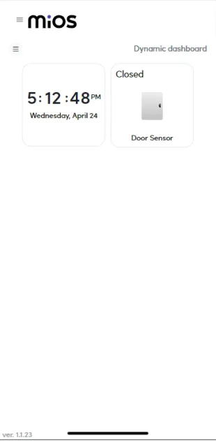

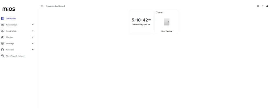

- After opening the MiOS mobile dashboard, you will be able to see the tile of your connected device. As you can see in the example given above, we can see the door sensor tile. It shows a “Closed” message on the tile as the sensor is detecting that the door is closed.

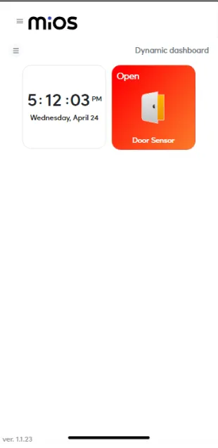

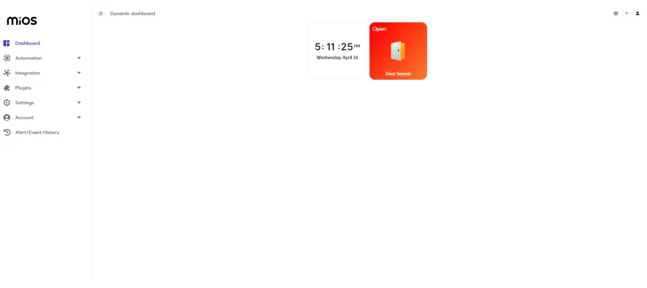

- Now as shown above, an “Open” message on the tile when the sensor detects no magnetic fields implying that the door is open.

- Now, you will see a tile labeled as Door sensor on the MiOS web application dashboard. Currently, As you can see above, It shows a “Closed” message on the tile as the sensor is detecting that the door is closed.
