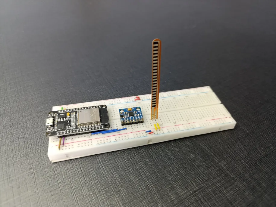

The gesture recognition system utilizes the MPU6050 3-axis accelerometer and gyroscope module, along with the ADA1070 flex sensor, interfaced with the EzloPi device to detect and interpret hand movements. The MPU6050 provides precise motion tracking through accelerometer and gyroscope data, capturing movement dynamics, while the ADA1070 flex sensor measures finger or joint bending angles. By processing this combined data, this system recognizes various gestures in real time, which enables applications such as controlling devices or triggering actions with simple hand movements. This setup offers versatility in smart home automation, robotics, and interactive systems.
Welcome to the project demonstration video section. The following video showcases the key aspects of Gesture recognition system, providing a visual walkthrough of its implementation.
- MPU6050 3-axis accelerometer and gyroscope module.
- ADA1070 flex sensor.
- Resistor of 100 Ohms as voltage divider.
The wiring diagram for the ESP32 30 pin is represented as below:
From ESP32 to MPU6050:
| ESP32 | MPU6050 |
| 3V3 | VCC |
| GND | GND |
| 21 | SCL |
| 22 | SDA |
From ESP32 to Flex Resistor & Resistor:
| ESP32 | MOSFET driver module |
| D15 | Trig |
| GND | GND |
From Power Supply to the MOSFET driver module:
| ESP32 | Flex Resistor/Sensor | Resistor |
| VIN | Terminal 1 | |
| - | Terminal 2 | Terminal 1 |
| 32 | Terminal 2 | Terminal 1 |
| GND | - | Terminal 2 |

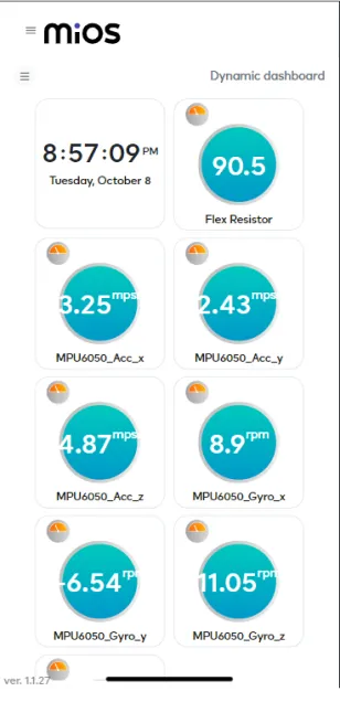

5. MiOS App
- After opening the MIOS mobile app, you will be able to see the tiles of your connected devices. The MPU6050 shows the accelerometer and gyro data of the three axes i.e X,Y and Z regarding hand gestures whereas flex resistor also shows the value when the hand bends.
- Now as seen above, there are now different values being shown on the tiles of both MPU6050 and flex resistor as they depict different values when there is a different gesture being made. Due to a different gesture, the values of the three axes movement data will also vary and the bending is also shown by the flex resistor.

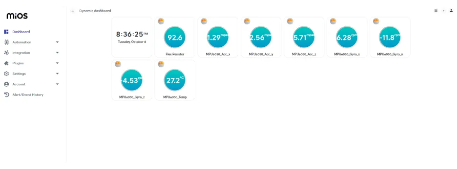

6. MiOS Web Dashboard
- After opening the MIOS web dashboard, you will be able to see the tiles of your connected devices. The MPU6050 shows the accelerometer and gyro data of the three axes i.e X,Y and Z regarding hand gestures whereas flex resistor also shows the value when the hand bends.
