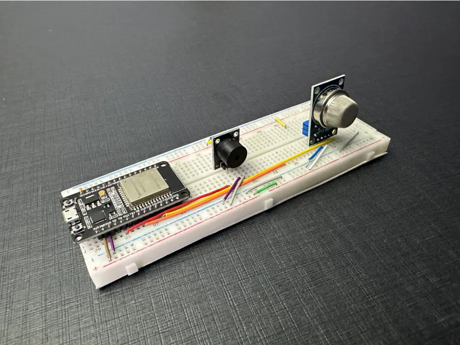

This project aims to interface the MQ8 H2 gas sensor module and a buzzer with the EzloPi device for gas leak detection in industries. The MQ8 hydrogen (H2) detection sensor is an essential component in industrial safety systems, designed to detect hydrogen gas concentrations in the environment. Its timely detection capabilities can prevent accidents and ensure a safe working environment. Buzzer is also incorporated in the project for providing audible feedback to the user. Many other smart devices and sensors can also be integrated in this project for a more dynamic system. Through the MiOS app, users can remotely monitor the H2 gas concentration which is displayed on the MiOS smart application.
Welcome to the project demonstration video section. The following video showcases the key aspects of Gas detection using MQ8 H2 sensor, providing a visual walkthrough of its implementation.

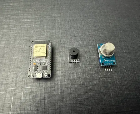

  • as an EzloPi smart device.
  • MQ8 H2 Gas sensor module.
  • MH-FMD Buzzer

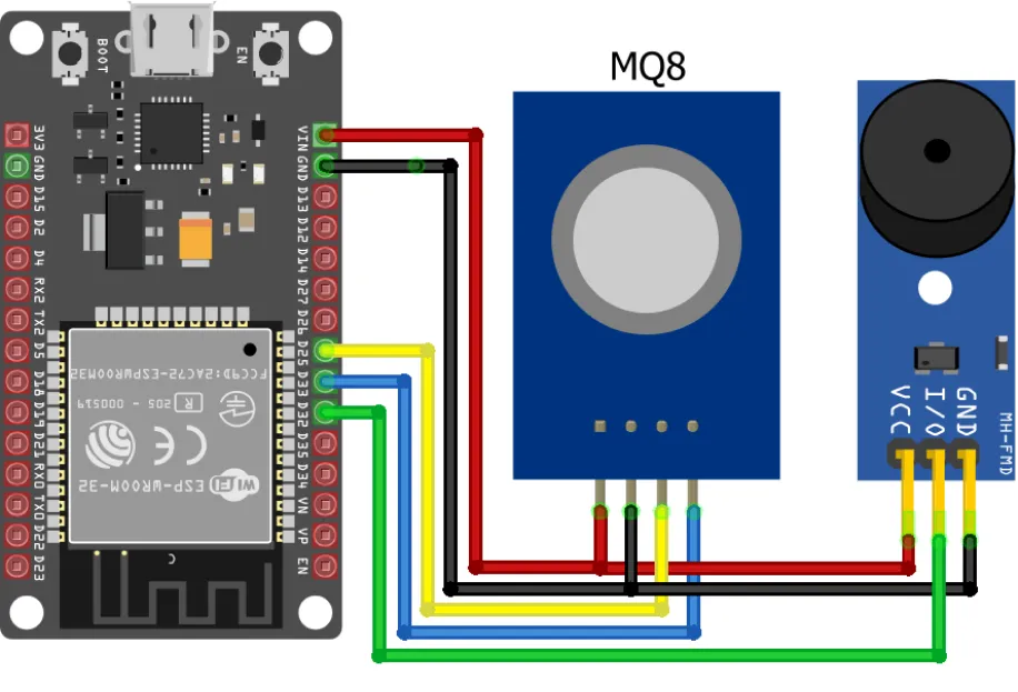

From ESP32 to the MQ8 gas sensor:
ESP32 MQ8 sensor
VIN VCC
GND GND
D5 DO
D33 A0
From ESP32 to the Buzzer:
ESP32 Buzzer
VIN VCC
GND GND
D32 I/O

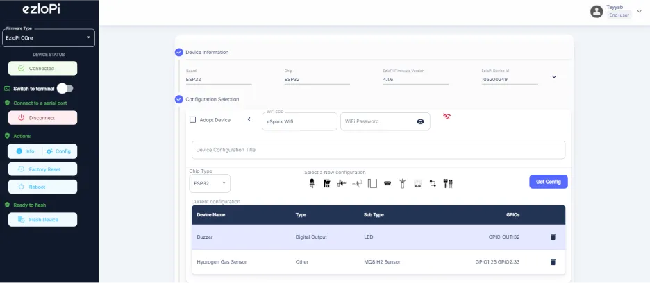

4. Interfacing the Soil moisture sensor and DHT22 with the EzloPi Web Flasher
  1. Log in using the credentials which you just set earlier while signing up.
  1. Now, click on the Connect Device button and a pop-up window will appear.
  1. Now, select COM Port to which your ESP32 device is connected. In our case, the COM3 port is used.
Click Connect
  1. If you are new to this and it's your first time configuring, select Create new Device ID. Enter Wifi SSID and Wifi Password.

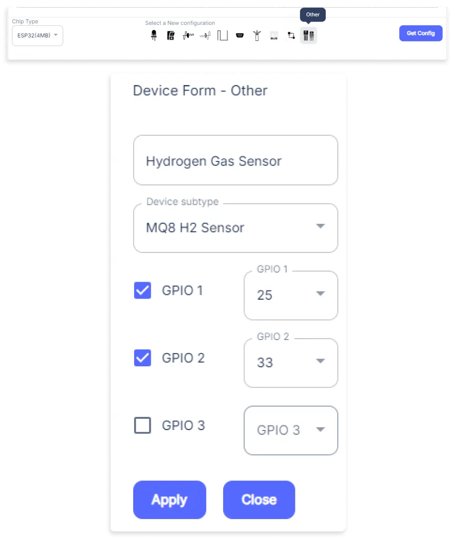

  2. In the Device Configuration, tab click on Other.
  1. A window will open for inputting the following parameters:
  • Set a Device name of your choosing. In our case, we set it to the Hydrogen Gas Sensor.
  • Set Device subtype to MQ8 H2 Sensor.
  • Check the box of GPIO 1.
  • Set the GPIO 1 to 25.
  • Check the box of GPIO 2.
  • Set the GPIO 2 to 33.
  • Then Click Apply Button.

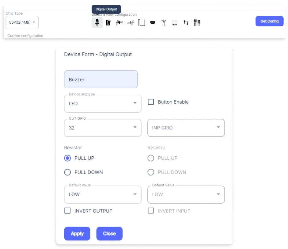

  1. In the Device Configuration, tab click on Digital Output.
  • Set a Device name of your choosing. In our case, we set it to Buzzer.
  • Set Device subtype to LED.
  • Set OUT GPIO to 32.
  • Set Resistor to PULL UP.
  • Set Default value to LOW.
  • After clicking the apply button you can see a table of your setting in the device configuration tab.

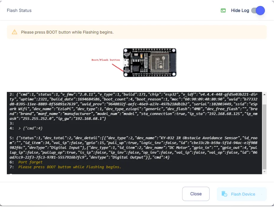

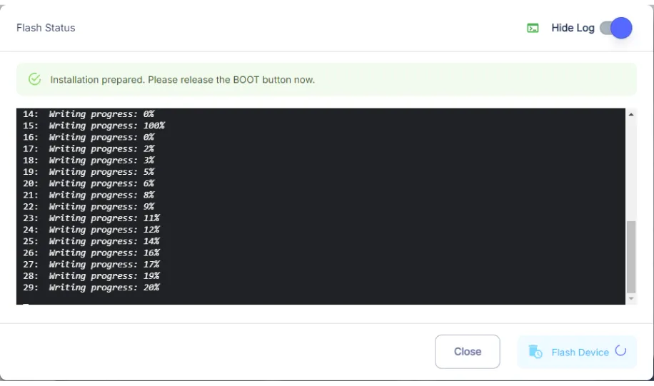

  • Press the Flash Device button.
  1. A window will appear on the bottom right side of the screen displaying “Please press BOOT button while flashing begins.”
  1. Hold the BOOT button down until the next window appears on the bottom right side of the screen which says “Installation prepared. Please release the boot button now.”
  1. Release the BOOT button from your ESP32 when this pop-up on the bottom right window appears.
  1. After some time, a popup will appear saying Device Flashed Successfully! This means that your device has been set up successfully.

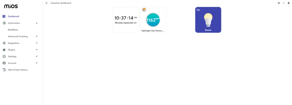

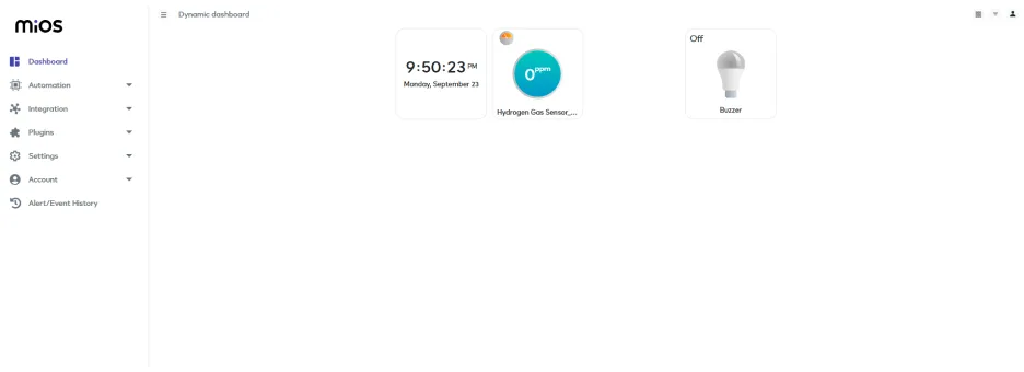

5. MiOS Web Dashboard
  1. After configuring the controller with the EzloPi web flasher, head to ezlogic.mios.com
  1. Use the same credential to log in that you used for configuring the controller with the web flasher.
  1. On the MiOS web dashboard, you will see the tiles of your connected devices as shown above labeled as MQ8 Hydrogen Gas sensor and Buzzer for alarm. Currently, no gas is being detected by the sensor therefore the MQ8 sensor shows zero value and buzzer tile also shows the “Off” message.

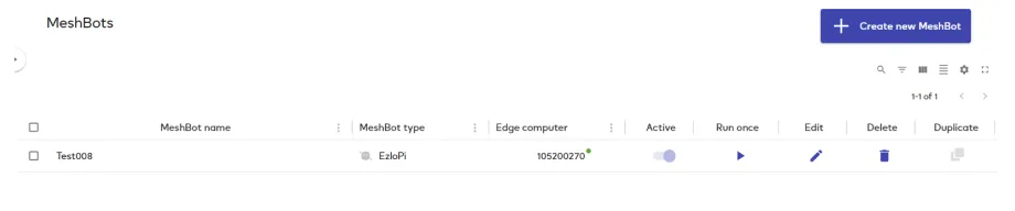

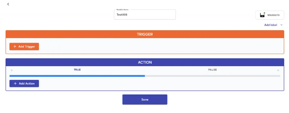

MeshBots:
  1. On the left side of the screen under Automation, click on MeshBots.
  2. On meshbot screen, click on Create new MeshBot button present on the top right corner of the screen.
  3. After clicking on Create new MeshBot, you will see this now under Automation MeshBot click on EzloPi.
  1. On the next screen you will see that we can create a name of our choosing, in this case we write it as Test008.
  1. In the trigger tab you can set the TRIGGER for your device and in the ACTION tab you can set the action to be performed based on the trigger which you have created.

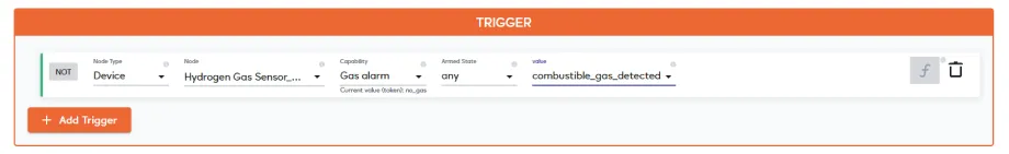

  1. Set these things in TRIGGER section:
  • Set Node Type to Device.
  • Set the Node to Hydrogen Gas Sensor.
  • Set the Capability to Gas alarm.
  • Set the value to combustible_gas_detected.

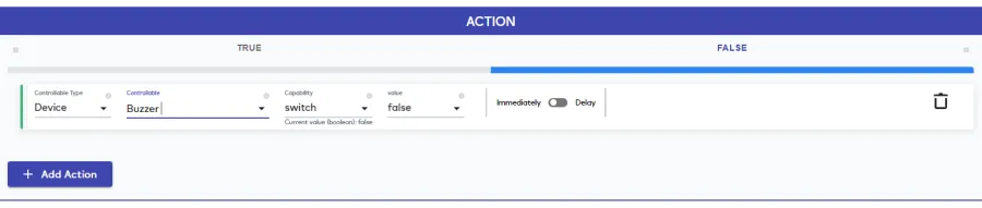

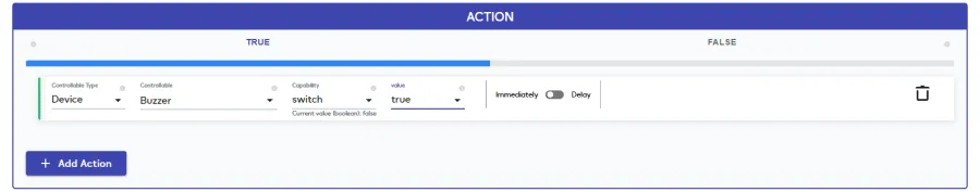

  1. Set these values in the TRUE part of the ACTION section.
  • Set Node type to Device.
  • Set Controllable to Buzzer.
  • Set Capability to switch.
  • Set value to true.
  1. Set these values in the FALSE part of the ACTION section.
  • Set value to false.
  • After clicking the apply button you can see a table of your setting in the Current configuration tab.
  1. After clicking the save button you can see this screen on the top right corner of the screen.
  1. Here you can see your saved MeshBot. Now click on Dashboard.
  1. Now as seen above, the tile is showing that when the MQ8 hydrogen gas sensor gets a high value of gas concentration which means that it detects a gas leak, therefore the buzzer also gets turned ON or triggered because of the rules we have set in the meshbot.

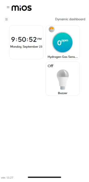

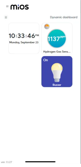

  1. After successfully logging in, you will be able to see the number of controllers connected such as a lamp, fan, or any other device in the MiOS app. Tap on any controller of your desired ID:
  1. You will be able to see the status of your controller whether it is online or offline. Access the device dashboard, and tap the device. The following view of the dashboard will appear:
  1. On the MiOS mobile dashboard, you will see the tiles of your connected devices as shown above labeled as MQ8 Hydrogen Gas sensor and Buzzer for alarm. Currently, no gas is being detected by the sensor therefore the MQ8 sensor shows zero value and buzzer tile also shows the “Off” message.
