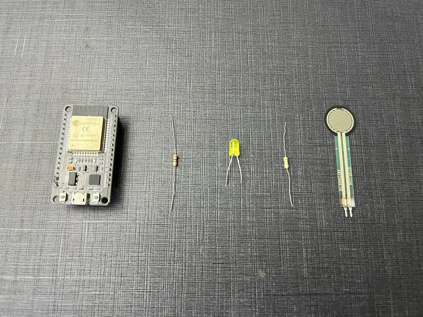

- Force Sensitive Resistor FSR402.
- Resistor 10Kohm.
- LED with 100 Ohm Resistor

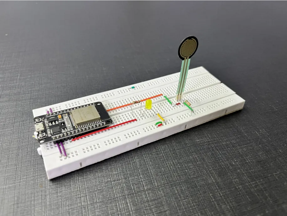

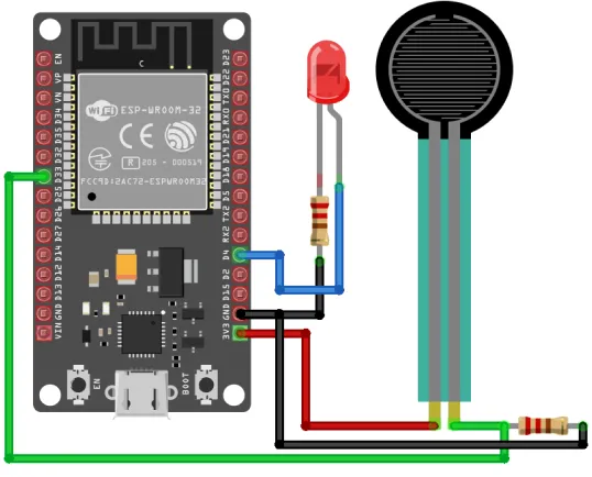

From ESP32 to the FSR402 & Resistor:
ESP32 | FSR402 | Resistor |
3V3 | 1st terminal of the sensor | - |
D5 | - | 1st terminal of the resistor |
D33 | 2nd terminal of the sensor | 2nd terminal of the resistor |
From ESP32 to the LED & Resistor:
ESP32 | LED | Resistor |
D4 | Anode | - |
GND | - | 1st terminal of the resistor |
- | Cathode | 2nd terminal of the resistor |

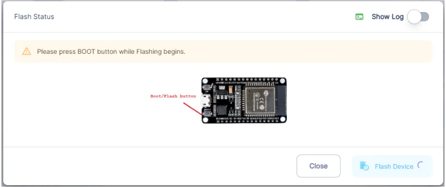

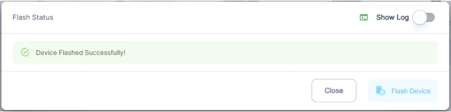

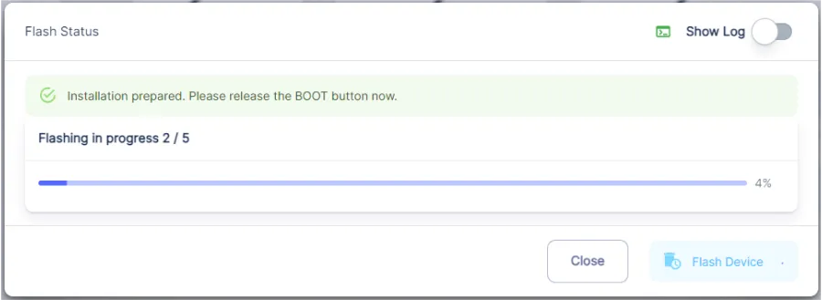

4. Interfacing the Force Sensitive Resistor by using EzloPi Web Flasher
Click Connect

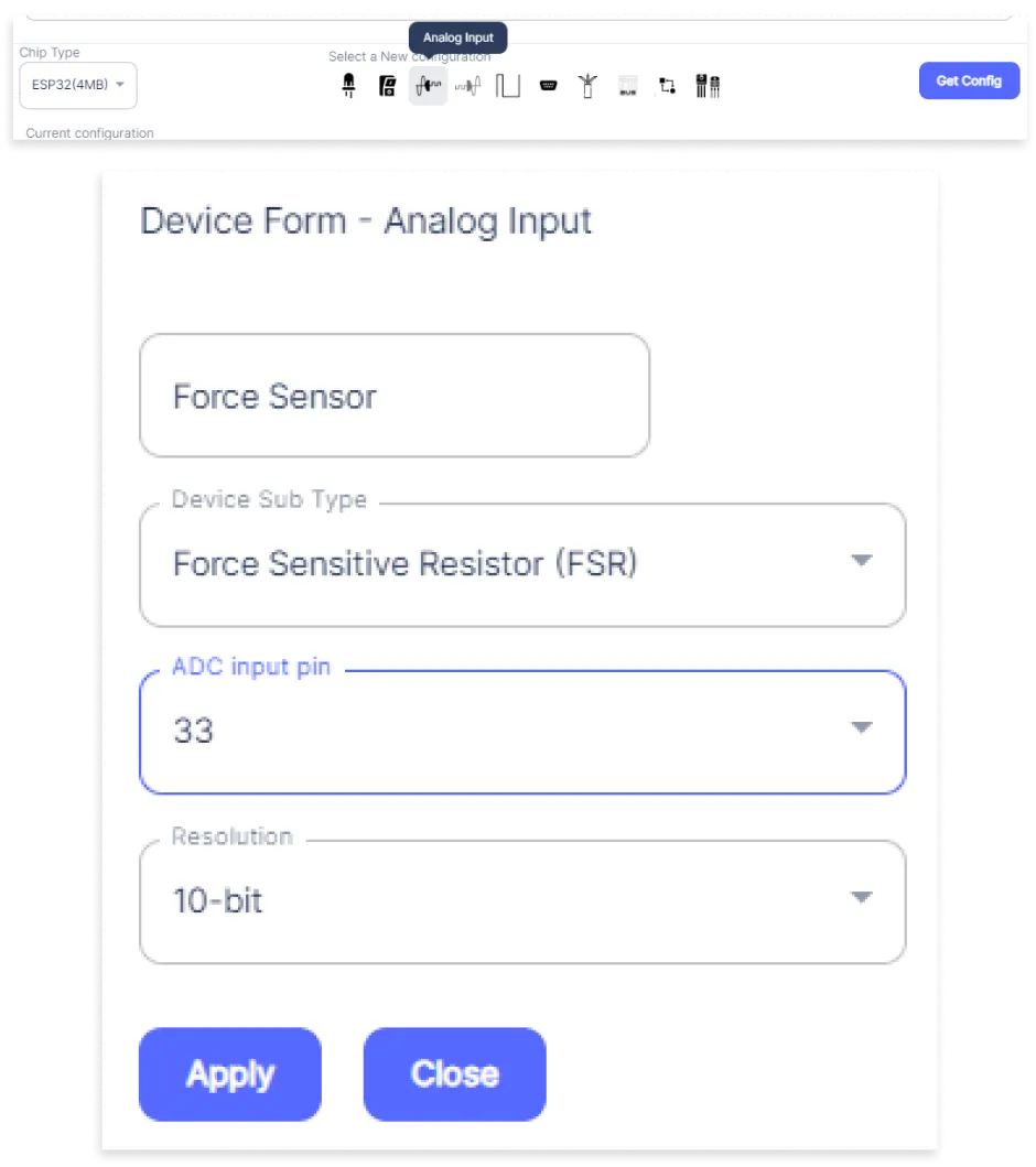

- In the Device Configuration, tab click on Analog Input.
- An Analog Input window will open for inputting the following parameters:
- Set a Device name of your choosing. In our case we set it to FSR402.
- Set the Device Subtype to Force Sensitive Resistor (FSR).
- Set the ADC input pin to 33.
- Now Click the Apply button.

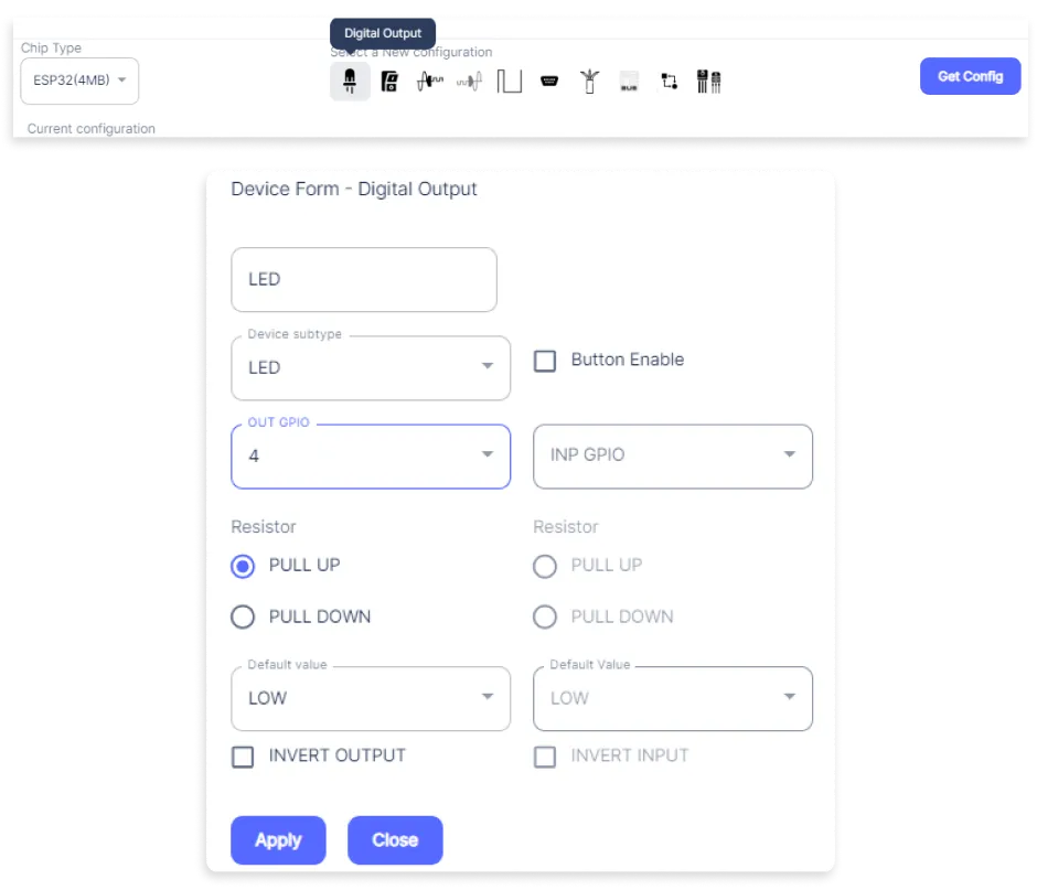

- A Digital Output window will be opened for inputting the following parameters:
- Set a Device name of your choosing. In our case we set it to LED.
- Set the Device Subtype to LED.
- Set the OUT GPIO to 4.
- Set Resistor to PULL UP.
- Set Default value to LOW.

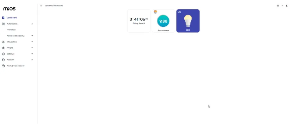

5. MiOS Web Dashboard

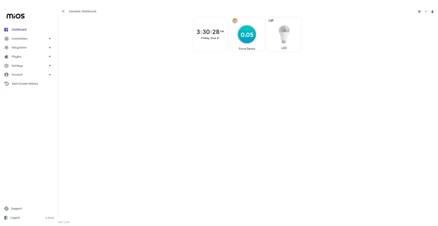

- After opening the MiOS web dashboard, you will be able to see the tile of your connected devices. For now, no force is exerted on the sensor as it shows very little value and the LED is not triggered.

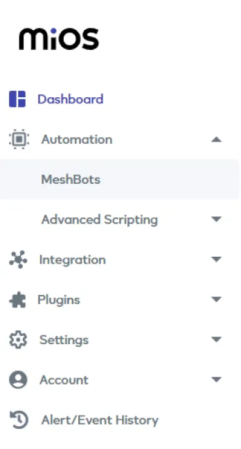

MeshBots

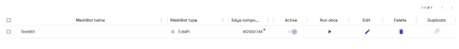

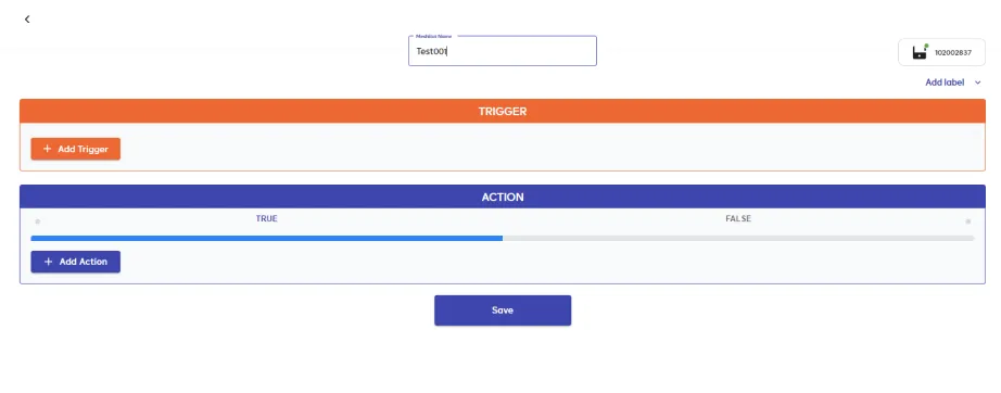

- After clicking on Create new MeshBot you will see new options, click on EzloPi.
- On the next screen you will see that we can create a name of our choosing, in this case we write it as Test001.

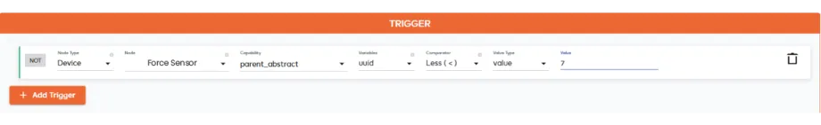

- Set these values in TRIGGER section:
- Set Node Type to Device.
- Set the Node to Force Sensor.
- Set the Capability to Dw state.
- Set the value to dw_is_opened.

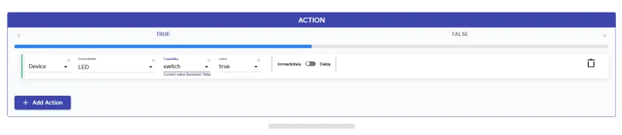

- Set these values in the True part of the ACTION section.
- Set Controllable Type to LED.
- Set the Capability to Switch.
- Set the value to true.

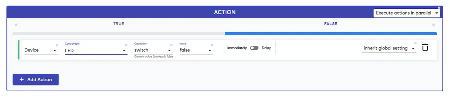

- Set these values in the False part of the ACTION section.
- Set the value to false.
- After clicking the apply button you can see a table of your setting in the Current configuration tab.
- Here, it can be seen that when force is exerted on the sensor, its value changes as shown on the tile of the sensor, and the LED also turns on because of the rules we have set in the meshbot.

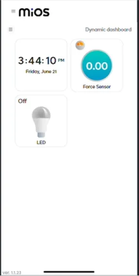

6. MiOS App
- After opening the MiOS mobile dashboard, you will be able to see the tile of your connected devices. For now, no force is exerted on the sensor as it shows very little value and the LED is not triggered.
