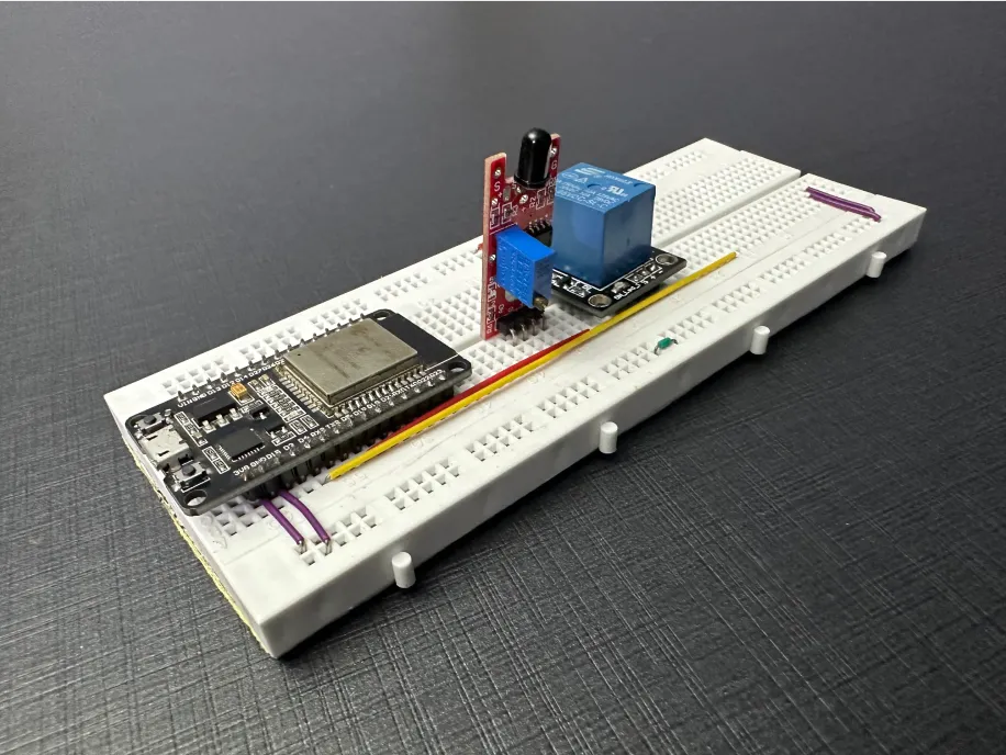

This project involves interfacing a KY-026 Flame Sensor module with the EzloPi device to detect fire and control the main power supply via a single-channel relay module. The flame sensor will continuously monitor for the presence of fire. Upon detection, the EzloPi device will receive the signal and trigger the relay module to turn off the main power supply, thereby enhancing safety by preventing potential fire hazards. Users can remotely monitor the fire detection system through the MiOS smart application.
Welcome to the project demonstration video section. The following video showcases the key aspects of Fire Detection with Automated Power Shutdown, providing a visual walkthrough of its implementation.

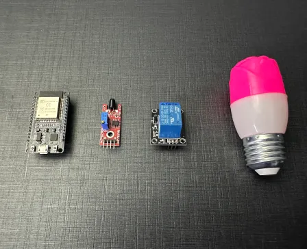

- KY-026 Flame sensor module.
- Single-channel relay module.

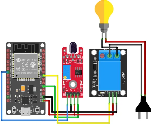

From ESP32 to KY-026:
| ESP32 | KY-026 |
| 3V3 | + |
| GND | G |
| D4 | D0 |
| D33 | A0 |
From ESP32 to Relay:
| ESP32 | Relay |
| VCC | VCC |
| GND | GND |
| D5 | S |
From Relay to Bulb & 220AC Main Power:
| Relay | Bulb | 220AC |
| COM | NA | Neutral |
| NO | 1st Terminal | NA |
| NA | 2nd terminal | Phase |

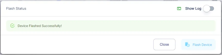

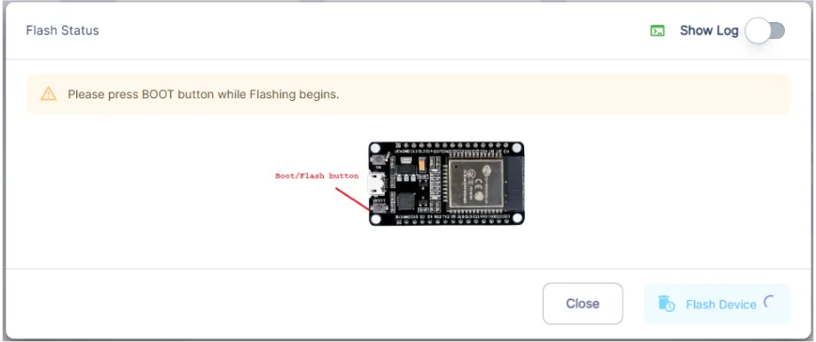

4. Interfacing the Flame sensor & Relay using EzloPi Web Flasher
Click Connect

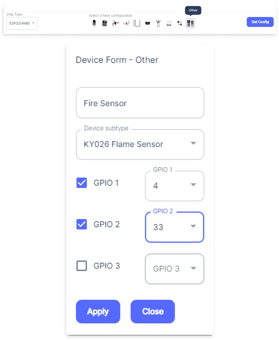

- In the Device Configuration, tab click on Other.
- An Other window will open for inputting the following parameters:
- Set a device name of your choosing. In our case, we set it to the Fire Sensor.
- Set Device subtype to KY-026 Flame Sensor.
- Check GPIO1 and Set it to 4 for Digital output.
- Check GPIO2 and Set it to 33 for Analog Value.
- Then Click Apply Button.

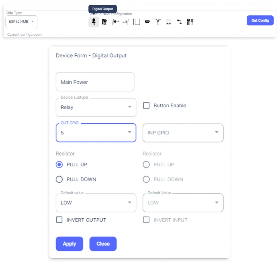

- Set a device name of your choosing. In our case, we set it to Main Power.
- Set Device subtype to Relay.
- Set OUT GPIO to 5.
- Set Resistor to PULL UP.
- Set the default value to LOW.

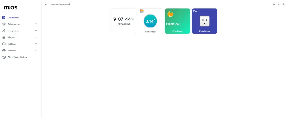

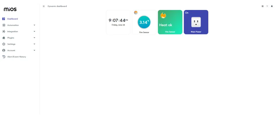

5. MiOS Web Dashboard
- After opening the MiOS web dashboard, you will be able to see the tile of your connected device. The KY-026 flame sensor and Main power relay works as a system for cut off power to stop spreading of fire. As seen above, currently no fire is being detected by the sensor.

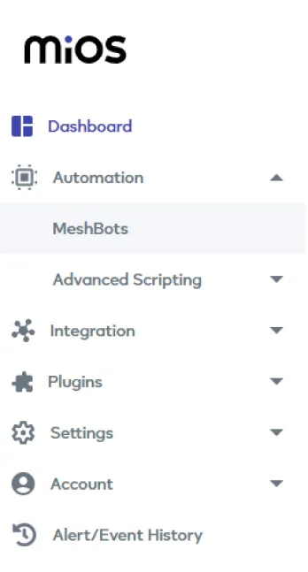

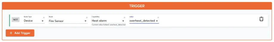

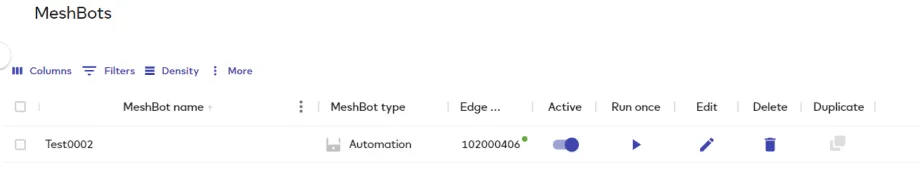

MeshBots:

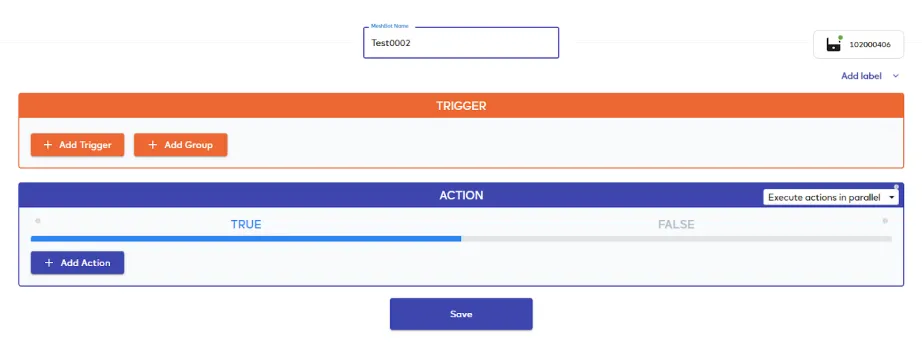

- After clicking on Create new MeshBot, you will see this now under Automation MeshBot click on EzloPi.
- On the next screen you will see that we can create a name of our choosing, in this case we write it as Test0002.
- Set Node Type to Device.
- Set the Node to Fire Alarm.
- Set the Capability to Heat alarm.
- Set Value to overheat detected.
- Click on TRUE.

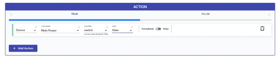

- Set Controllable to Main Power.
- Set the Capability to switch.
- Set the Value to false.
- Set Action to Immediately.

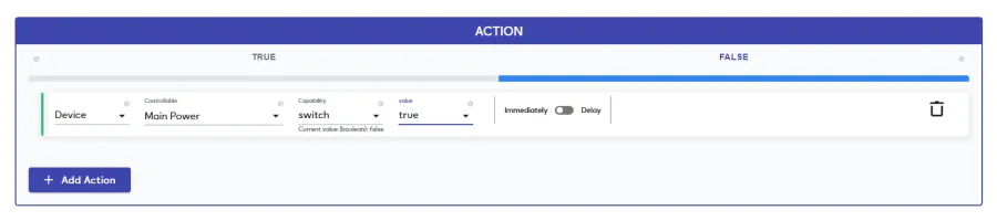

- Click on FALSE.
- Set the Value to true.
- Now Click the Save button.

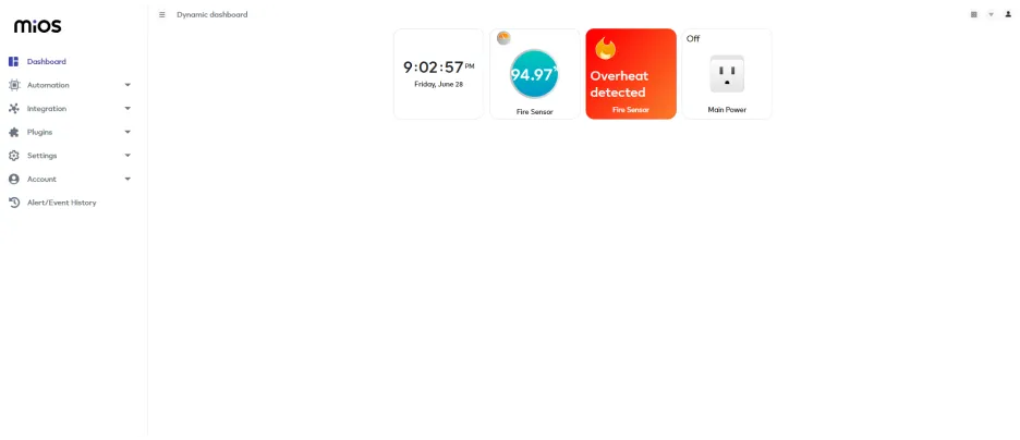

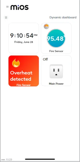

- After opening the MiOS web dashboard, as seen above, currently no fire is being detected by the sensor.
- As seen above, when a fire or flame is detected, the relay connected to the main power will cut off the main power according to the rules we have set in the meshbot.

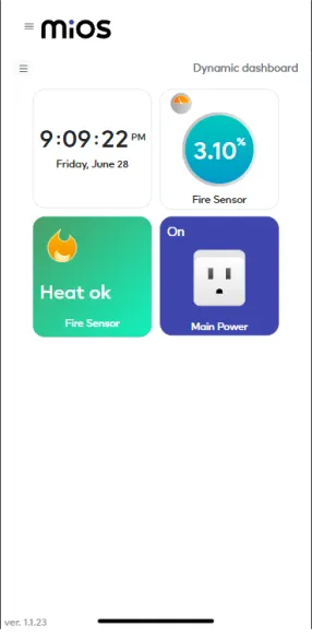

6. MiOS App
- After opening the MiOS mobile dashboard, you will be able to see the tile of your connected device. The KY-026 flame sensor and Main power relay works as a system for cutting off the main power to stop the further spread of fire. As seen above, currently no fire is being detected by the sensor.
