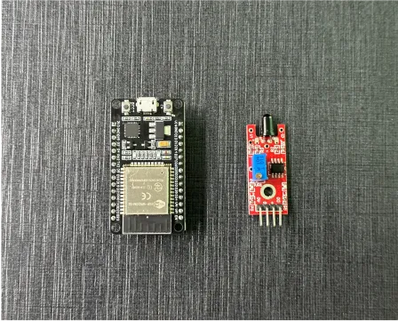

- KY-026 Flame sensor module.

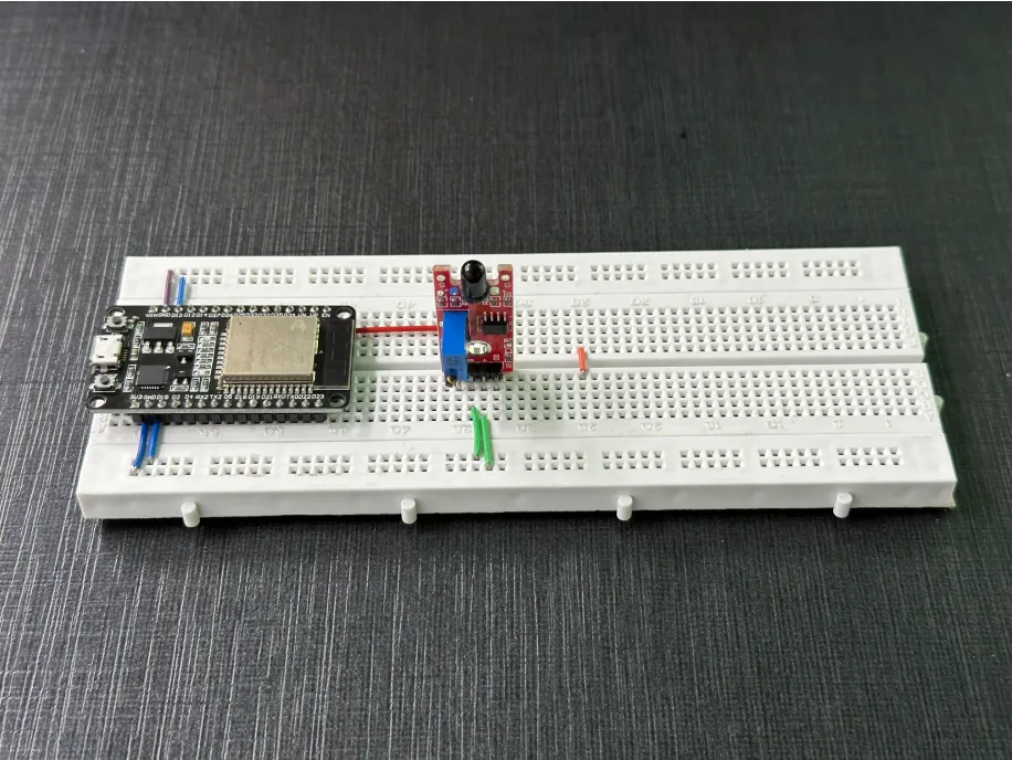

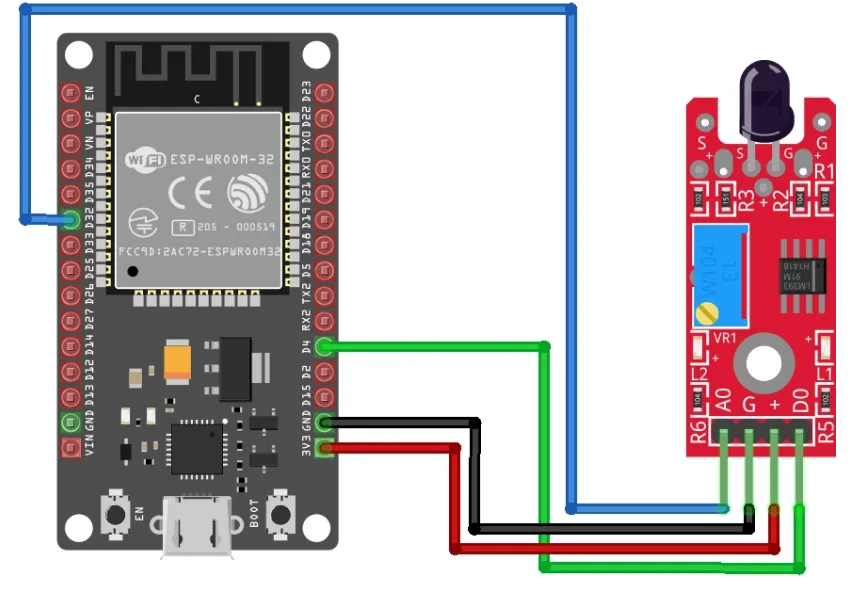

The wiring diagram for the ESP32 30 pin is represented as below:
From ESP32 to the KY-026 Flame Sensor:
- Connect 3.3V from the ESP32 to the VCC (+ pin) of the sensor.
- Connect GND from the ESP32 to the GND (G) pin of the sensor.
- Connect D4 from the ESP32 to the D0 pin of the sensor.
- Connect D33 from the ESP32 to the A0 pin of the sensor.

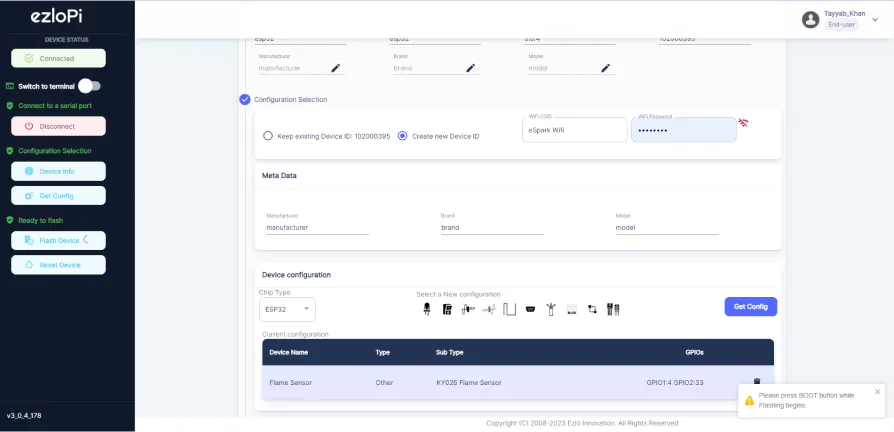

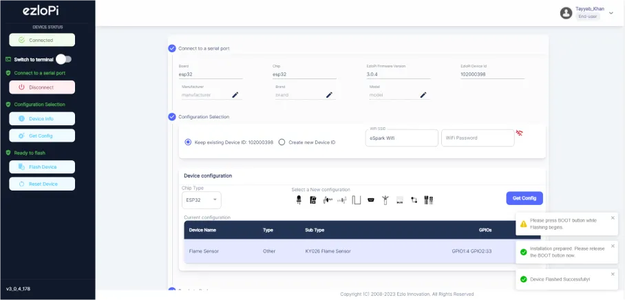

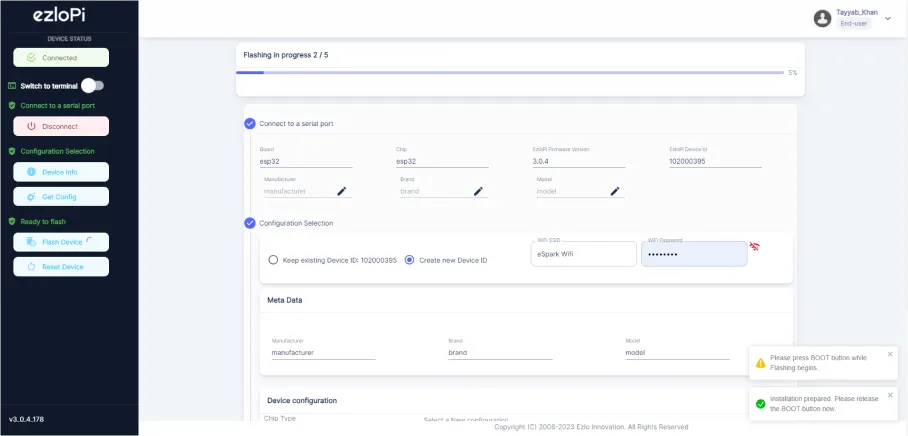

3. Interfacing the KY-026 Flame sensor module using the EzloPi Web Flasher:
Now, select COM Port to which your ESP32 device is connected. In our case, the COM3 port is used.
Click Connect.

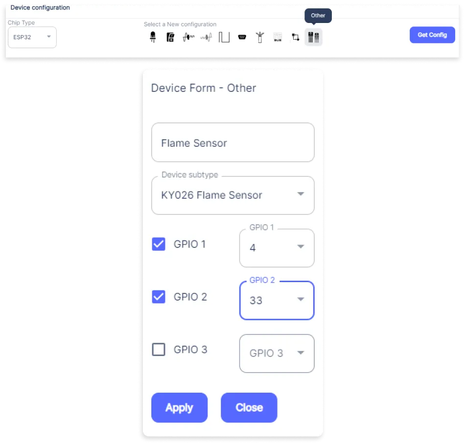

- In the Device Configuration, tab click on Other.
- A window will open for inputting the following parameters:
- Set a device name of your choosing. In our case, we set it to Flame Sensor.
- Set Device subtype to KY026 Flame Sensor.
- Check the box of GPIO 1.
- Set GPIO 1 to 4.
- Check the box of GPIO 2.
- Set GPIO 2 to 33.
- Then Click Apply Button.

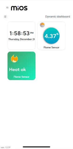

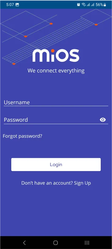

4. MiOS App

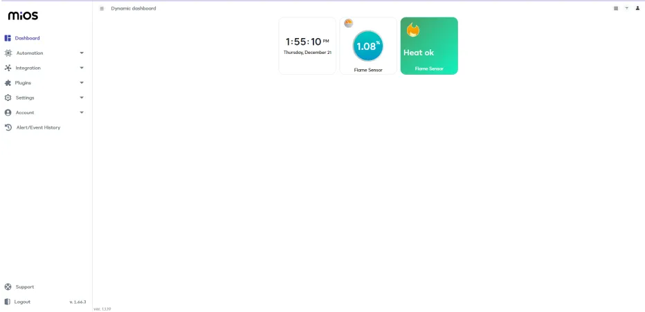

- After opening the MiOS mobile dashboard, you will be able to see the tile of your connected device. The KY026 Flame Sensor tiles in the above image indicate that no flame has been detected.

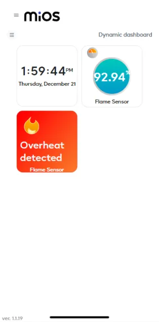

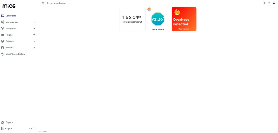

- In the above picture, the KY026 Flame Sensor tiles reflect that flame has been detected.

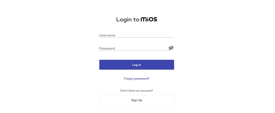

5. MiOS Web Application
- After opening the MiOS web dashboard, you see the tile of your connected device.The KY026 Flame Sensor tiles in the above image indicate that no flame has been detected.
