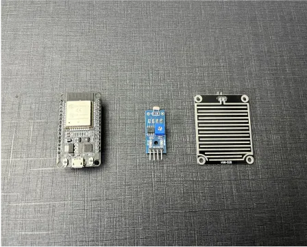

- LM393 comparator IC module.
- FC-37 rain sensor module.
- LM393 based 4-pin photoresistor sensor module.

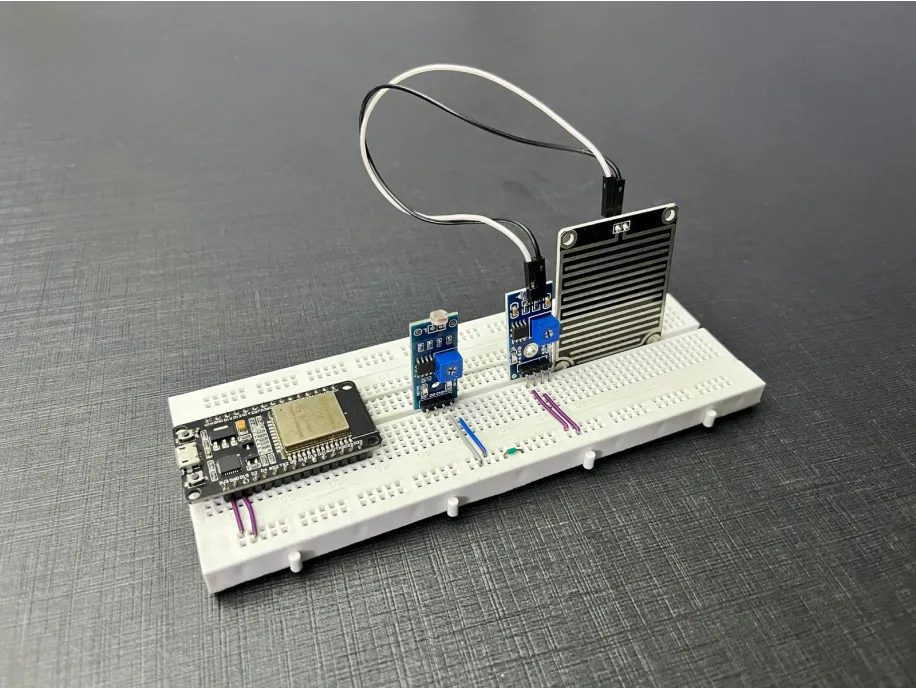

The wiring diagram for the ESP32 30 pin is represented as below:
From ESP32 to the LM393 comparator module:
| ESP32 | LM393 Comparator Module |
| VCC | VCC |
| GND | GND |
| D33 | A0 |
From the LM393 module to the Rain sensor:
| LM393 Comparator Module | Rain Sensor Module |
| (Pin) | POS |
| (Pin) | NEG |
From ESP32 to LDR Module:
| ESP32 | LDR Module |
| 3V3 | VCC |
| GND | GND |
| D15 | D0 |

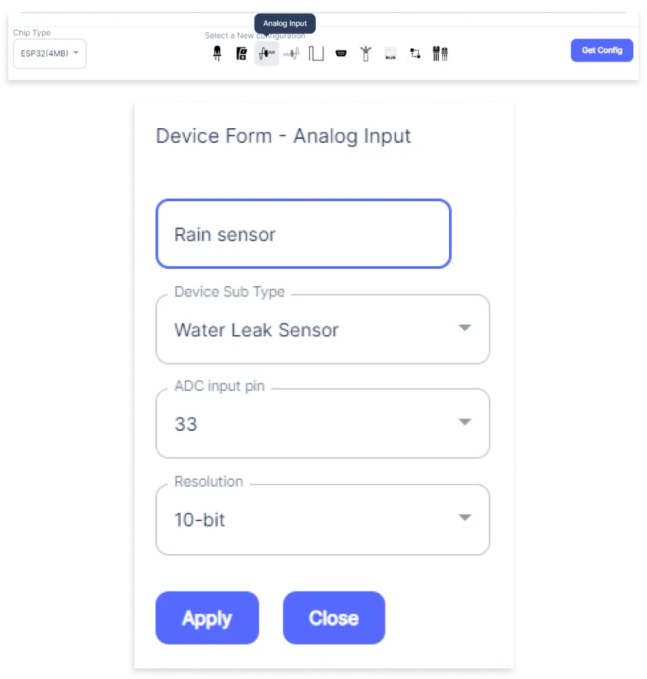

- In the Device Configuration, tab click on Analog Input.
- An Analog Input window will open for inputting the following parameters:
- Set a Device name of your choosing. In our case, we set it to the Rain Sensor.
- Set Device Subtype to Water Leak Sensor.
- Set the ADC input pin to 33.
- Set the Resolution to 10-bit.
- Then Click Apply Button.

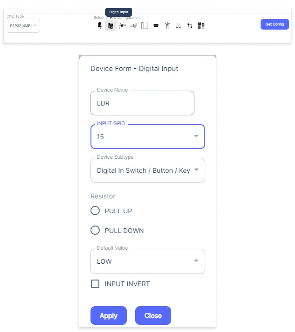

- Again, In the Device Configuration, tab click on Digital Input.
- A window will be opened for inputting the following parameters:
- Set a Device name of your choosing. In our case, we set it to LDR.
- Set INPUT GPIO to 15.
- Set Device Subtype to LDR Sensor (Digital).
- Set Resistor to PULL UP.
- Set default value to LOW.

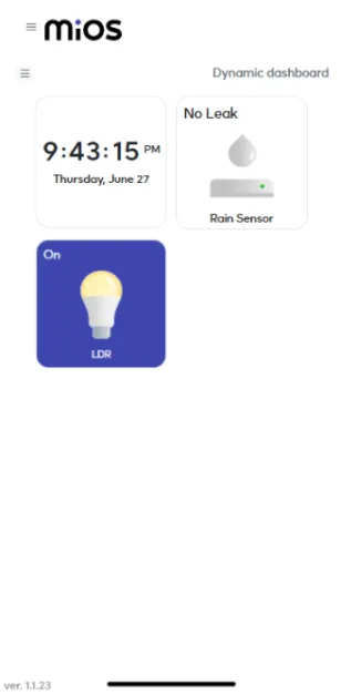

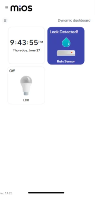

5. MiOS App
- On the MiOS mobile dashboard, you will see the tiles of your connected devices as shown above labeled as rain sensor and LDR.
- Currently, no rain drops are detected by the sensor therefore the rain sensor tiles show the “No Rain" or “No Leak” message. The LDR also shows ON indicating the presence of sunlight.
- Now as seen above, it shows a “Rain Detected” or “Leak detected” message on the rain sensor tile when the sensor detects any raindrops or rain water. Also the LDR tile turns OFF because of low intensity of light during rain.

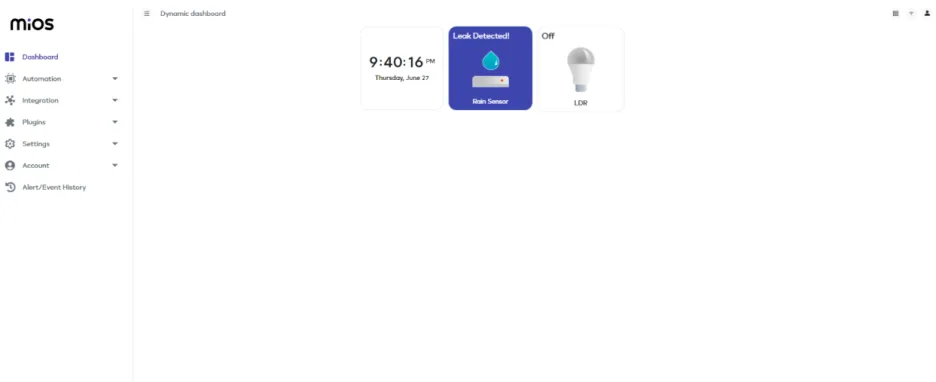

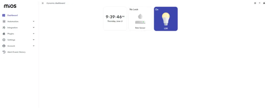

6. MiOS Web Dashboard
- On the MiOS web dashboard, you will see the tiles of your connected devices as shown above labeled as rain sensor and LDR. Currently, no rain drops are detected by the sensor therefore the rain sensor tiles show the “No Rain" or “No Leak” message. The LDR also shows ON indicating the presence of sunlight.
