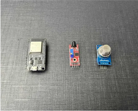

- MQ-9 LPG Combustible gas sensor.
- KY-026 Flame sensor module

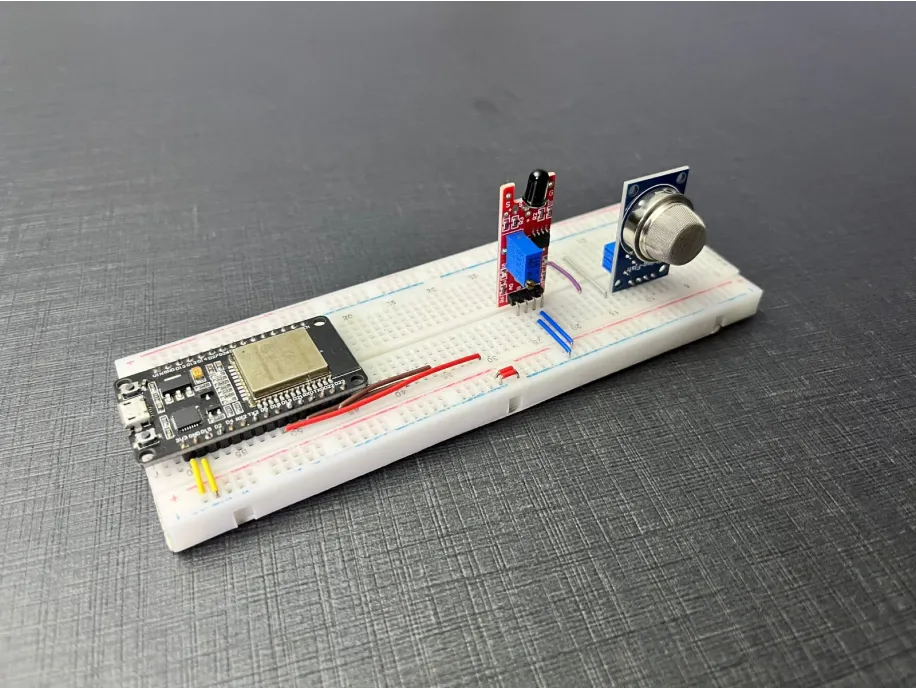

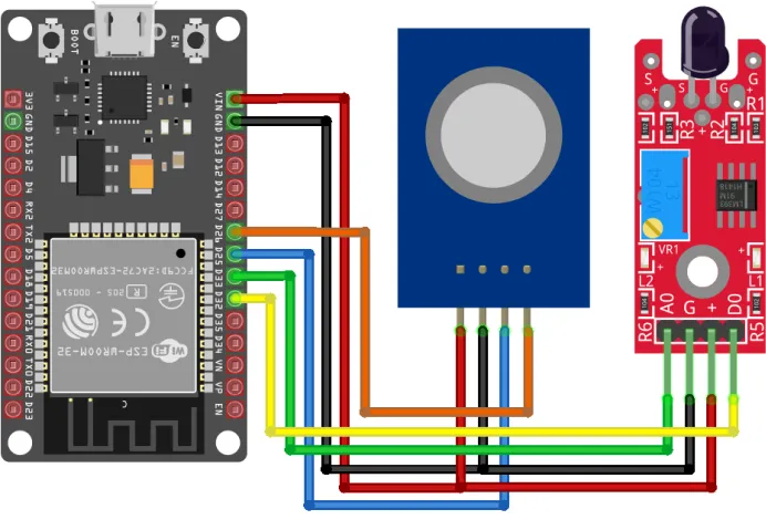

The wiring diagram for the ESP32 30 pin is represented as below:
From ESP32 to the MQ9 Combustible gas sensor:
| ESP32 | MQ9 |
| VIN | VCC |
| GND | GND |
| D26 | A0 |
| D25 | D0 |
From ESP32 to the KY-026 Flame sensor:
| ESP32 | KY-026 |
| VIN | VCC |
| GND | GND |
| D33 | A0 |
| D32 | D0 |

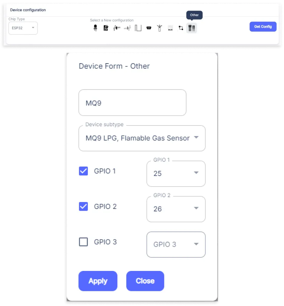

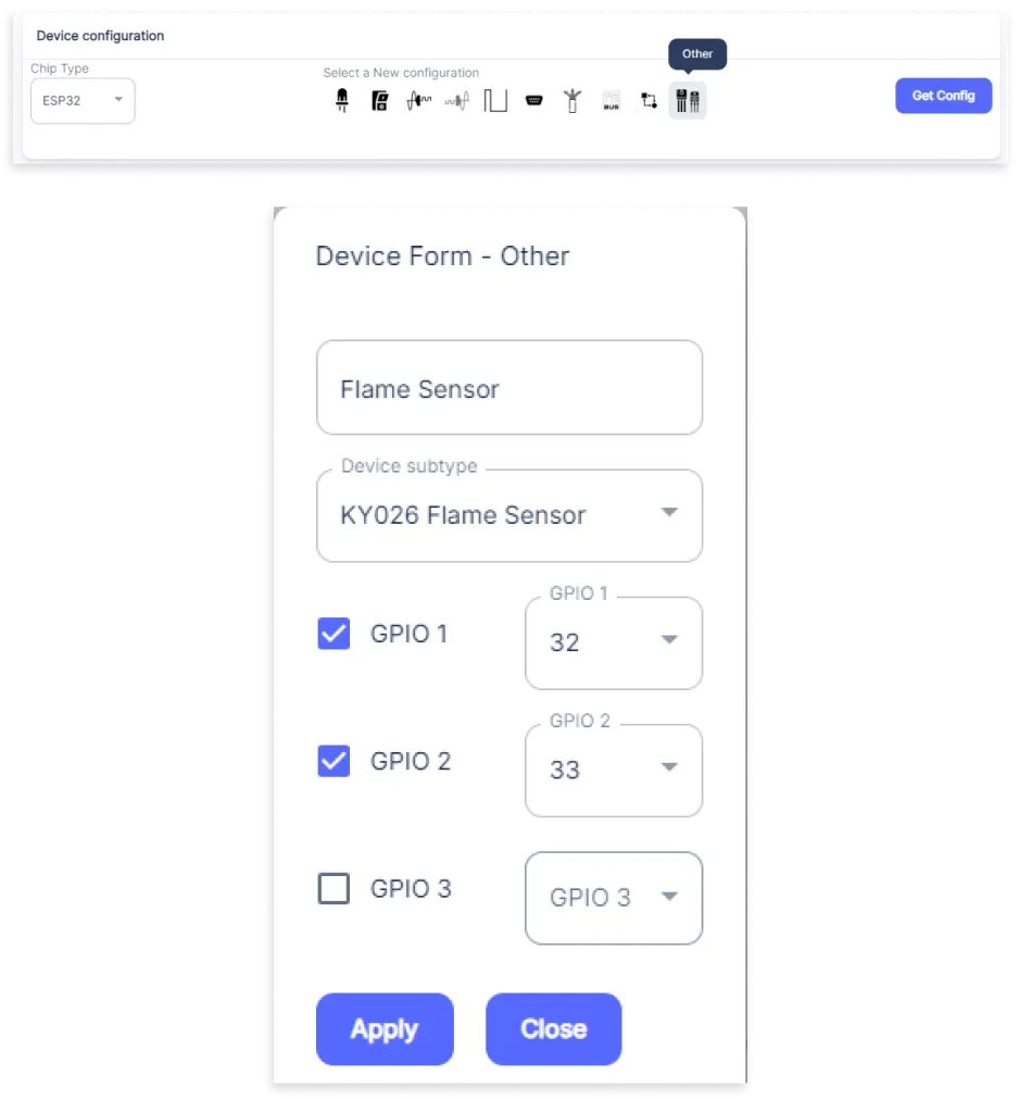

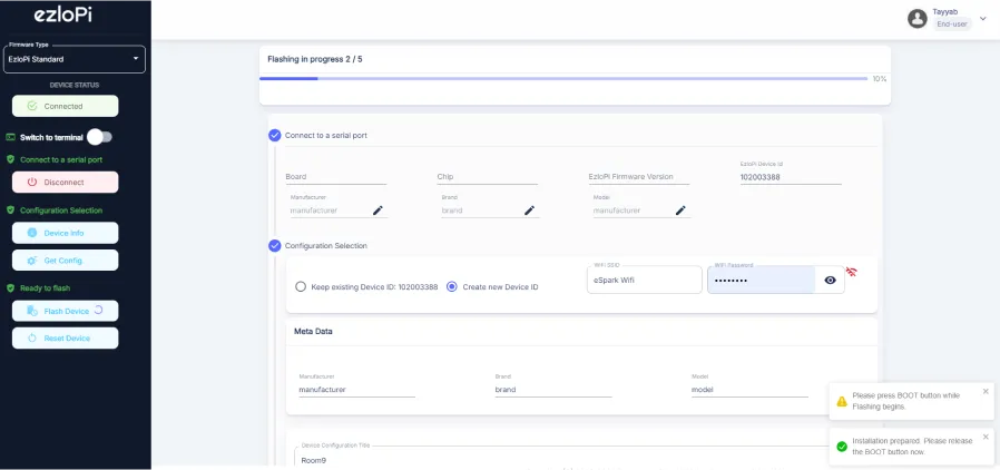

4. Interfacing the Gas sensor and flame sensor module using the EzloPi Web Flasher
Click Connect
- In the Device Configuration, tab click on Other.
- A window will open for inputting the following parameters:
- Set a device name of your choosing. In our case, we set it to MQ9.
- Set Device subtype to MQ9 LPG Flammable Gas Sensor.
- Select theCheck box of GPIO 1.
- Set GPIO 1 to 25.
- Select the Check box of GPIO 2.
- Set GPIO 2 to 26.
- Then Click Apply Button.

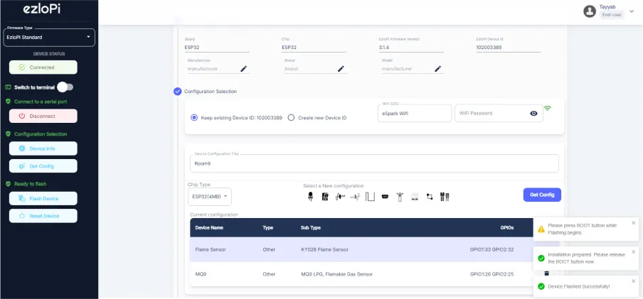

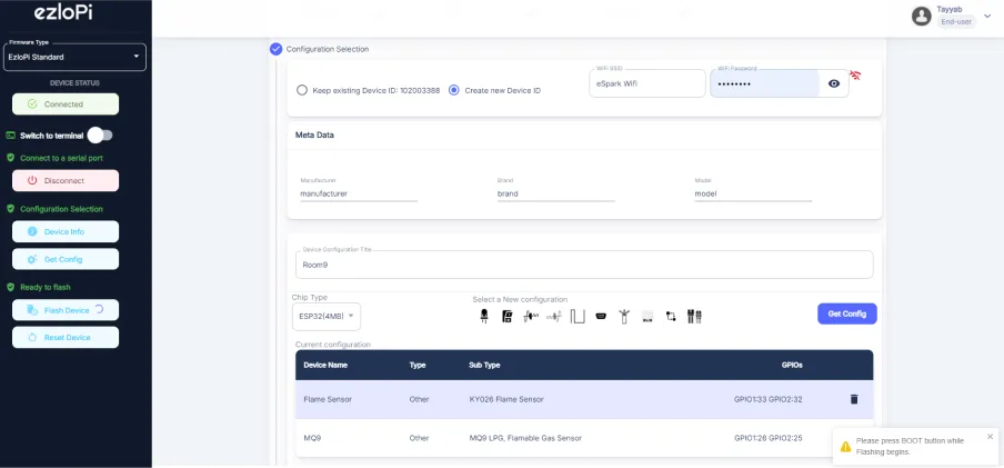

- Again, In the Device Configuration, tab click on Other.
- Set a device name of your choosing. In our case, we set it to Flame Sensor.
- Set Device subtype to KY026 Flame Sensor.
- Check the box of GPIO 1.
- Set GPIO 1 to 32.
- Check the box of GPIO 2.
- Set GPIO 2 to 33.

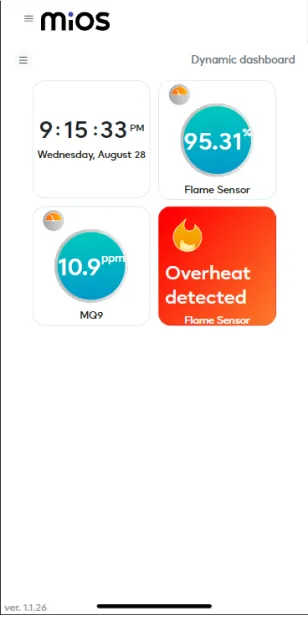

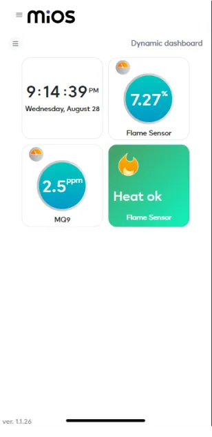

5. MiOS App
- After opening the MiOS mobile dashboard, you see the tiles of your connected devices. The MQ9 tile will reflect the concentration readings of the carbon monoxide (CO) as shown above and the KY-026 flame sensor shows the amount of heat it detects and if it's under the set temperature threshold.
- Now as seen above, the MQ9 detects gas and shows an increased value of the gas on the dashboard tile along with the flame sensor which senses heat and shows the “Overheat detected” message on the tile.

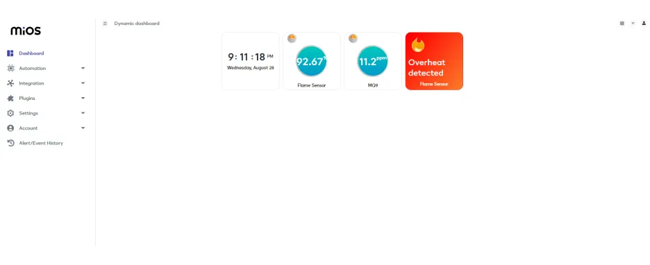

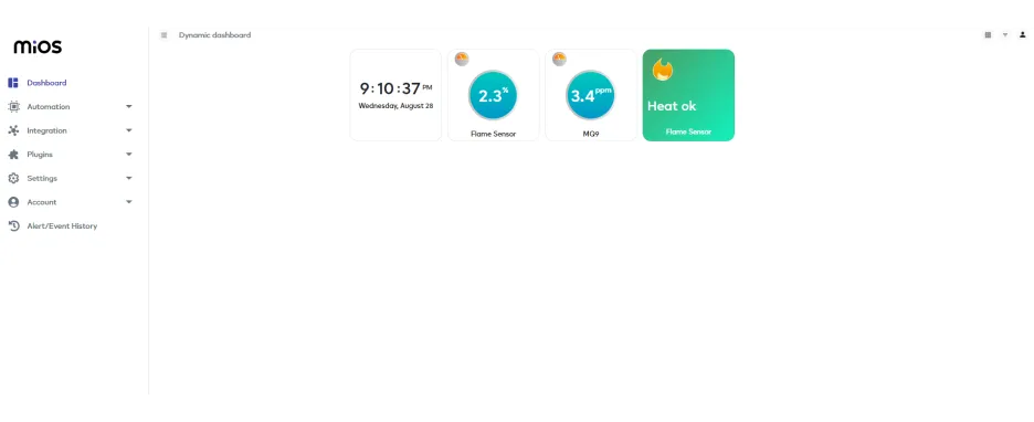

6. MiOS Web Dashboard
- After opening the MiOS web dashboard, you see the tiles of your connected devices. The MQ9 tile will reflect the concentration readings of the carbon monoxide (CO) as shown above and the KY-026 flame sensor shows the amount of heat it detects and if it's under the set temperature threshold.
