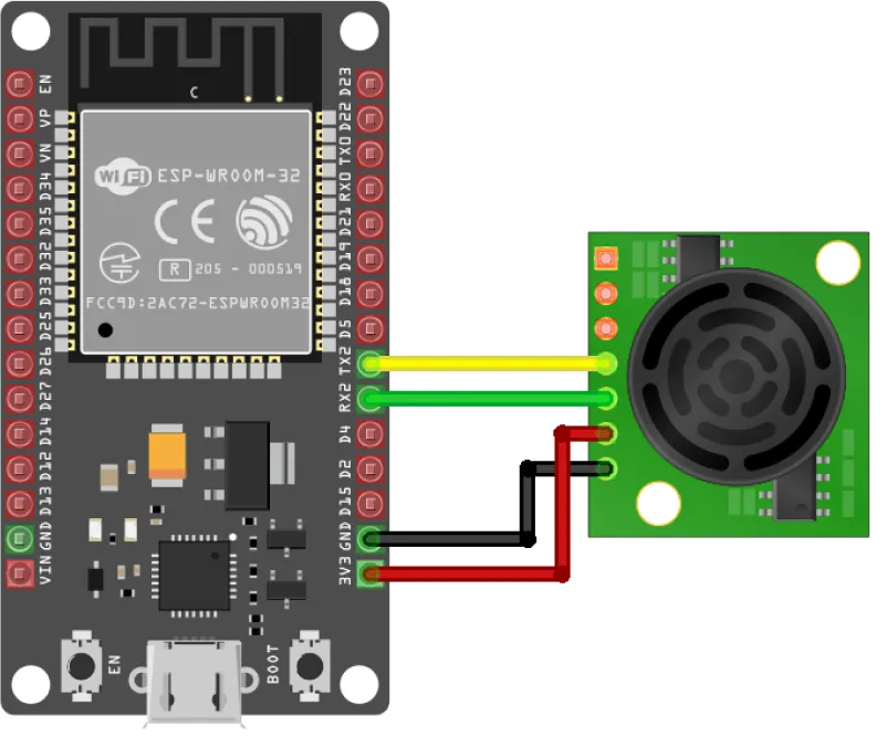

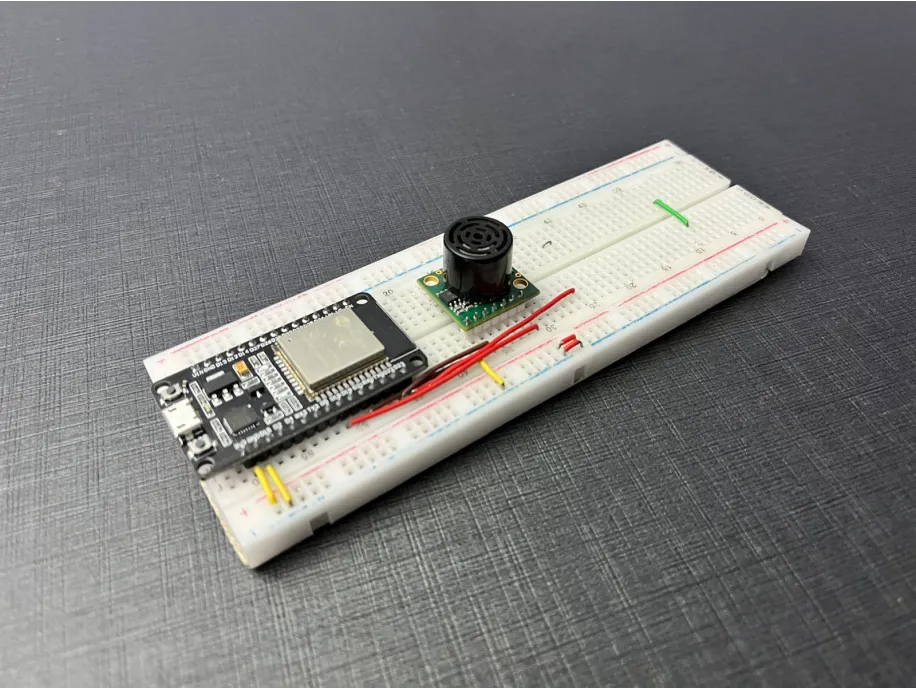

The wiring diagram is represented as follows:
From ESP32 to the MB1013 module:
ESP32 | MB1013 |
3V3 | VCC |
GND | GND |
D16 (RX) | Tx |
D17 (TX) | Rx |

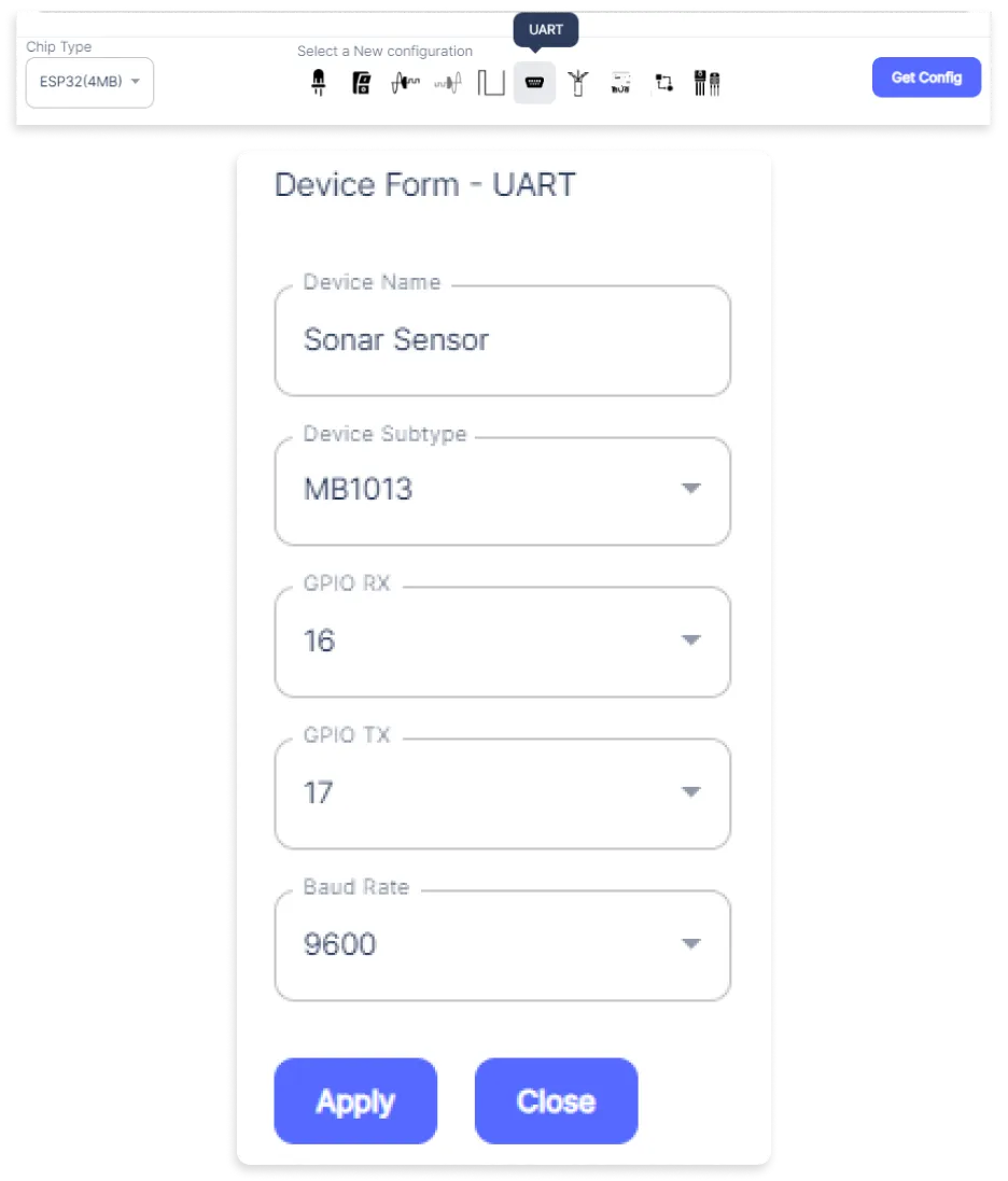

- A window will open for inputting the following parameters:
- Set a device name of your choosing. In our case, we set it to Sonar Sensor.
- Set Device subtype to MB1013.
- Set GPIO RX to 16.
- Set GPIO TX to 17.
- Set Baud Rate to 9600.
- Then Click Apply Button.

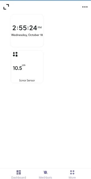

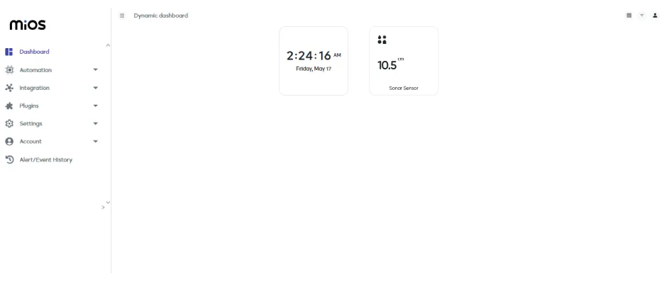

5. MiOS App
- After opening the MiOS mobile dashboard, you will be able to see the tile of your connected device. Now the dashboard tile is displaying the distance to the object detected by the sensor as seen above.
6. MiOS Web Application
- After opening the MiOS web dashboard, you will be able to see the tile of your connected device. Now the dashboard tile is displaying the distance to the object detected by the sensor as seen above.
