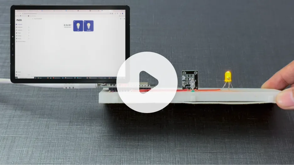

Welcome to the project demonstration video section. The following video showcases the key aspects of Detect tilt by using Tilt Switch Module KY-017 Mercury Tilt Switch and LED, providing a visual walkthrough of its implementation.

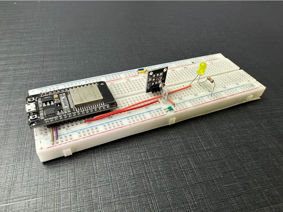

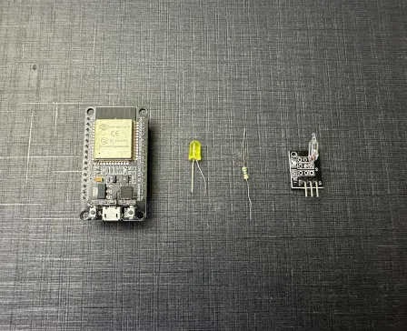

- KY-017 Tilt Switch Module.
- LED with 100 Ohm Resistor

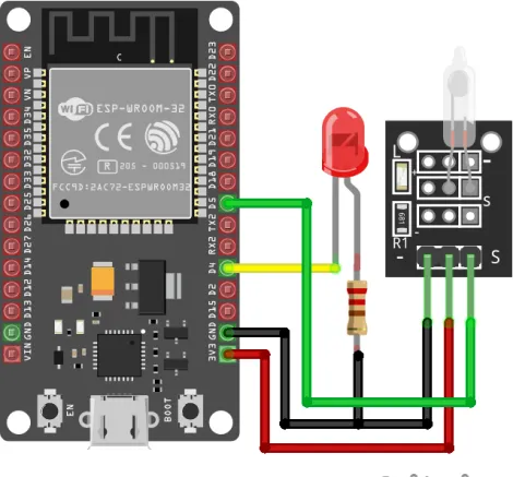

From ESP32 to KY-017:
| ESP32 | KY-020 |
| VCC | Vin |
| GND | GND |
| D5 | S (Signal) |
From ESP32 to LED & Resistor:
| ESP32 | LED | Resistor |
| GND | - | 1st Terminal |
| D4 | Anode | - |
| - | Cathode | 2nd Terminal |

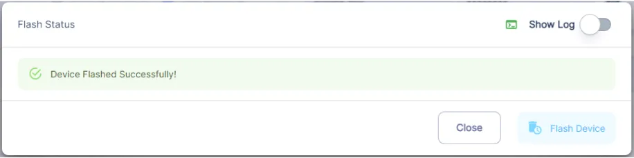

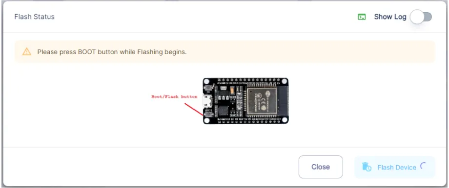

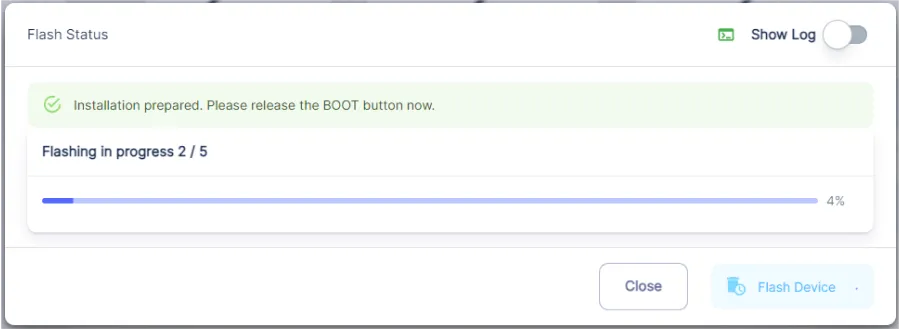

4. Interfacing the Tilt Switch Module using the EzloPi Web Flasher:
Click Connect

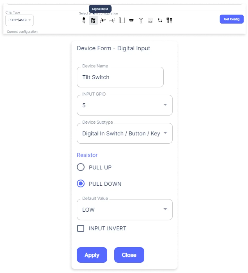

- The Digital Input window will open for inputting the following parameters:
- Set a Device name of your choosing. In our case, we set it to the Tilt Switch.
- Set INPUT GPIO to 5.
- Set Device Subtype to Digital In Switch / Button / Key.
- Set Resistor to PULL DOWN.
- Now Click the Apply button.

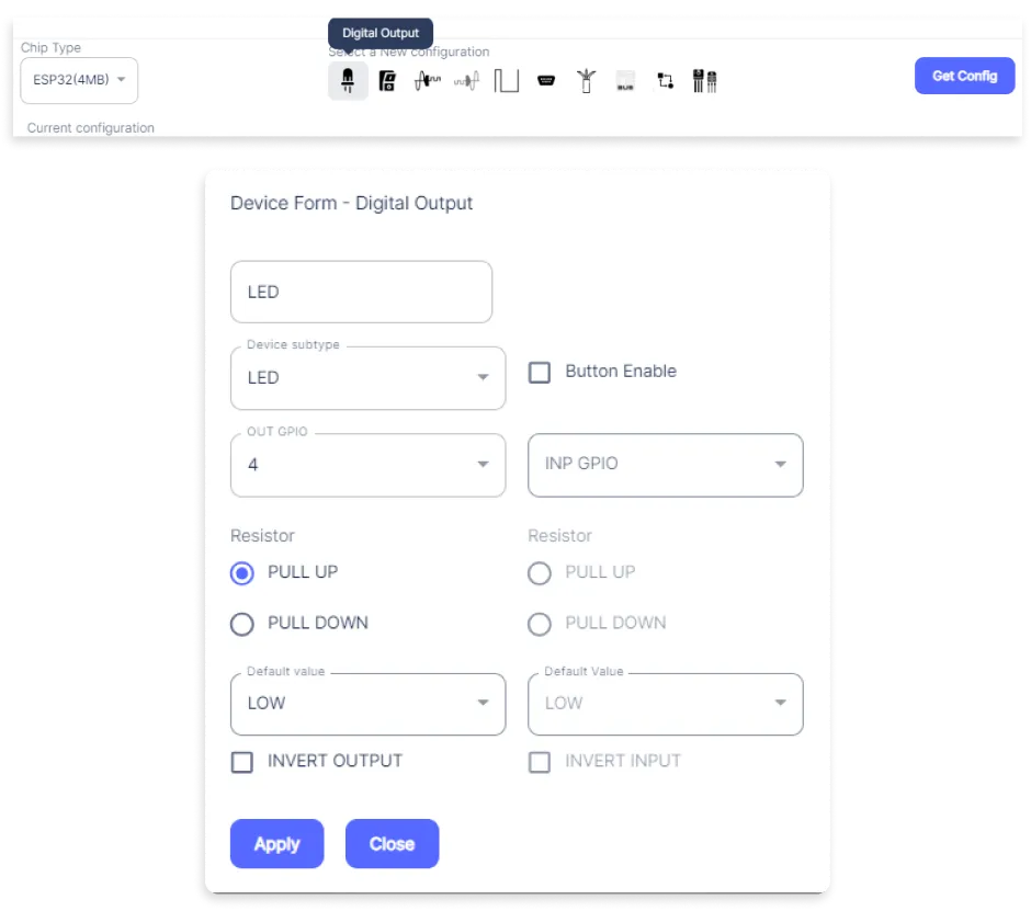

- The Digital Output window will open for inputting the following parameters:
- Set a Device name of your choosing. In our case, we set it to the LED.
- Set Device Subtype to LED.
- Set OUT GPIO to 4.

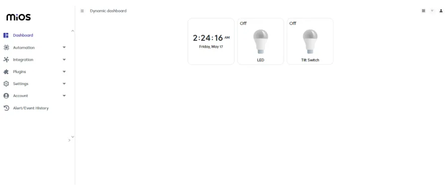

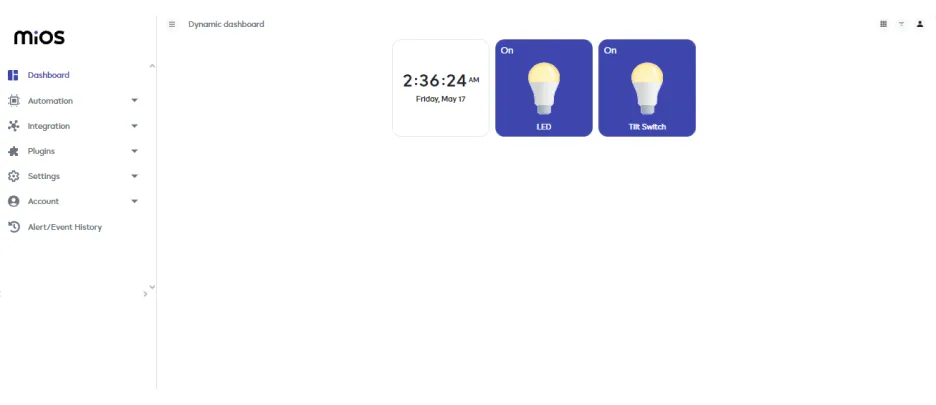

5. MiOS Web Dashboard
- As seen in the MiOS web dashboard above, the Tilt Switch and LED tiles are visible. For now they both are in off state.

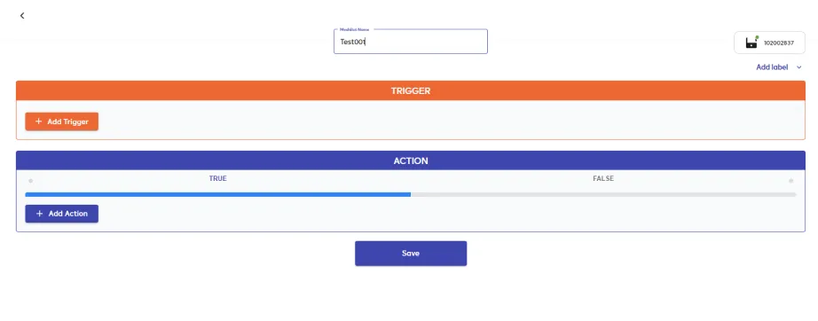

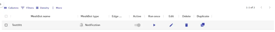

MeshBots:
- After clicking on Create new MeshBot you will see new options, click on EzloPi.
- On the next screen you will see that we can create a name of our choosing, in this case we write it as Test001.

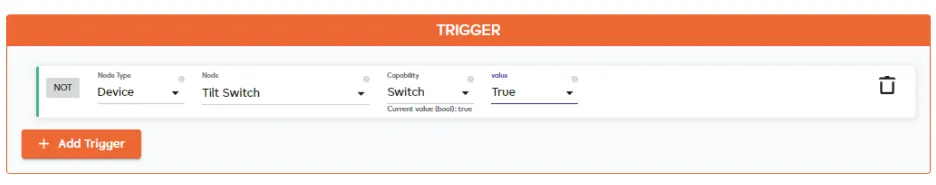

- Set these values in TRIGGER section:
- Set Node Type to Device.
- Set the Node to Tilt Switch.
- Set the Capability to Switch.
- Set the value to True.

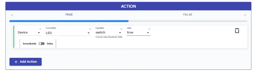

- Set these values in the True part of the ACTION section.
- Set Controllable Type to LED.
- Set the value to true.

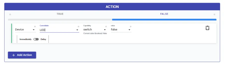

- Set these values in the False part of the ACTION section.
- Set the value to false.
- After clicking the apply button you can see a table of your setting in the Current configuration tab.
- As seen in the MiOS web dashboard above, the Tilt switch sensor tile is visible which is triggered and the LED gets turned on because of the rules we have set in the meshbot.

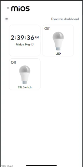

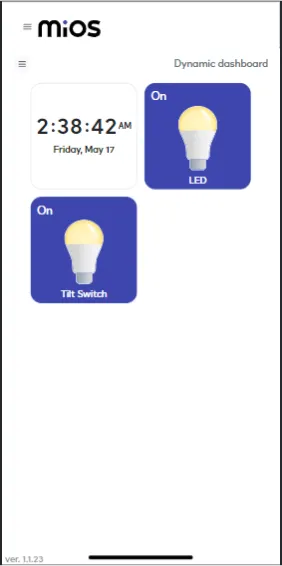

6. MiOS App
- After opening the dashboard, you will be able to see the tile of your connected device.
- As seen in the MiOS app above, the Tilt switch sensor and LED tiles are visible. For now they both are in off State.
- As seen in the MiOS app above, the Tilt switch sensor tile is visible which is triggered and the LED gets turned on because of the rules we have set in the meshbot.
